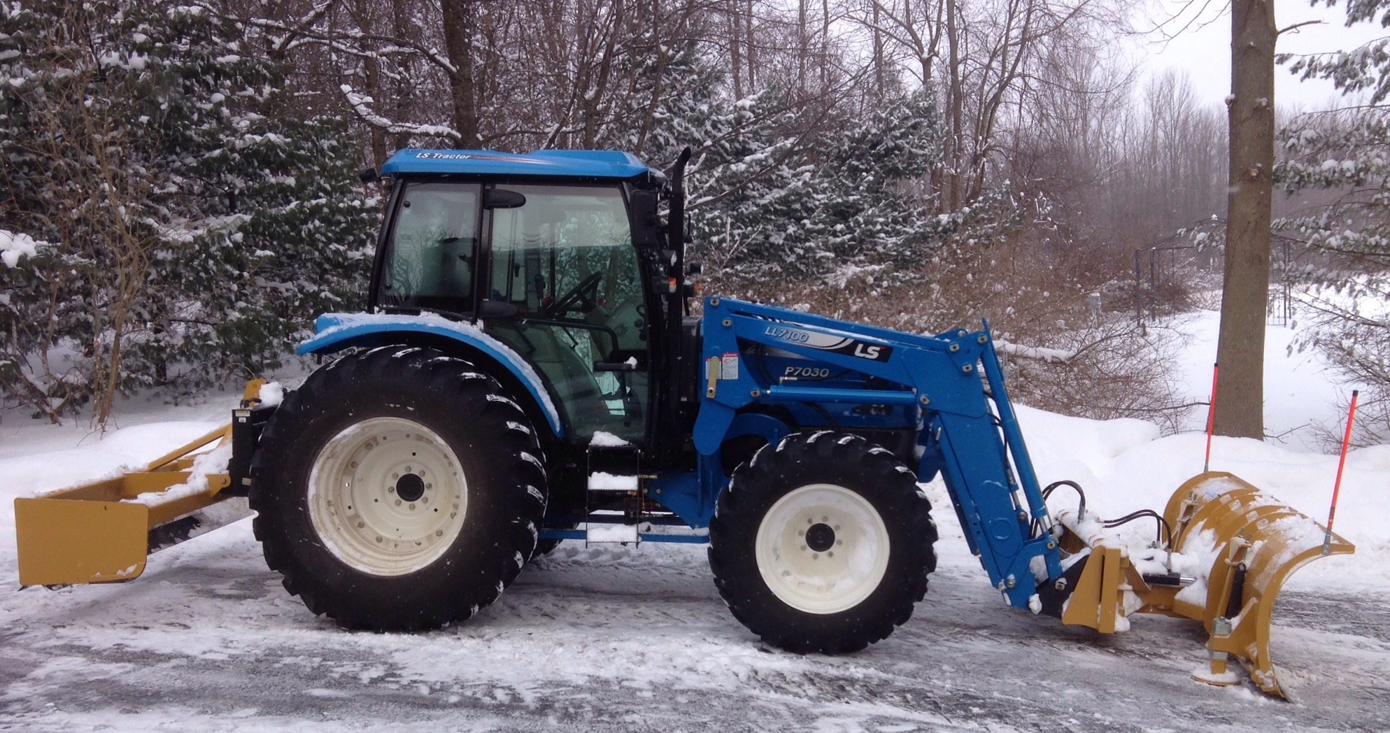

Here's the 2000 on my Kioti and the 3000 on my LS. (FYI I had the 2000 painted, that's not a standard color.)

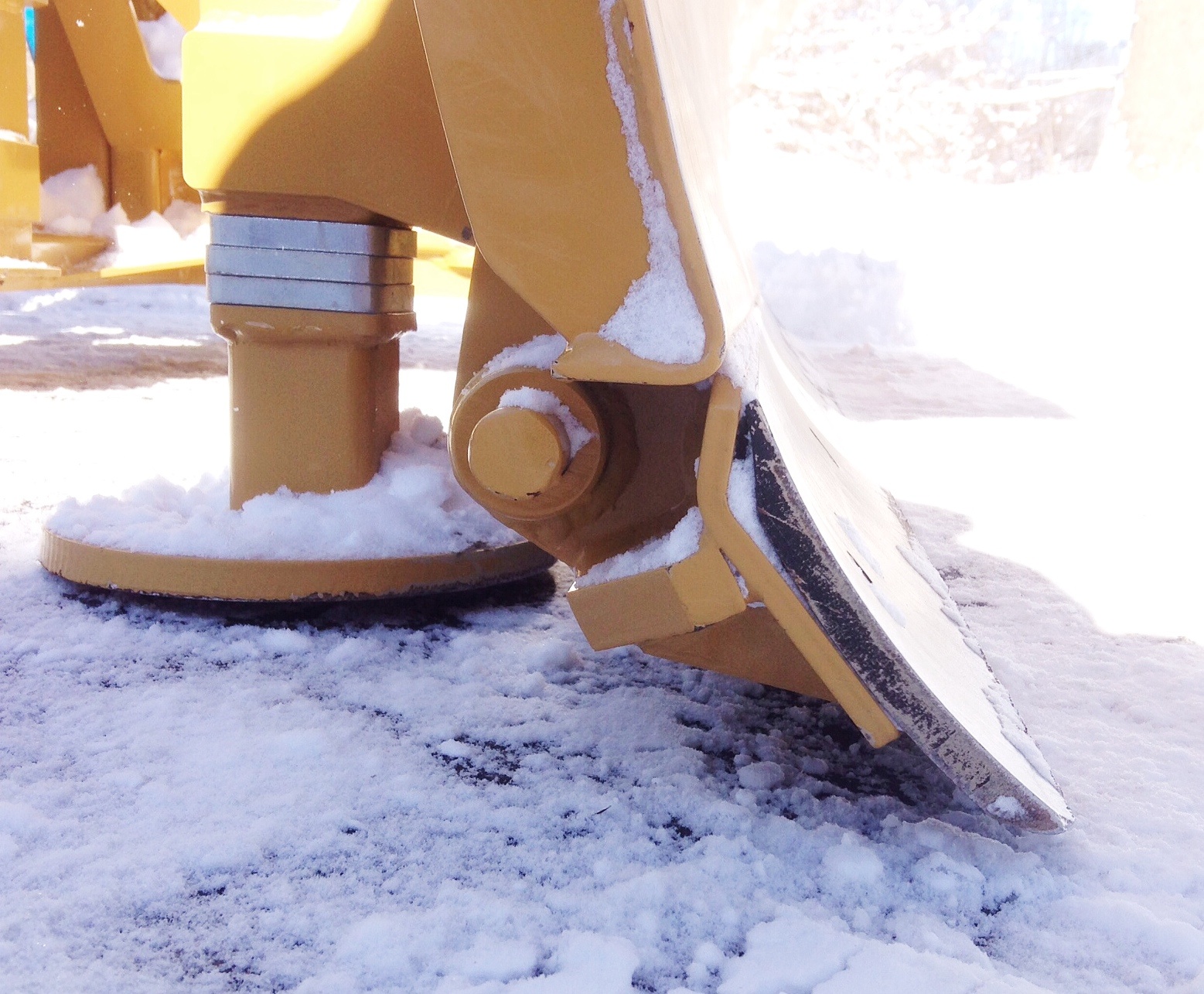

The Kioti handled it very well and I have no qualms recommending both the tractor and the plow with a few pointers. I had only one or two instances where the front end was pushed around and that was in very deep snow. I never needed to remove the plow and put on the bucket. I didn't need chains but the rear tires were loaded with Rimguard.
Prepping the drive prior to snow season is key. I make sure the drive is in great shape prior to the first freeze. If you have wash boarding or potholes you will be fighting it all season. This year has been great for plowing in that it's pretty much been frozen since November.
Adjust your skids so the blade is just about hitting the ground when level and note where your bucket indicator is. I use this setting when plowing the paved section of my drive and will even tip it a little forward if I want to scrape it clean.
For my 1/4 mile section of gravel drive I just set the plow down, curl it back about half a inch of indicator rod and go to town. Do NOT use the float mode on your FEL, the plow handles that great.
You will need to experiment with the curl to find the optimum setting for your tractor and snow conditions but I really think you will enjoy the plow.
As far as plowing the area around my fields, I only started seriously doing that this year with the bigger tractor. I didn't really prep it like I should have prior to the snow. It can be more of an adventure and a few times when I was "sight-seeing" I would hit the opposite windrow with the leading edge and the tractor would take a sharp detour.
Good luck!
   / HLA (HorstWelding) or Curtis Sno-Pro Snow Blade #7

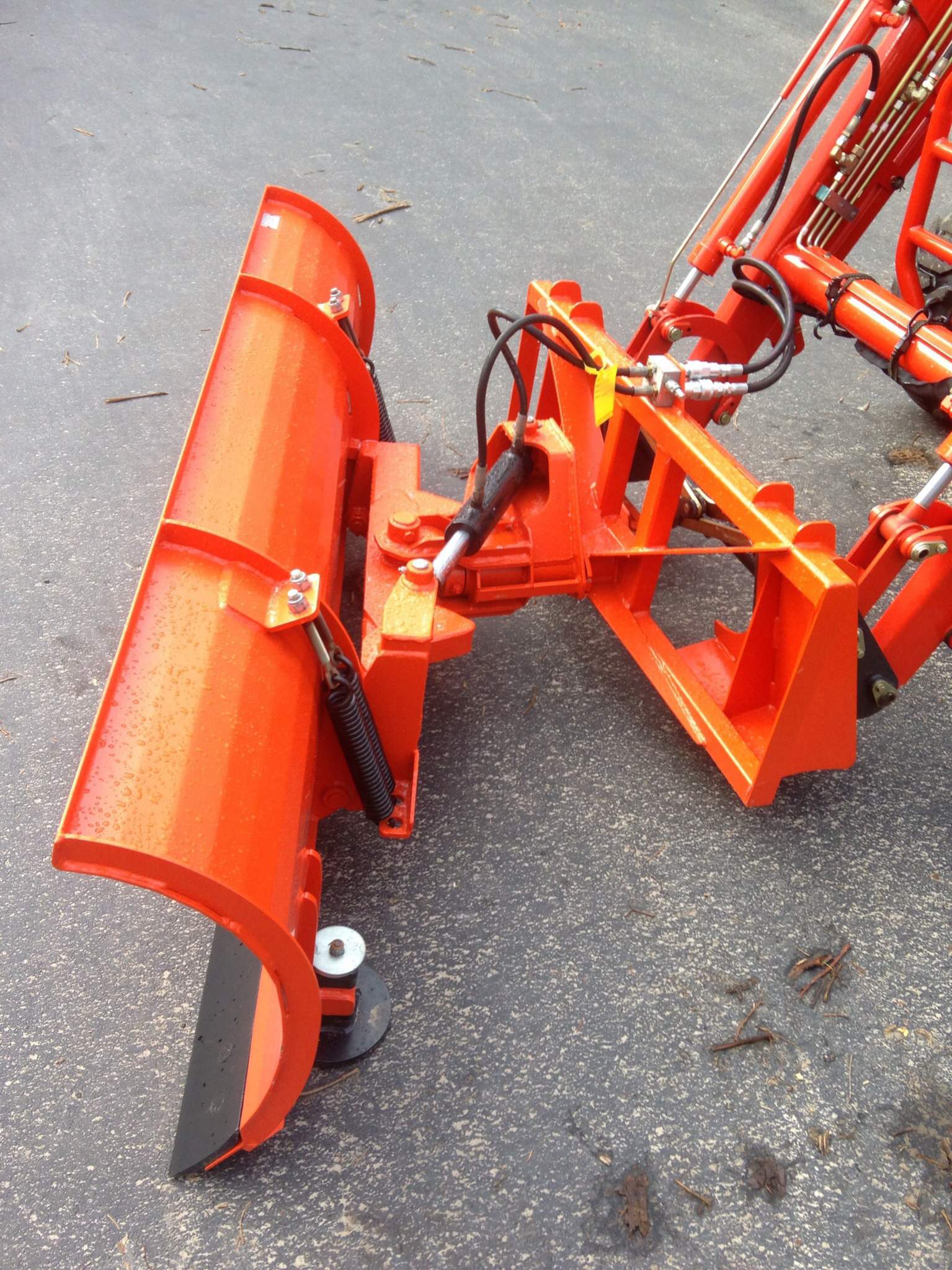

I went out and snapped a photo of how I have the plow adjusted. I try and have it so the rear of the skid shoe is just touching.

That's a great shot. Thanks. I have a new wrinkle. The salesman from Quick Attach just called me and said he'd ship to my door a 72" Quick Push - Snow/Light Material Blade ( 25 degree angle, 66" work width, skid shoes hoses, guide markers, 28" tall, 600 lbs. and shipping included) for $2400. That's about $1200 less than I can get the HLA. In the end I want to get a good plow that will last me 15 years. Any opinions on Quick Attach??? (Model #900340)
