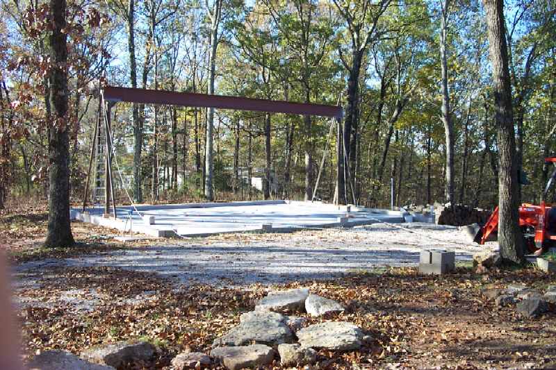

Things always take longer than expected… Anyway, got everything rigged-up and took the beam up a couple feet. Everything worked as expected except I noticed a little lip at the column top that the beam must get around. Just have to figure a way to get around it and then it should be resting in place today.

It’s up! Went pretty smoothly until I hit that lip. Used some rope to pull it around and then it swung right into place.
Time for breakfast. Even though I’m pretty sure of myself you still get on edge when doing something like this.

Nice work. I'm sure you are glad to have that out of your way -- now on to the next challenge! /forums/images/graemlins/wink.gif

Looks good. Now, be sure to post progress pictures so we see how it's being used...

Glad it went up smoothly...
Somehow I am not surprised though...
Still...can't help but want to say: Good job! /forums/images/graemlins/smile.gif

Well done, I admire the effort /forums/images/graemlins/cool.gif
