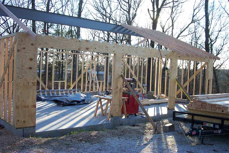

Thought I would give everyone an update on my beam project.
Had a few nice days so I was able to get it painted. Got all the walls framed and I’m now working on the roof.
Everything is coming together pretty nicely, but I’m torn about what siding to use. At first I was going to use HardiPlank but I’m swinging more towards T-11 now. After reading about all the issues with HardiPlank it seems easier to use the T-11 and have to paint it more often.

Fungus - Looking Good! This has been interesting to watch the development of your project/hoist methodology. Are you building this from purchased plans or plans of your own? I'd be interested in those plans if they are available some where.
I have T-111 on two outbuildings which has held up really well with minimal maintenance but don't have any experience with Hardiplank.

#46
jd2210va
Thanks, the design is my own. I basically wanted a 34’ X 24’ garage for vehicles only. The I-beam eliminates all the truss clutter, provides a nice lifting point, and was about the same cost – at least with me doing all the labor.
Since I’m an engineer type I simply calculated the required strength necessary to support my dead & live loads, plus a little extra for lifting things. As it turns out a W18X35 was lighter, stronger, and cheaper than going with a W12. Spanning 34’ with snow loads get pretty tough.
em14
Didn’t say anything is wrong with it, just issues or pros & cons. My T111 siding on the house is still doing well after 25 years. I’m just reconsidering my choices.

Keep in mind I’ve never used HardiPlank so the only thing I know about it is through reading.
Some of the “Cons” I’ve read about are caulking, nailing, dust if sawing, and telegraphing any irregularity through from the framing. There is a lot of talk about how it can either look really good or bad depending on the install. Maybe I’m overreacting to it all but I know where I stand when it comes to a wood product.
While at the store today I pickup a piece of HardiPlank so I can test it out – nailing, cutting, etc. The fellow at the store suggested that installing HardiPlank without external sheathing might not be good in that it would be pretty flimsy or easy to break through. Hardie suggest it can be installed on 16”OC framing but now that I think about it, well maybe its not a good idea.
In my situation I decided to sheath the insides to cover up all the framing and make for clean look. What ever I decide to put on the outside need to go directly on the framing. Has anyone ever done this with HardiPlank?
