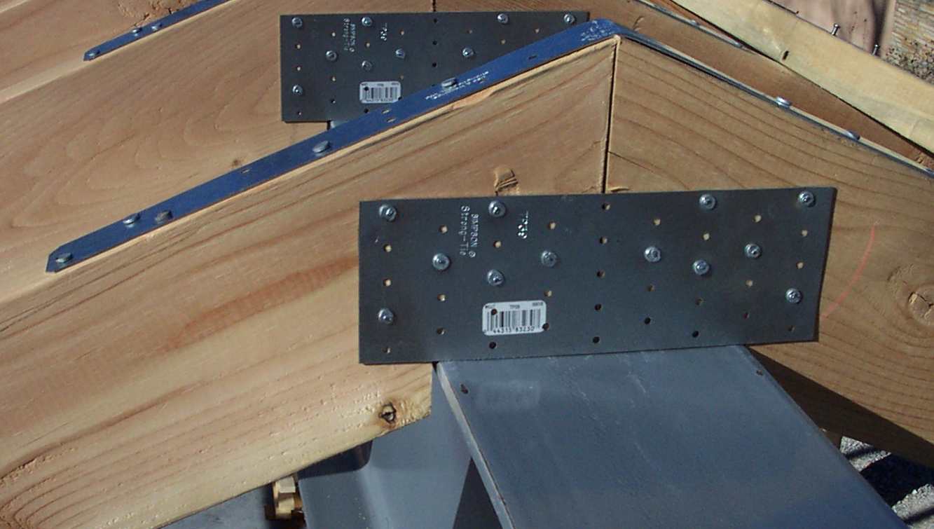

Hi Fungus,
How are you making the connection between the wood rafters and the steel beam? Are you bolting some wood plates to the top of the beam so you can still use Simpson style connectors?
Thanks
Yooper Dave

I used a strap tie on top and a mending plate on the side - see attachment...

So what holds the peak down? That's not obvious from the picture. Or do you figure that the hurricane ties at the eves and the peak straps combine to hold the roof sufficiently rigid?
Cliff
   / Hoisting an I-beam … #59
Are you concerned with the notch on the tension side of the rafter? The notch may induce a crack and reduce the intended capacity of the rafter.
What also holds the rafter down at the ridge from wind uplift loading? Can the rafters as detailed laterally brace the steel beam? Were you going to add blocking between the rafters and connect it to the top flange of the beam?
Sorry for all the questions, but I am not familiar with these details.
Good Luck
Yooper Dave

Yep, I figured these questions would follow.
</font><font color="blue" class="small">( So what holds the peak down?)</font>
As it is right now the peak is just resting on the beam. I do figure between the straps and wall hold-downs there’s enough to keep it from blowing away. Were not in a high wind or special wind region. Also, the exposure category is very low due to all the surrounding oak tress. If you think about it, a standard gable roof does not have the ridge tied to the foundation either. It depends on the wall hold-downs and the ridge staying together, hence the straps.
However, I am considering extending the bottom of the rafter up under the beam flange. Nothing like a little insurance…
</font><font color="blue" class="small">( Are you concerned with the notch on the tension side of the rafter?)</font>
No, it’s standard practice to notch the tail end. What’s the difference if one or both ends get notched? Most of the tension (bottom side) and compression (top side) occurs out in the middle, not at the ends.
I am a little concerned about wood quality. For my loads No. 2 is adequate for the span. I sorted through a lot of DF to find some decent stuff. I can’t believe what the contractors use!
</font><font color="blue" class="small">( Can the rafters as detailed laterally brace the steel beam?)</font>
The rafters do provide lateral support but it’s only as good as the top of the walls (not a whole lot). Although the beam does not depend on any lateral support it will wobble when pushed on from the side. I’m hoping once I get my roof sheathing installed things will stiffen up some more.
Please note that where I’m at there are no codes or inspections. You can do whatever you want just as long as you’re willing to live with the consequences.
Finished installing the rafters and lookouts (see attachment). Now I’m getting the fascia installed. So far winter has been kind & I’m hoping to get the roof on before it finally gets here.
Don’t mind the questions.
