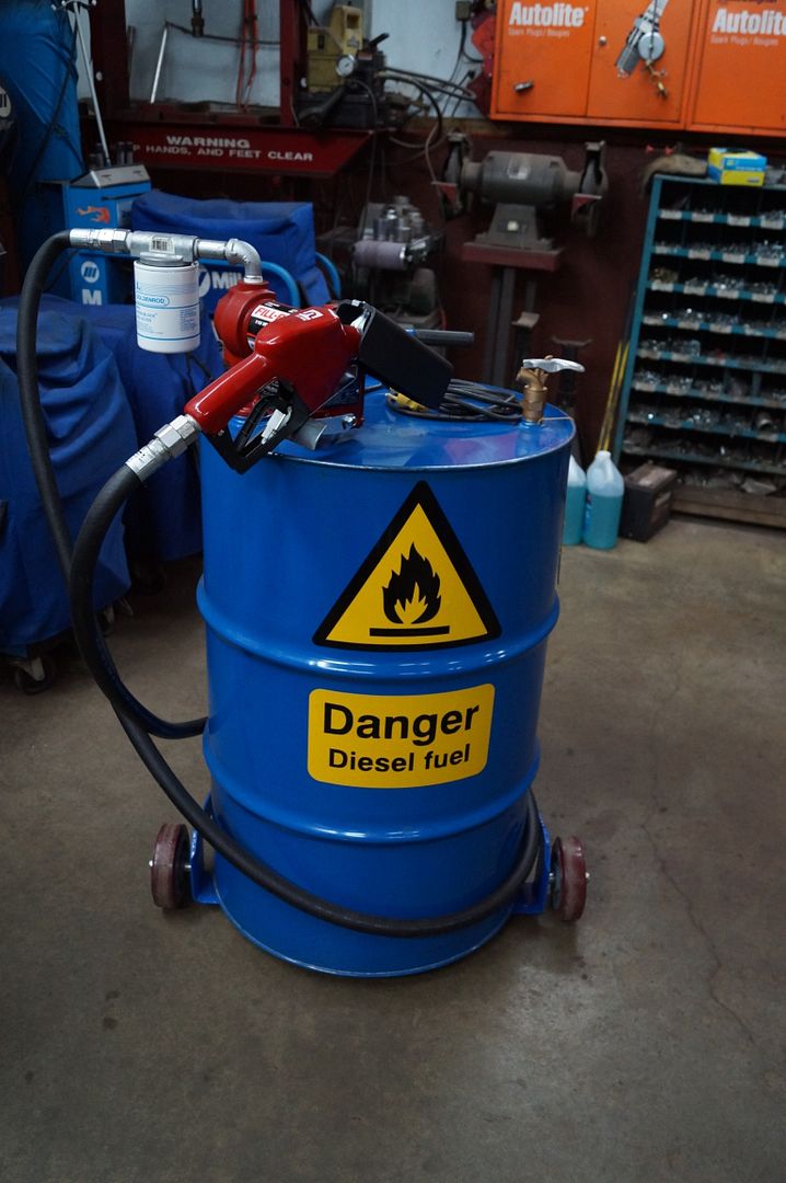

As for plastic barrels. Last year I did some research and the more I was reading on it the more confusing it got. There are different types of plastic drums. Some of them can break down due to the fuel in them. I decided to go with the steel barrel because there was no risk of chemical reaction to the diesel plus less risk of the threaded bung stripping out. The plastic bungs are easy to strip.
I went with the electric pump with the optional automatic cutout nozzle. I did make one change thanks to the good advice of TripleR. I put a 90 degree elbow on the hose that exits the filter (not shown) The filter takes any crap and moisture out.
This of course is the ultimate set up. This is definitely a possibility but my blue plastic gravity feed system will be much cheaper... I generally don't take the cheap route but I did set up a salt water mix/feed system with a 65gal storage and 40gal mix tank with a mix/flush pump system with mostly plastic and was very happy with the system. I guess that is why I am leaning that way at the moment.

With the money you'll save I would invest in a pump. I have the same Fill-Rite pump as 4 shorts. I use it to pump out 275 gallon tanks into 55 gallon drums when someone is in the same situation as your son. I had to add an extra 6" section of pipe to the adjustable intake pipe to get to the bottom of the 275 gallon tank. My 55 gallon drum isn't as fancy as 4 Shorts, it's just sitting on a wood platform with 4 Harbor Freight 6" casters so I can roll it around the garage. In the fall I just call up the fuel dealer and he stops over and fills up both the home tank with HHO and the 55 gallon drum with ORD with anti-gel. Fill-Rite pumps aren't cheap but they last and if you ever need to you can rebuild them. Harbor Freight does sell a pump that some people here have bought and said works fine. It doesn't screw into the large bung on the drum or tank though.

The fill rite pump will wipe out my savings and more! Would love to have but I am seeing $320 for the low end and need a barrel. My BX will be the only user as I run LP for supplement heat and cooking. Generator is gasoline as are other vehicles and tools, so it hard to justify. Also in the mix is a multi process welder and I would rather skimp on this project and steer the $$$ to the welder and accessories.
Still thinking gravity feed unless someone can convince me that the pump is the way to go for limited use/need.
