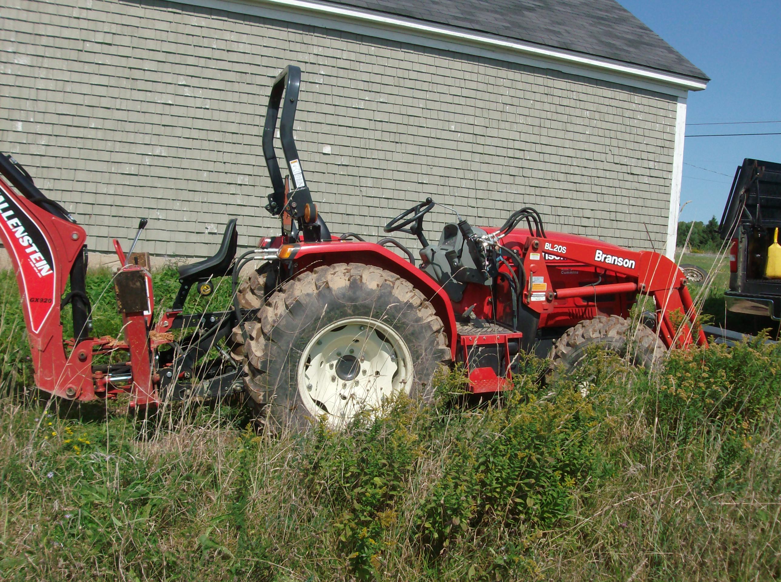

/ Home-made attachments... #292
Pin on quick attach for the loader
Grapple bucket
Core aerator
Backhoe
Leaf vac

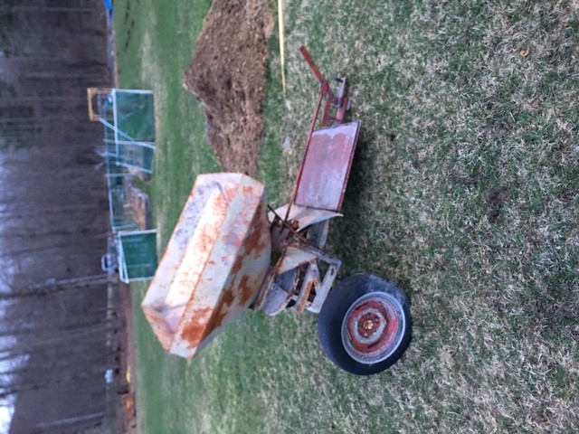

I didn't make this but I recently purchased this after looking for a ground driven sander I can use on my long ( 1200') gravel driveway in upstate NY

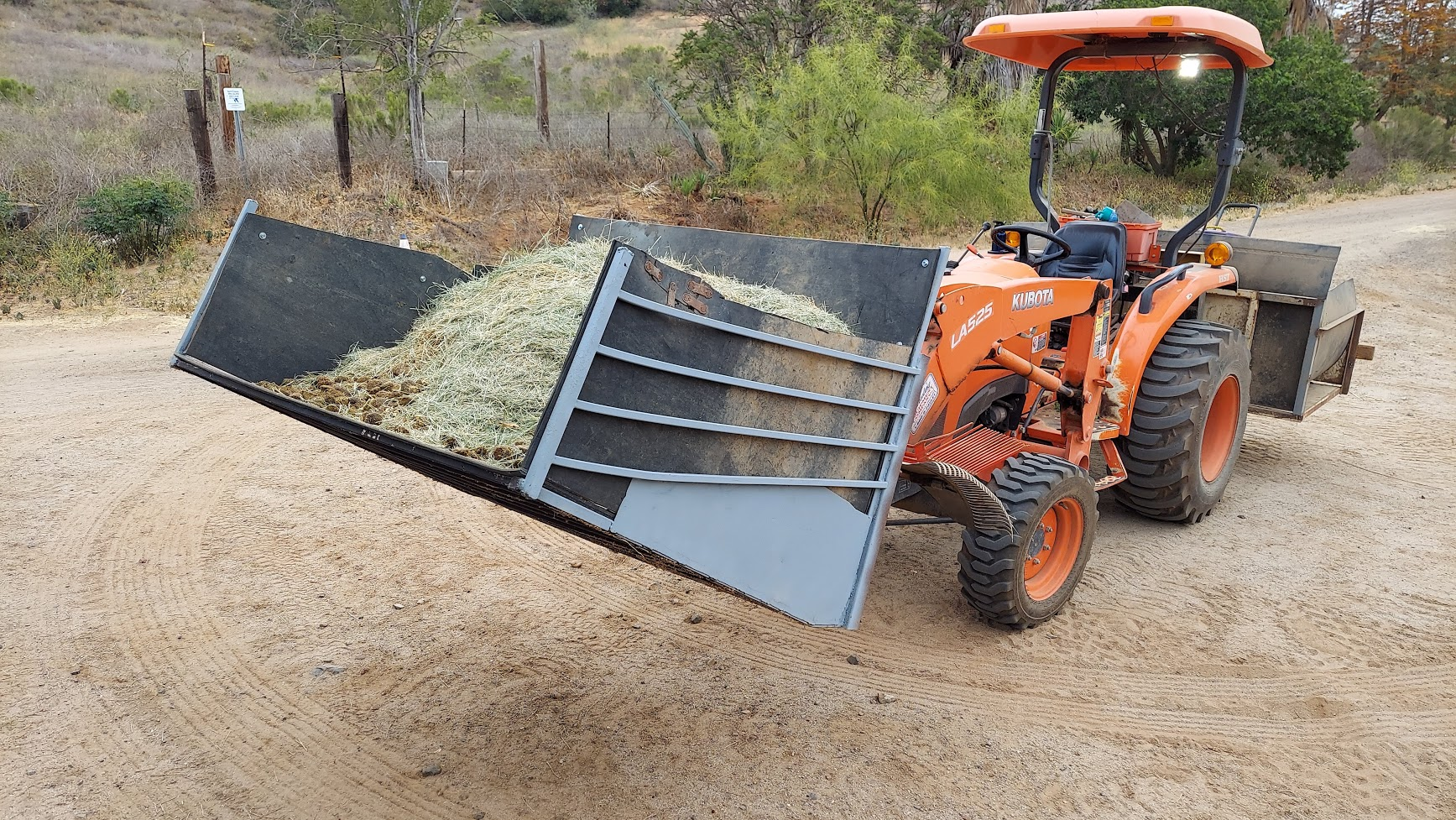

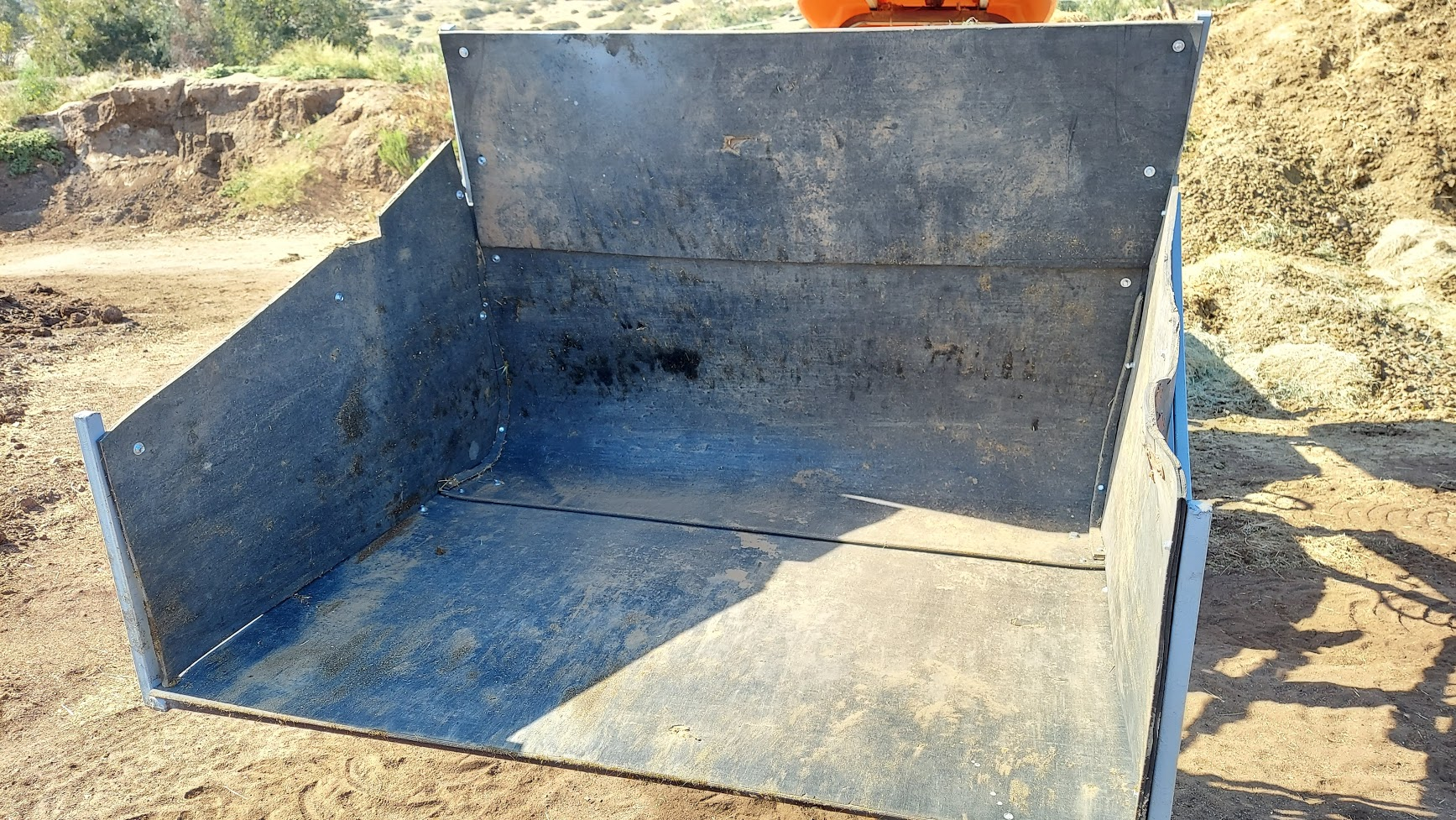

For mucking horse stalls we need to move about 5-6 yards of material from one end of the property to the other daily (about 1/2 a mile). I made an FEL basket/bucket clad with rubber conveyor belting remnants from a local quarry. We load via muck buckets or wheelbarrows so it doesnt have to withstand digging forces.

On the 3pt is a dumping box, based off of the TSC carry-all frame and scrap metal on hand. A board fits in across the back that is easily removed for dumping.
