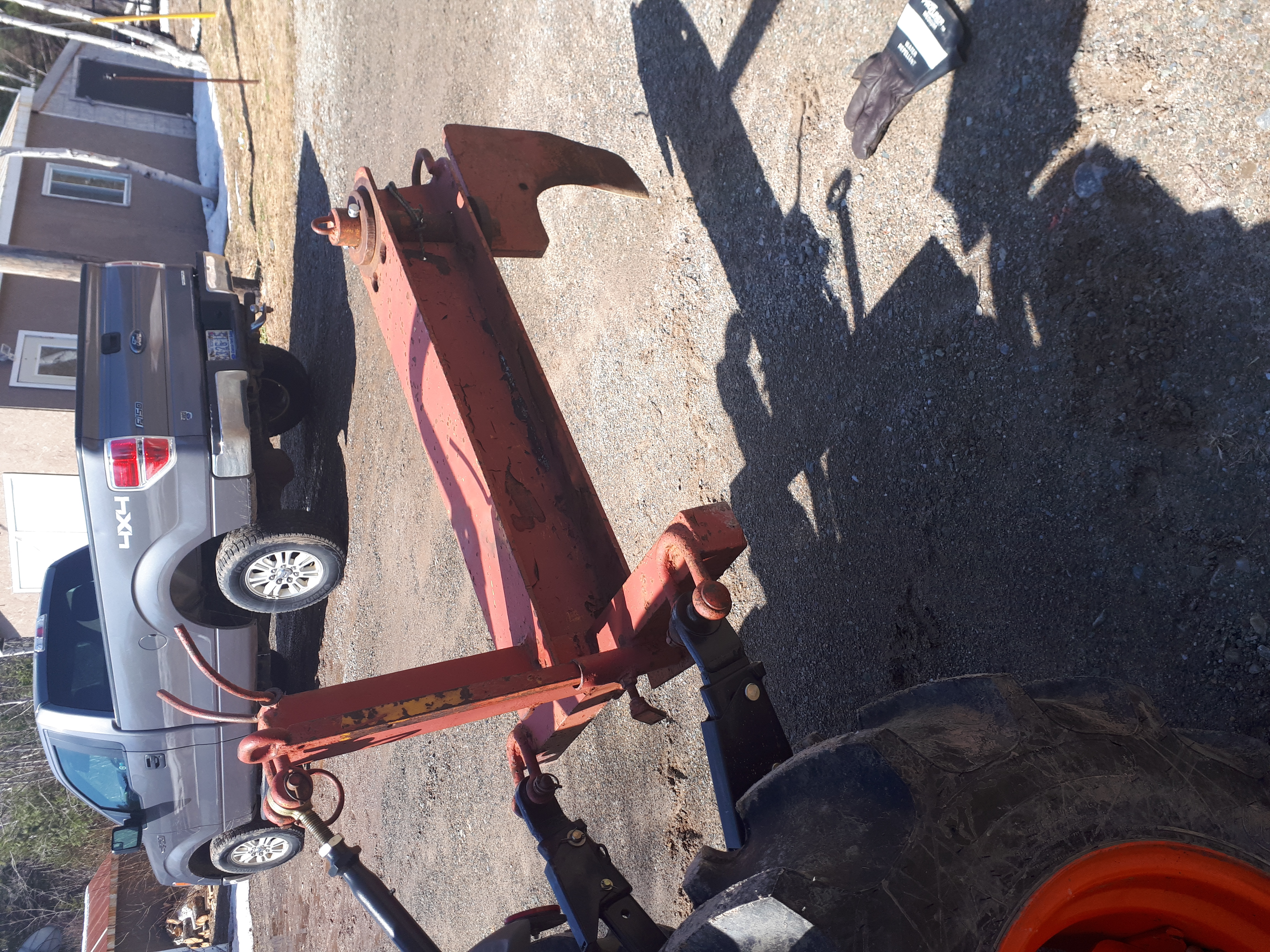

20190405_115628.jpg A friend let me borrow this for stump removal .
