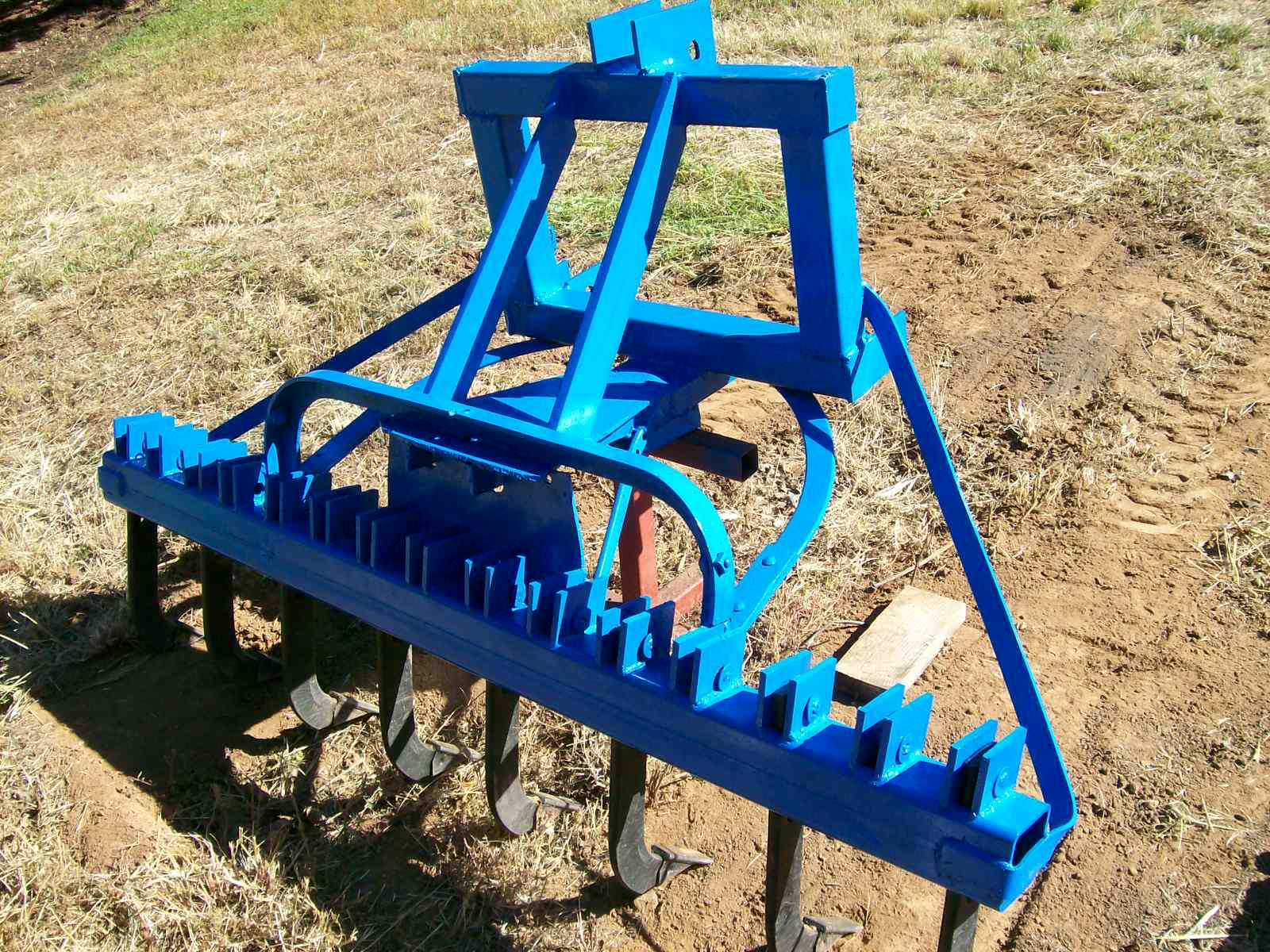

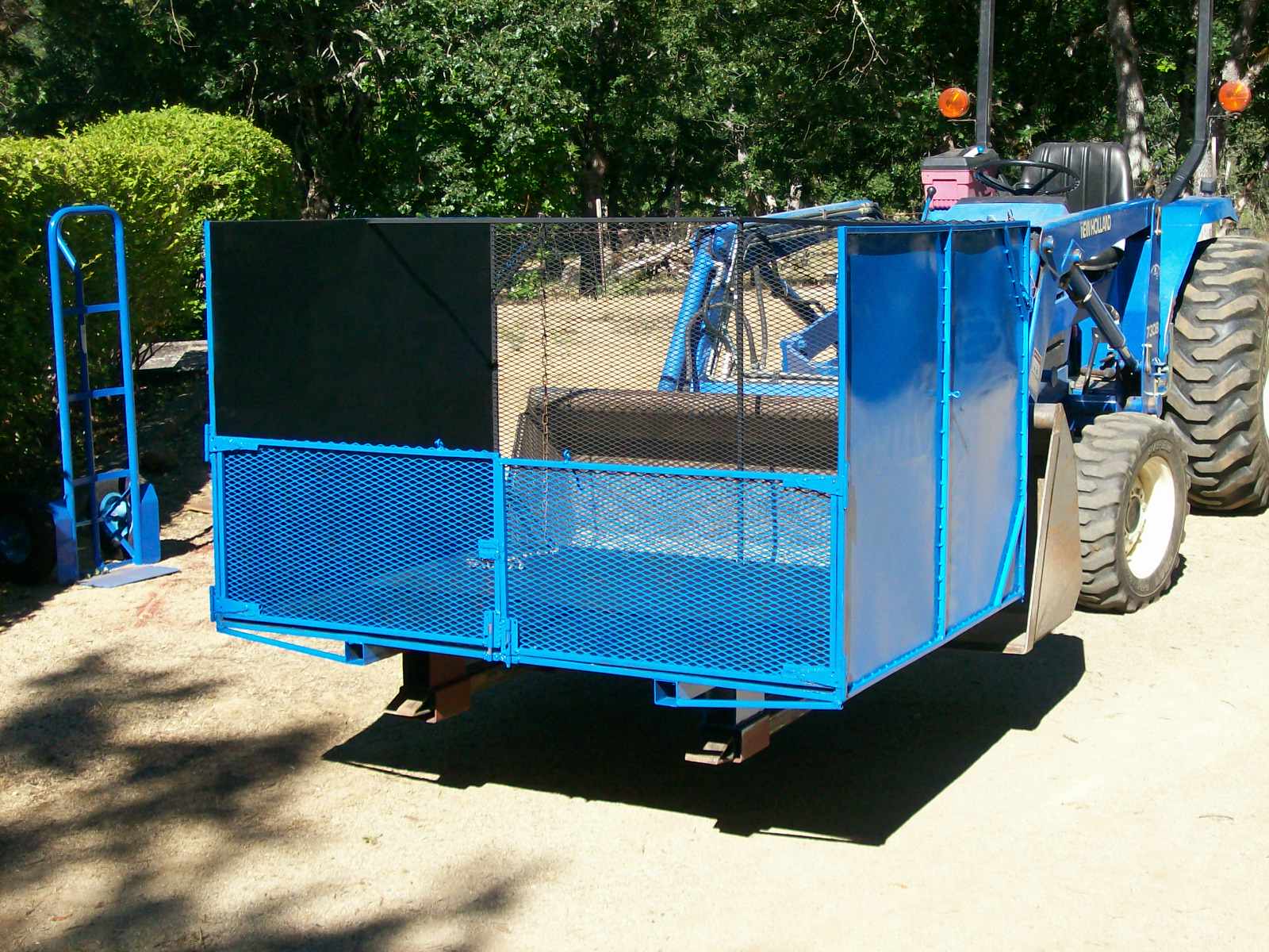

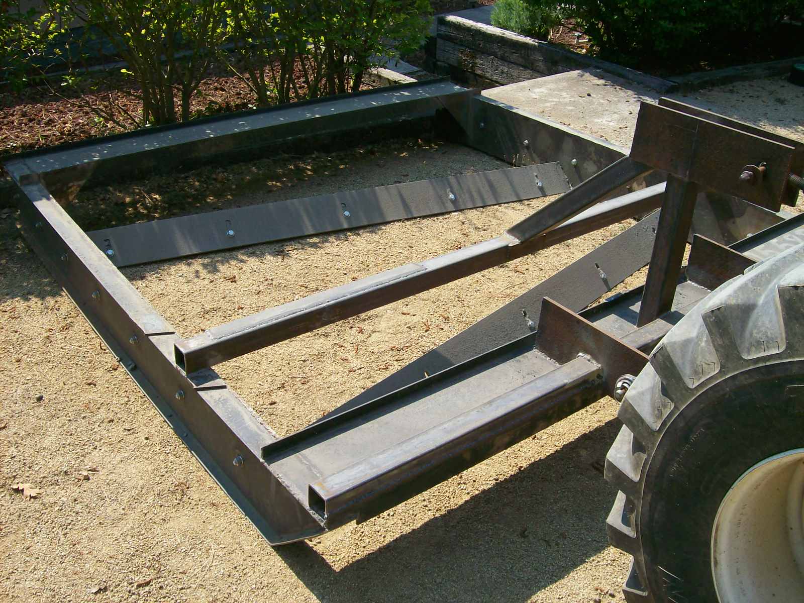

Here are a couple of things I either built from scratch or converted it into something I needed .
Land plane / road grader I built a couple of years ago . Added some additional bracing , modified the blade adjustment since these pictures were taken , but still no paint .
Leaf bucket I built a few years ago when the wooden one I had fell apart while dumping on the burn pile , thus it all burned !! :)
A 8 shank ripper that I made from a old single gang disk frame . What started out life as a 2 gang pull disk was converted to a single gang 3 point disk , then everything that was from the axle mounts on ward was cut off , braced , and the 4" x 4" x .25" tubing with shanks was added . Can pull it side hill or downhill with my TC30 , but uphill get's a little iffy when I try to go to maximum depth .

Those are so solidly made!
T

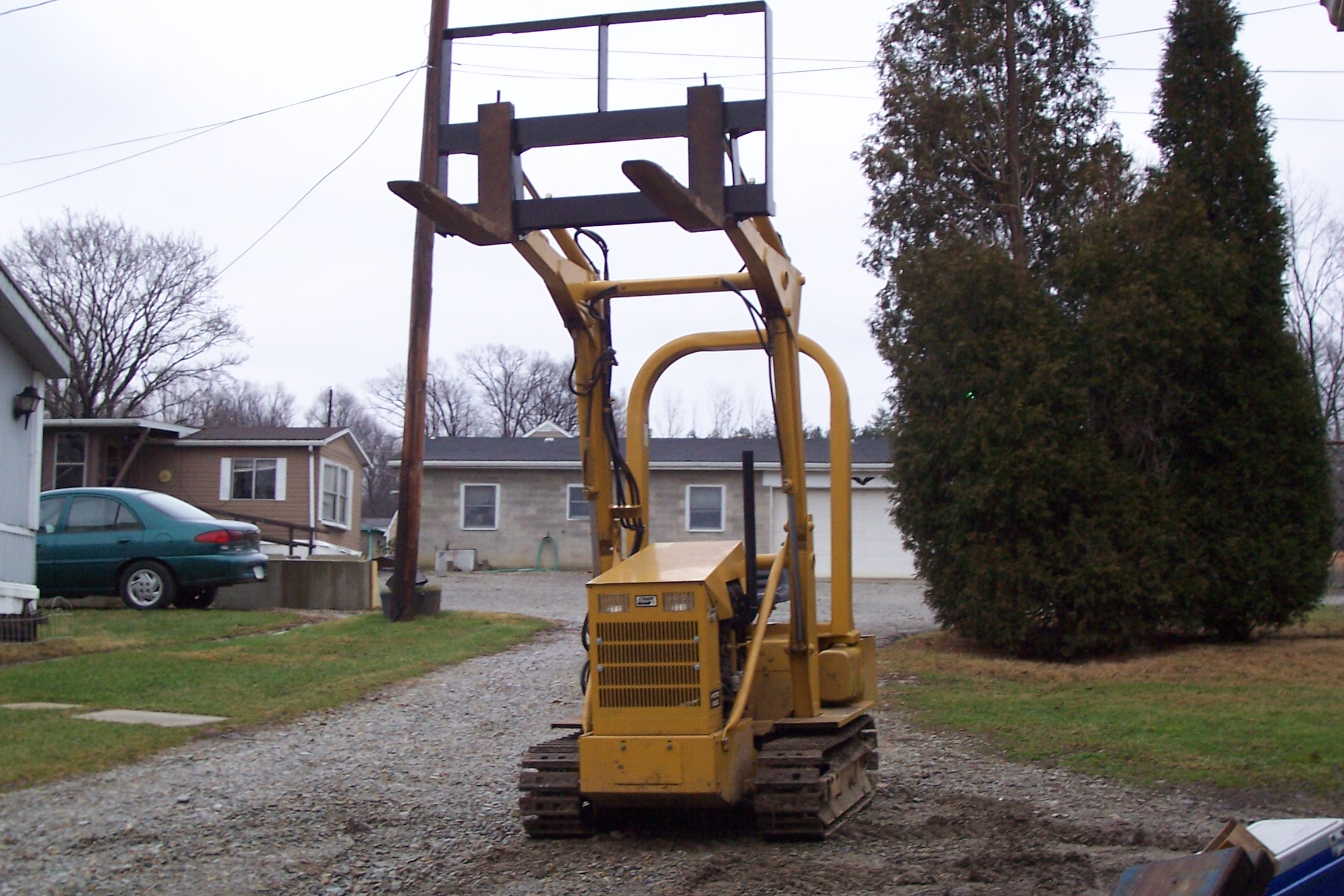

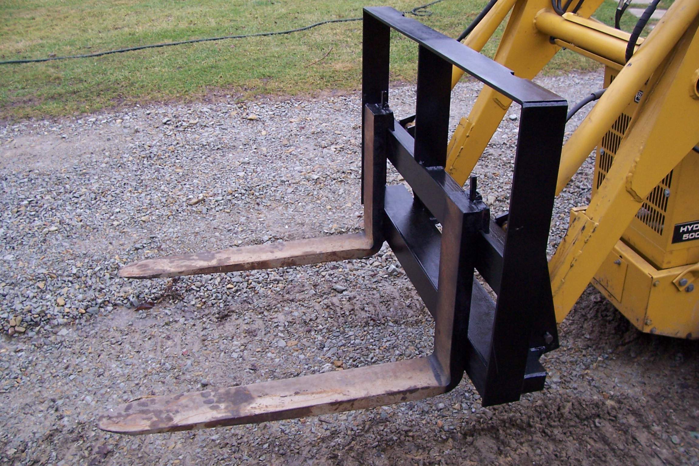

Hear is the forks I put together last month. I was fortunate to have found the actual forks in my local salvage yard. The rest is 3/8"x 4" flat stock. It makes handling logs easy.

I'd never be lucky enough to find forks in a salvage yard. Nice Find!!!! :D
/ Home-made attachments... #100
great find on the forks and mount. looks like it should be on there.
