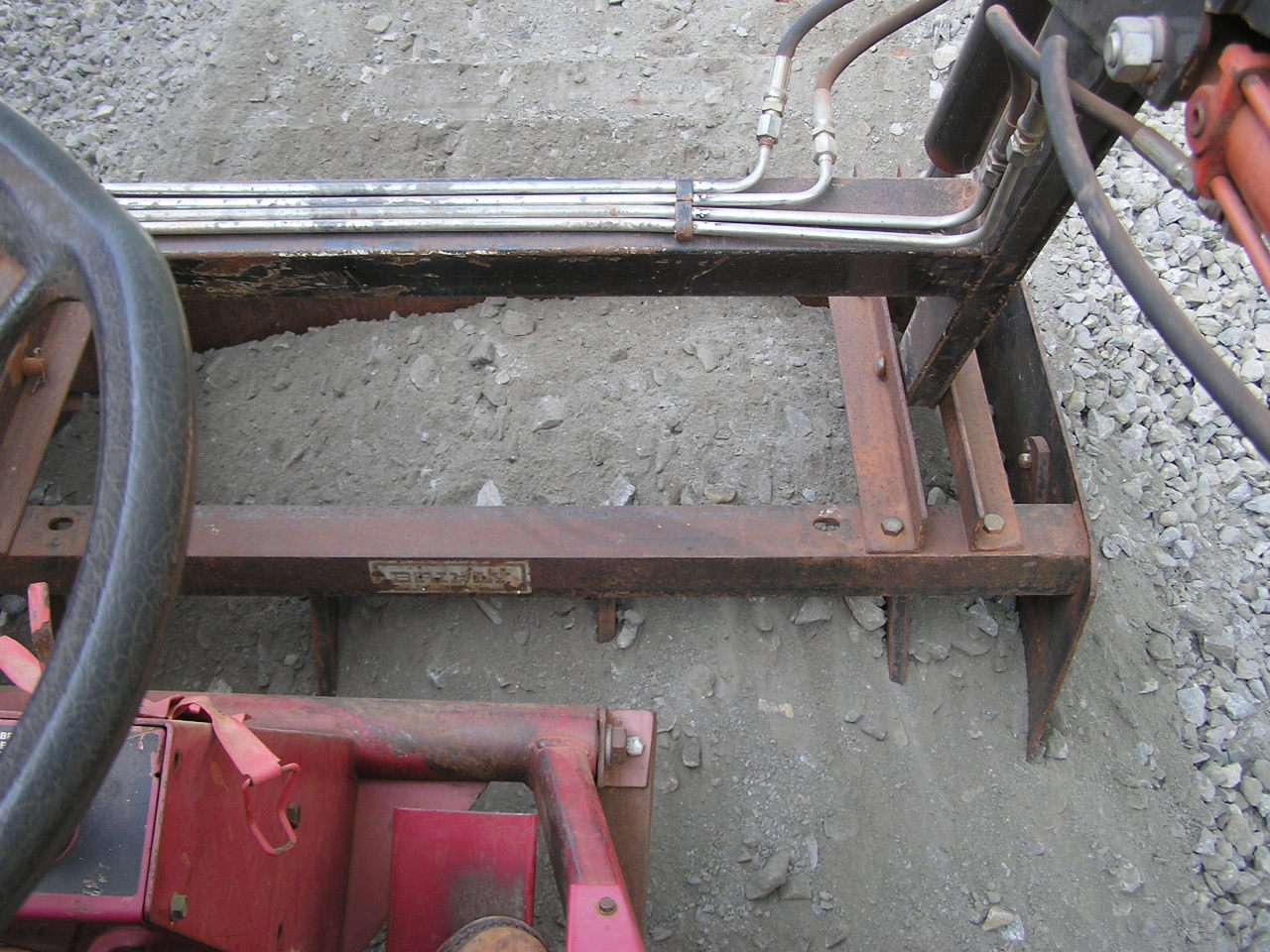

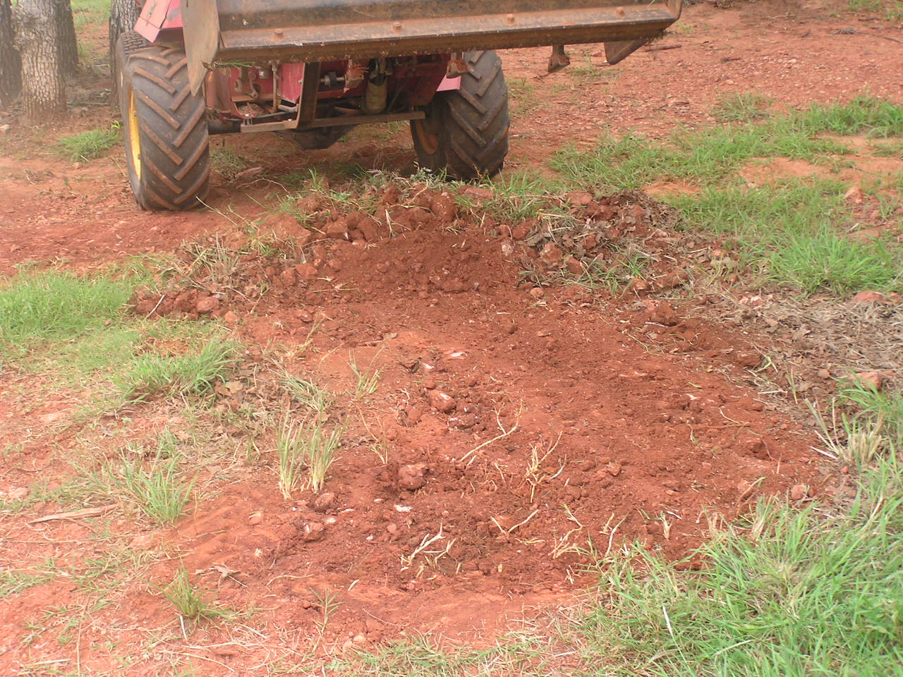

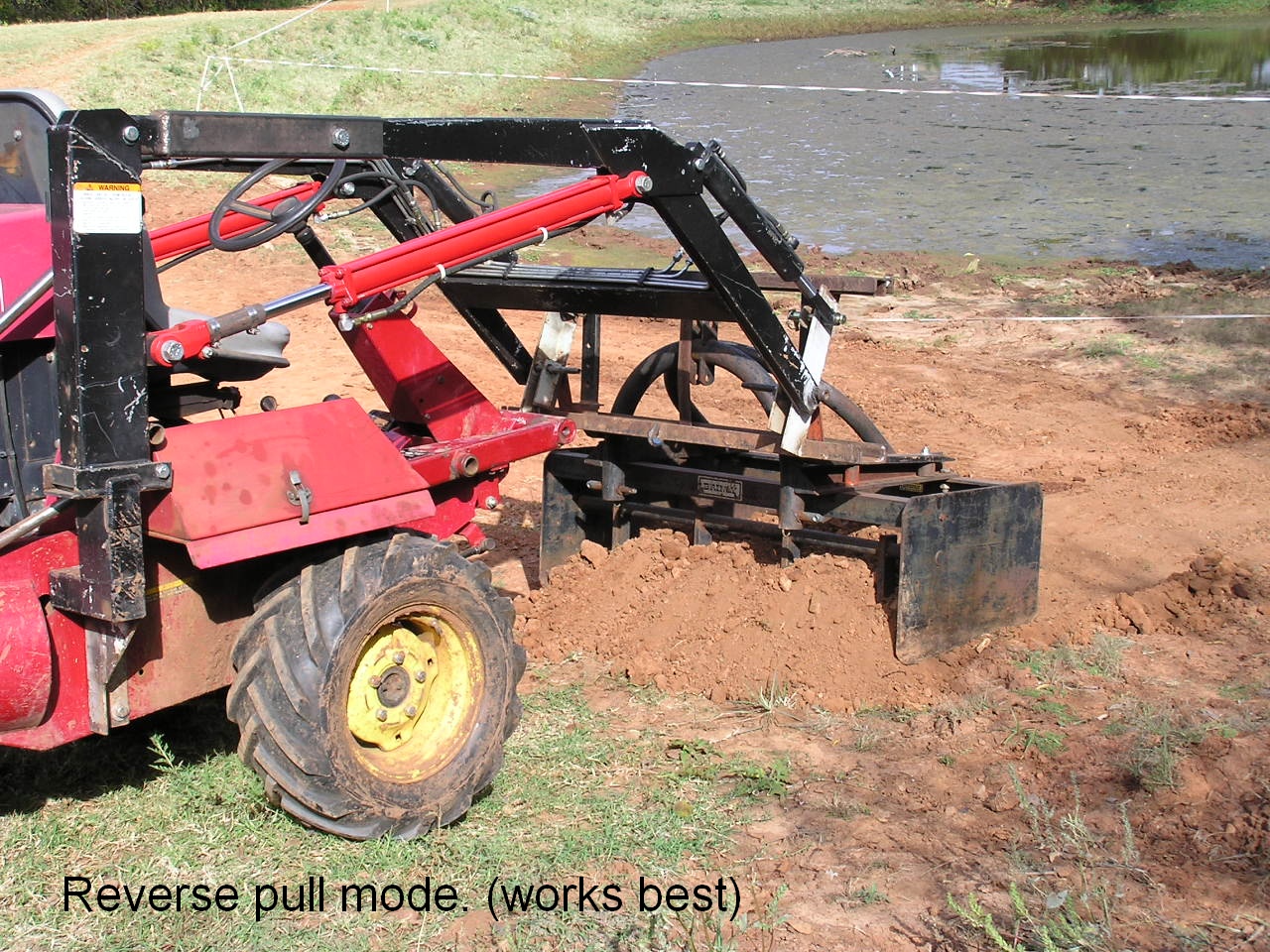

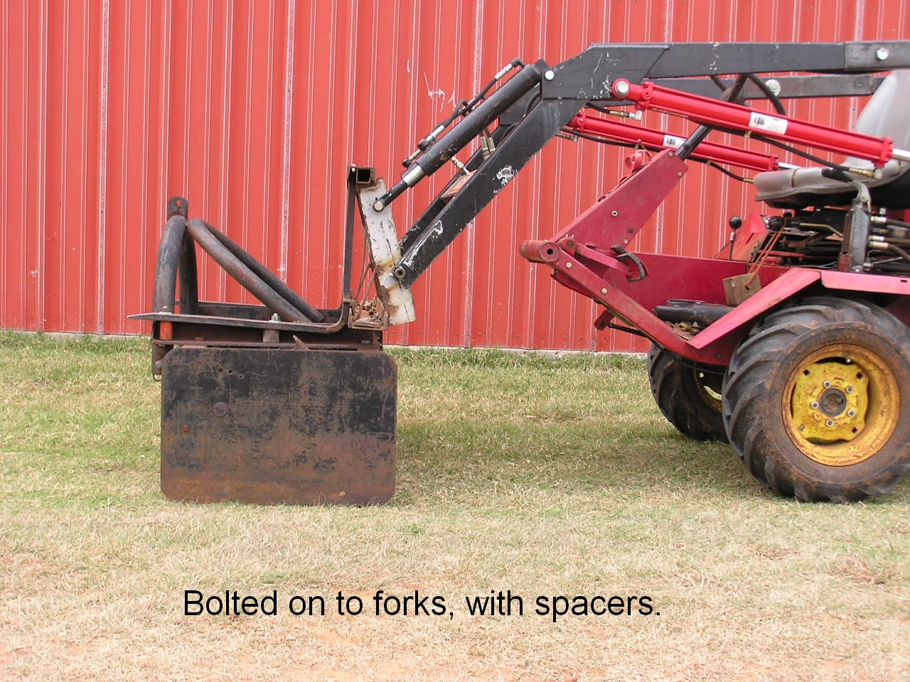

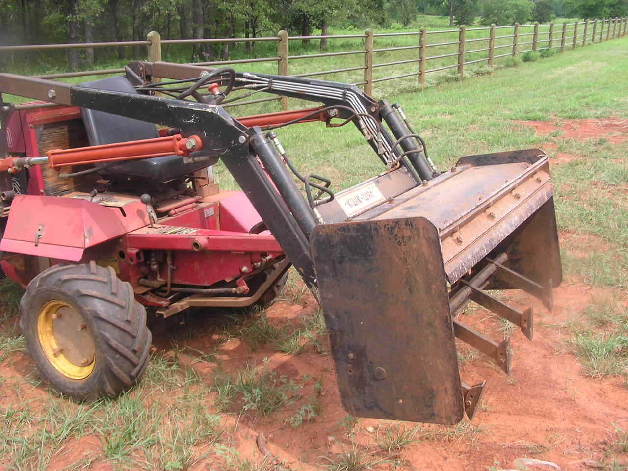

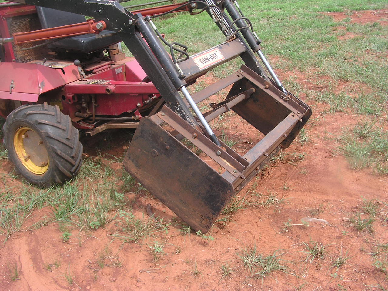

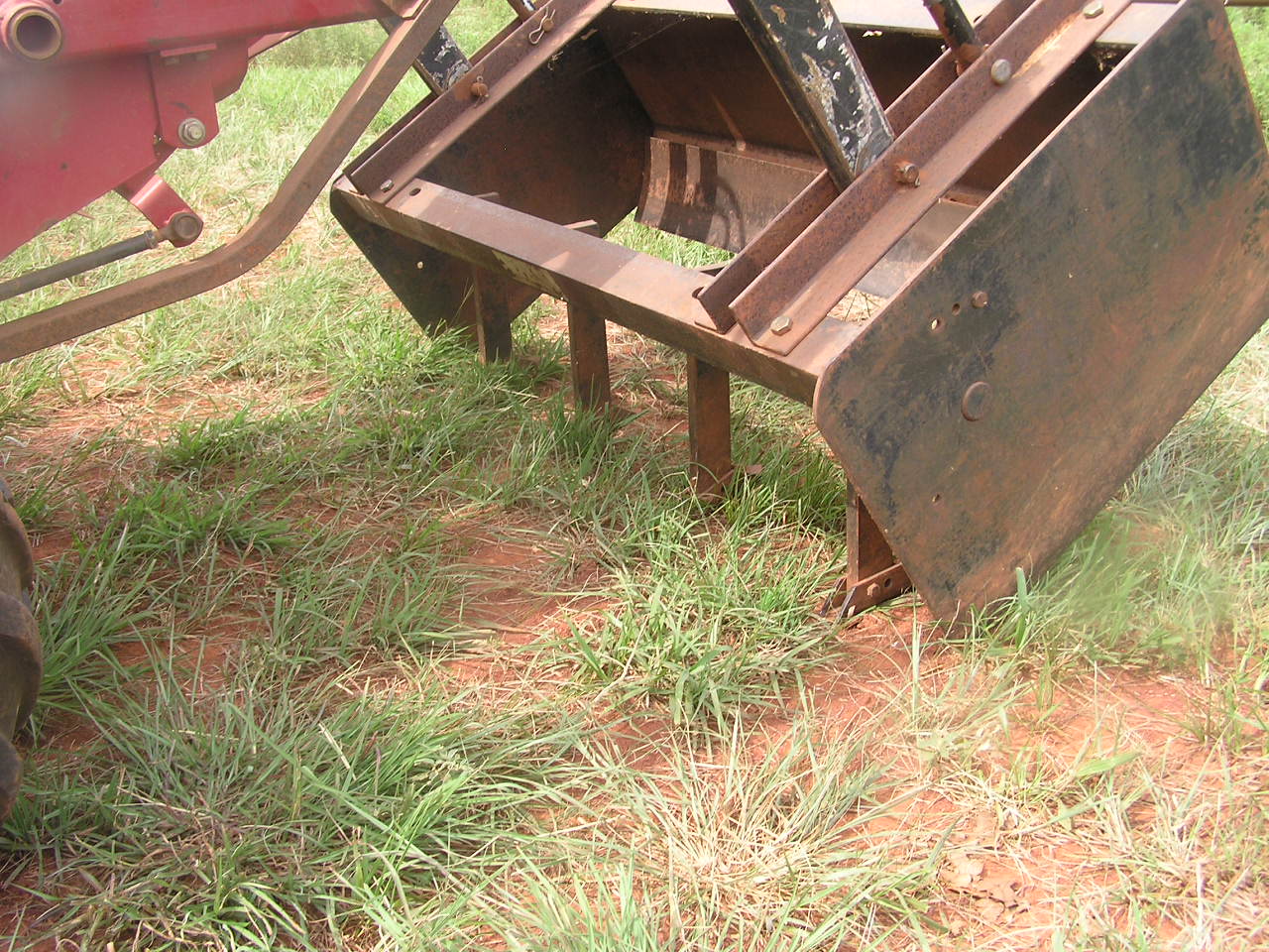

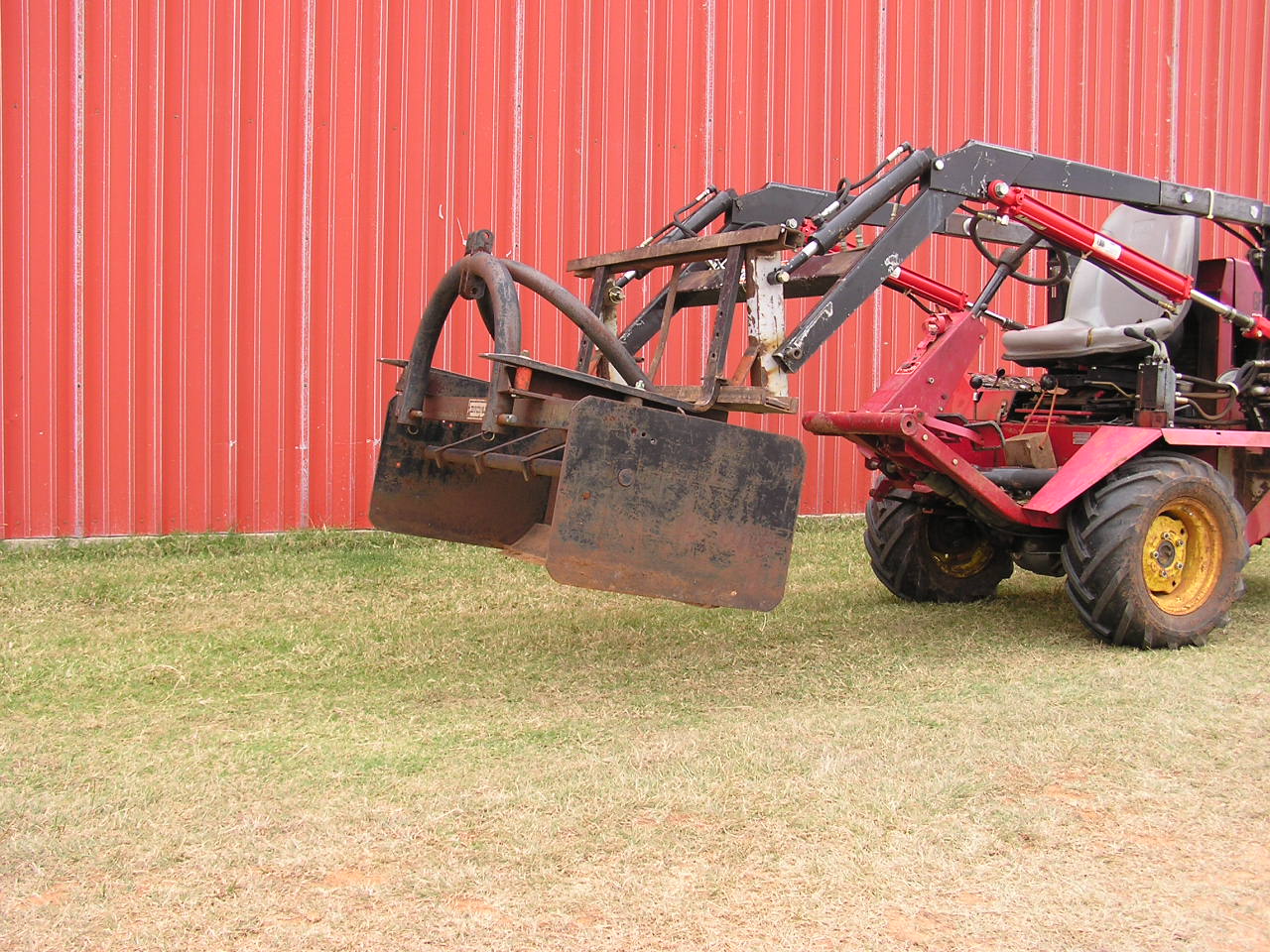

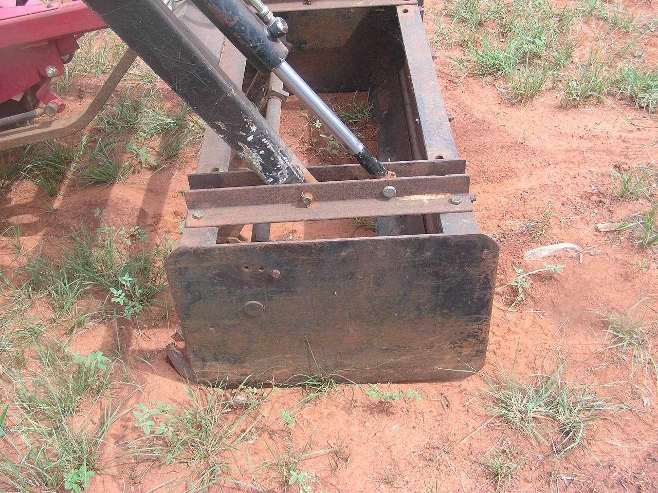

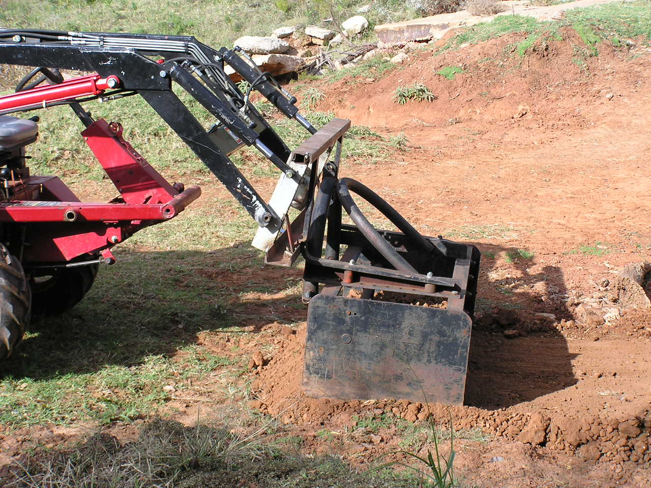

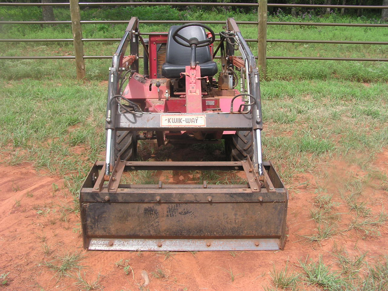

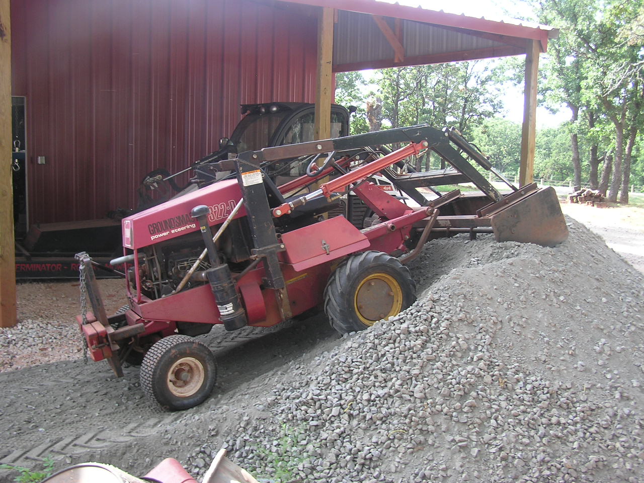

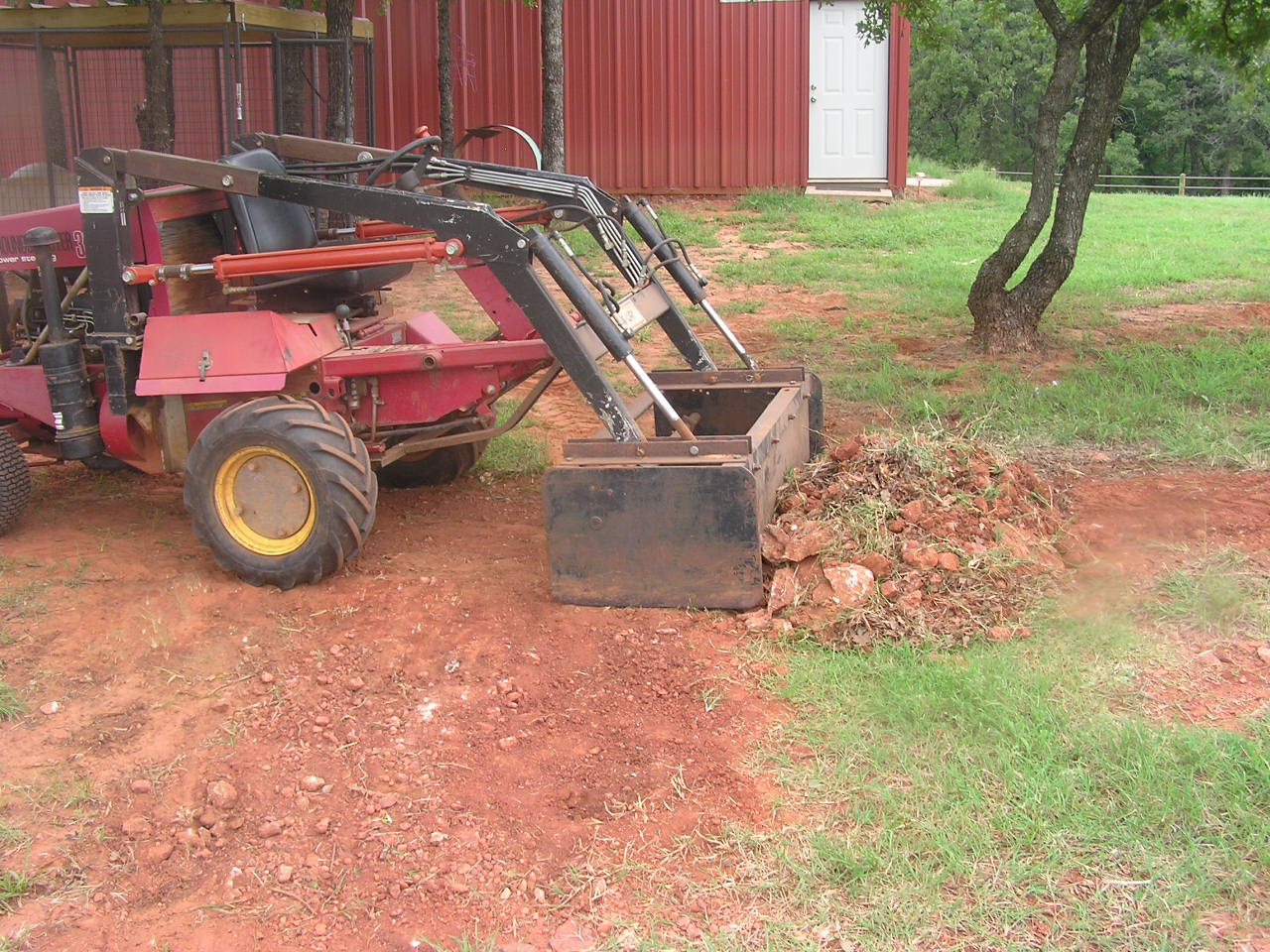

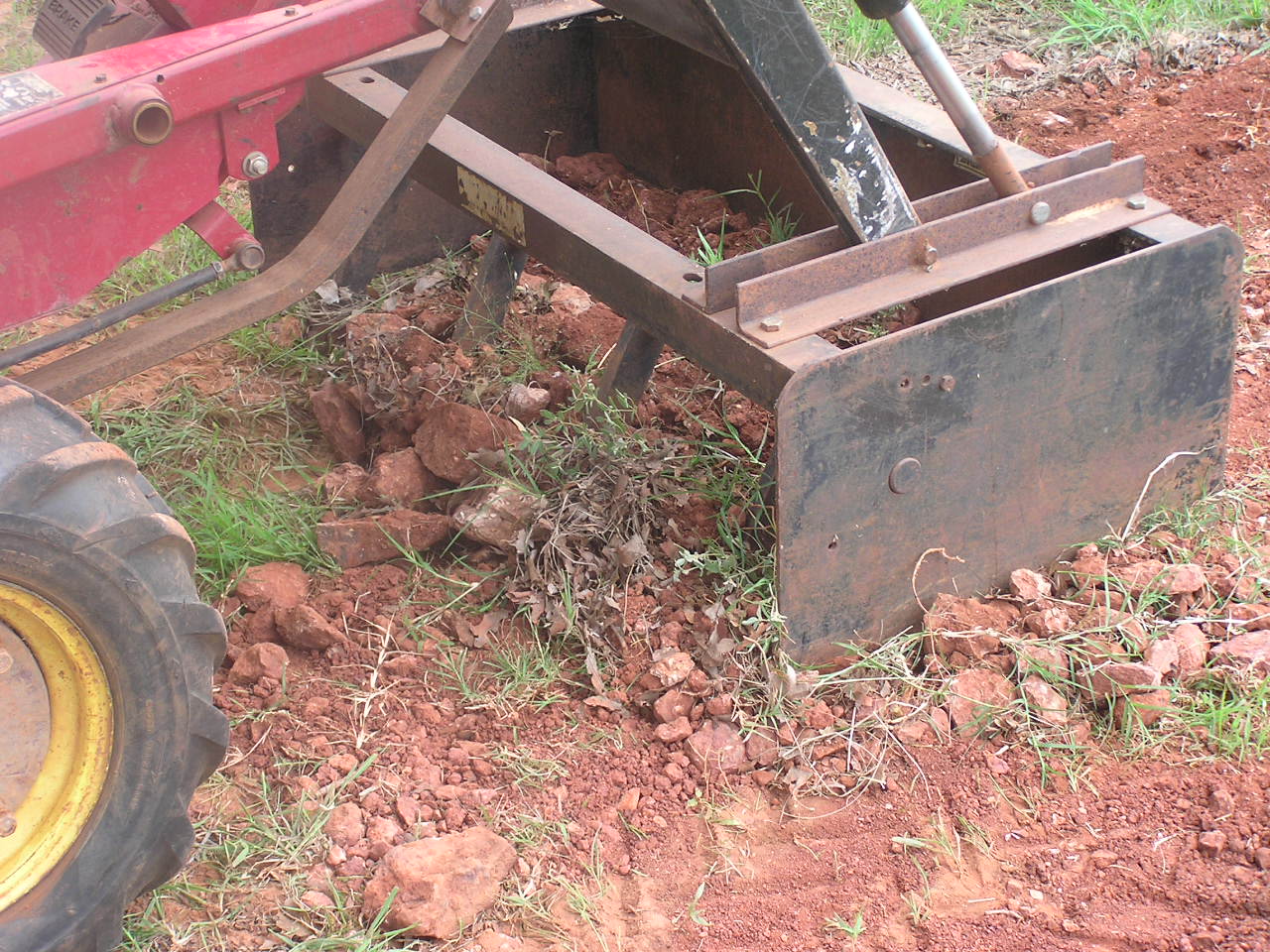

Didn't make the 4' Brinly boxblade, just modified it to fit on the front end loader.
The way it was back in 2005.
Removed the cat 0, 3 point frame, cut and drilled some angle iron and bolted it on.
Works way gooder! :D :thumbsup:
View attachment 356509 View attachment 356510 View attachment 356511 View attachment 356512
View attachment 356517 View attachment 356518 View attachment 356519 View attachment 356520
View attachment 356521 View attachment 356522 View attachment 356523 View attachment 356524
Looks handy.

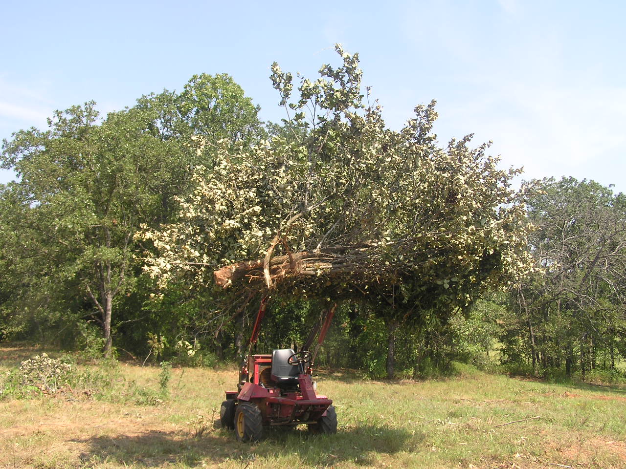

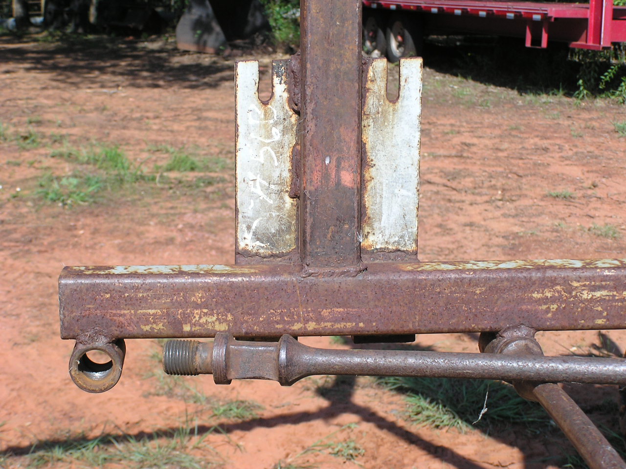

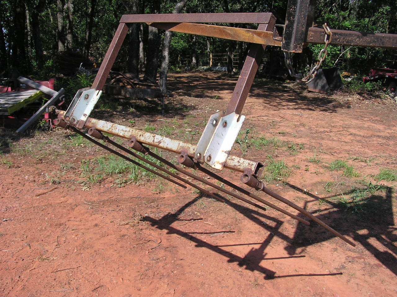

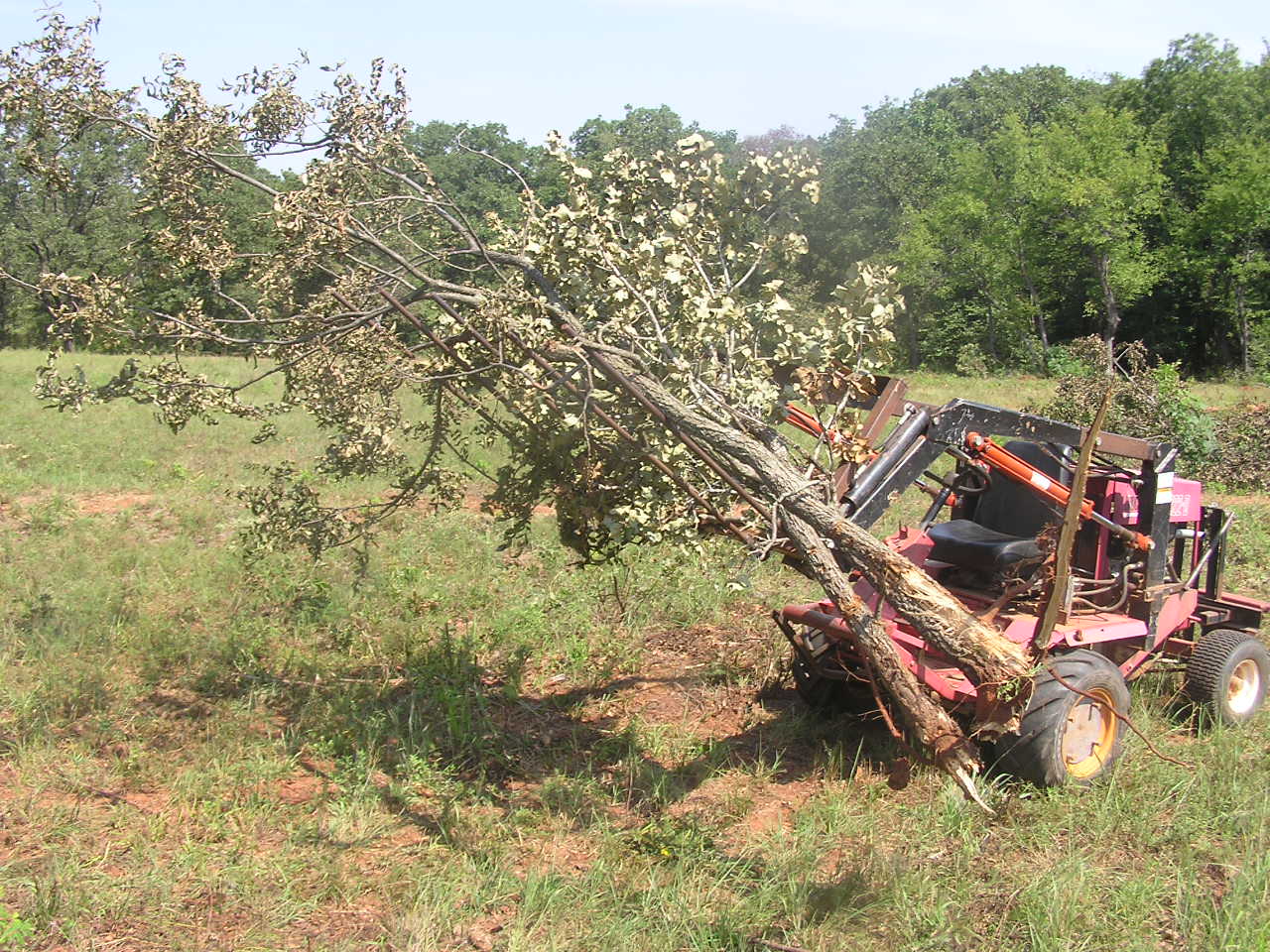

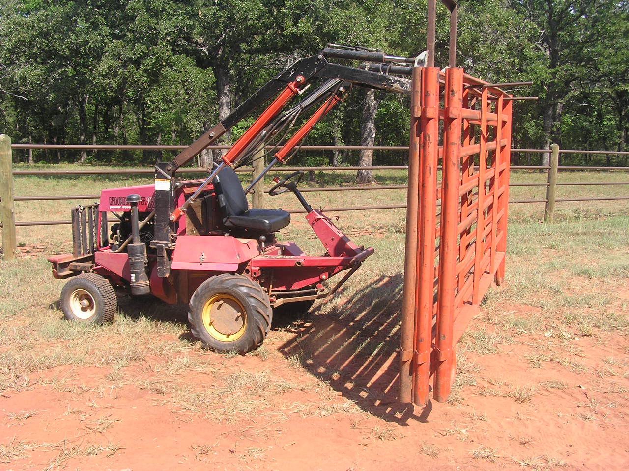

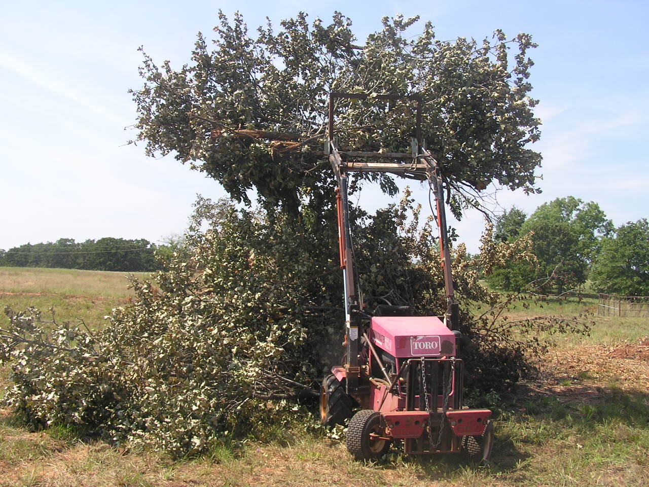

This is my brush mover on the TORO+Loader.
<img src="http://www.tractorbynet.com/forums/attachment.php?attachmentid=355862"/> <img src="http://www.tractorbynet.com/forums/attachment.php?attachmentid=355863"/> <img src="http://www.tractorbynet.com/forums/attachment.php?attachmentid=355864"/> <img src="http://www.tractorbynet.com/forums/attachment.php?attachmentid=355865"/>
<img src="http://www.tractorbynet.com/forums/attachment.php?attachmentid=355857"/> <img src="http://www.tractorbynet.com/forums/attachment.php?attachmentid=355858"/> <img src="http://www.tractorbynet.com/forums/attachment.php?attachmentid=355859"/> <img src="http://www.tractorbynet.com/forums/attachment.php?attachmentid=355860"/>

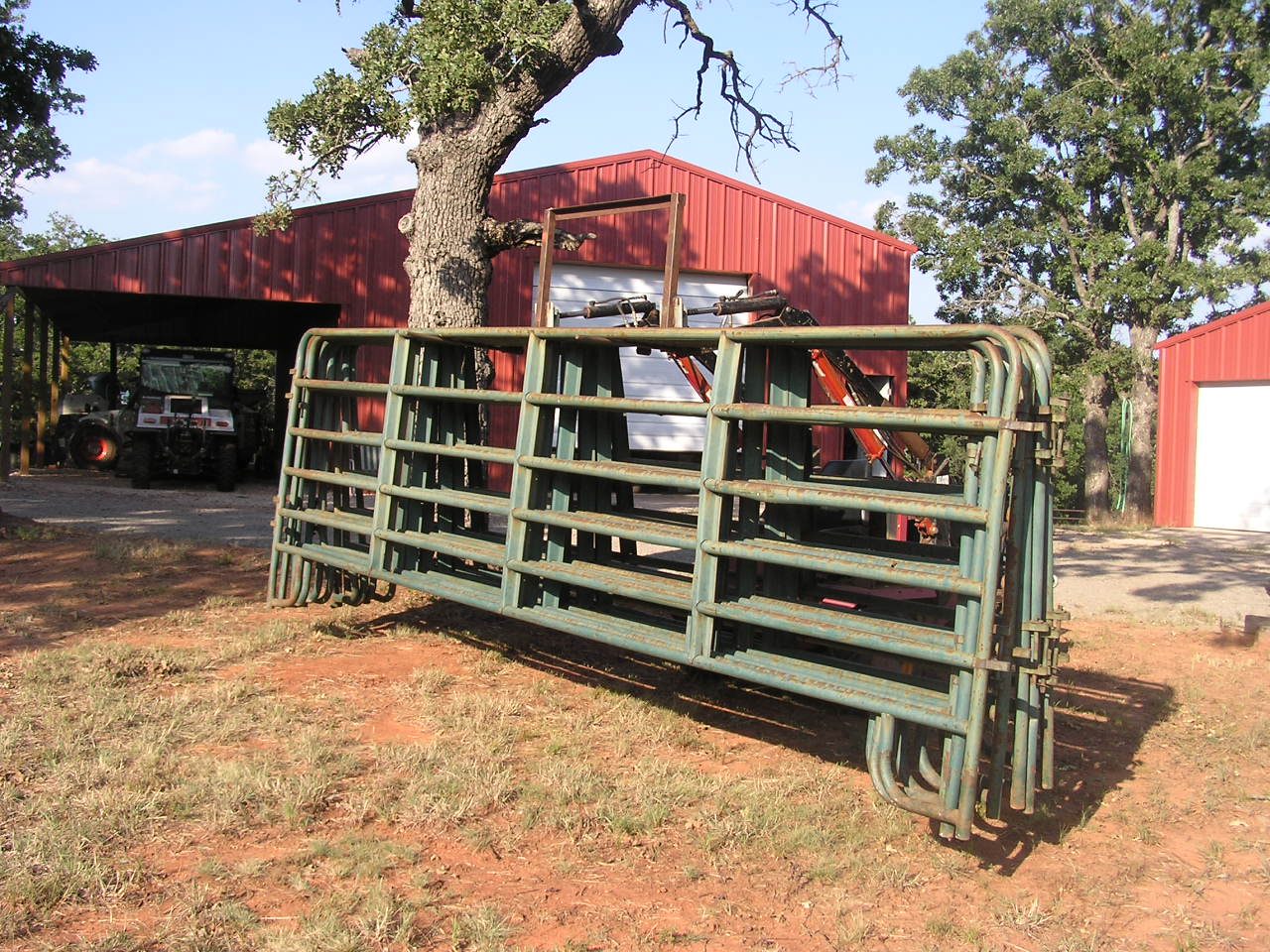

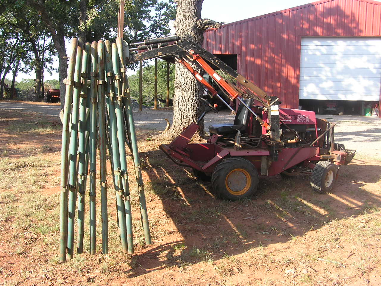

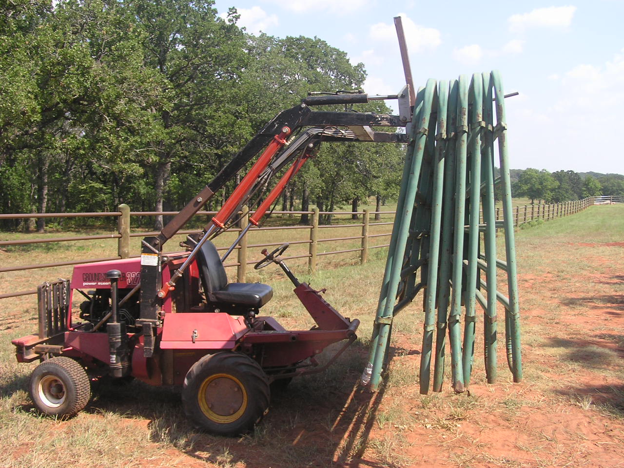

It also moves cattle panels, with the short rods.
<img src="http://www.tractorbynet.com/forums/attachment.php?attachmentid=355875"/> <img src="http://www.tractorbynet.com/forums/attachment.php?attachmentid=355876"/> <img src="http://www.tractorbynet.com/forums/attachment.php?attachmentid=355877"/> <img src="http://www.tractorbynet.com/forums/attachment.php?attachmentid=355878"/>

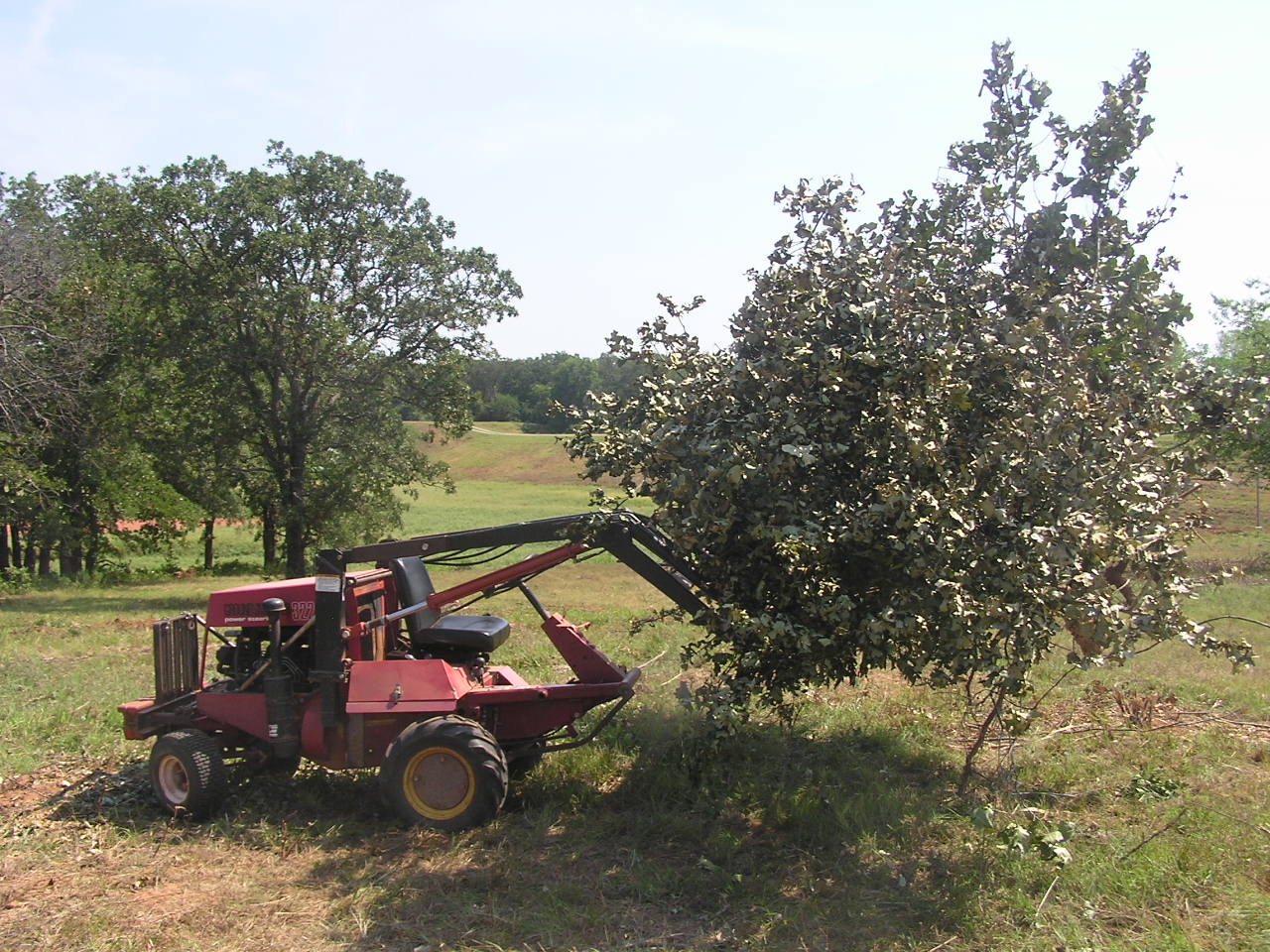

Yep, very handy. Here are some pictures from 5 months ago.
<img src="http://www.tractorbynet.com/forums/attachment.php?attachmentid=356551"/> <img src="http://www.tractorbynet.com/forums/attachment.php?attachmentid=356552"/> <img src="http://www.tractorbynet.com/forums/attachment.php?attachmentid=356553"/> <img src="http://www.tractorbynet.com/forums/attachment.php?attachmentid=356554"/>
sure would like to get my father and you together.he has aforklift that he built for his toro.

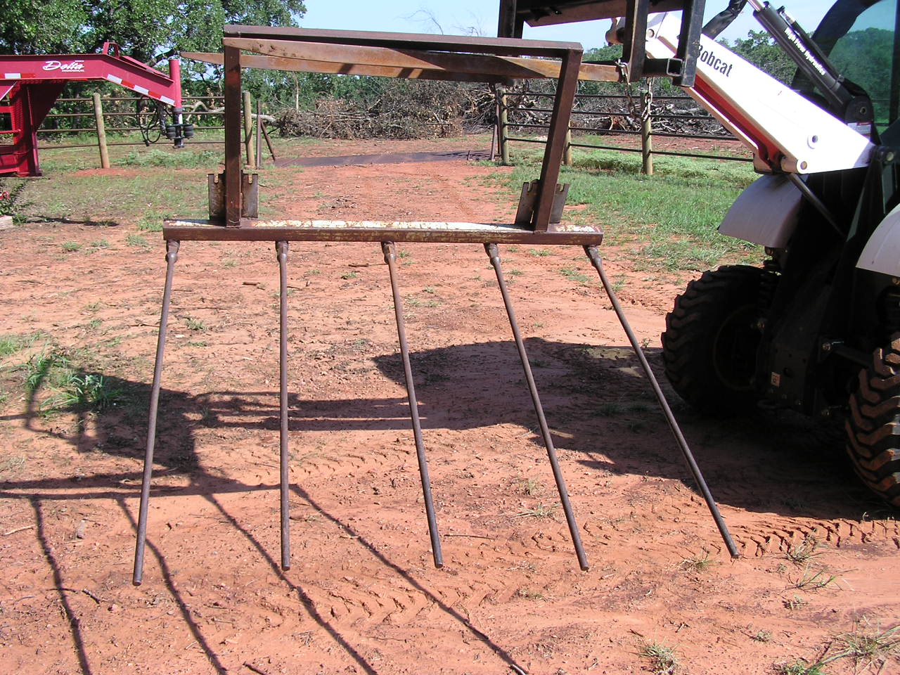

I made a brushfork, then later, made five quick-release stick-rakes that pin onto the fork.
Being on the front I can stuff it far under trees and pull out a big pile of sticks.
Once I get a good pile going I remove the rakes and pick up the pile with the brushfork and dump it on the fire.

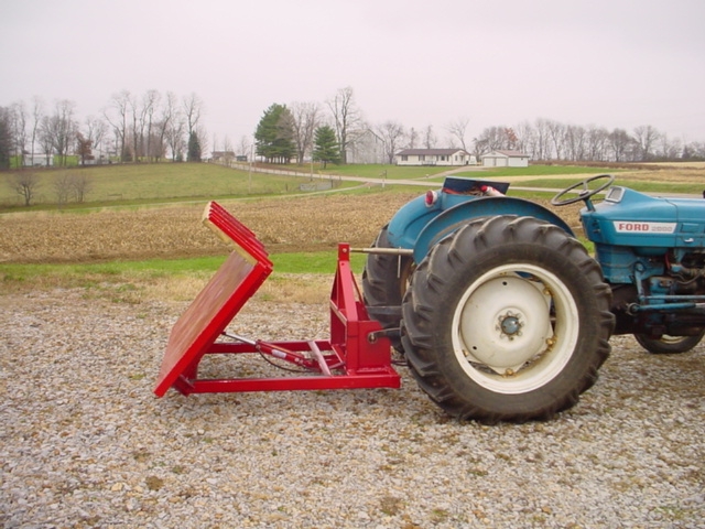

I put it on as an experiment to make it act as a box blade. There are a couple stop pins that the tail gate hits against. I can hang it behind the stops so when I back up the tailgate acts as a blade to push stuff and it is heavy enough so that it will also hold light material like sod in the box when grading. Makes sod on road edges and in the road easy to deal with. If I swing the gate up and over so it hangs inside the stops I can collect material in the box and move it just like (almost) a box blade. I find it useful. For just grading a gravel road w/o sod in it it is just there for decoration as it adds little.
Hi Gordon,
Thanks for the follow up and pictures, I understand now.
I'm hoping to weld up a landplane or grader somewhat like yours once I get a little more practice with smaller pieces, but wasn't sure if there was a reason to add a gate like that.
After your explanation, I think I probably wouldn't since we have a decent (Gannon R/O) boxblade for the purpose of moving materials. In retrospect is there anything you would have done differently in making/ designing your grader?
Would you ever have wanted to add scarifiers to break up packed areas, or do the cutting blades do that well enough?
Thanks again,
Thomas

Scarifiers would probably be a good addition especially if the unit you make is on the light side.
My grader is 5' wide and weighs about 575 lbs including the cutting edges. If it was 200 to 300 lbs heavier it would be better. If the road is really packed hard and is bone dry (not really a good time to grade) and I am having trouble getting a deep cut I roll the grader forward a little with the top link so that all the weight is just on the front blade doubling its cutting pressure and make a couple passes that way to loosen the surface then drop it back so the skids are flat to finish. If it was heavy enough I wouldn't have to do that. However it isn't an issue if you can pick your days and grade after a rain.

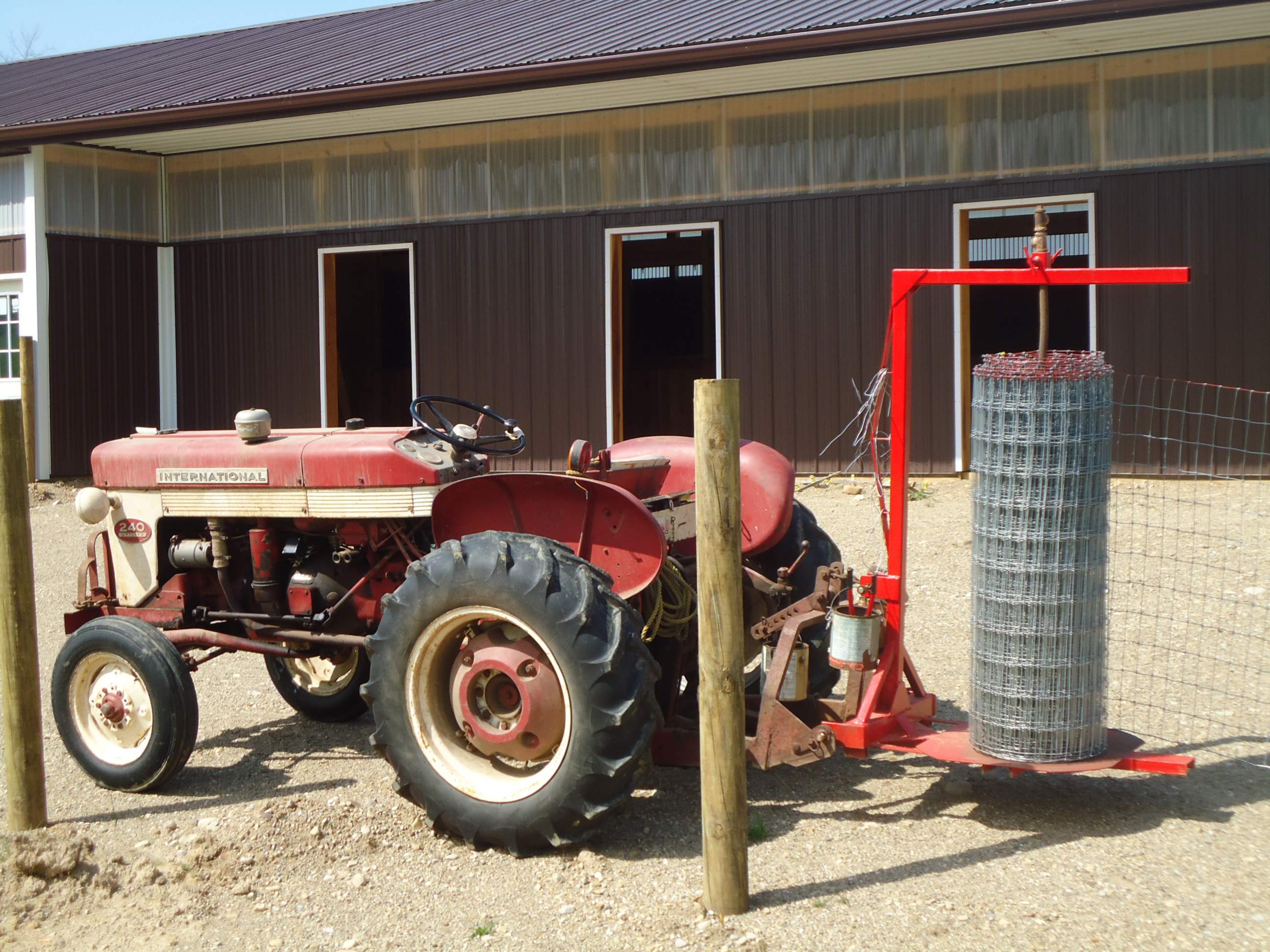

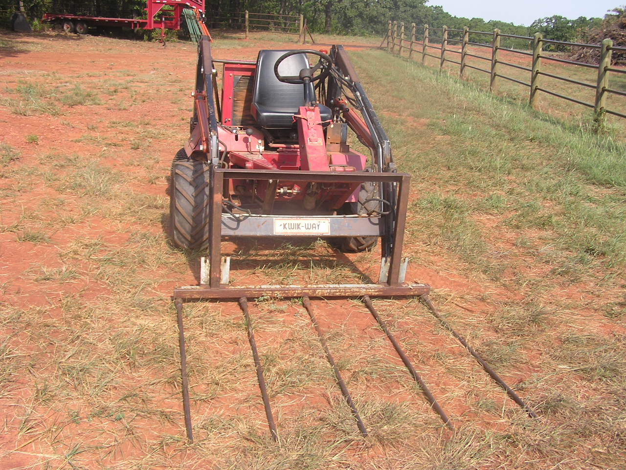

I've posted these in a few other threads, but guess one more time won't hurt. First is my fence unroller. Can't stretch with it, but I use a come-a-long for that anyway... Most material came out of the scrap pile, but do have $17.50 in new steel that I used about half of it to build this + 6 hrs. work in the shop on a rainy day. Paint was left from another project + another hour or so to paint & clean up the gun.
The other is my dump carry-all. A winter time project about 10 years ago. Pretty handy for gathering rocks out of the pasture, tree limbs down, some dirt or mulch to be hauled, cleaning stalls, and adding to the compost pile, or cleaning out the road ditch, and dumping the gravel somewhere. Don't mind shoveling something on, just hate to shovel it back off...
One of the handiest things I've ever built..!!
View attachment 356857View attachment 356858
Nice work! :thumbsup:

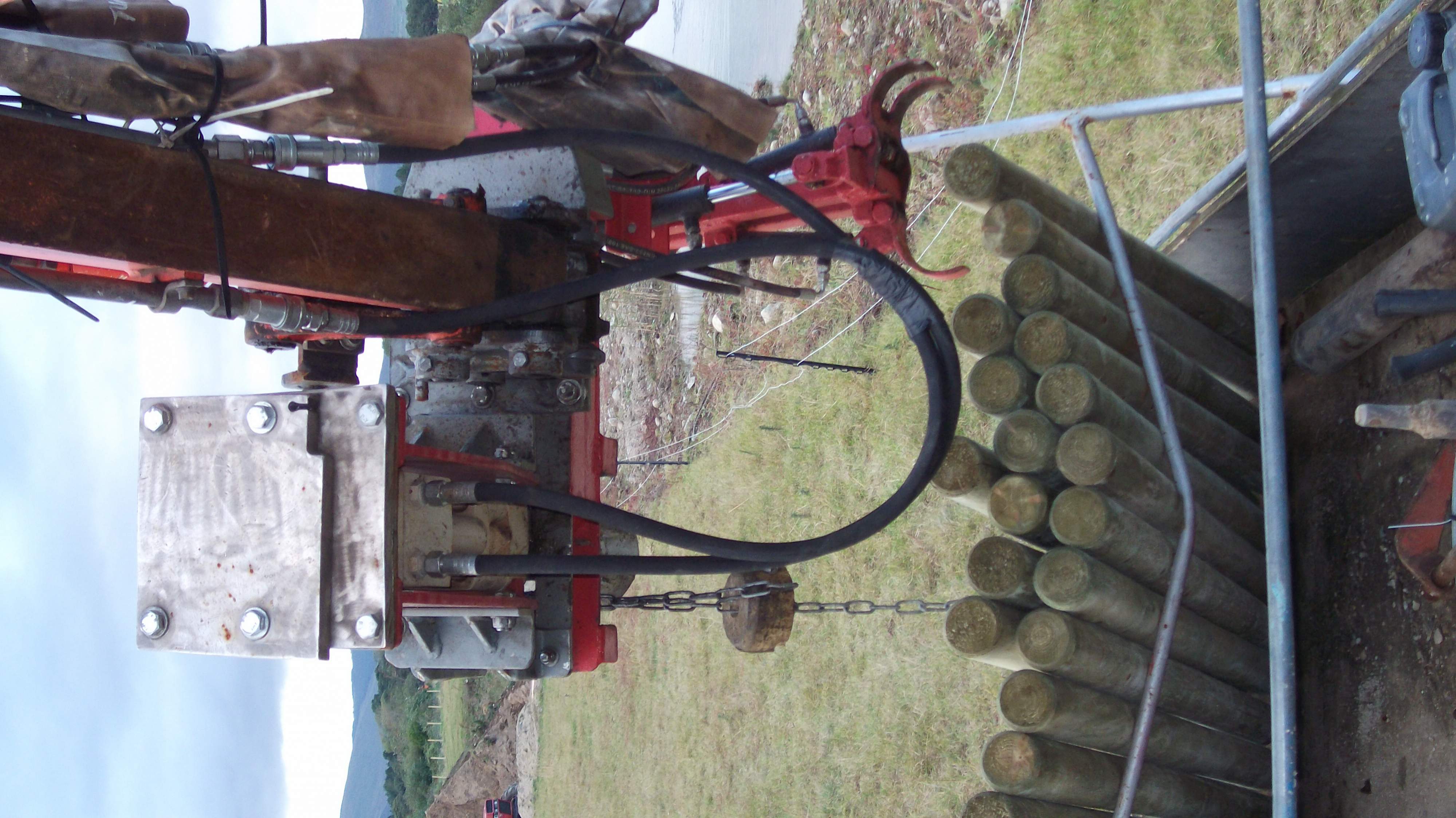

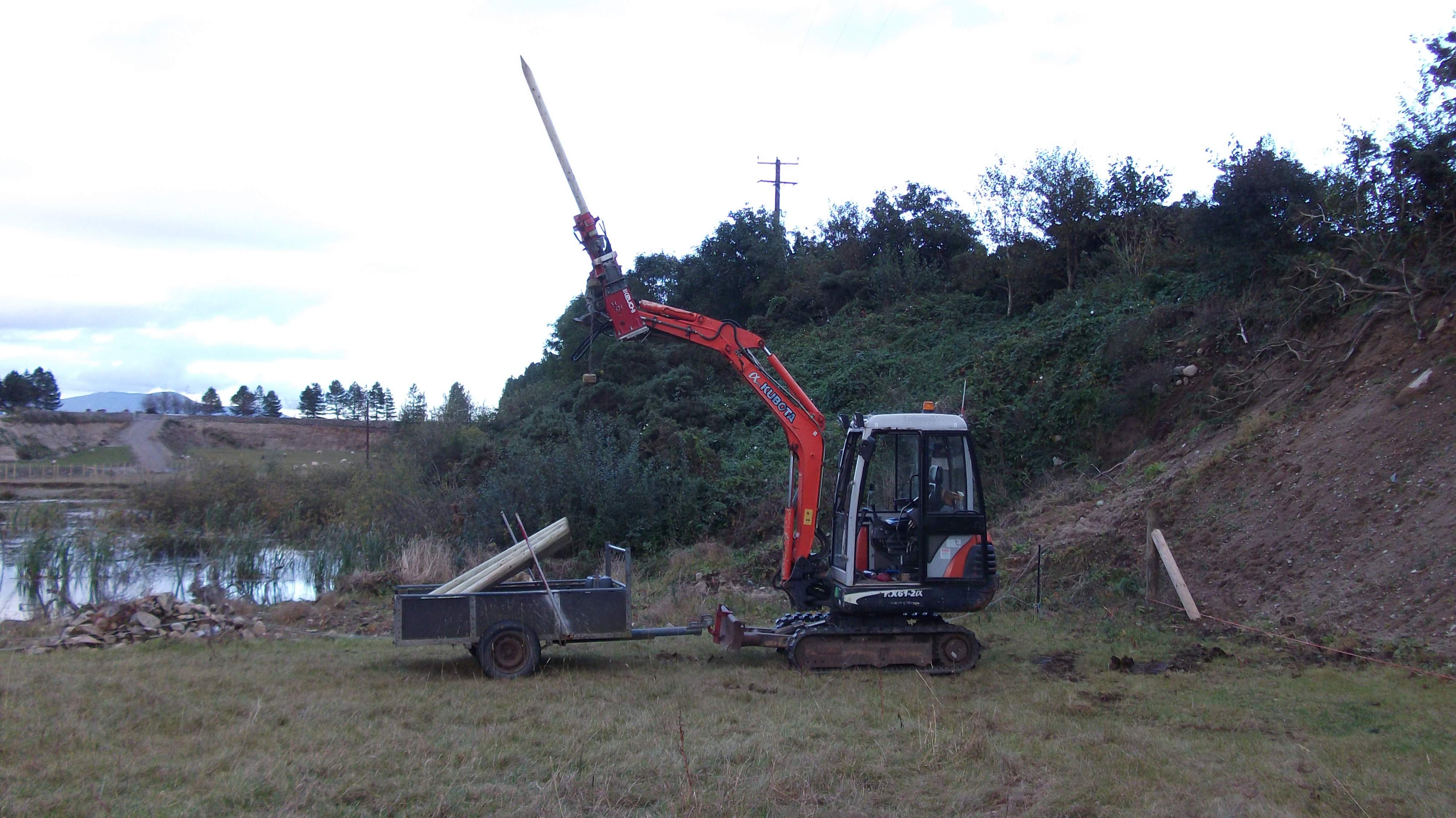

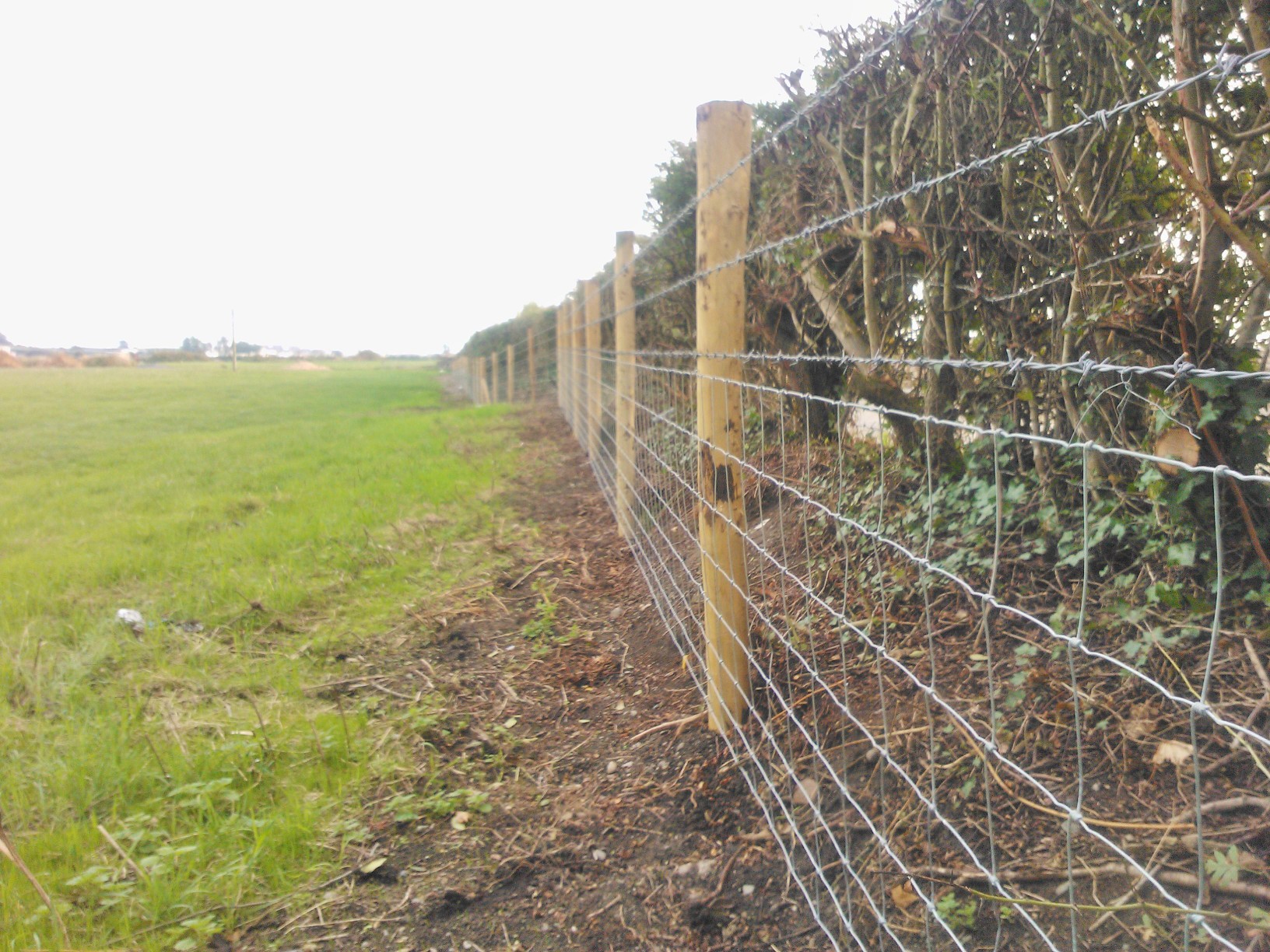

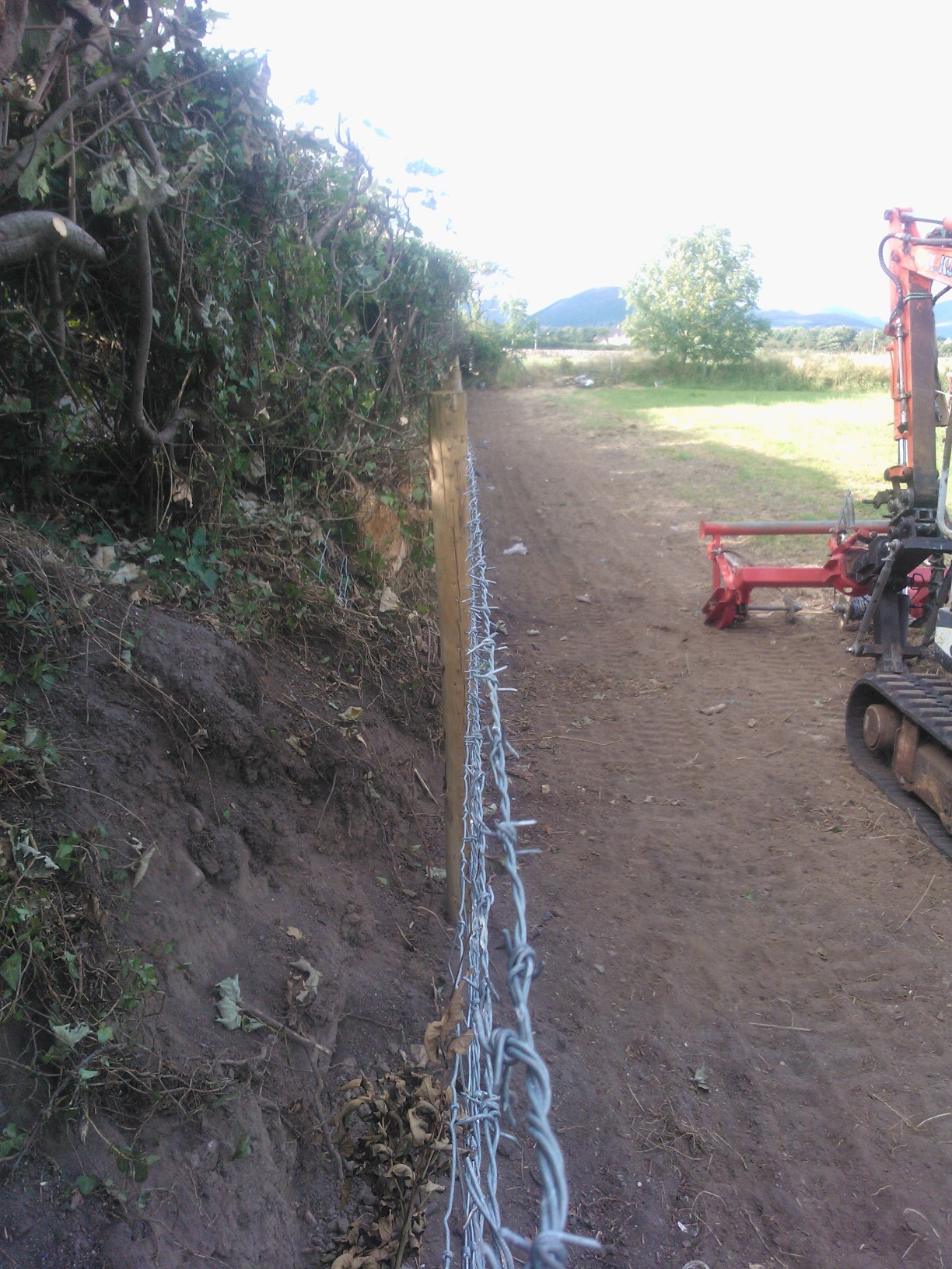

hello,live in n.ireland,I've made several things that might be of interest to u ,not copies, just my own ideas, the 1 i have posted is a couple of attachments for a mini digger to leave it a bit handier to erect a fence on ur own im not an engineer and just made this in my spare time if u like it ill show more fotos of it and different stuff
