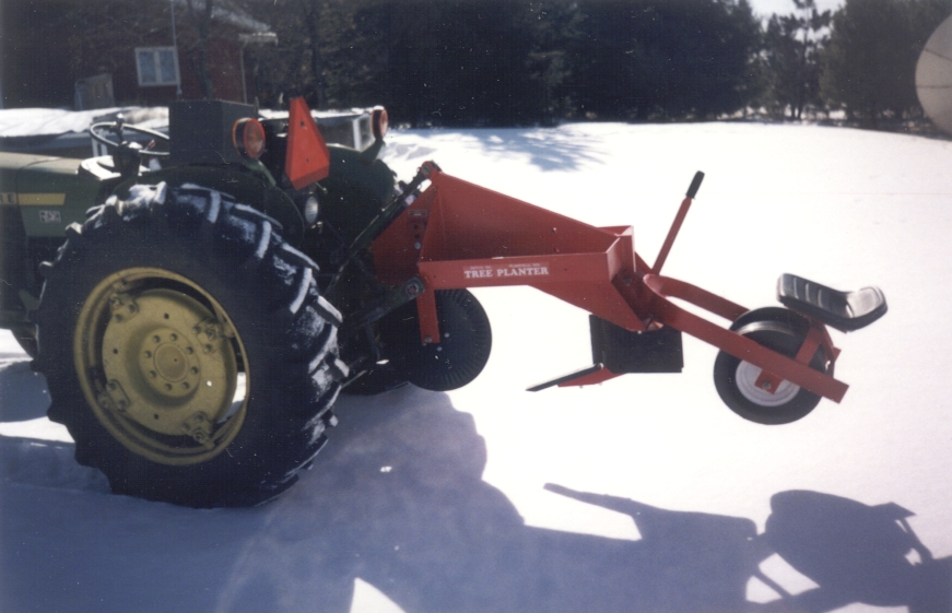

I'm thinking of something like this:
There are lots of tree planters available, but given that this is likely to be a one off job I am guessing it will be cheaper to temporarily modify one of our existing ploughs or build something from scratch - although my engineering skills (or rather lack of them :hammer:) mean I'll probably have to get a friend to do the pre-fab for me. One concern I have is that most the tree planters I've seen are designed to plant saplings with only a very small root, not 30cm like these will be.

In our area they use your pictured device for christmas / reforestation projects, but those only handle bare root trees and really small ones...

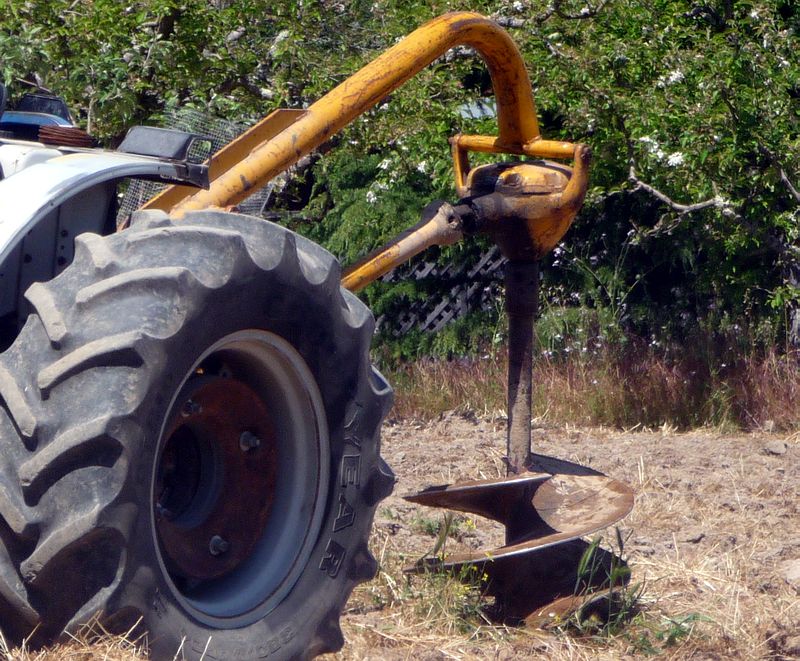

Given the fact you want the soil to be turned larger than the area of the root on a tree like that, you are going to want a post hole digger. We planted 150 trees with one. Took me just a few hours to dig the holes, but filling them took a couple of days...

We run a rototiller over the planting location to get a head start on weeds then use a large post hole digger.
Our replacement locations are all where trees died. Often the hole reveals a gopher nesting cavern that was located beneath the old tree. So I recommend a post hole digger as big as your tractor can handle, to disrupt gopher (or other) nests if this is a replanting project.
Note the post hole digger gives you a head start on the levee you need around each tree for watering.

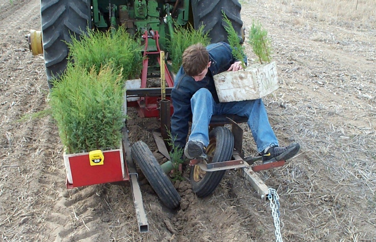

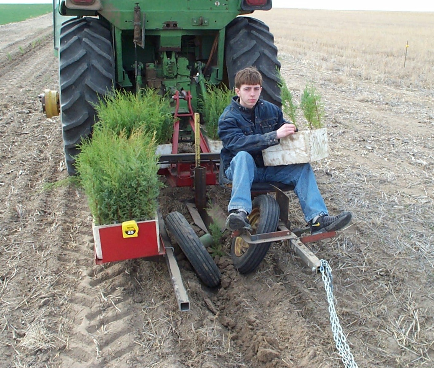

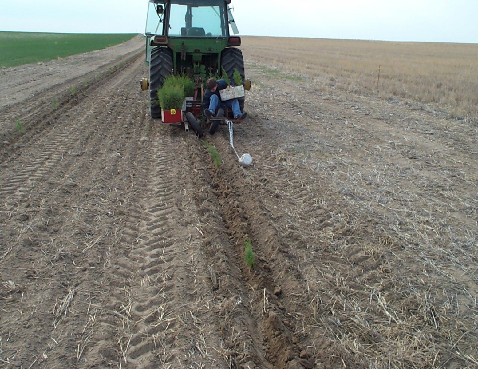

I do not have the best pictures of it but I made one and planted over 10 miles of trees one year,
first a three point mount, there is room for a colter in the front, then a single shank I welded a square tube on the back of the shank and then welded Shields on the tube to keep the slot open, the shank is adjustable up and down,
the two packer wheels are off a old roll over plow, and they ride independently, and the seat is attached to the tube that they ride on and the platform there is a stop so they can only drop so far, so one can lift it out of the ground for transport, the wheels are on a tube that can slide for adjustment on the tube that is attached to the three point mount,
the chain is attached to a old plastic jug, with a little water in it for weight, and was used for a marker by adusting the lenght of chain one could be the spacing to all most the inch once one got use to the watching of it,
one has to creep along as one can get very busy back there putting in trees,

Great job BHD - just the sort of thing I'm thinking of... :)
Did you have any issues when using it / anything you would do different?
/ Home Made Tree Planter #6
not really, I modified the packer wheels once, the way the arms swung I think at first I had them rigid, I will try to go over and take a few more side pictures of it, it has been a few years since I use it,

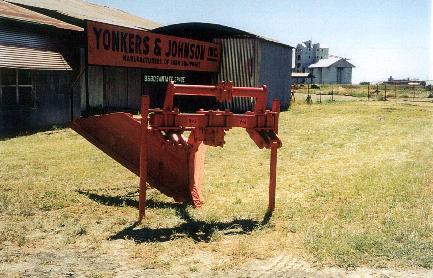

I cannot believe you are fighting the idea of a post hole digger as it is the implement used by most farmers for this.....
If you want to use a plow (I have no real idea why when you dealing with a large root ball) you are probably going to want something like a Ditch Plow.
Then after the ditch plow weld a couple of plates on in a V shape to push the dirt back in, but leave enough space for the trunk to fit between the plates.... Something like this \/
It won't work as well as a post hole digger but at least you will have what you want...

If you want to use a plow (I have no real idea why when you dealing with a large root ball) you are probably going to want something like a Ditch Plow...
The modified ditch plough is a great idea (although the one in your photo might be a tad too large) :laughing: - I'll look into a bit more - Thanks!
