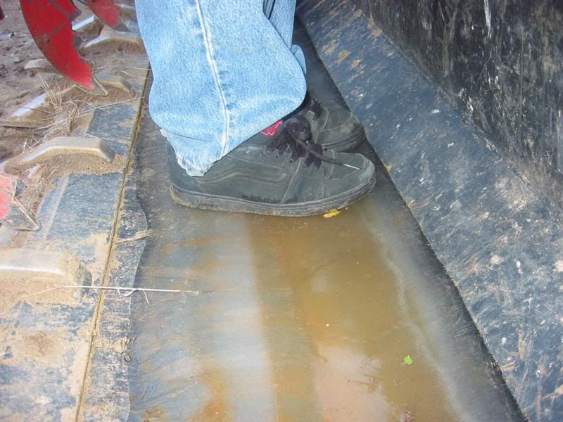

This is how cold it got and it was already 9:00 AM. It's still only 26° and the rain water in my bucket was frozen solid. So much for warm Winters in Sunny southern California.
Wes was skating in the bucket.
It was freezing (actually below freezing and never got over 36° degrees all day. I even tried to warm up the tractor with a propane heater.

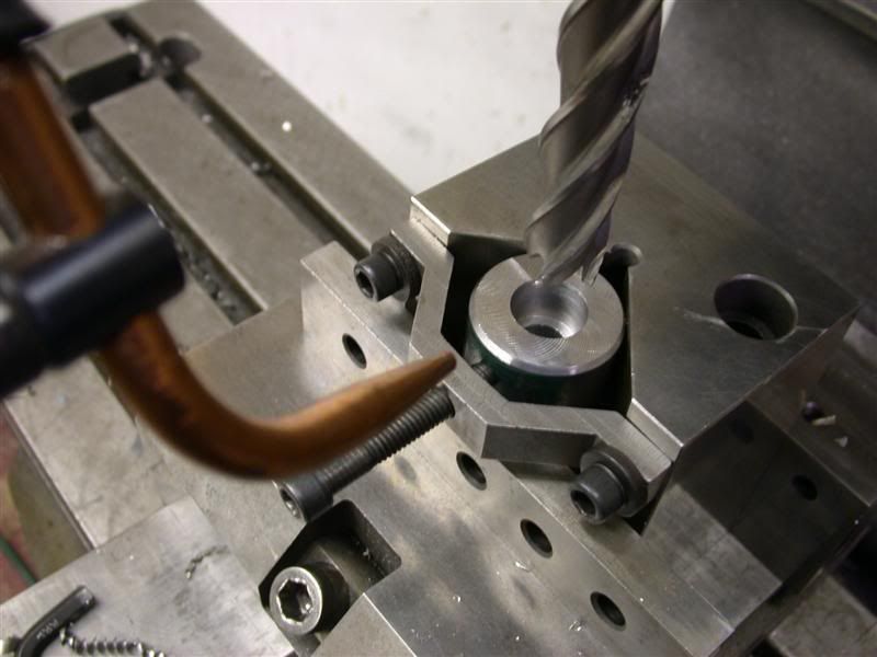

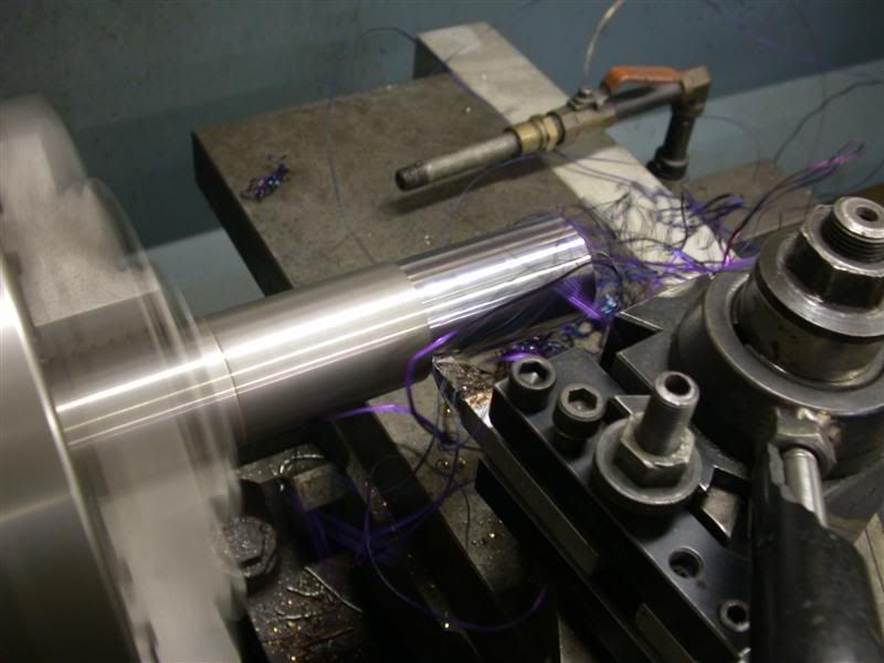

I told you I still had to make the standoff pivot blocks (rounds in this case) that will be welded to the backhoe dipper stick. I had some Ø2" H-13 tool steel that I made them out of.
Turning down diameter in lathe to save weight.
I had to mill them down to size so the fit between the linkage after they are welded on. they have to be pretty close because I'm using the shoulder bolts as pins for the pivots.
You can see they are being held in a big homemade "V" block that is clamped in my homemade milling vise.

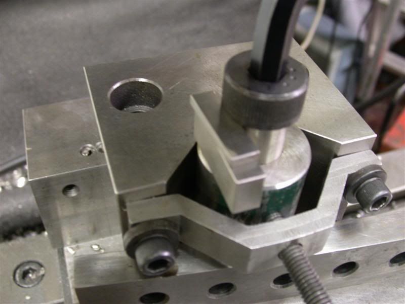

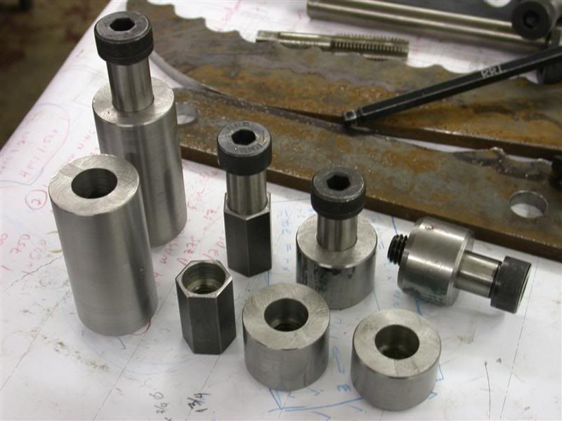

Then, after drilling a 17/32" hole (tap drill for 5/8-11 thread) all the way through each one, I had to counter bore them with a Ø.750 endmill. This is so the stress is taken by the shoulder and not just the threads, making a stronger connection.
Those counter bores had to be right on, or if they were too deep, the linkage could be pinched instead of pivoting freely when the bolts are tightened. So I decided to gage block them to make sure there was enough room for the linkages and the hardened washers between the linkage bars and also on each side. I got them within .001" of the dimension.
This is probably overkill since this time I included .030" as clearance. I learned this from my last project where I tried to hold everything to .001" Hahaha, what a joke!

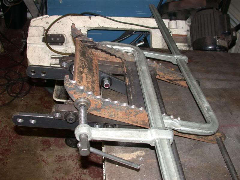

I have a "storage position" designed for the thumb. This will be when I unbolt the linkage from the kidney shaped actuator bar and bolt that link to the backhoe. Since the width of the linkage is wider than the dipper stick, I had to make "storage nuts" to weld on. I made them from some hex stock and they came out beautiful. They are also counter bored to fit the same length shoulder bolt.
So here are all the stand-off pieces that need to be welded to the backhoe. You can see how the counter bores accept the shoulder of the shoulder bolts, not just the threads.
I've also fixtured the jaws to weld the stabilizing plates in between them. I used Ø3/4" rods to line up the holes and then clamped it all together. I checked to be sure the rods still slid freely through both jaws. Tomorrow I will make all the welds on it and maybe paint it.
My plan is to take the finished thumb and linkages up to the property and clamp everything in place to see the range of motion. Then I will tack it all on and try it out. Then weld everything with 6011 rod for root passes and finish pass with 7018.

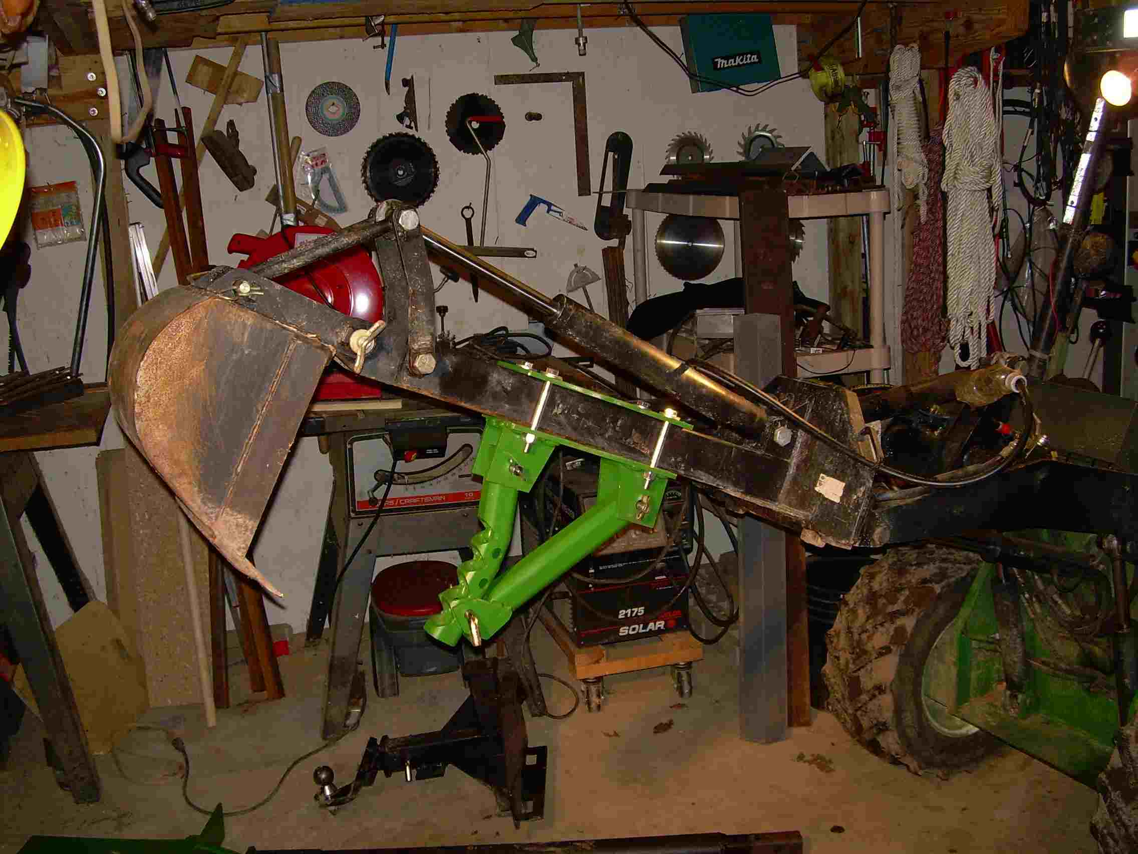

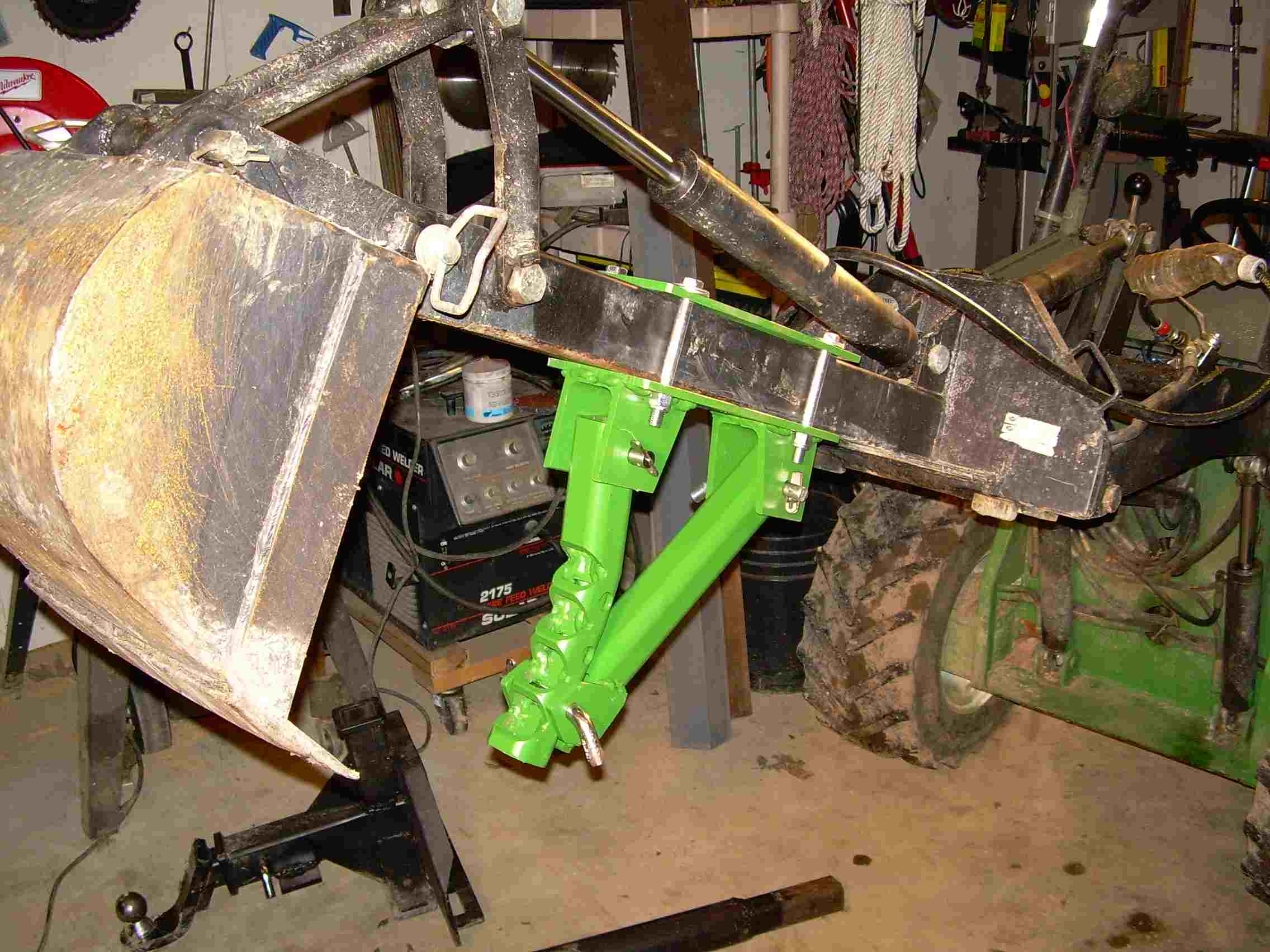

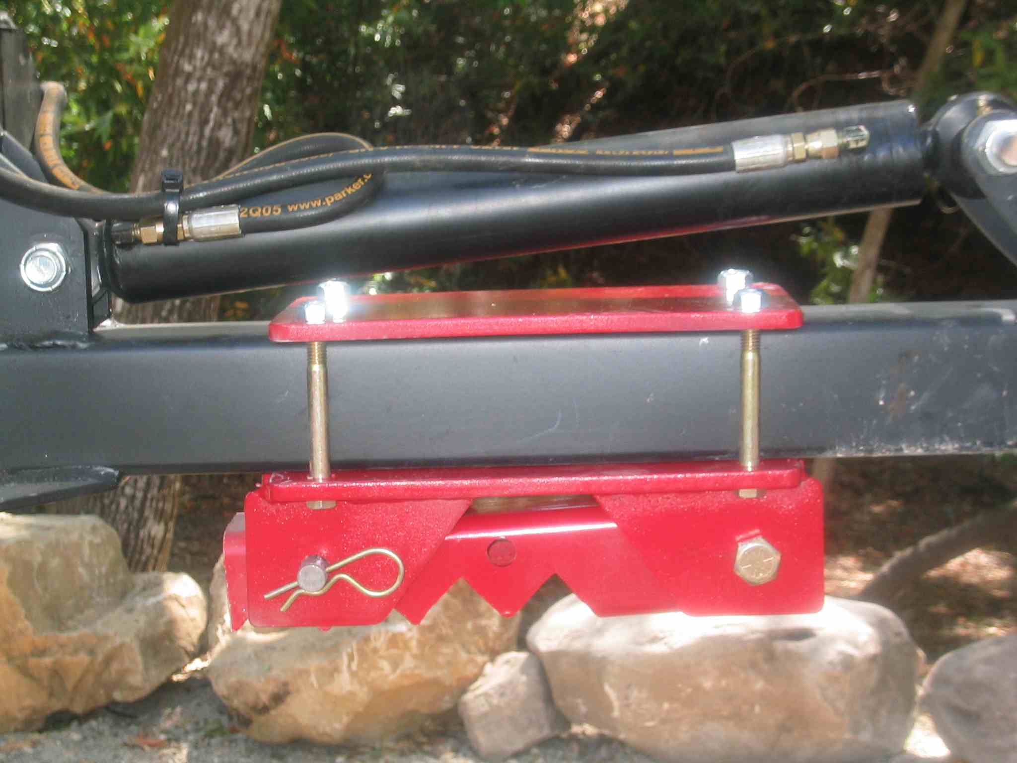

I have attached some pictures of the thumb I built for my PT422. There are a few more pictures on the Power Trac section. The red picture is not mine, but it does demonstrate how the thumb folds.
