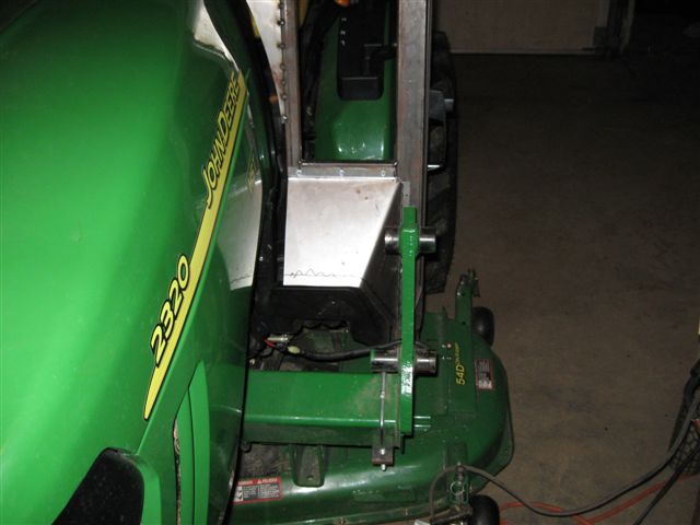

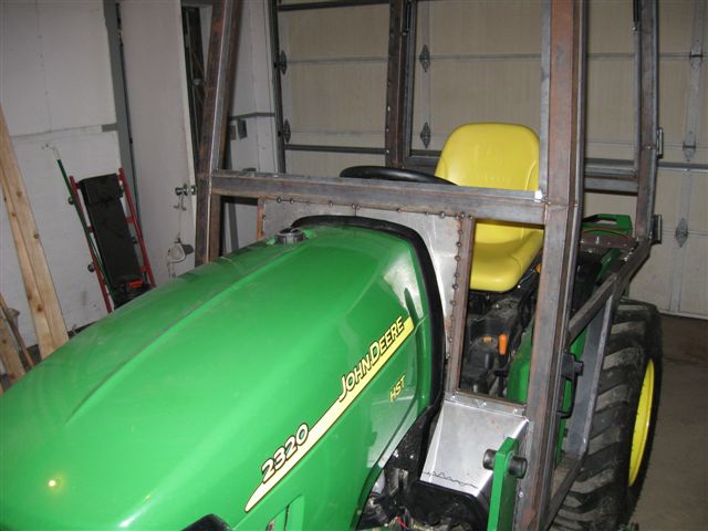

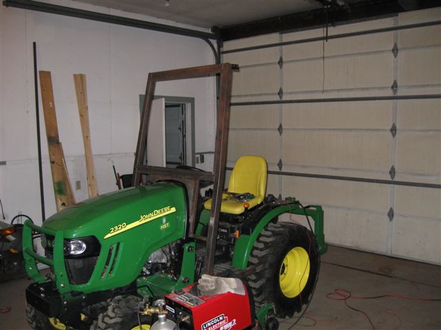

Minor progress today

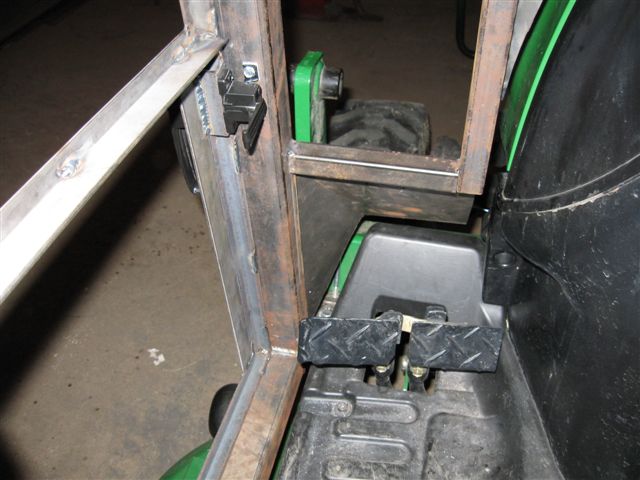

Didn't get a lot of playtime today. Was able to cut out and tack in the filler pieces over the top of the cowl/hood area. The large gap will be filled with a seal/weatherstrip thing. I've got the idea for that in my head, need to try it for real now...
Also fabricated the LH panel to box in around the foot controls. Was able to make it with 1 piece. The main bend was made on the homemade bender. The bends for the attaching flanges were made in a vice with my "Armstrong" bender. Turned out really good, should look great painted.
Closing in on the end of fabrication... A few more odds and ends to work on, then I can tear it down and remove the cab from the tractor. Once off, I can do some finish welding of some of these smaller filler panels and such, smooth out rough welds and do some minor body work in places. Then some sandblasting to remove the rust, prime, and paint. Then I'll be all set to beat the snot out of the paint while reinstalling it...
Starting to look like a real cab!

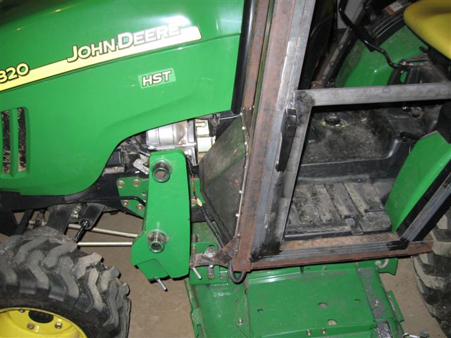

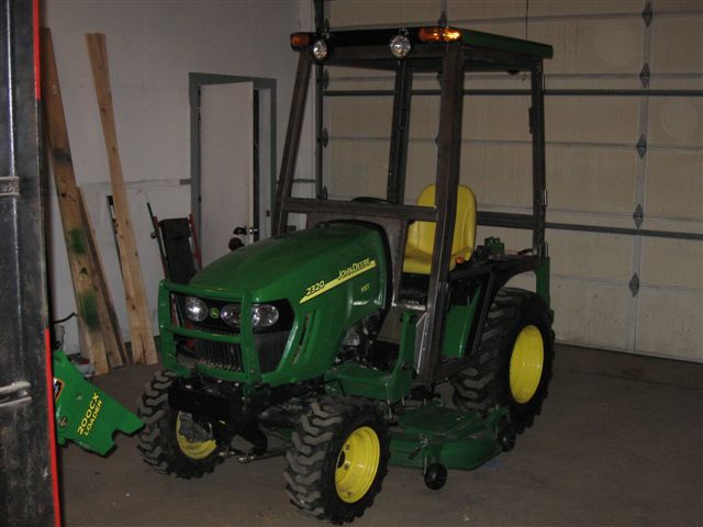

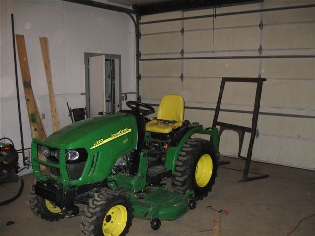

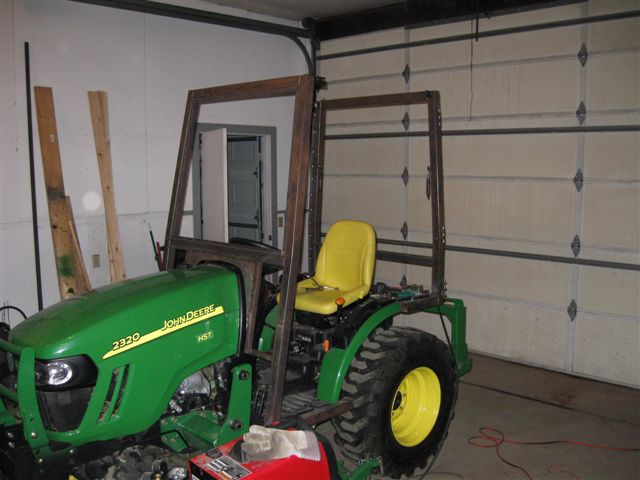

Removed the cab from the tractor tonight. Timed it, took me around 45 minutes total. I was able to get all but the front frame by myself, had to wait for an extra pair of hands to lift the front section up over the seat. Wouldn't want to do it very often, but once a year should be ok.
By the time I had it all tore down, there wasn't much time left for any more progress. I was able to clean the rust off of the foot control filler panels and the window flange that was added to the RH fender bar. Also got primer on those 3 pieces as well.
The goal is to get the cross bars, door, and window frame in primer tomorrow night if at all possible. Would like to shoot paint on everything this weekend depending on the weather.
Here are some pics along the dissassembly process...

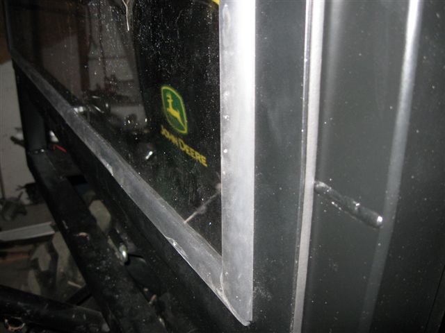

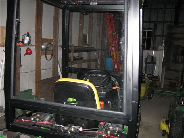

Update

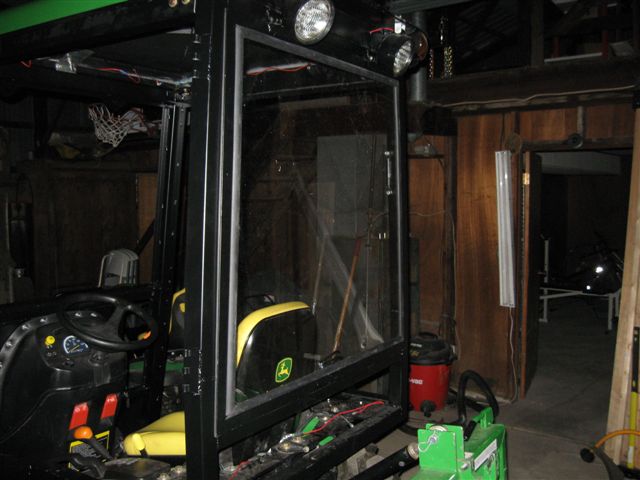

Most of the cab has now been painted. Still need to paint the door and the filler panel for below the rear window. Have Bondo applied to the door frame, just need to sand, prime, and paint it now.
This evening, I cut and installed the first piece of plexiglass. I did the rear window since it was a separate frame, easier to deal with for the first one. That rubber gasket is a bit of a pain to install, but really turns out well, glad I sprung for it. Stuck the weatherstripping on too, makes a nice seal against the frame. Didn't get any good pics taken during daylight, had to run out and get a couple in the dark tonight.
The cab's looking pretty good now that it's all painted black. Should have some time to work on it again tomorrow night, should try to get the door primed and maybe painted for sure, maybe install another window too. Maybe the windshield, another fairly square one, easier cutting that way...

You've probably mentioned it in previous posts, so I appologize for asking again......but where did you get the gasket material from?? What is it called??
What type and thickness of plexiglass are you using??
