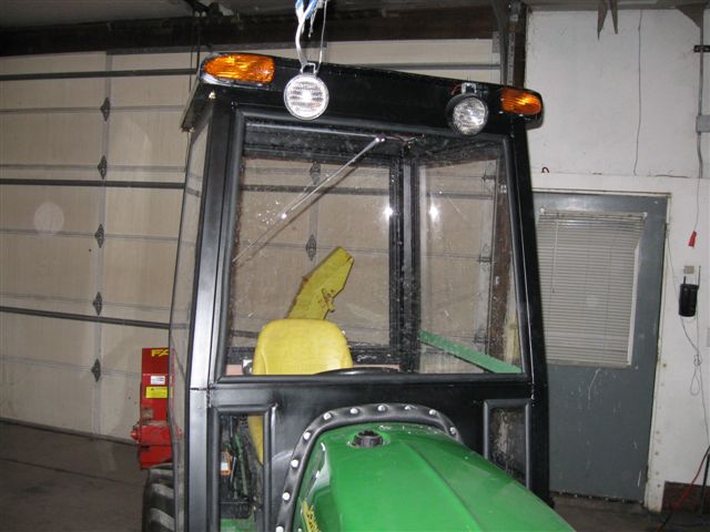

quickie update with some more pics.
Got the plexi in the door and hung it back on the cab. The screen door latch doesn't look like it'll pan out. It isn't doing a good job holding the door shut with the weatherstripping compressed. I'll probably have to add something a little stronger on the inside to keep the door from vibrating open when the tractor's in use... I'll have to give that some thought...
Also installed the hand-operated wiper in the front windshield. Almost had a disaster while drilling the hole for the wiper in the windshield. About halfway through, the bit caught and cracked a chunk out of the plexi! :eek: Fortunately, the wiper nuts cover it up, no harm, no foul....so far. We'll have to see if any cracks come wandering out of the now jagged hole in the future... Might try using some solvent glue to sort of melt the hole more smooth, maybe stop the cracks before they start...

Pics...
The 3rd pic is a shot from the seat out the LH door. From a normal seated position, I can see the edge of the 54" mower deck without leaning over...
