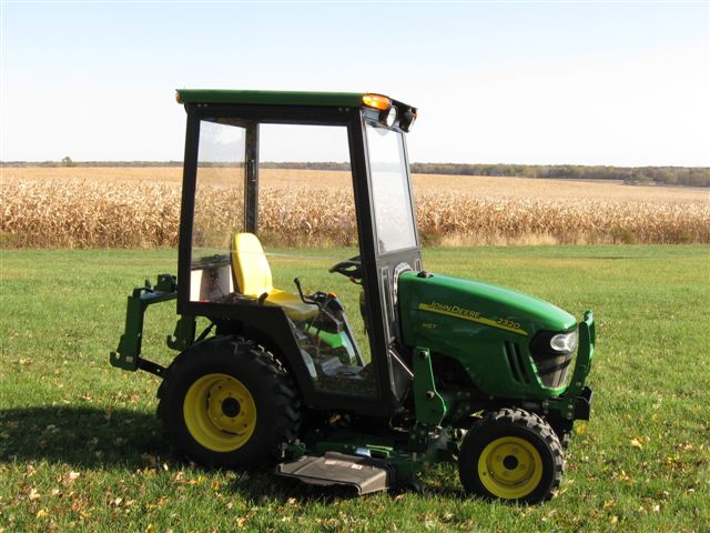

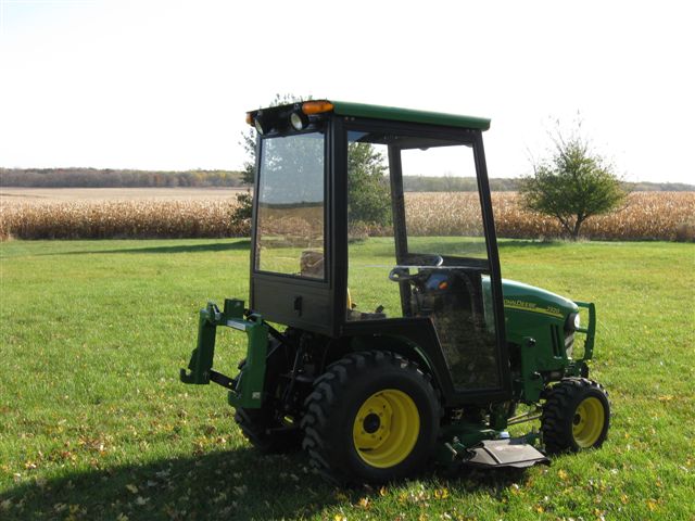

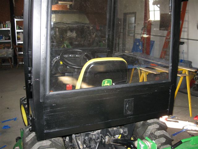

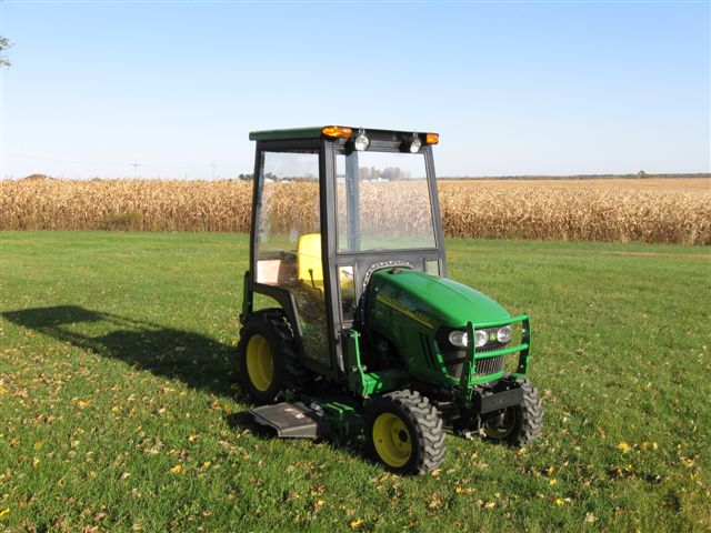

Getting closer to having the cab complete, or at least functional. The other day, put plexiglass in the RH side window and windshield. Yesterday I was able to buttong up installing the "glass" in the little windows on either side of the hood. I also painted and installed a filler panel below the rear window. I ended up making this out of wood rather than metal. A couple reasons for that: 1) laziness... cutting a 1x8" piece of oak I had lying around to length, drilling a couple holes, and painting it was easier than fabricating a steel piece. 2) I may want/need to change this piece someday as I add options, etc, so I figured this would be a good disposable piece.
Mounted in that back panel is an electrical outlet with a sealed outdoor cover plate with door. This is my aux. hookup. Inside the cab, I attached the control knob for a small 12V winch I had from another failed project. The outputs of the control knob wired to the outlet. I placed the control to be right where my hand will be when driving backwards with the snowblower. I added a standard male plug end to the wires on the winch. Today, I removed the manual crank handle and cable from my snowblower. I removed the cable from the winch, drilled a new holle through the reel in about the middle, and mounted the winch to the blower. Using a chunk of the cable that came with the winch, I wrapped and attached a new cable around the winch and chute for electric rotation. I can plug the wires into the back of the cab now, easy on, easy off. After a little adjusting and some grease on the chute, it moves perfectly and my arm won't have to freeze off to turn the crank! :cool:
Before calling it a day tonight, I sanded, primed, and painted the LH door frame. Should be able to get the plexiglass in tomorrow night and have a door to complete the box. Then it'll be a matter of filling in gaps here and there and this project will be almost complete...for now...
Didn't get any pics of the winch setup, will try to do that tomorrow. Glad I took the pics I did today, weather turned nasty this afternoon, high winds, dropping temps and snow flurries! :eek: Better get that door done fast!
