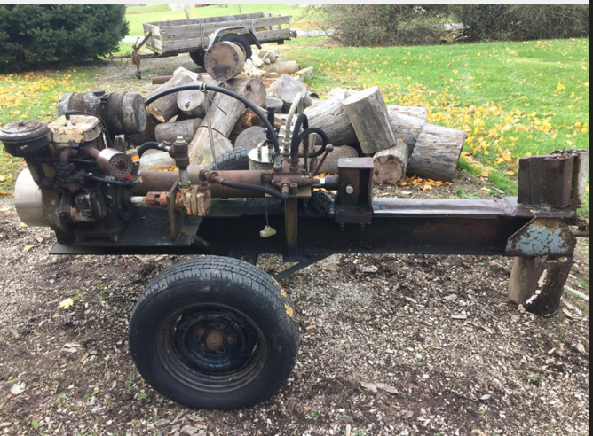

I've got to be honest, in todays economy you might can pick up a decent log splitter from somewhere like Northern Tools for less than you can build it for. When you factor in the cost of steel, the cost of a strong hydraulic cylinder, the cost to plumb it, the 3PH. (assuming it's not a pull behind) IDK maybe you've got a connection to get a strong I-beam and some think, scrape metal for fairly cheap, and a used hydraulic cylinder that doesn't need new seals or rebuilding, but I find making your own things (while very cool, and rewarding for sure) doesn't benefit you in costs saving like it did 15-20 years ago. Plus if it breaks there's no warranty. IDK, you have to ask yourself, "is the juice worth the squeeze?".
This is what I have. It works pretty well.
