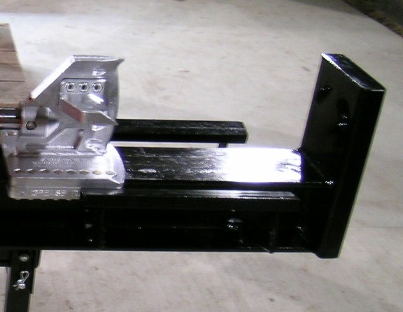

any theories from you guys on why log splitter wedges are shaped the way they are? it seems to me that rather than have a straight vertical sharpened edge, the wedge would require much less force to 'start' the split if the front edge were to have a more arrow-point shape (not as pronounced, of course, maybe 10-20 degrees of tilt ). the force to start the split would be reduced by having a 'pointy' wedge. watching splitters operate, there is the initial 'pop' to start the splitting action, probably the first inch of the stroke, followed by the spreading action which takes much less force. i compare it to cutting a piece of steak with a knife. pushing straight down with the knife doesn't work and would require a large force, but using the point of the knife to pierce the steak is easy. i've seen forged steel wedges on splitters but they, too, have vertical cutting edges. but i have seen 4-way drop-on wedges that have the wings tapered back. why not the main cutting edge? any theories other that cost to manufacture?
You are correct about it being way more efficient. The sliding problem is solved by a tip at the top. This style of wedge has been around awhile. Here's a pic of the business end of mine, notice the wings and main edge:
/ log splitter wedge design #5
The edge looks like an ax head. Curved just a bit.

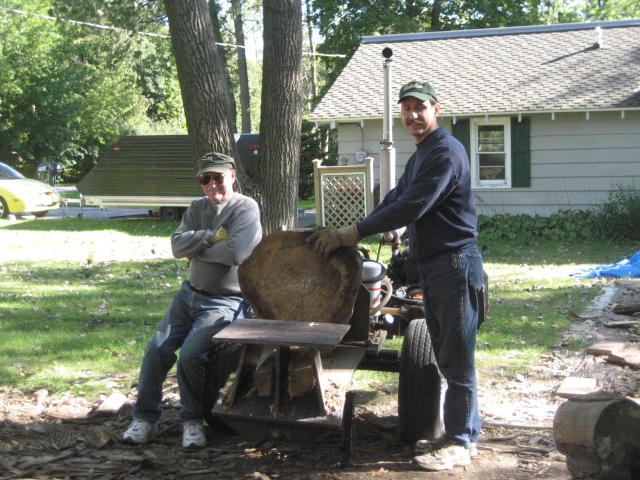

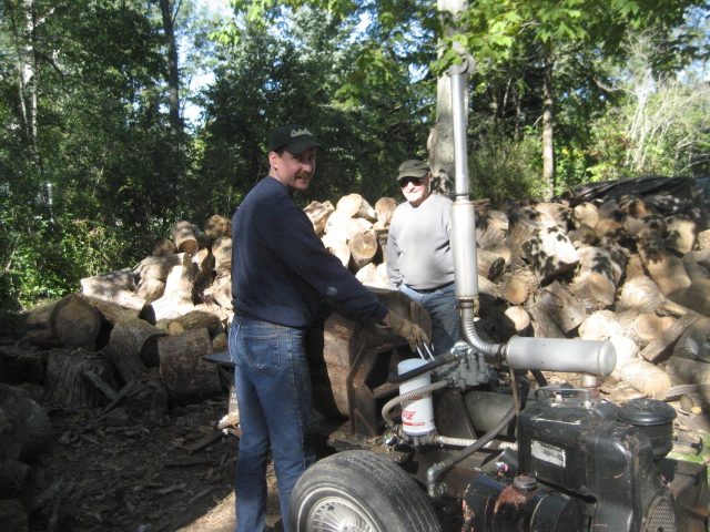

I don't know if you need to think about this so much. We're talking about the power of hydraulics here. If you select a 4" cylinder and decent parts that will push to 3,000psi, you'll have more than enough power. If you buy cheap parts that can't produce pressure, then you need to get inventive with your wedge design.
Personally, I hate slow splitters. While using my dad's painfully slow $800 splitter, I got to thinking about the process of splitting. I thought to myself "why do people think of log splitting like they are trying to split the wood with a wedge and maul?" The more I thought about it, the more I like the idea of trying to extrude the wood, instead of splitting it. Yep, I built a wood extruder, not a splitter! The first time my neighbor saw my creation, he immediatly dismissed it, saying "that'll never work!" Oh, how wrong he was! The head that I built is around 16" wide. It first splits the wood horizontally and then splits the bottom half 3 more times. For each pass of the splitter I get 4 pieces of wood. When the push plate cycles back the area is clear and I slide the nsplit half back. No having to catch and hold pieces so you can resplit them. To run this splitter you must have a 5" ram and 3,000psi of pressure. Anything less, won't work. Using it on dry wood (elm, oak, maple, hickory, etc), it has never jammed. I have jammed it with green box elder though (not my wood). Is it fast? **** yea! This splitter requires 3 people to operate. One works the controls and positions the pieces. Another brings the chunks in and the third person clears the splitter of pieces. Everybody is always busy. If you wanted to stack the pieces, you'd need a 4th person because there isn't enough time to stack. With this splitter we managed to split 14 full cords of wood in 2 long days.

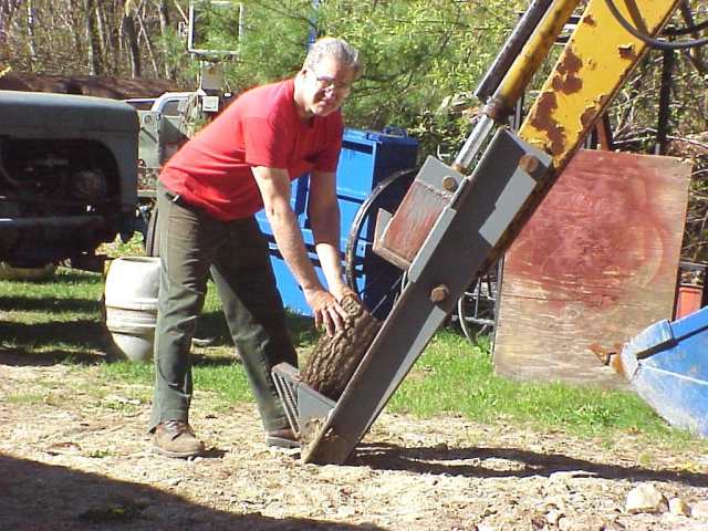

that's quite the rig you've got there. i'm sure it works well for you but in my case i'm trying to get all the info i can on improving or modifying a copy of the one pictured. my backhoe bucket has a 4-1/2" cylinder, 27" stroke, but i'm not sure on the psi...maybe between 2500 and 3000. the cost, with new metal, should be about $300. were cost no object, i'd have a 30 ton unit sitting in my shop, but such is not the case. but where's the fun in 'buying' when you can 'build' , right?

Thus design seems to work well. Be interesting to see how long it stays sharp, and how long the wedge lasts.
/ log splitter wedge design #13
I have been thinking a lot lately about building something like that. Did you use any kind of special steel in the blades? Maybe hardfacing rod on the leading edges? Did you angle them at all to prevent wedging?

I have been thinking a lot lately about building something like that. Did you use any kind of special steel in the blades? Maybe hardfacing rod on the leading edges? Did you angle them at all to prevent wedging?QUOTE]
The steel is regular A-36 1/2" plate. I put a very sharp edge on the plates and did hardface the edge so it would stay sharp. The plates must splay apart or the wood will wedge. My first design did not splay the plates enough and it took too much power to split the wood. You can see how much the throat opens up in my current design.
