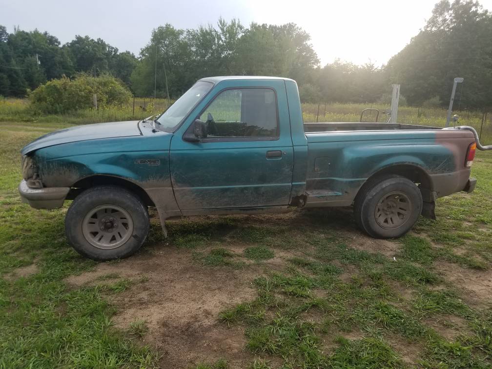

Ranger is a small pickup.
Will be selling what's left of it after removing the cab to fund this build. One thing I do not want to so is build off of the truck frame. I will be building everything custom.
I plan on building the rear suspension so it pivots like a door hinge. It will be similar suspension to a 4 wheeler

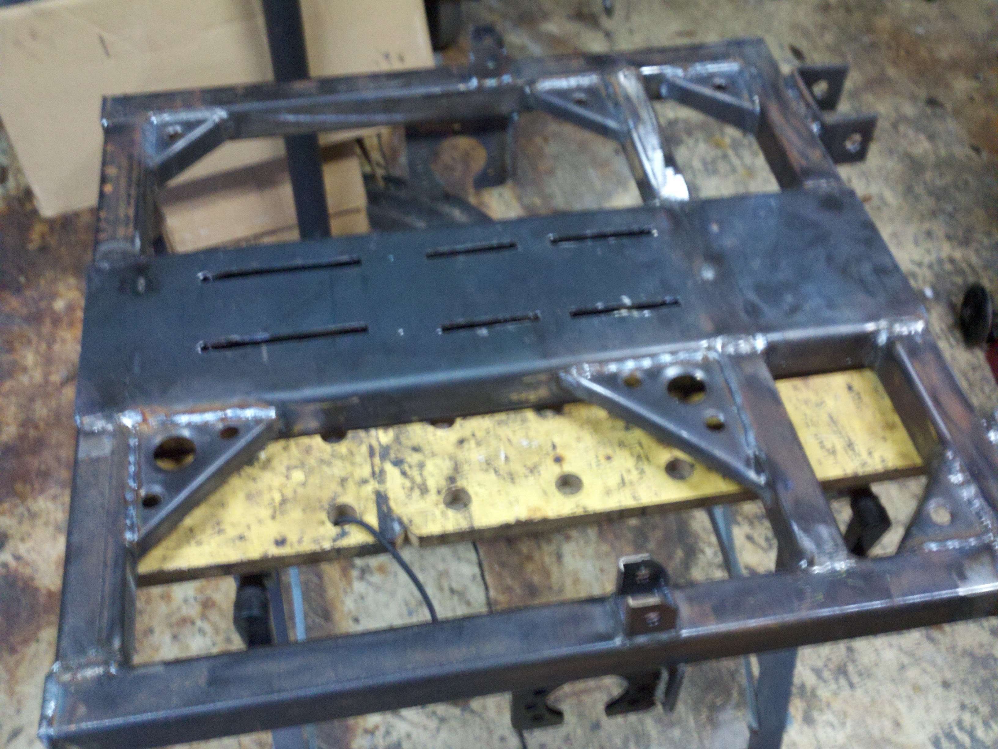

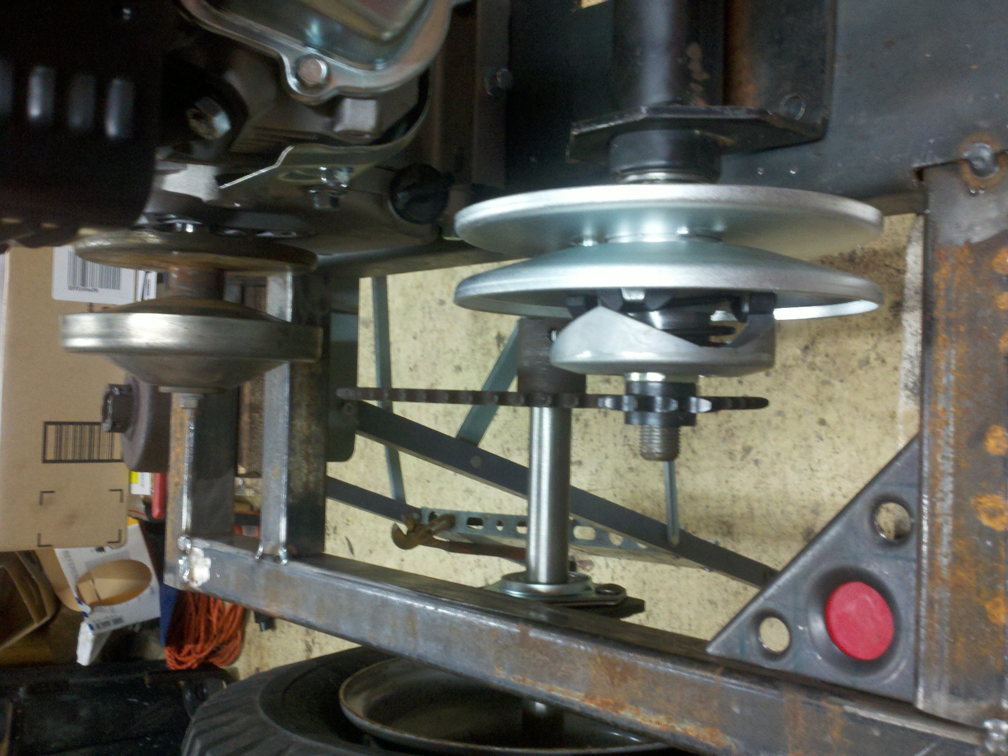

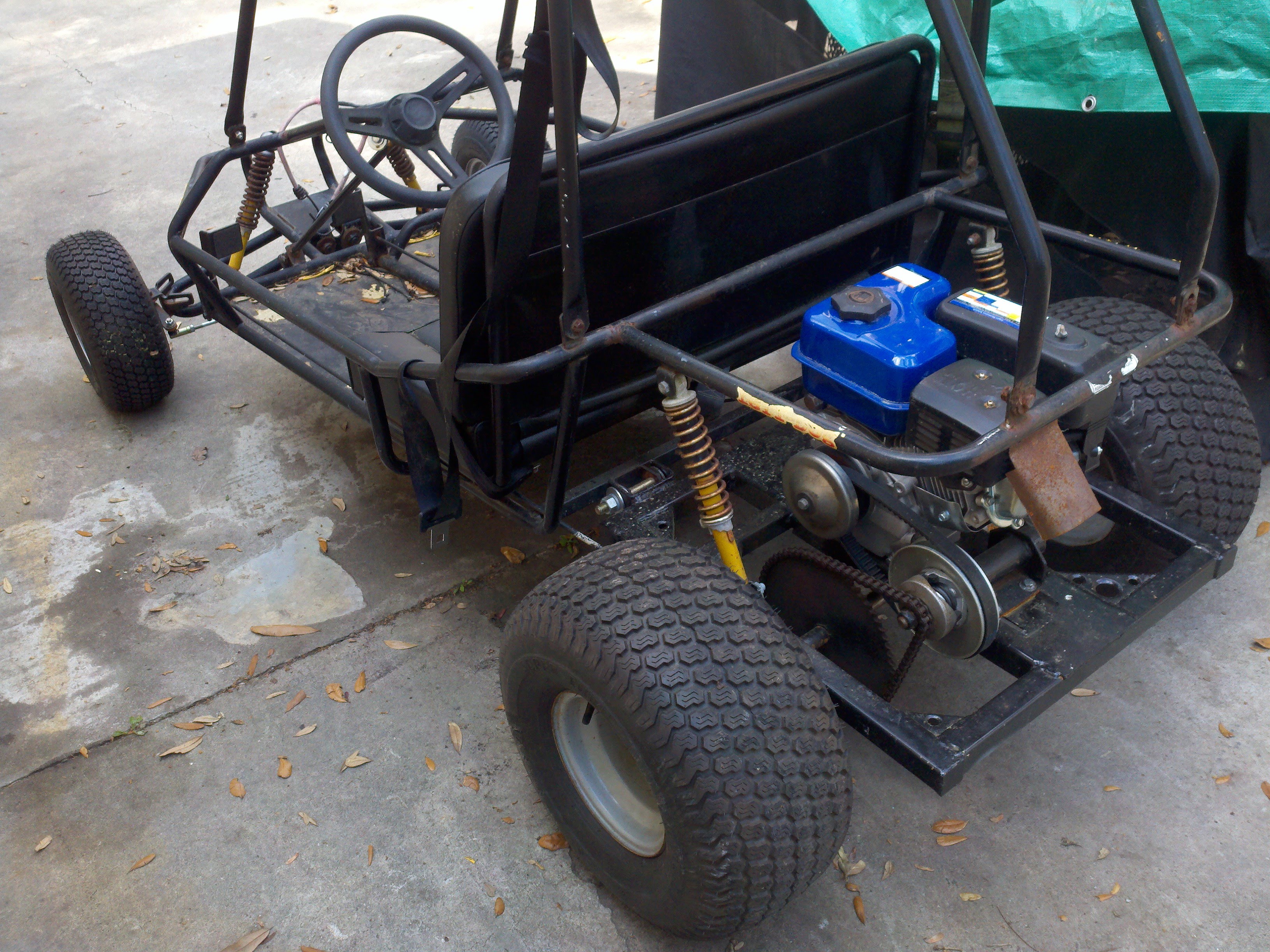

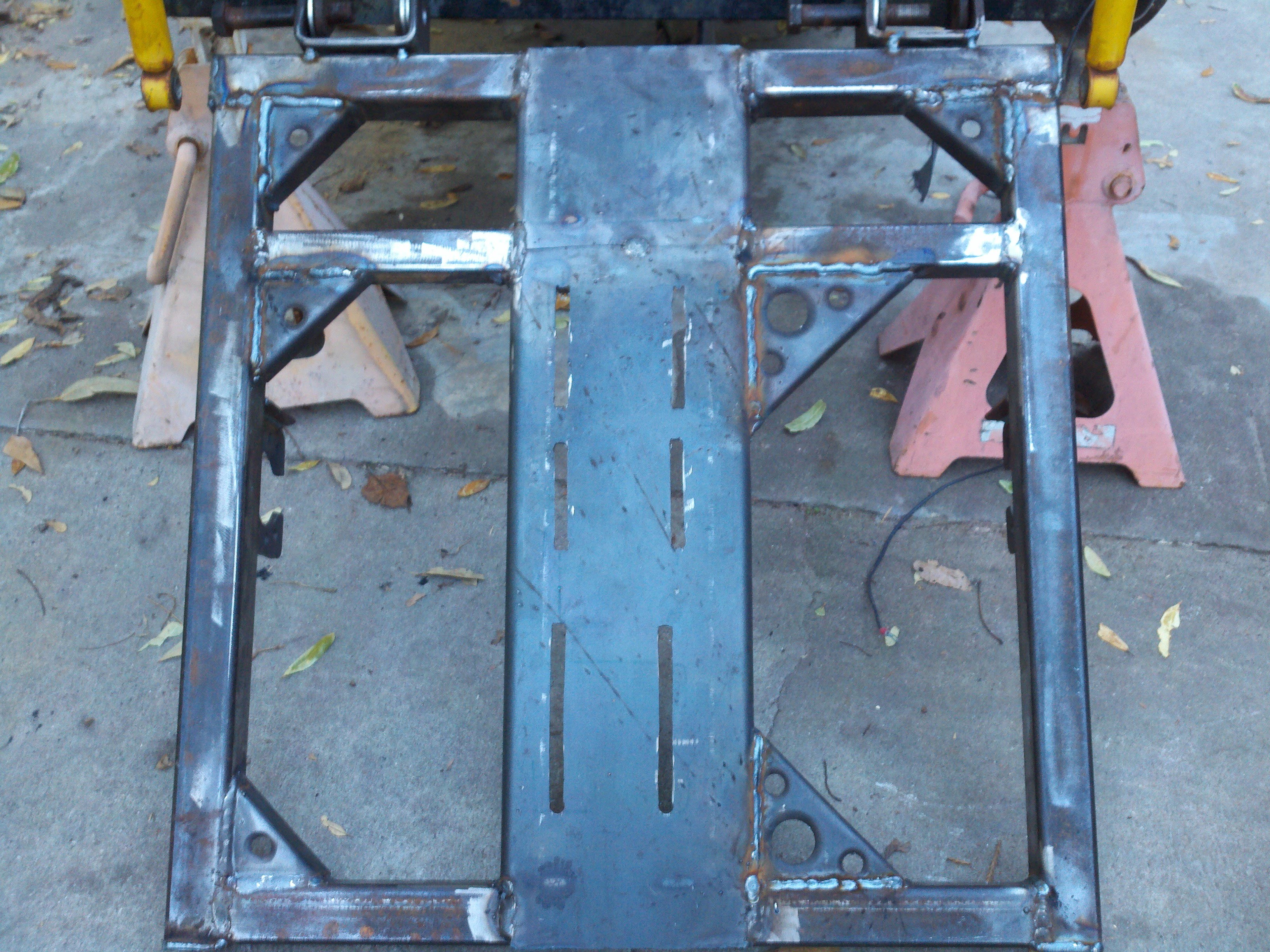

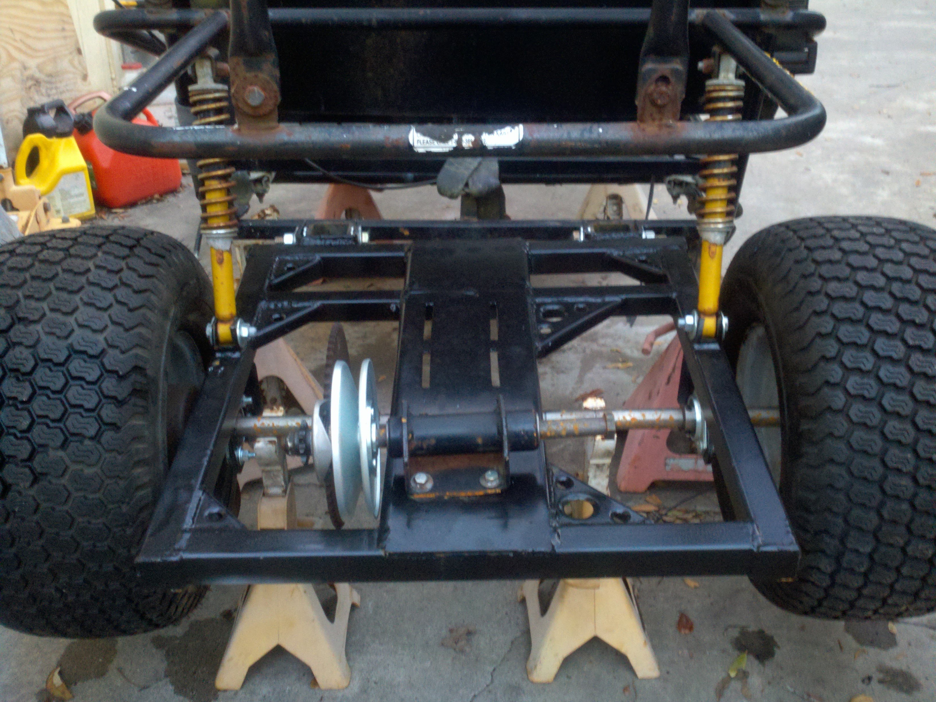

Once upon a time, I built my nephews a go-kart with a hinged suspension on the back. I assume you are talking about something like this an not a quarter elliptical suspension.
IMG_20111225_134332.jpgIMG_20120314_152605.jpgIMG_20120129_173830.jpgIMG_20120114_171402.jpgIMG_20120114_165534.jpgIMG_20120103_184551.jpgIMG_20120103_184525.jpgIMG_20120103_171730.jpgIMG_20111225_154922.jpgIMG_20140825_183709.jpg
/ Homemade offroad buggy
#15
View attachment 570601View attachment 570609View attachment 570608View attachment 570607View attachment 570606View attachment 570605View attachment 570604View attachment 570603View attachment 570602View attachment 570610
Yup, mine will be just like that. Basicly just a little bit bigger. I want to use a bigger engine. Something like a snowmobile engine.
