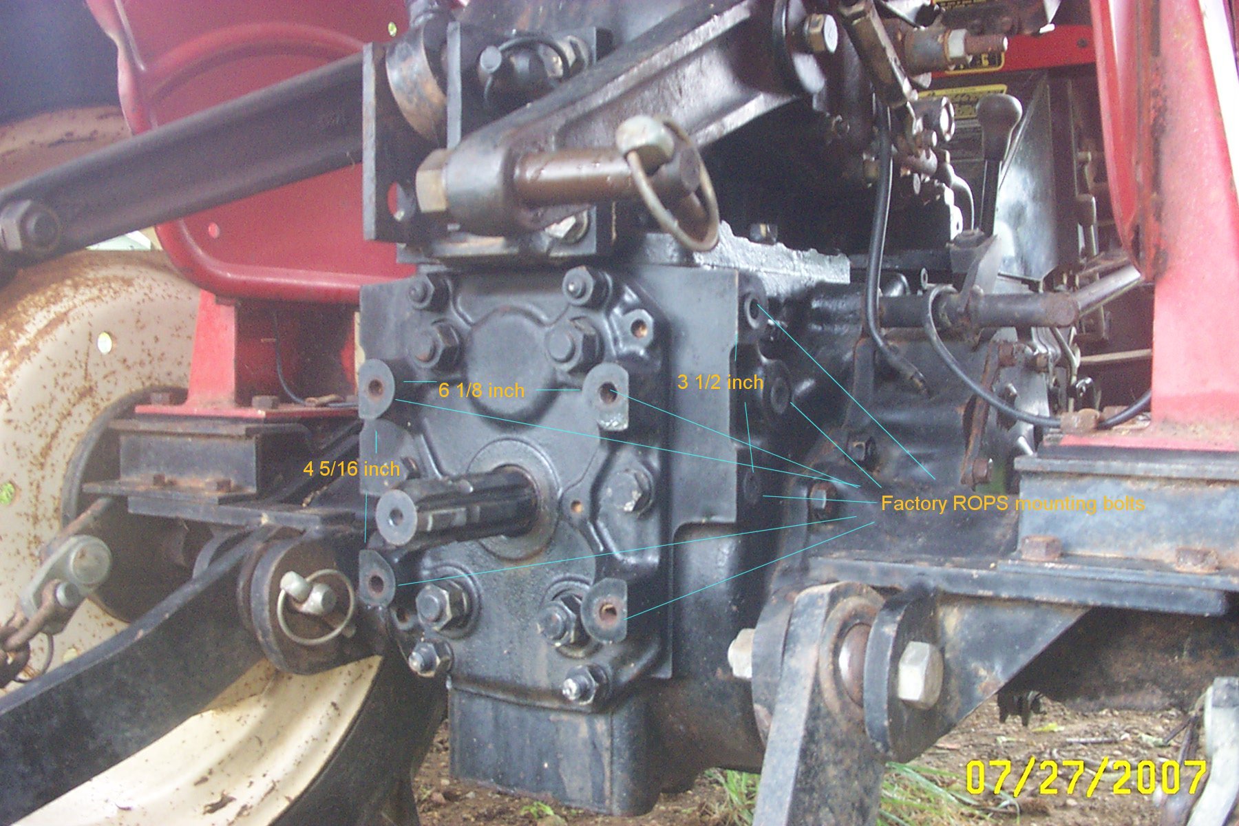

Would you be willing to share your measurements for your ROPS mount? I've got a YM226D and and wonder if your ROPS mount would fit.
The factory mount not only bolts to the front facing of the PTO housing, but also bolts to three points on each side of the housing. It doesn't appear to tie to the fender mounts.
I looked for a factory ROPs recently. Curious that I could find all kind of ROPS for grey market units, but not this domestic 226D.
Besides some terrific welding as others have mentioned, I would add that it's not so easy to figure out how to fit a ROPS mount around all the projections on these tractors. And there's not a lot of space to work with, either.

I have some reservations because of an incident previously posted in a forum on this site where a strongly welded ROPS held, but the tractor itself broke. http://www.public-health.uiowa.edu/face/Reports/PDF-Reports/Rops-Rollover%20Final.pdf
Part of the support for the ROPS mount in this thread involves bolting the mount to the fender brackets. The fender brackets on my YM226 are on top of the axle, and not bolted by any kind of U bolts under the axle.
Although bolting the ROPS mount to the face of the rear PTO housing will certainly make the ROPS mounting more secure, the factory mount does bolt to three bolts on each side of the PTO housing via a simple piece of angle.
In view of the factory mounting, it would seem to make sense to add some angle that can be bolted to the sides of the PTO if the YM240 PTO housing is built the same as my ym226.

Hi everyone, back from the fires. I looked at my YM240D and see that being the age it is, it doesn't have the side bolt possibility on the housing. Apparently, it's just too old. This tractor was built before ROPS were standard and the aftermarket ROPS does use the four bolts surrounding the PTO and the axle flange bolts. I am familiar with several tragic examples of where homemade ROPS failed, but none were attached as ROPS; they were attached as sunshades. A quick look at the excellent link provided should make it clear, you can't attach a ROPS like a sunshade. My attachment system (rear casting and axle flanges) is taken from a certified ROPS for the 240D. It distributes the attachment over the largest casting of the tractor, as well as adding the strength of 90 degree gussets to each axle. While I like that clean, one point angle attachment provided in the Yanmar parts drawing, I doubt it provides any greater strength than the rear end and the axle flange attachments. With both of these attachments at 90 degrees to each other and reinforced with gussets, it increases the strength tremendously over a sunshade attachment. Look closely at the link, it's hard to believe anyone would have believed in that attachment. It failed for good reason. The bar looked good, it's how they attached it. Think of it this way. When attached just at the axles (like in the link example), the flanges have a high probability of failure. If attached only at the rear (PTO area), the bar may fail at the single attachment point. When attached to both points and reinforced, the strength is increased ten fold.
