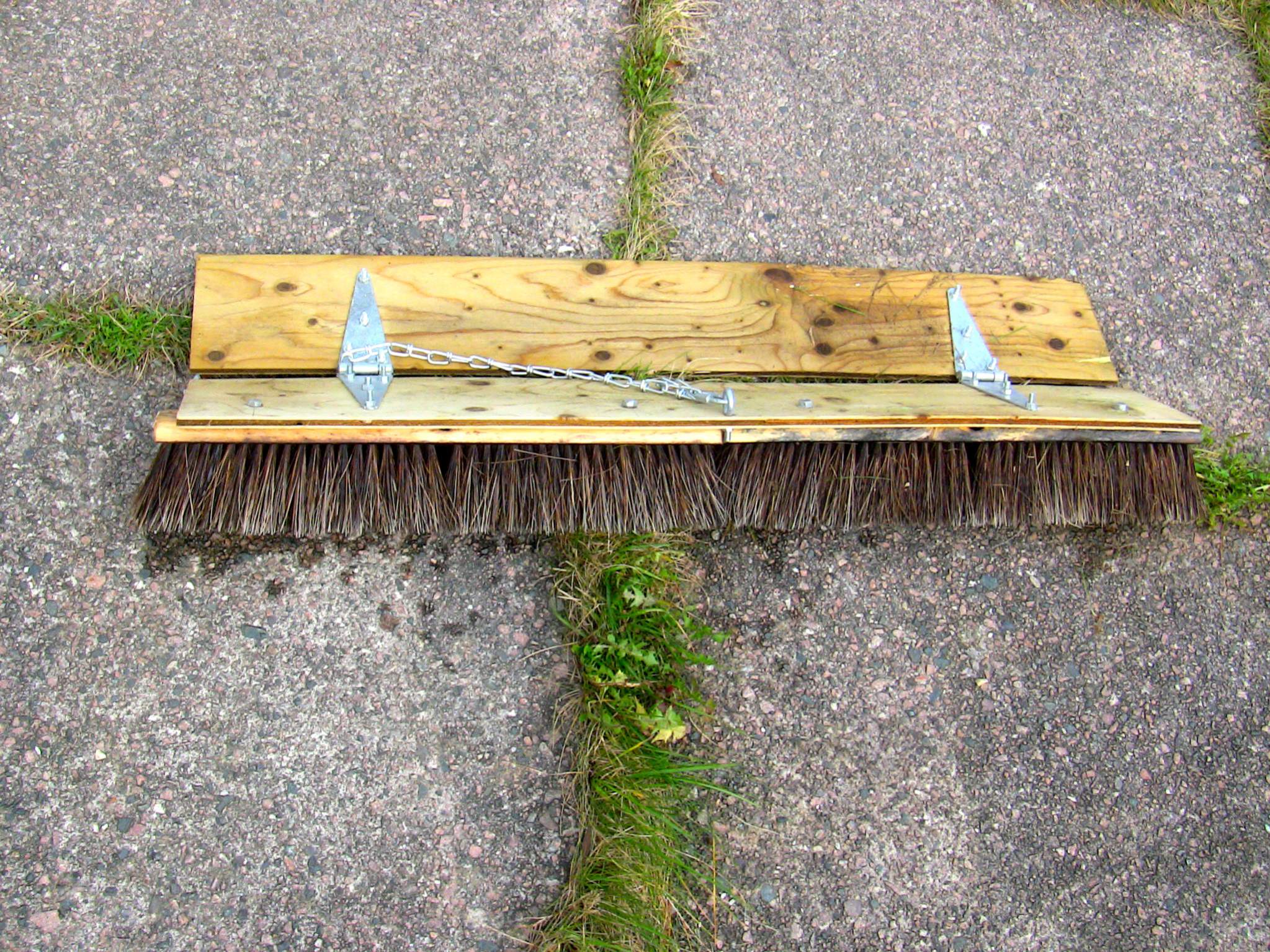

Thanks pmsmechanic! Four sides with brushes work pretty good with no noticeable gaps and much easier to do four than six with the mounting method I used. Last year I made a "one-step" brush and it didn't work very well at all - it didn't rotate. I will try and find the video on that but it might be down too deep somewhere.

Didn't find the video of my original bucket brush yet but here's a picture. Turned out to be mediocre performance. IMG_0990.jpg
