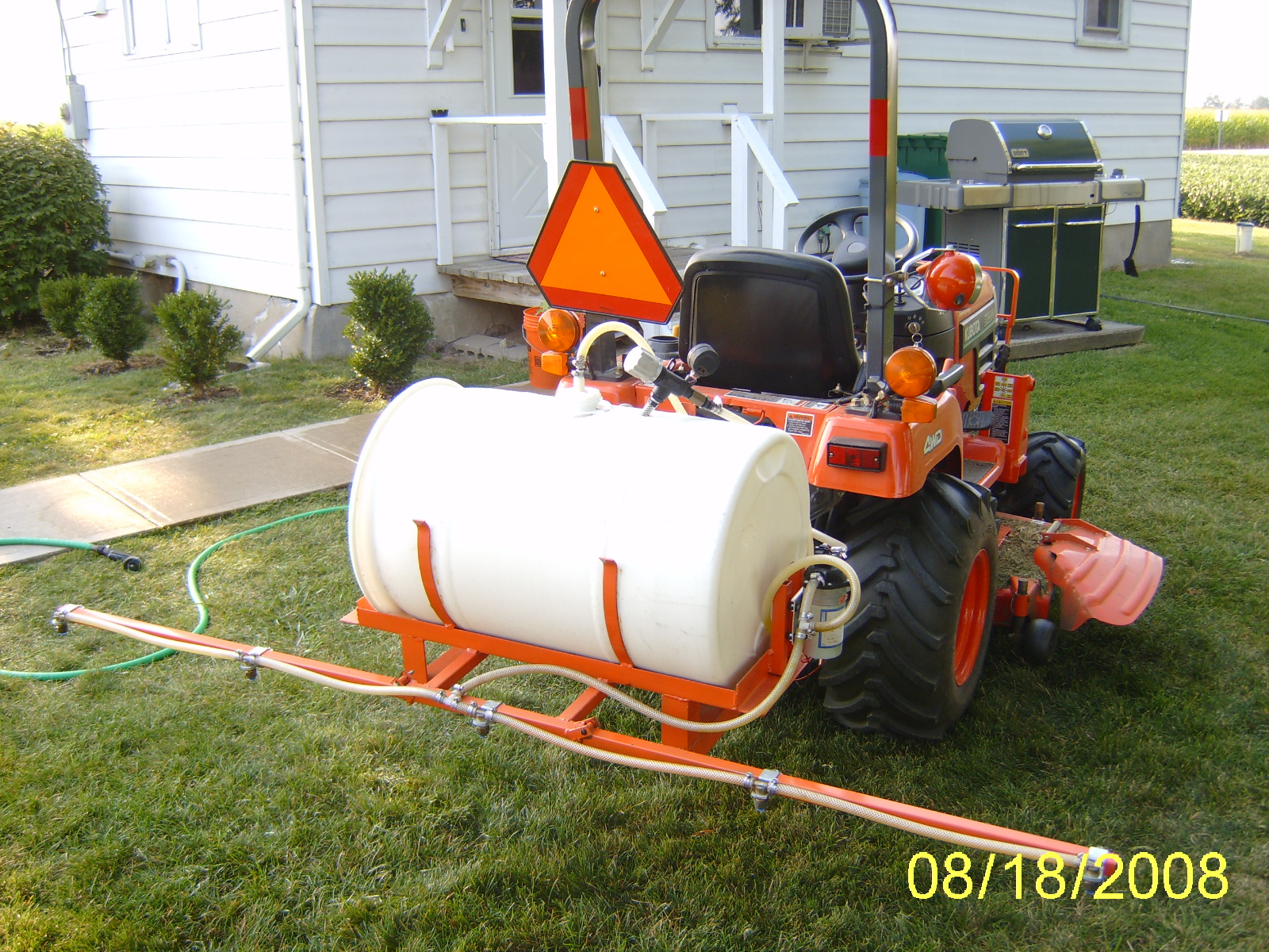

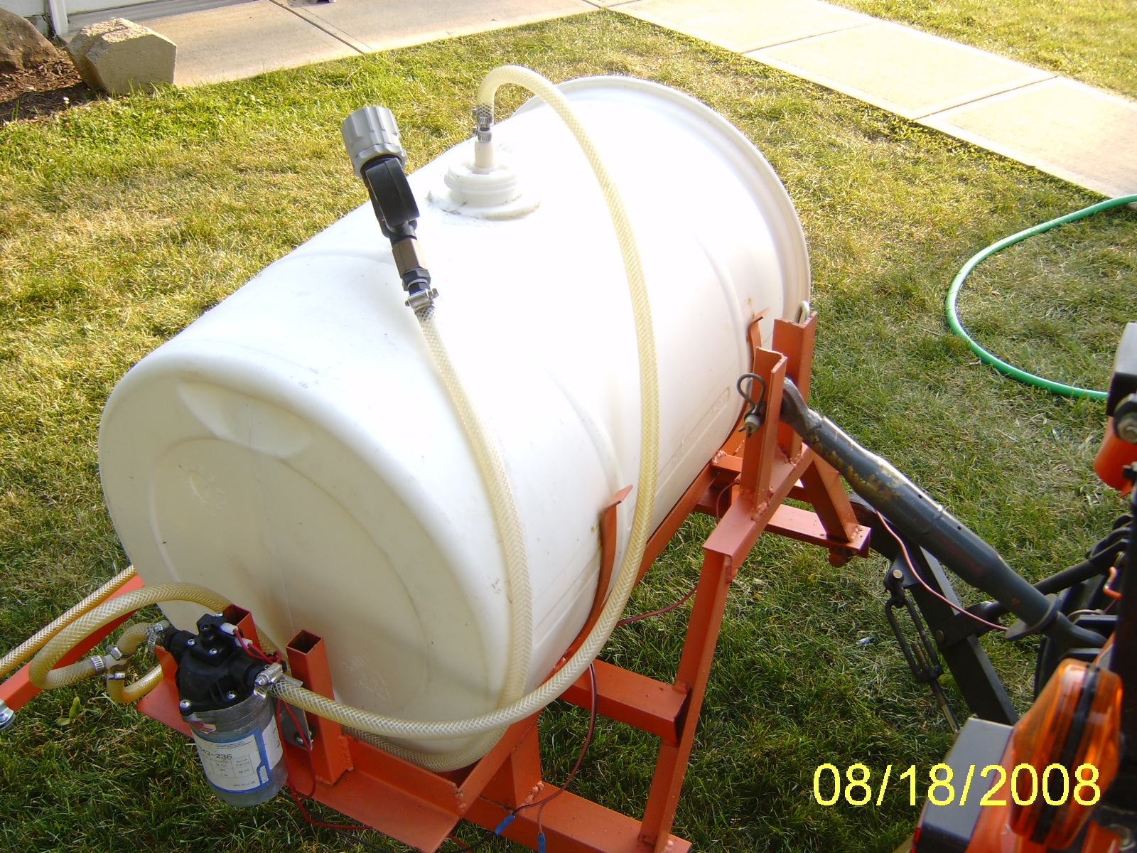

I got the spray nozzles for my system at TSC. They are plastic so they don't corrode, were cheap, were easy to assemble. I use an electric pump with good results. Made my boom of PVC pipe. Use 2 fan nozzles and spray 80 inches wide. Works well on my BX24. I can spray a 1/2 acre section in about 5 minutes. I'm not doing acreage though...
