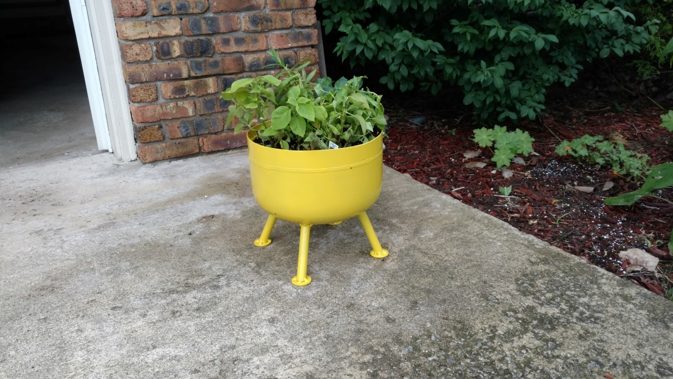

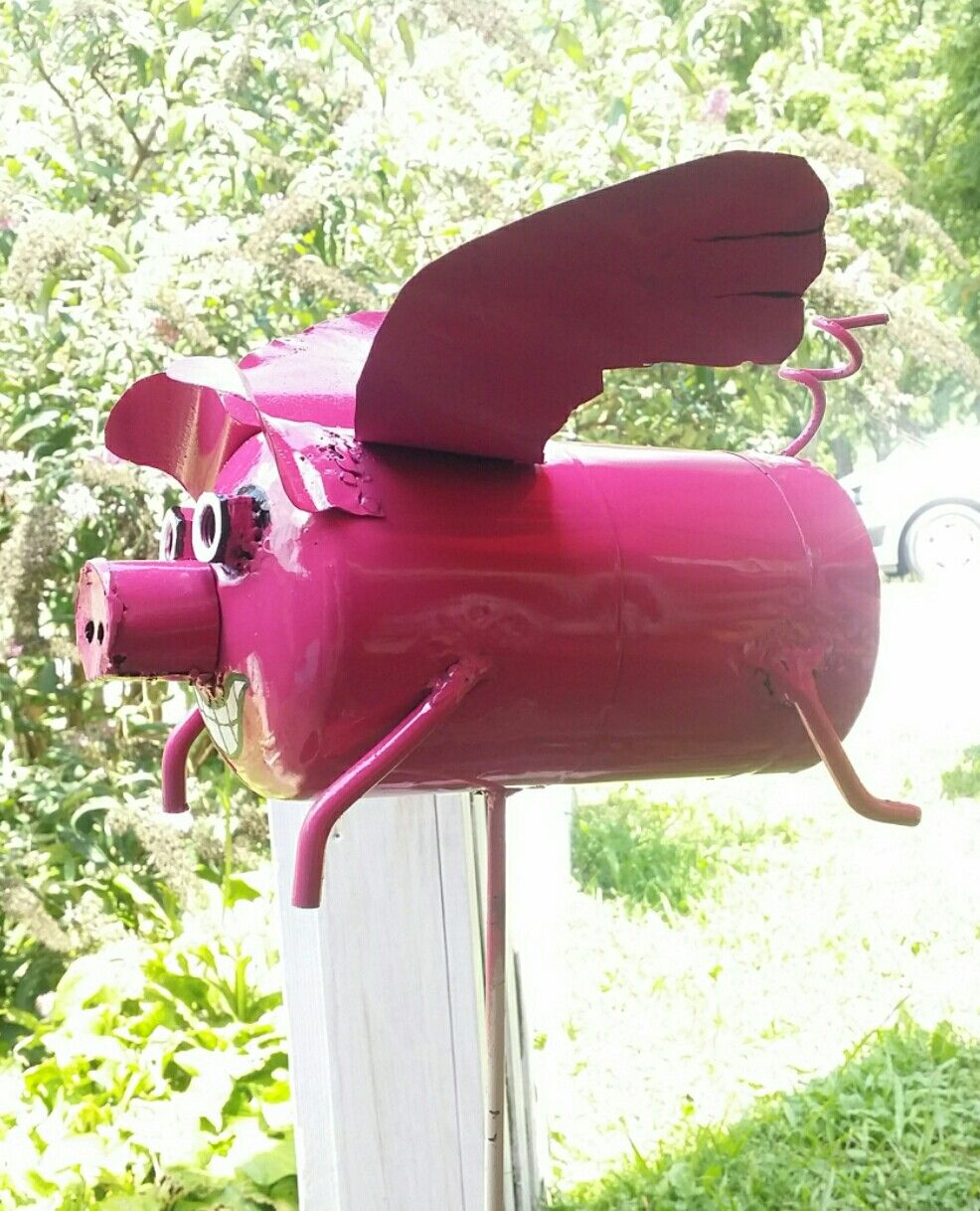

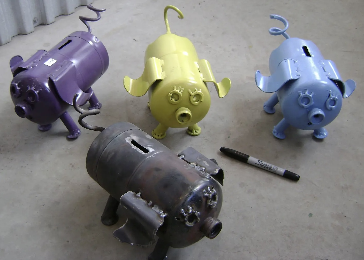

I have used old gas bottles cut in half for lots of variuos needs so long as you de louse them properly first I have used several 100lb bottles with the ends cut off and welded together to form culvert pipes covered with concrete or coarse gravel, there are hundreds of uses for old gas bottles. If you need a pressure vessel then go buy a brand new cylinder that has never been filled, if its for liquids you need to either turn it upside down or fit a pick up tube long enough to reach just off the botton to the valve, drill a hole the right size and fit a tubeless tyre valve to the top of the cylinder they are ok to use up to 120psi bear in mind this is for a brand new gas cylinder that has never had gas in it, you can even weld on pipe sockets safely if needed, best way to do this is to weld on the socket first then drill the hole through the socket.
Don't use a used cylinder as they may have been stressed.
I have even used OLD oxy cylinders G size with the bottoms cut out of one and the top cut of the other welded together for heavy duty gate posts, Cheaper than heavy gauge pipe half the diameter also used them for bollards set in concrete either side of roller doors , usualy obtained from the local tips for free.
