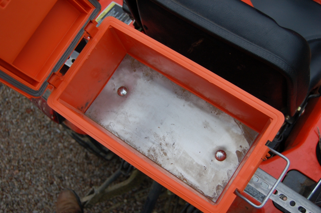

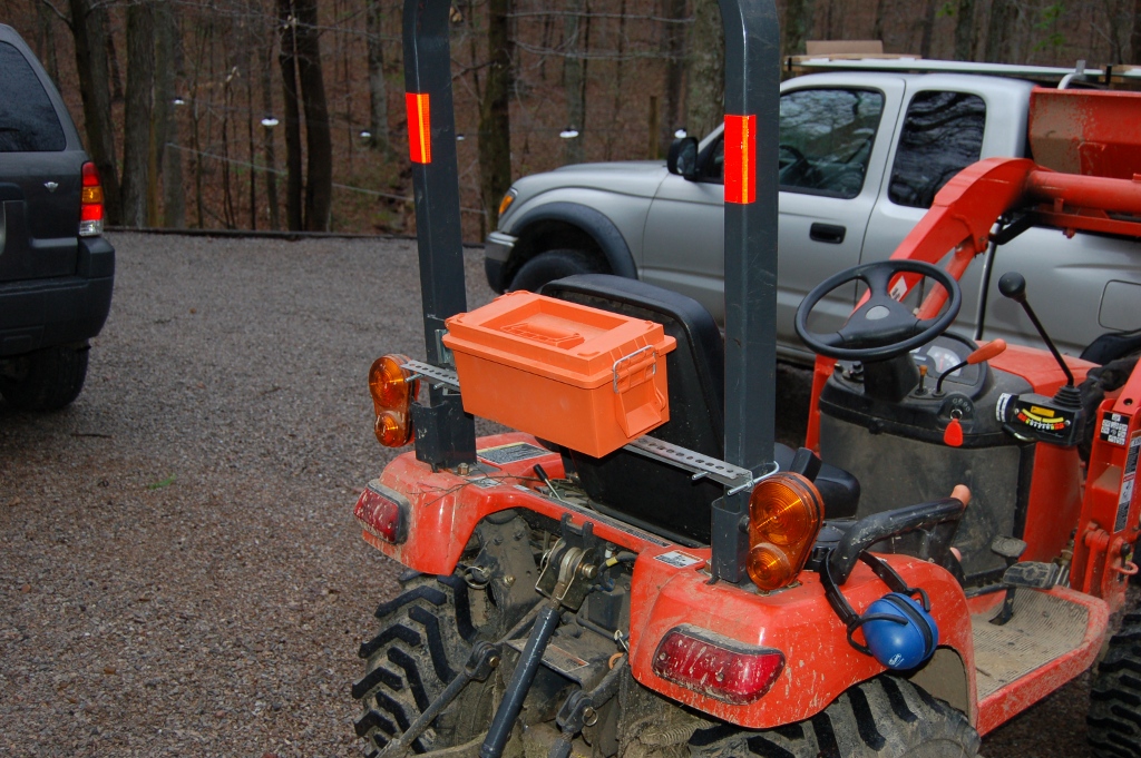

I just added a small toolbox to my BX2350. This is an easy project that only requires a little very simple metal fabrication.
The box itself is this toolbox from Northern Tool.

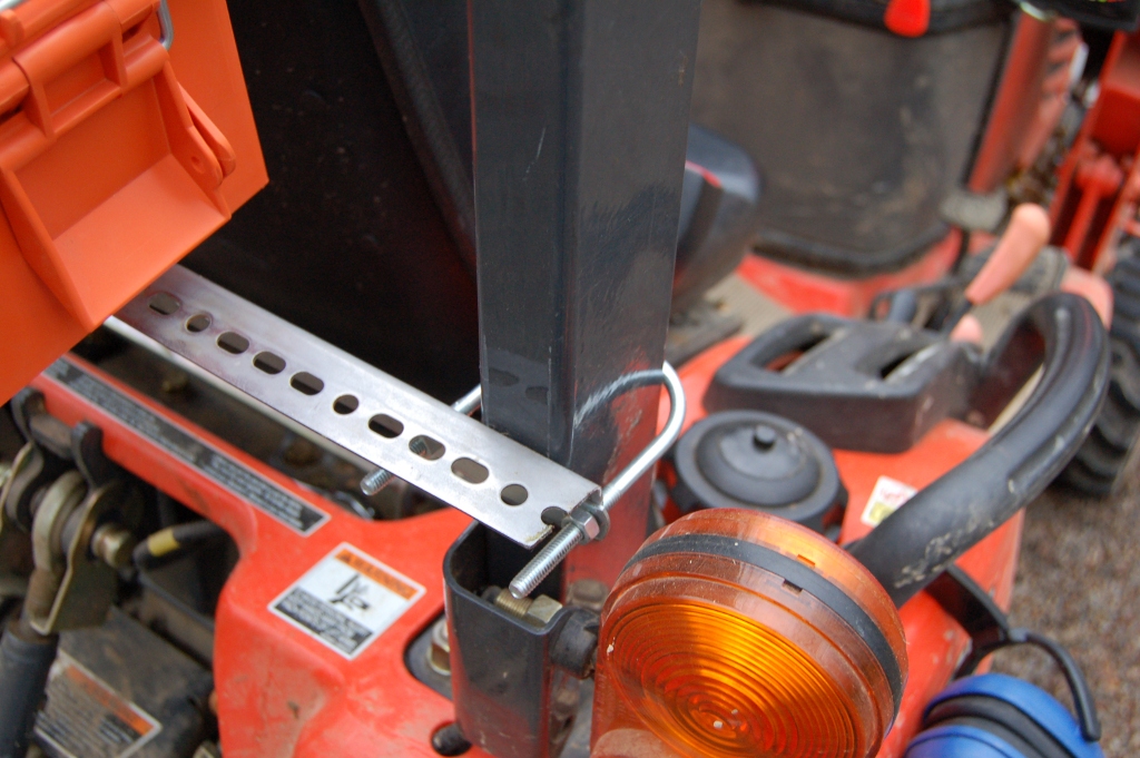

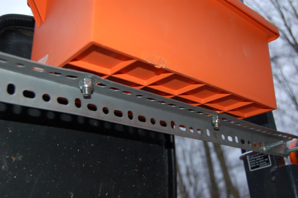

It's held on by two U-bolts and some angle iron.
Carriage bolts and nylon lock nuts attach the box to the angle iron.
I cut a piece of sheet metal from Lowe's (not sure what gauge I used) to reinforce the bottom of the toolbox. Without this, I doubt the plastic box would be able to hang on by two carriage bolts. The toughest part of the project for me was squaring the bolt holes in the metal. I think I ended up grinding them most of the way with a Dremel then just pounding the carriage bolt in there to finish the job.
It's not rock-solid but maybe sturdier than it looks. I had doubts until I tightened everything up. It's been on for around 10 hours and I'm very happy with it.

I meant to point out that in the first picture, you can see that the 25CDA Tilt Meter fits well on the loader valve.

Nice project. My only comment is to get rid of the sharp corners and put acorn nuts on the ends of the U bolts. I tend to leave a lot of skin on anything sharp.
/ Homemade toolbox examples #4
Now you have a place to keep some tools, spare pins and stuff. Your sheet metal bottom was a good idea. :thumbsup:

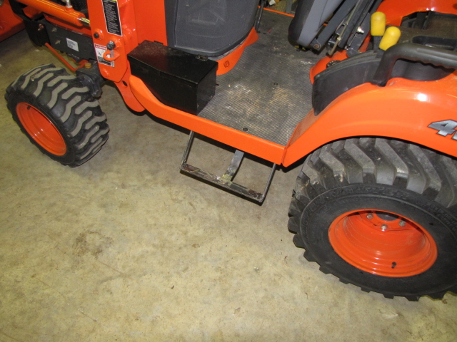

Hi Leejohn:
If I may inquire where did you get the step(if you have part # manufacture) or is it homemade. Find as getting older first step is getting harder esp with boots winter coat on!!
Thanx Pat R

I made it. I use one 5/16th bolt to hold it on, could hold it on with a pin. I haven't tried the pin yet because I thought it might rattle. It has to come off when I put my deck on, but only takes a min. It is also adjustable in and out about 1 1/2", I use mine all the way out. Maybe I could make you one if you would like one. PM me.
/ Homemade toolbox examples #19
Pat I just looked at your profile and see you have a BX23. I'm not sure that would work for you. Would have to do more checking before I could make one.
