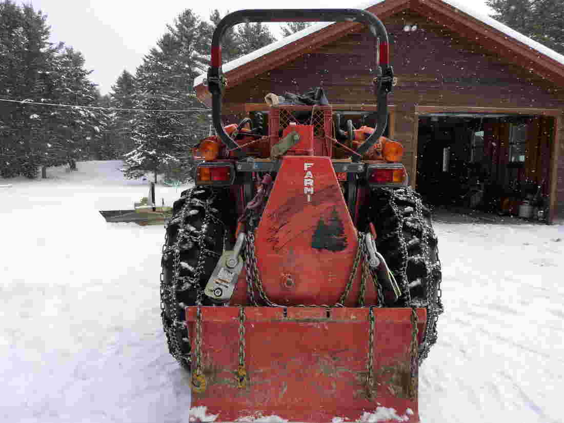

Here's my attempt at a tool box. Made it out of 3/4" square tubing and some expanded metal. Drill and tapped the frame to secure it. Added a place for my 2 year old son to stand.
Duck- here come the safety police!
I like it. I may have to copy that for mine
