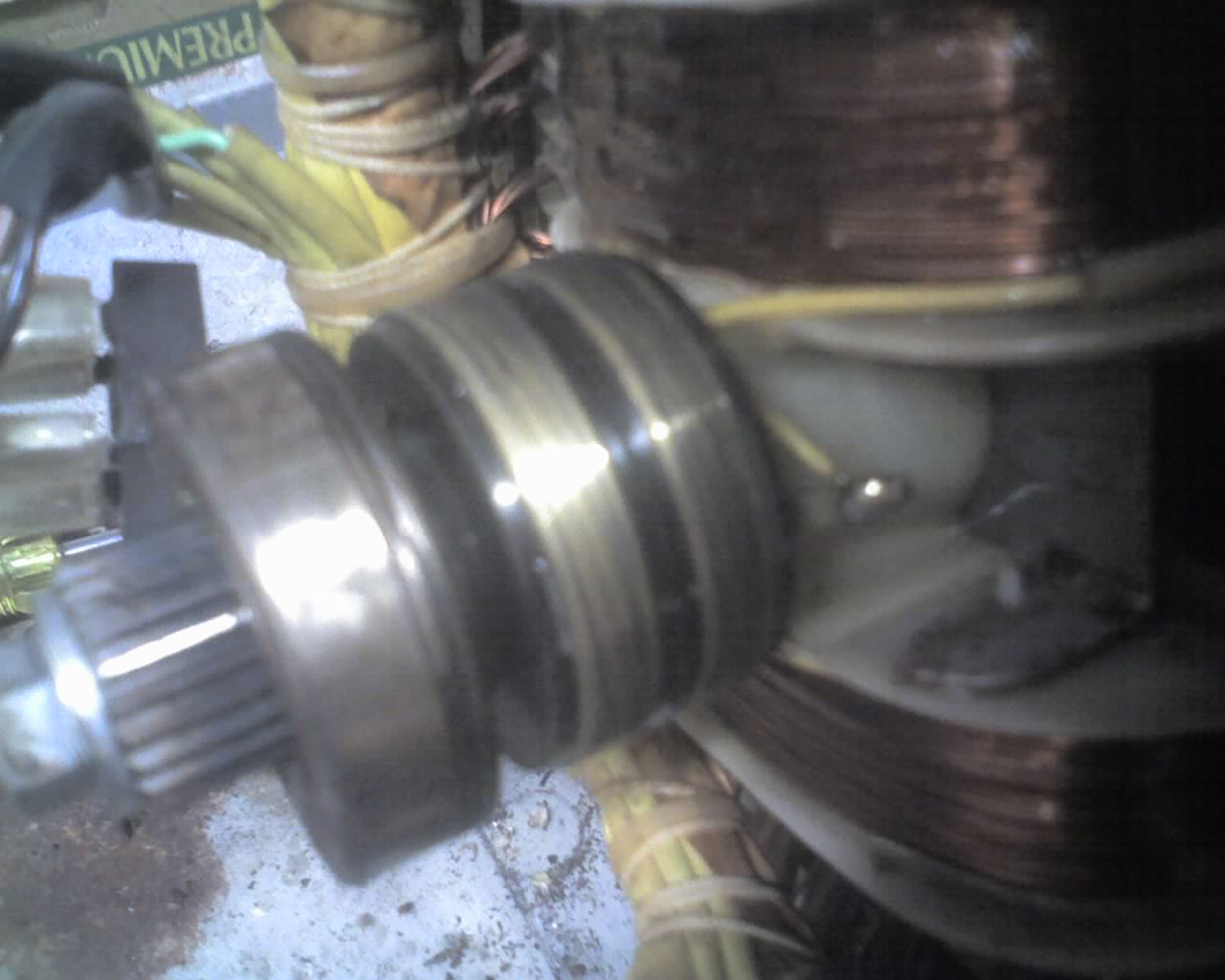

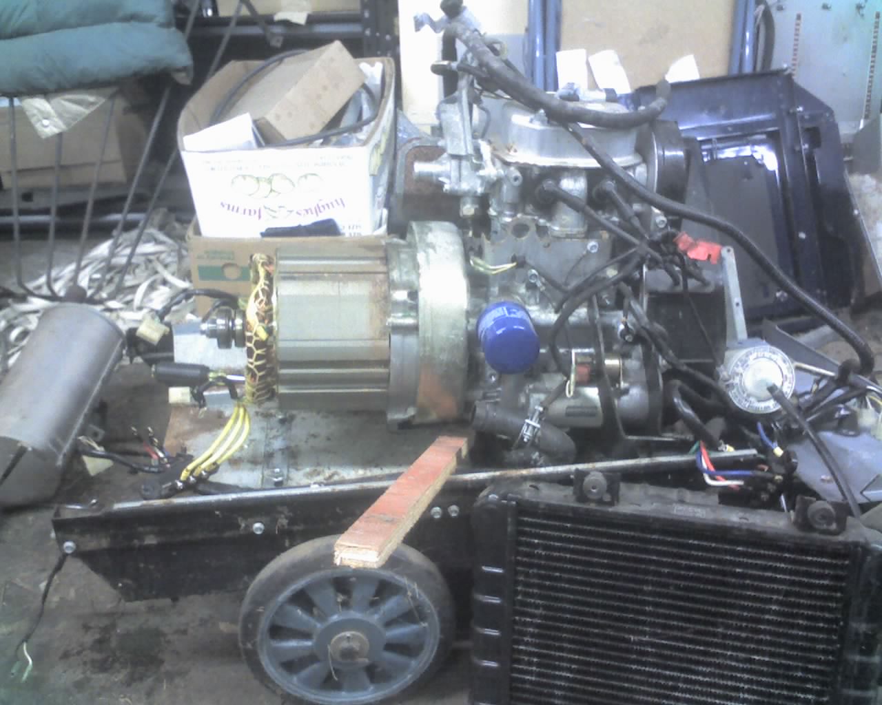

Well, I tore into the generator today. What a pain in the rear.
I started by taking readings on the brush contacts for the rotor. Spec calls for 50-75 ohms. At the brush contacts it read 549 ohms. The book then calls to remove the brushes and take readings on the slip plates for the brushes. I could not get to them so I treated the rotor as if it were bad meaning disassembly for removal. Here is a pic of the generator, or what was left of it, after disassembly.

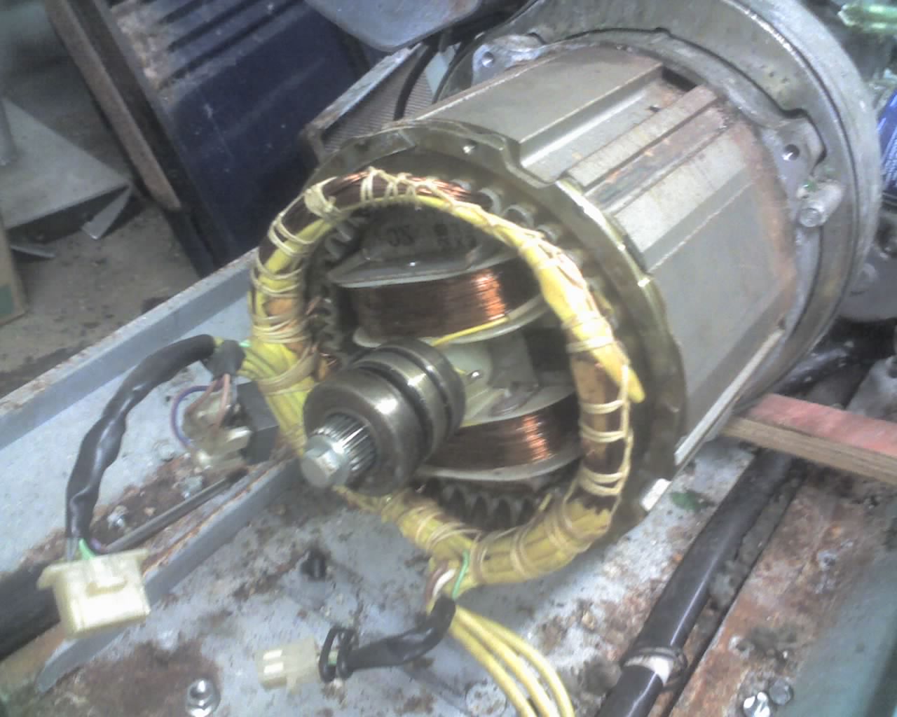

Once I got the front cover off the stator, I could see that the slip plates on the rotor were black. I took new readings and had a result of 59 ohms. The rotor is fine. I then spent about 1/2 hour cleaning the slip plates to get them back into good condition. Poor pix from my cell phone, but here are some pix of the rotor.
I'll be ordering new brushes and then testing again. I got the generator most of the way back together tonight. I felt that a certain portion of the reassembly needed to be done today while I still remembered how it came apart. The hardest part was actually figuring out how to get to the bolts for removing and reinstalling the muffler.:confused2:

I got the brushes and got them put on. 58 ohms through the brushes now. Still have to finish putting it back together. Probably won't have time to do that until November though. Already put in 42 hours of overtime at work this month and no breaks in sight until the end of the month.
   / Honda EX5500 Generator - no power output
#15
Today was my first day off since the 3rd. Got the generator reassembled and tested. Runs like it did when it was new. Couldn't ask for better results.:thumbsup:
