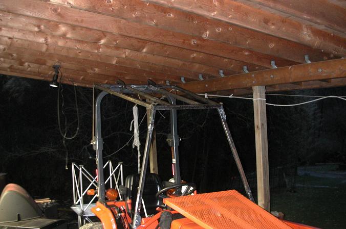

Bill ... that looks like a fun project. Well .. ummm .. how do I say this without offending ...
that last pic has me squirming a bit. if 1. that tractor went rubber up on uneven terrain, that 'head cover' might become a guillotine. 2. Build it strong enough so that a stout tree limb can't also bend it down and into your nostrils either.
I would be worried about this in a canopy tractor somewhat also, but they're usually plastic and would breakup with heavy forces on them. This metal square tubing will bend and I'd hate to see it bend into a life altering moment.
Perhaps I'm being a lil finicky .. but it threw a spook into me it did.
And expanded metal on the belly would rapidly become the largest lint catcher you could find .. only mother nature would supply the lint. Make up some skid plates outta sheet steel or buy one and modify it is my suggestion.

<font color="blue">that 'head cover' might become a guillotine </font>
Dap,
I know what you mean there. I had the same feeling about canopies...but I am pretty sure what I end up with will not fold more than about 45 degrees [in a major event, like a roll over], or be a hazzard. I also hope to make it strong enough that it would hold the tractor up, if the tractor tipped against a tree. As a matter of fact, I decided to incorporate supports from the front corners to the loader frame, just be sure. They will bolt on, so I can remove them and still have the top in place.
It seems to me that whaterver one had above his head, if it not supported at all four corners, it may fold down a little if the tractor rolled. But it would probably stop when at the point where a line drawn from the Rops the the grill guard is.
I am pretty sure that what I end up with will be a safety enhancement and not a liability. We will all have to look at it and decide after it is finished, I guess. /forums/images/graemlins/smile.gif I don't know about normal canopies, but I don't think they are so lightly made that they would less of a worry really.
I do appreciate you concern and your thoughts!

Had a chance to get a little more done on the head protector.
Its been cold and rainy and even had a lttle snow today. Not as much fun as the warm sunny weather... /forums/images/graemlins/frown.gif
This first shot shows the front supports that are bolted to the front corners and also down at the loader, at the point where the loader cross bar support is bolted.
I had thought about bolting these supports directly to the loader frame that remains on the tractor when the loader is taken off, but the joystick control valve got in the way.

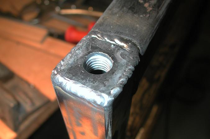

These supports are held to the top piece by bolts that thread into nuts which are welded inside the ends of the cross tube at the front. I welded nuts inside the ends of the cross tubes at all four corners.
I think tapering the "roof" towards the front was the right thing to do. It should not get in the way when I am moving between trees too much. The resulting angles did take more time figuring out how to cut though... /forums/images/graemlins/tongue.gif
It was dark and I could not really see what I was going to take the photo of, but I got a couple that show where I am at now...
Here is a side view. I stuck the tractor under the roof on the back of the house as I knew the rain was coming. Looks like we will have rain for another few days. April showers, May flowers and all that... /forums/images/graemlins/smile.gif

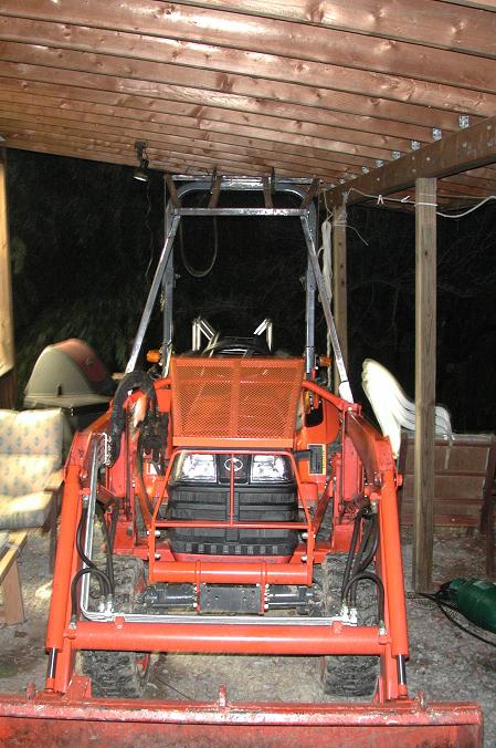

Front view...

1/2 inch nuts were welded on one side of a piece of 1/8 steel, and then the steel was welded on the end of the cross tubes. One nut at each corner. 1/2" grade 8 bolts will be used.

Couple of quick comments:
1. I think the adding of the support on the front of the "head protection" was a must.
2. Consider thick aluminum for the bash plate. It's used a lot on dirt bikes and while it will deform it will stop rocks, sticks etc flinging up under the tractor and protect the softer components.
3. How much was a cab? /forums/images/graemlins/smirk.gif

Stephan,
There is one more support piece that is not there in the photos to date, so the front supports may not be a must, but certainly do make things rock solid. More pics to come...
If I make a belly protector of some type, it will be a balance of weight vs protection I guess. With only 3.7 acres I don't have much to worry about on one hand, but on the other it is really not a question of space, but a question of where the thing is that will cause one the trouble. So I may make some sort of protective belly pan for welding practice, if for no other reason... /forums/images/graemlins/smile.gif Aluminum would work I'm sure...but when I think of aluminum I think "expensive."
