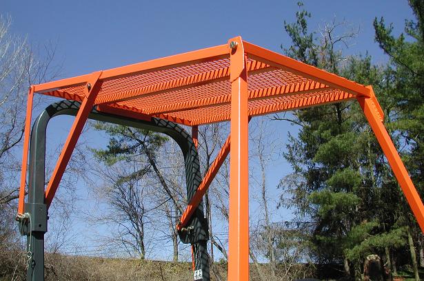

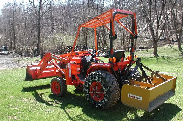

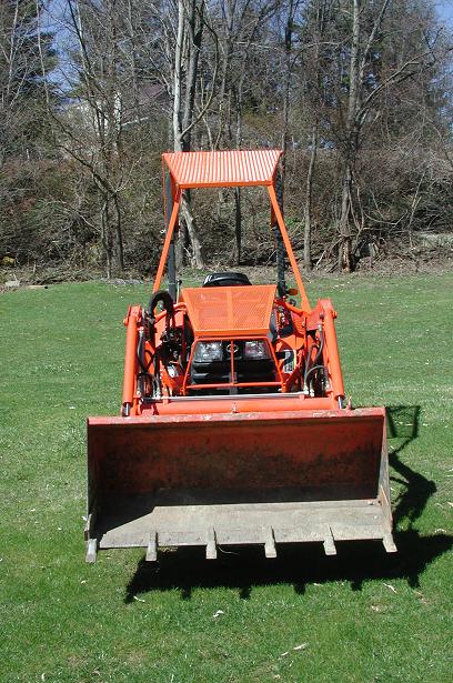

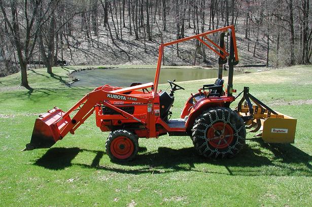

Well it's finished!
Always seems to take longer than it should!
I think I am pretty satisfied with the result. The height of the folding ROPS was a factor I had to live with. The head guard only adds about an inch and a half to the height. Plenty of head room, but if I try to stand up…not enough. That is no problem for me.
It is actually quite strong. The front supports remove easily and the top could be used as a canopy if I wanted to, but actually there is no reason to remove those front supports, because you hardly notice them there when you are in the driver’s seat.
The front dropping down and being narrower than the back keeps things out of the way. I don’t think this thing will get in the way at all, where I will use it. I can still see me sneaking between trees and so on, just like before, because the ROPS was always there anyway.
It was a great day for photos! I got about ten to post. Hope I don’t tire you guys out!

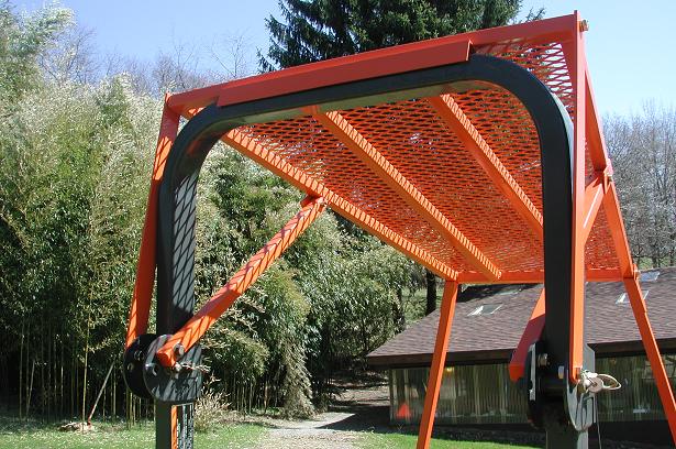

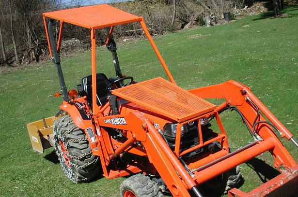

I did not drill my ROPS (yet). I did however drill 2 half-inch holes in the ears of the hinge assembly. Had I thought more carefully, I could have used one existing hole (or both if I could find the right bolt). I am thinking I may drill two holes in the top crosspiece to prevent the guard from slipping sideways in an event, if one should happen. I will decide later on that.

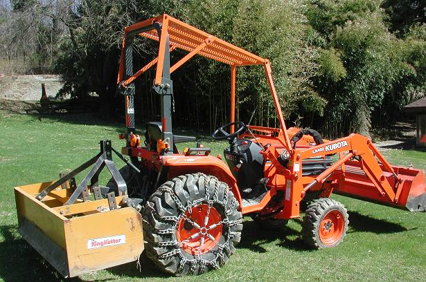

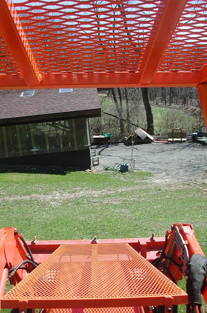

View from the driver’s seat
   / Hood Guard…Head Guard
#46

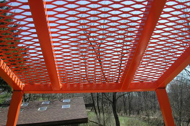

Easy to see through this 9 gauge diamond expanded metal. Works just as I had hoped.

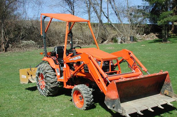

Ready to work
