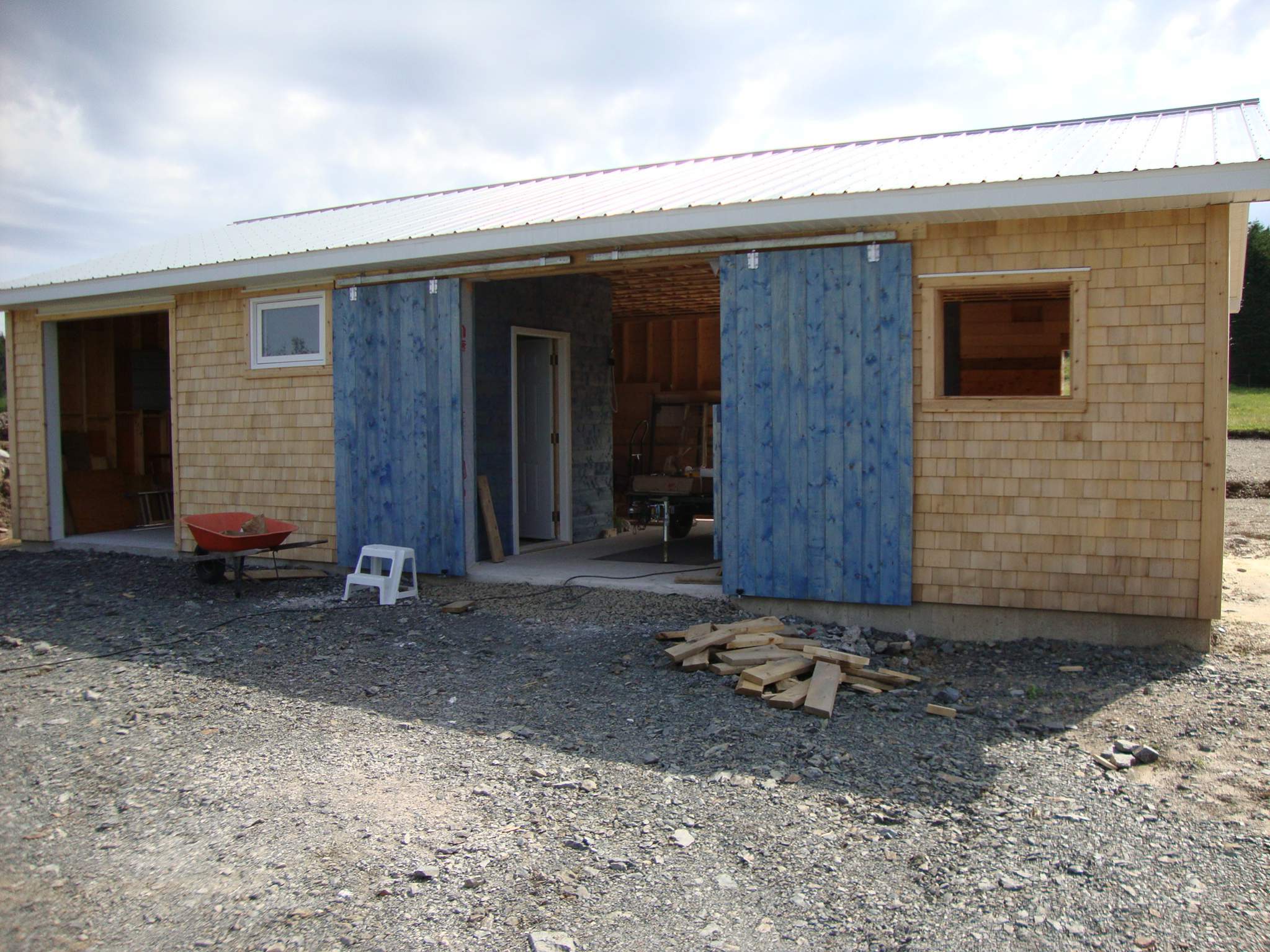

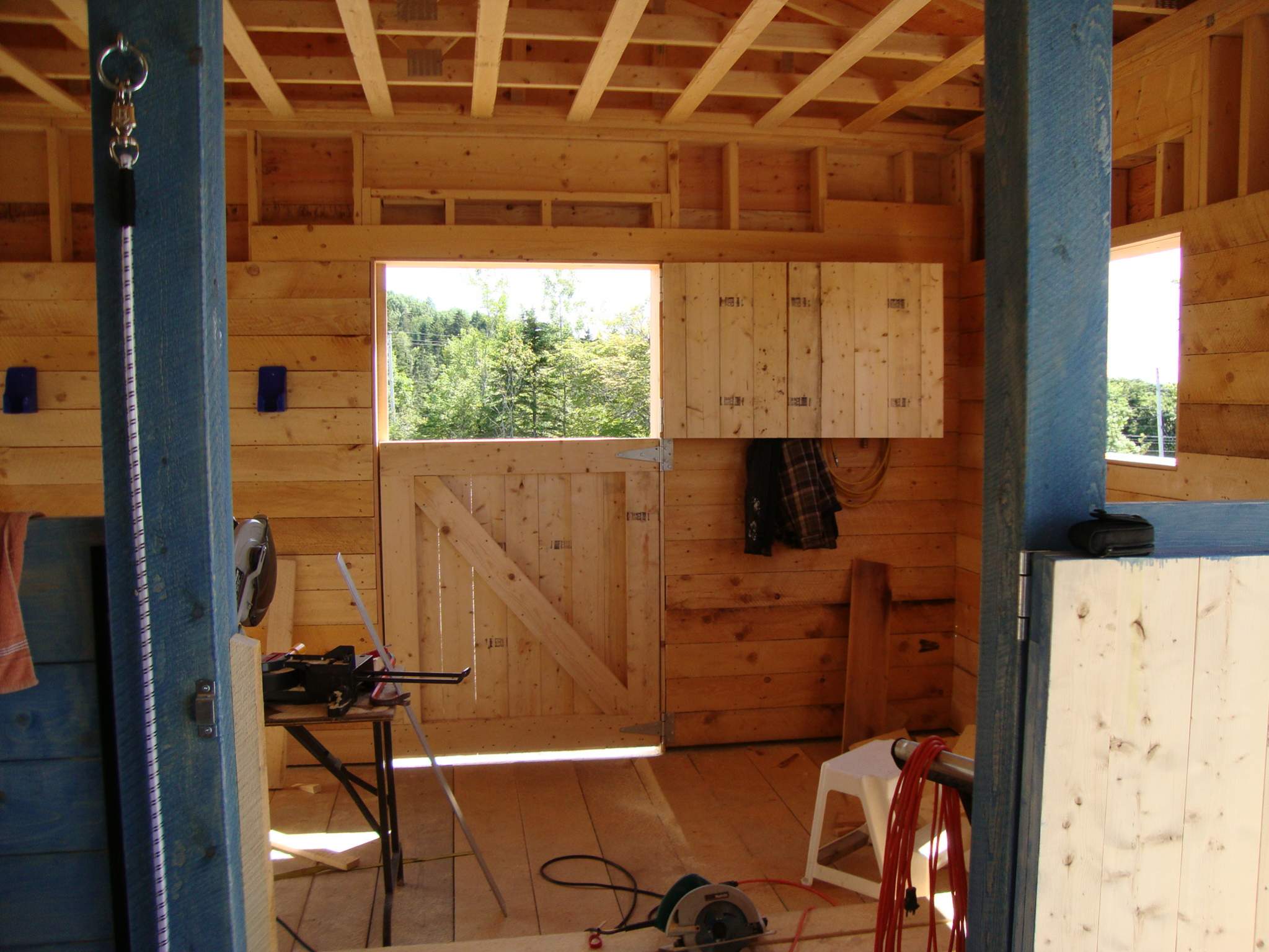

/ Horse barn project
#64

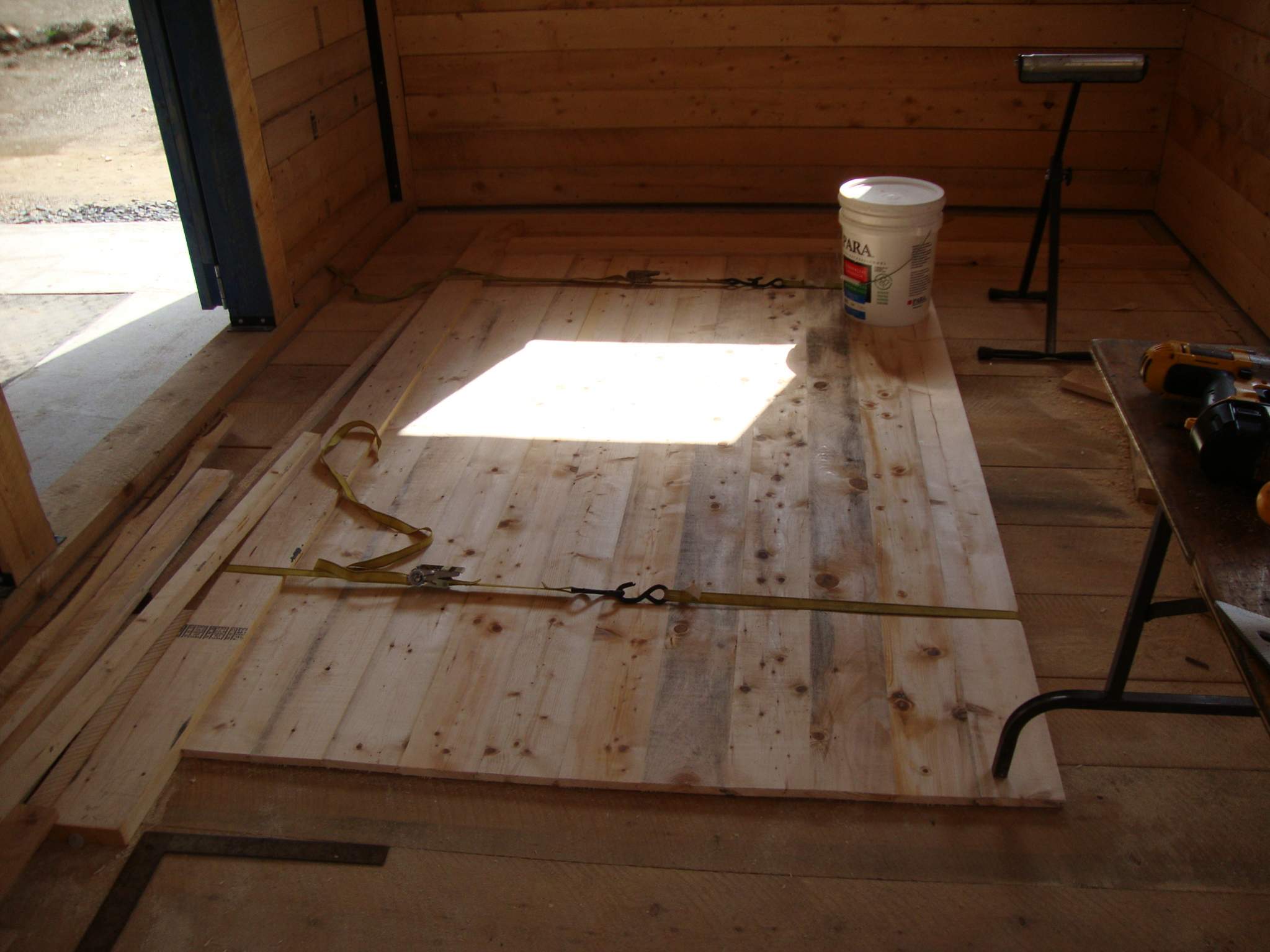

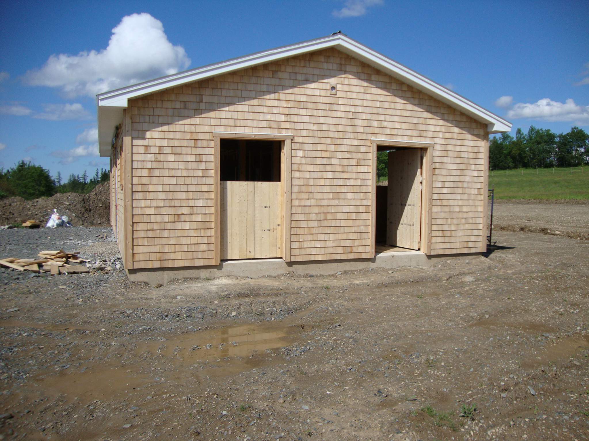

Sliding doors are finished and hung, and the dutch doors for the stalls' in-and-out doors are finished and hung. We built those in one piece, then cut the top off.
I finally wised up and built an L-frame for building the sliders, it kept everything square and I could put a ratchet strap around the boards and squeeze 'em up tight before putting screws in.
The overhead door is going together now, first one I've put in myself. Not nearly as bad as I thought.
Electrician should be here momentarily, which means I've got a few loose ends to tie up before he gets started.
Sean

/ Horse barn project #70
Very nice barn project there Chilly :thumbsup: I have one question though.. shouldn't the dutch doors on the stalls swing out from the stall with the plain board side facing in? That way bored or mischevious ponies don't have as much opportunity to chew or tug the door.
#71
You're probably right John, and our inner stall doors are built that way. When we decided to go with the dutch doors' smooth side out, we were more concerned with getting them weather-tight as possible. The framing and braces would be a water trap, and having the smooth side out allows us to add battens vertically over the cracks that form as the lumber dries out.
Normally the doors will be open, the only time we close them is if we want to keep them in for some reason, i.e. sick horse or a bad storm. Ours stay out all night and most all winter unless the weather is really bad.
Sean

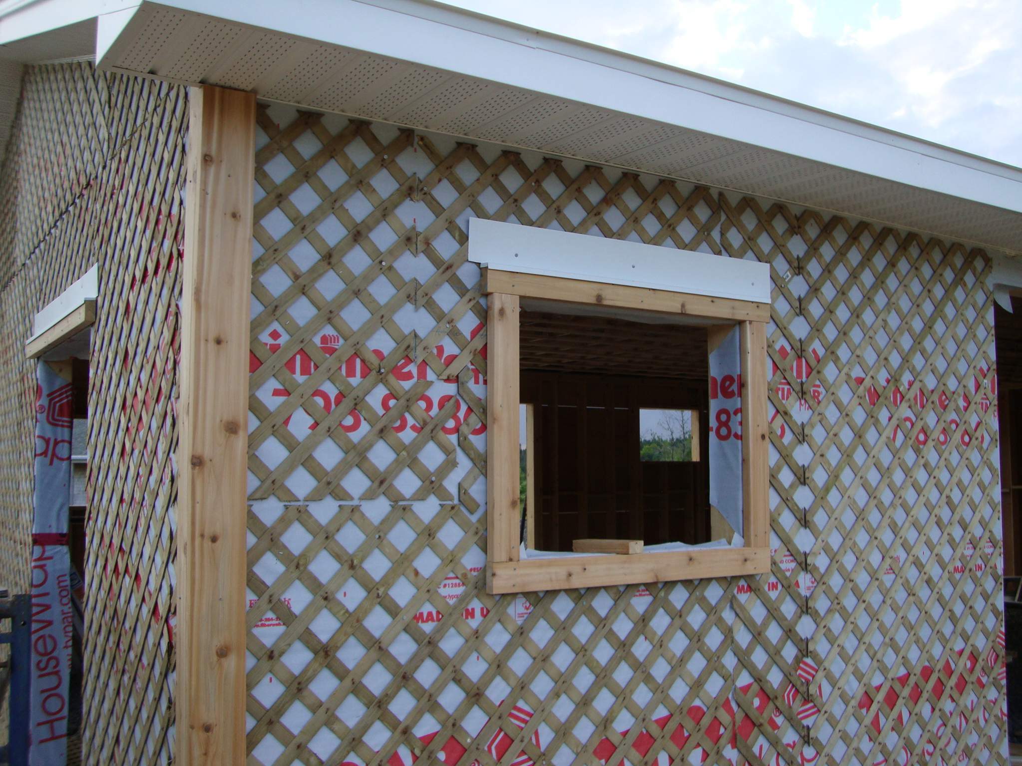

Sean, One very well thought out project and one terrific job. Beautiful horses who I am sure will love their new home. Very Nice Job!! I certainly like the lattice idea....never seen that before.
Harry
#75
Harry
Thanks Harry,

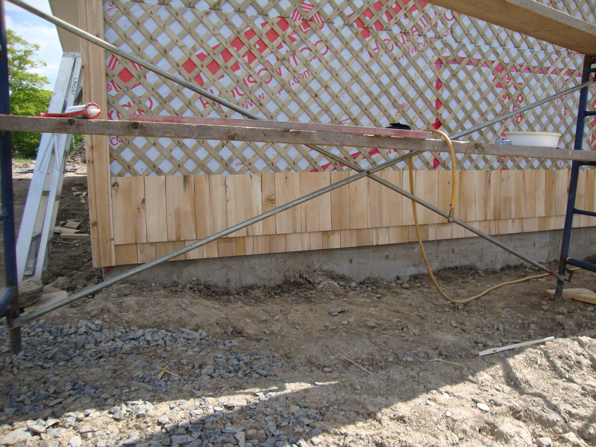

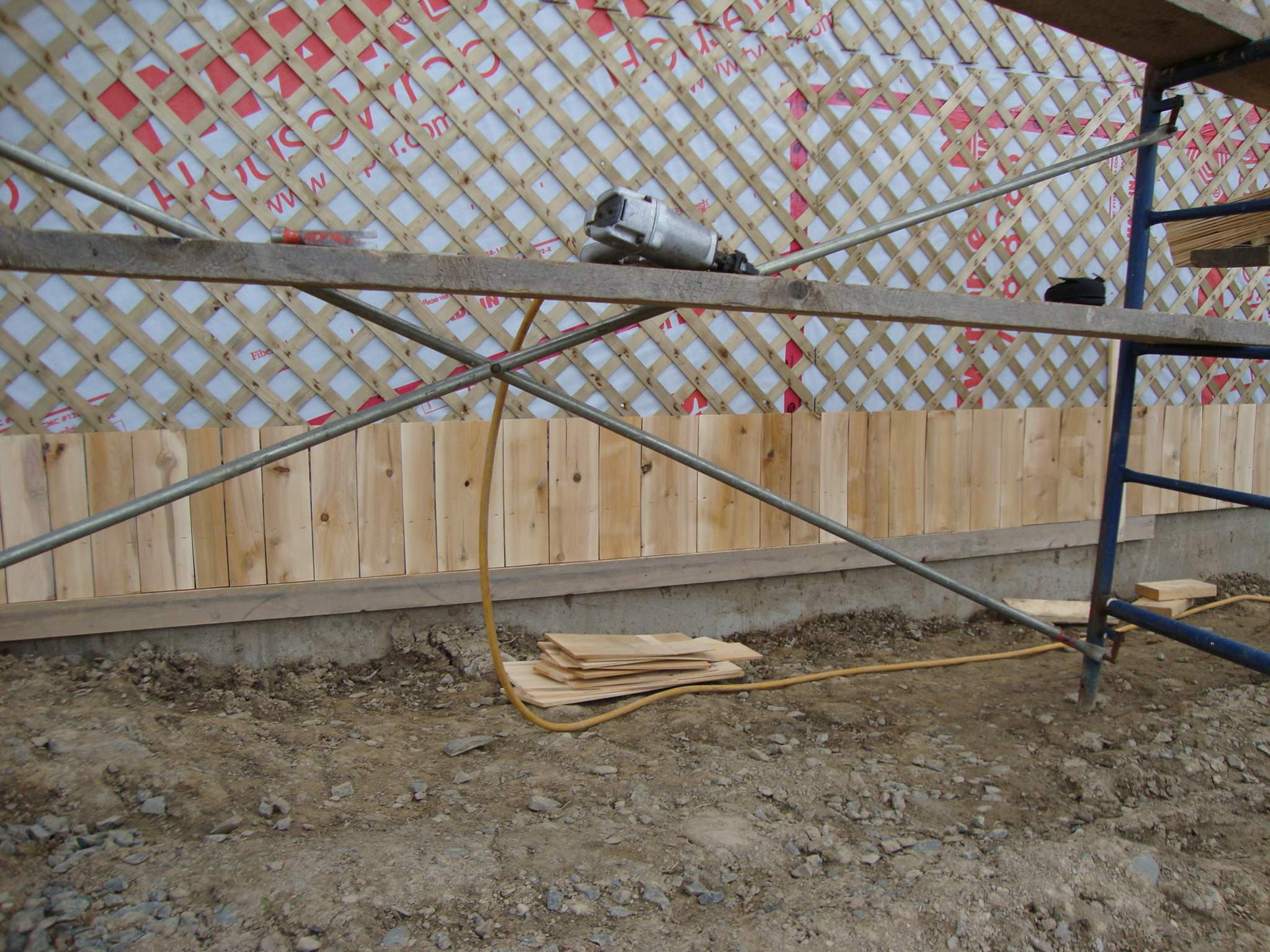

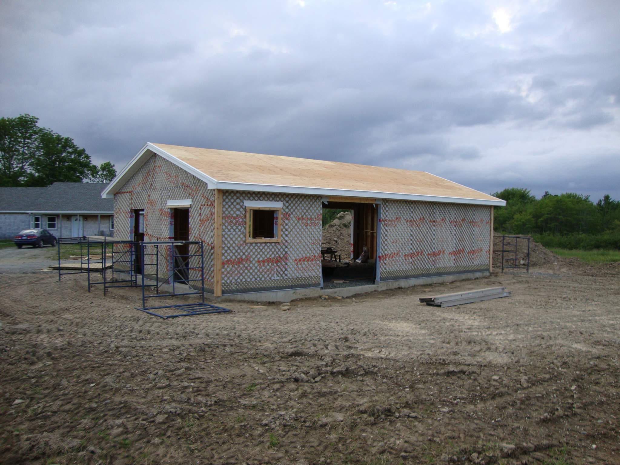

We spent some time designing it, although as usual there are a few things we would have done differently in retrospect. All in all, it turned out OK... the lattice is called for by the building code here, to create an airspace behind solid siding such as the cedar shingles.
Part of the goal was to build something that complements our house, which is about 150 feet from the barn. Both have the cedar shingles and trim, and both are single story buildings. If I had my time back I'd have put steel on the house roof as well.

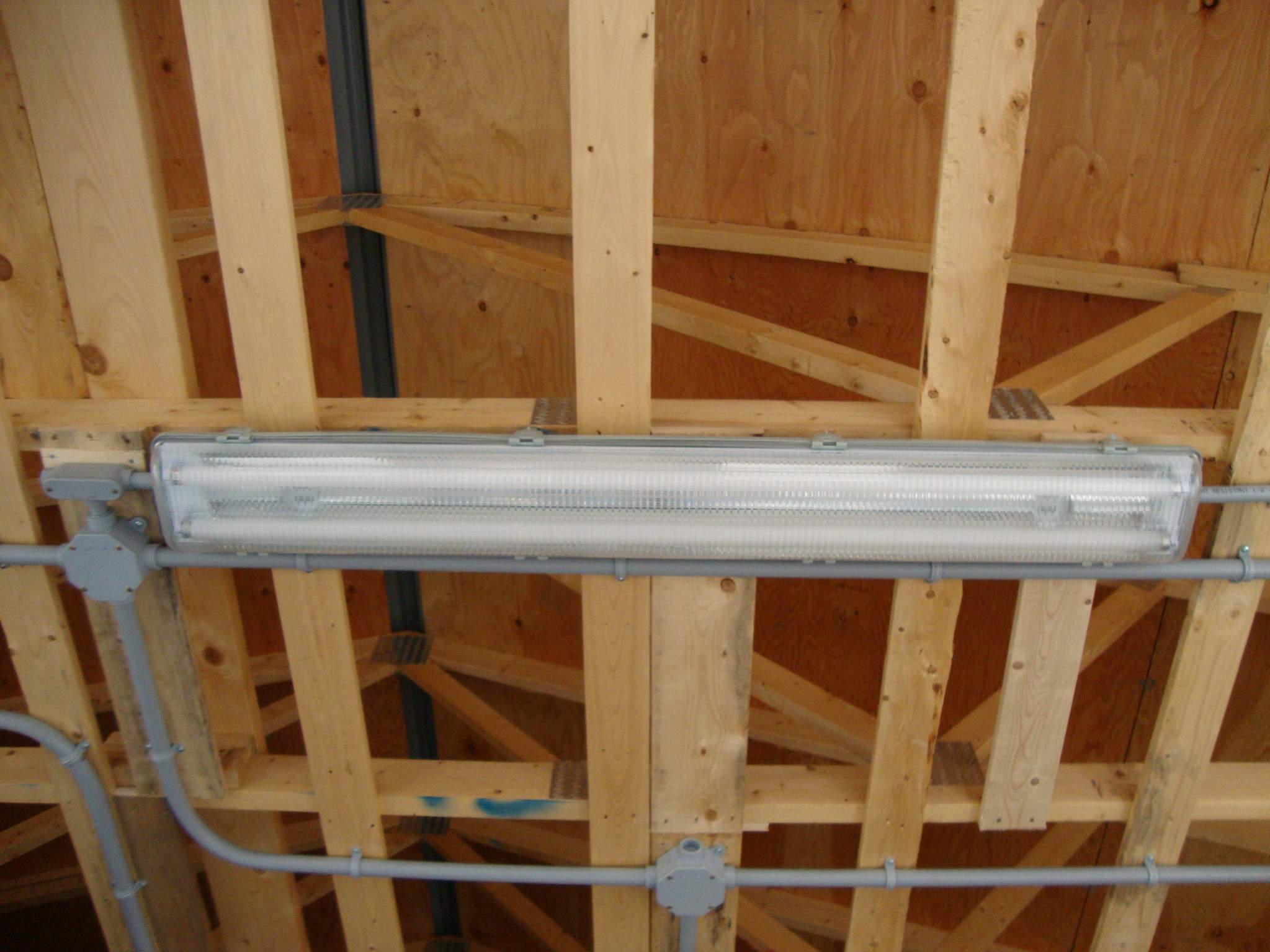

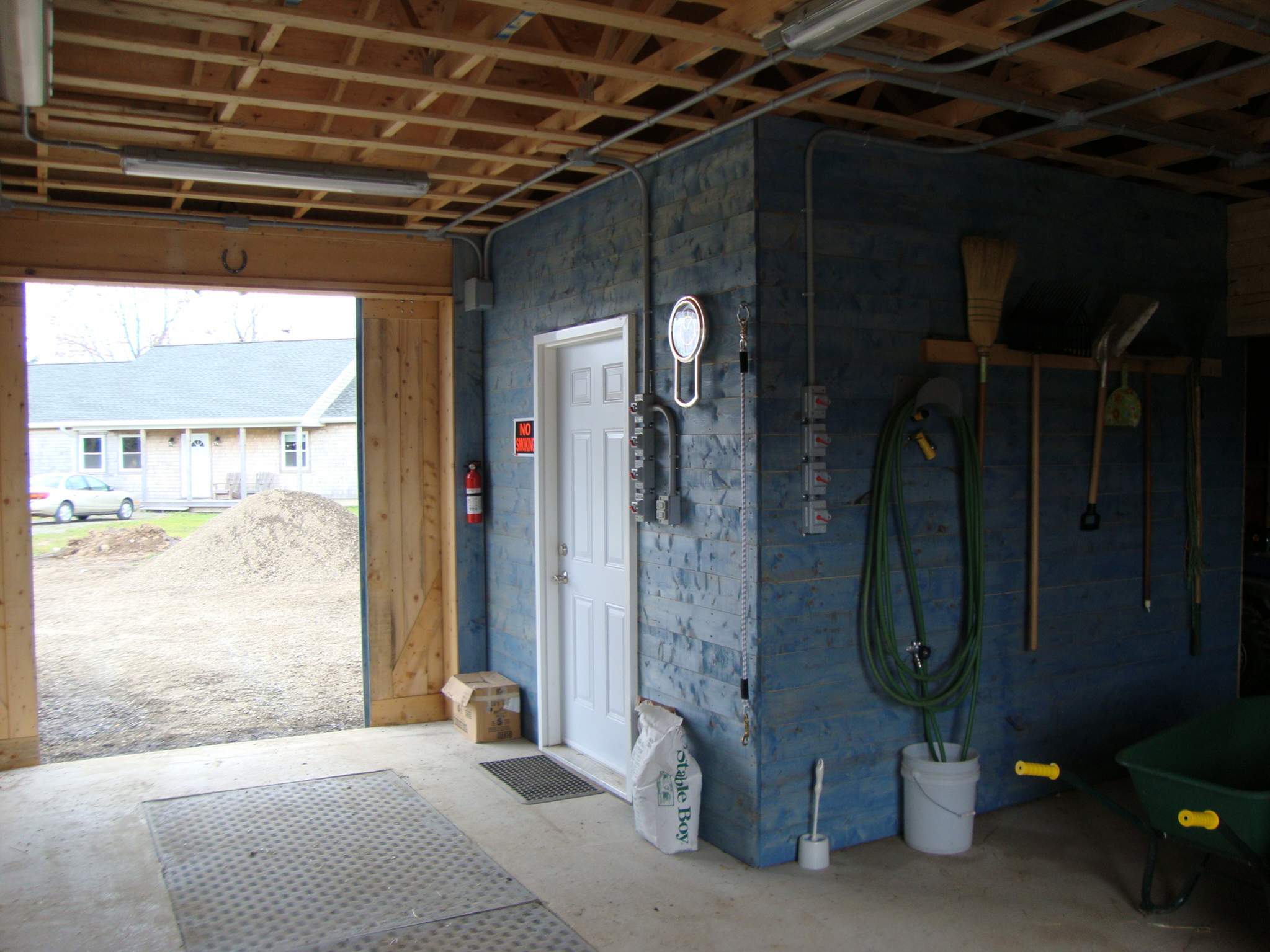

#76

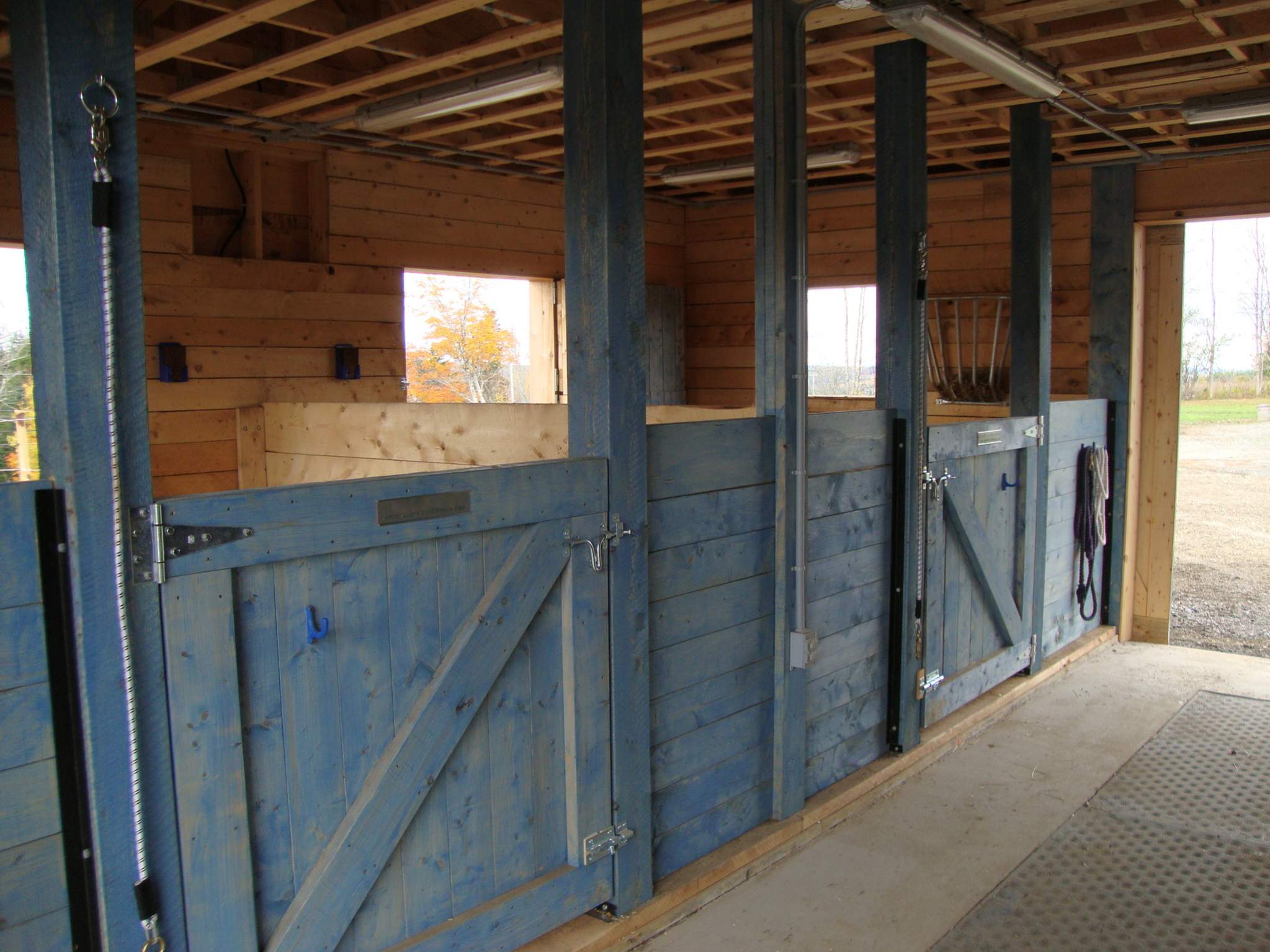

We have the critters moved in, finally. Fencing was the last hurdle, and we're over it.
The electrical turned out really nice, we used PVC conduit or Tec cable throughout as well as weatherproof switches and plugs, and T8 vapor tight fluorescent fixtures.
Sean

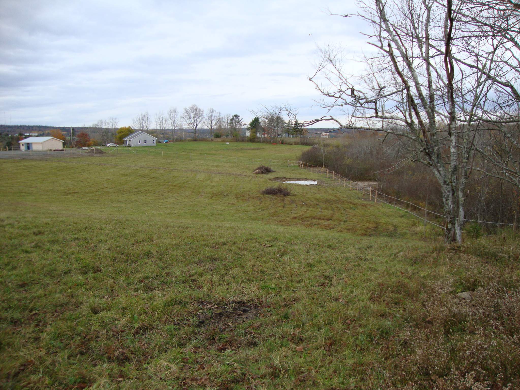

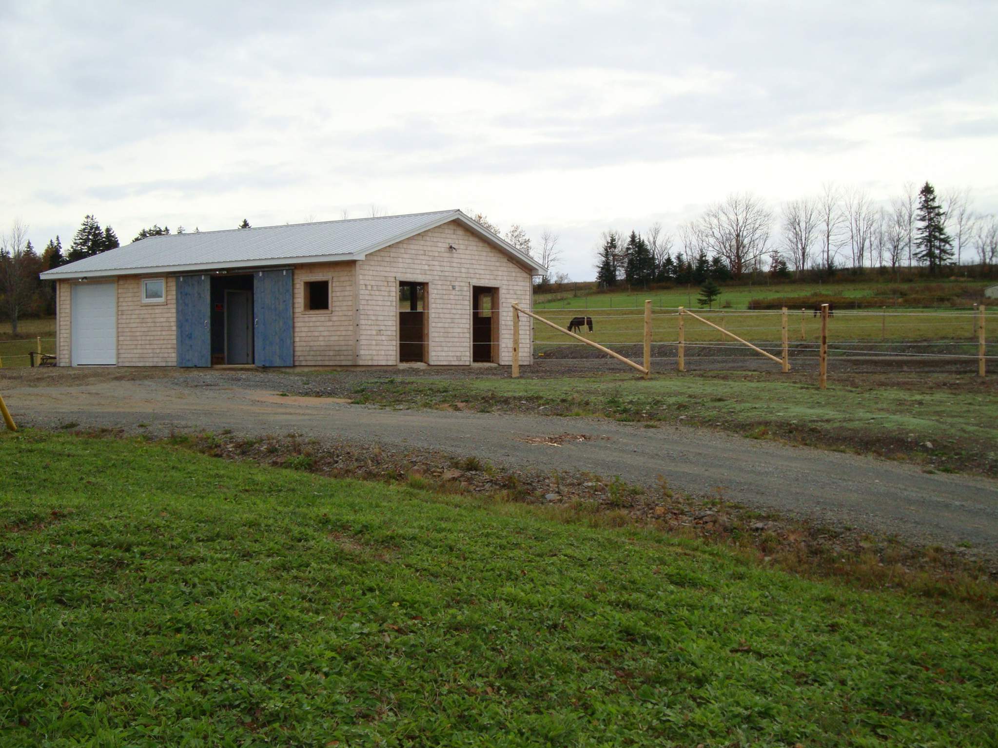

#77

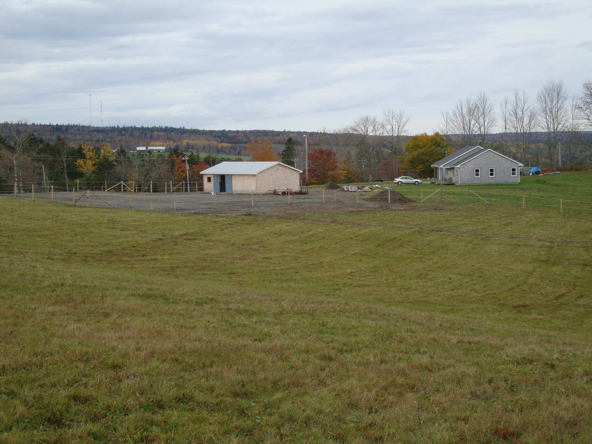

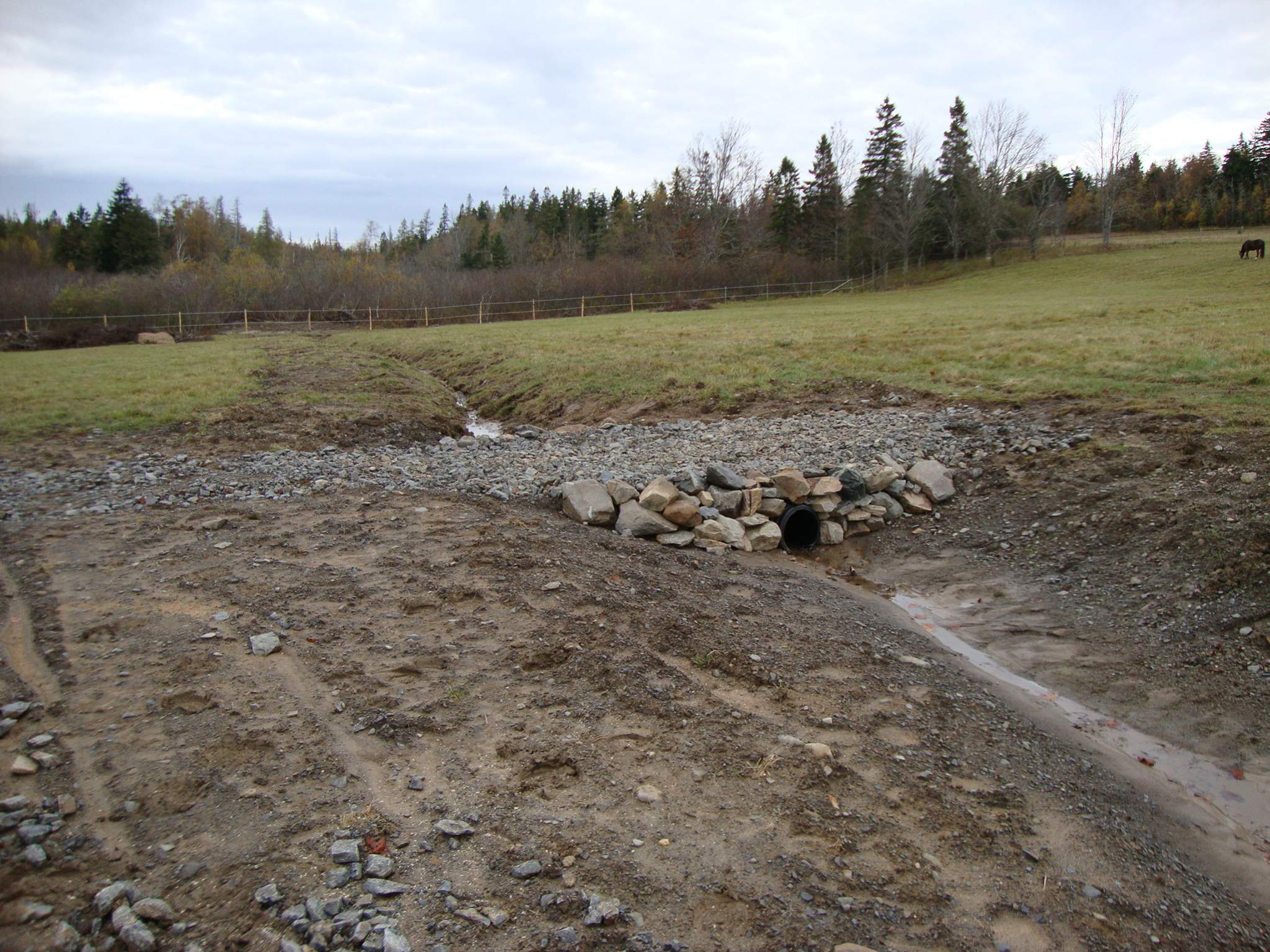

We added a culvert to the swale that feeds our pond, from the amount of rain we've had I think it was a good choice.
The inmates seem pretty happy with the new digs, they spent a good part of the day yesterday napping in the field. When they relax like that, they're at home.
