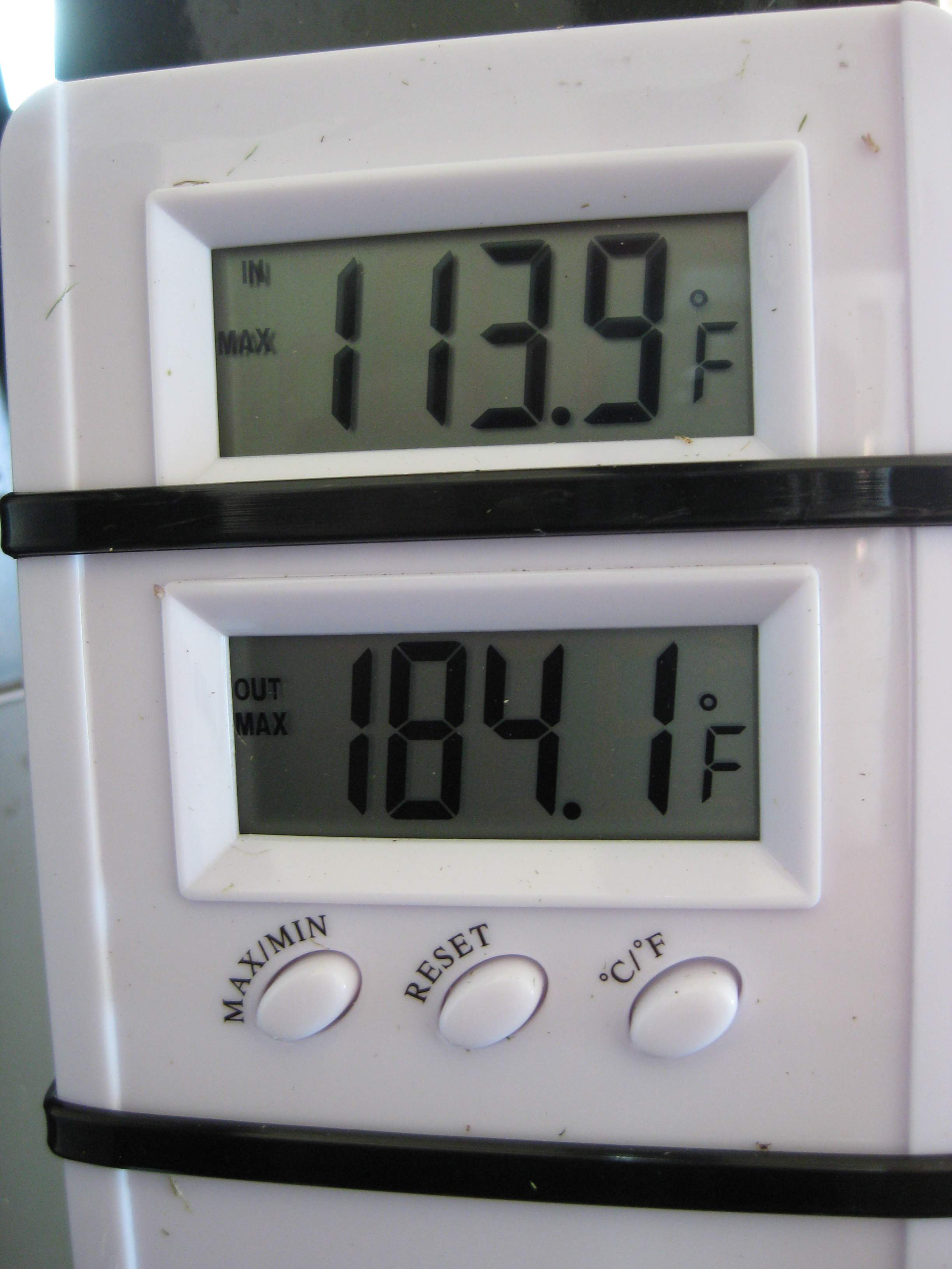

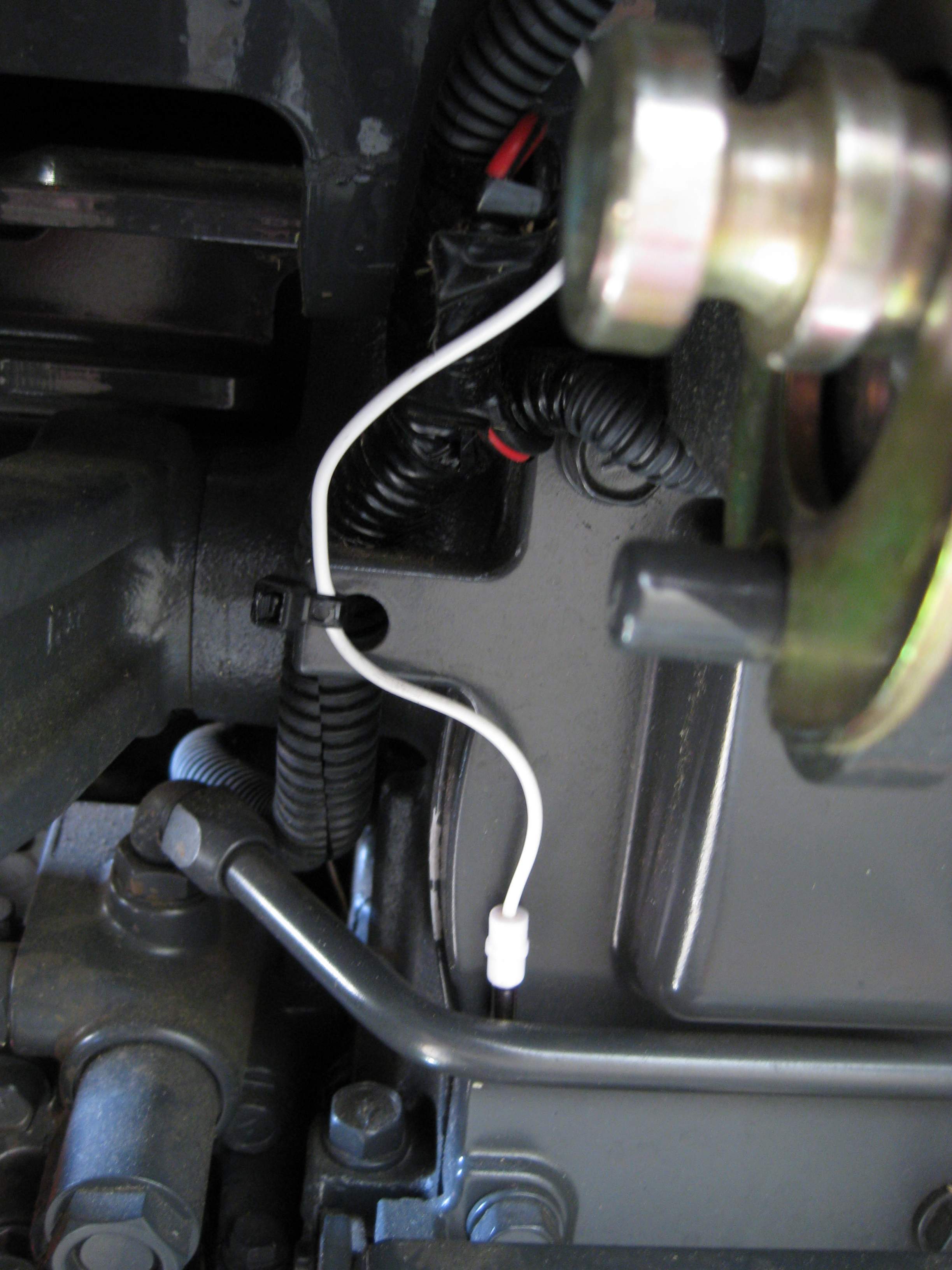

I found this in a dusty box at the local Big Box store . $6 ! (AAA battery)
Top temp is air temp ( with sun shining on it ..... ) and the bottom
temp is probe temp . Photo taken showing maximums recorded a
couple of weeks ago before the weather cooled off.
With a trans starting temp of 75f ( in the shop ) , this oil
temp took 60 mins to be attained .
