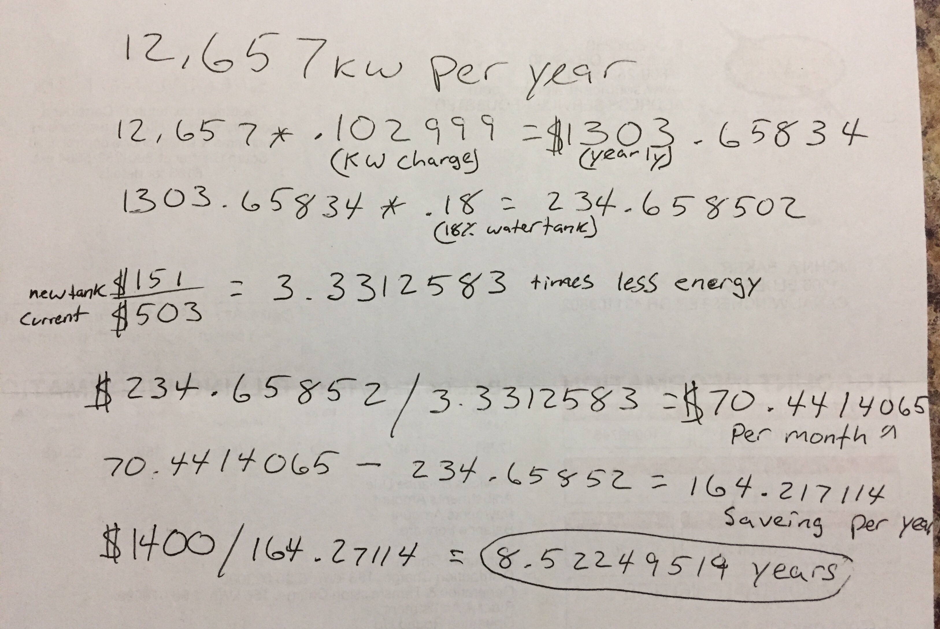

I bought the Rheem hybrid water heater you pictured in January, after a power surge fried my previous electric heater. The yellow energy sticker stated 151 dollars/year on the hybrid vs 505 on the previous 5 year old heater.
In the 3 months we've had it, our electric bill has been running 75-80 dollars less each month. Not sure how much the weather enters into that, it's been a mild but wet winter so far. The utility co. Rebated 300 dollars of the 995 original cost. So far, I am happy with the heater, and probably won't go back to a non hybrid when this one goes out.
I installed this one myself, it was easy using pex and shark bite fittings, and didn't bother with the wifi stuff. Mine is in my garage, and the one thing I didn't expect was the large amount of condensation output from the unit. Right now, it just empties into a bucket, which I empty every day. When the weather dries up, I will need to install a drain line running out through the foundation. Hope that anyone installing one in their basement has a floor drain.

Broke,
When trying to justify a new unit like this by citing the payback as a reason, you have to somehow factor in the reliability too. We can never do that, so it just becomes a best case bet. If the payback is 8 years, you're even money at 8 years and haven't saved a thing. Now, after that is when the savings begin, and your starting out with an 8 year old appliance.
If that appliance is not 100% reliable the payback moves farther and farther into the future.
If your existing water heater failed, it would make more sense to replace it with something you believed was better and weigh the costs at that time. I like the utility rebate idea too. Maybe yours does that. Of course you'll have to fill out the forms, get a permit and inspection, etc. So factor that in too.
It has become abundantly clear to me, with a hydronic heating business for almost 40 years, that simplicity and proven components are the key to success. I strive to make systems simple. That doesn't mean they don't have capability, just the opposite, they do it all with the minimum of parts and therefore increased reliability and low build cost.
I've mentioned it already, but if you only want BTUs at the lowest cost with the best reliability for the long run, you probably can't do better than with thermal solar.
Another trap that people fall into is to make the leap that since they have an efficient system, or a perceived efficient system, that they can be more careless with use. Of course they can, but if the original intention was to save money, they don't. That is part of the fallacy of tankless water heaters. "If it's more efficient, we can take longer showers, and we never run out of hot water".
People always have only two answers to my question after a year or so of having one of my systems. The question is: did your bill go down? If the answer is no, it's only because they are now heating to a higher temp or heating more rooms than before. In other words, they answer that they are heating more and like the added comfort, for the same cost, or they noticed a significant reduction in the bill.
In your case you've said you are willing to work on it to save repair costs. Cool. You'll have fun hunting down parts while your family takes cold showers. Hmmmm, is that negative enough?
In my case, when I have given a guarantee, I have to perform or take the hit.
I really hope heat pump water heating is reliable. It's a great idea. If the Rheem unit is as reliable as a household refrigerator they will have a great product.

I'm kinda surprised so many people here have the hybrid water heaters, nothing bad about them so far. When I did my calculations I figured that my bill would go down $10-$15 a month, could be more but that's the figure I came up with.

But people should take pen to paper and write it down. I actually prefer spreadsheets. Take a $1000. See how many months it will take you to break even. Then take take $1000 and look at rate of returns on mutual funds. Subtract taxes you will pay because it will be income. The mutual fund is making money. The water heater is starting out in the hole.
If you need a water heater, subtract the cost of a normal one from the cost of the expensive one. That helps. Even then it is hard to break ahead. You have increased labor cost, it is not a one for one swap. It needs a direct vent. I was a plumber, and even given that, it just wasn't worth doubling the cost of material.
Some people like carrying risk and having a mortgage. So they spend 3% on mortgage, which they can deduct 25%. As long as they have enough to deduct. So they invest it, for say 7-10. Which they are paying tax on too. It can work out. Myself, I listen to Dave Ramsey. He did a study. 100% of foreclosed homes had a mortgage.
But mortgage have nothing to do with this conversion. Reduce this to buying a $500 widget or $1000 widget, that saves you $10 a month. Remove everything except numbers.
