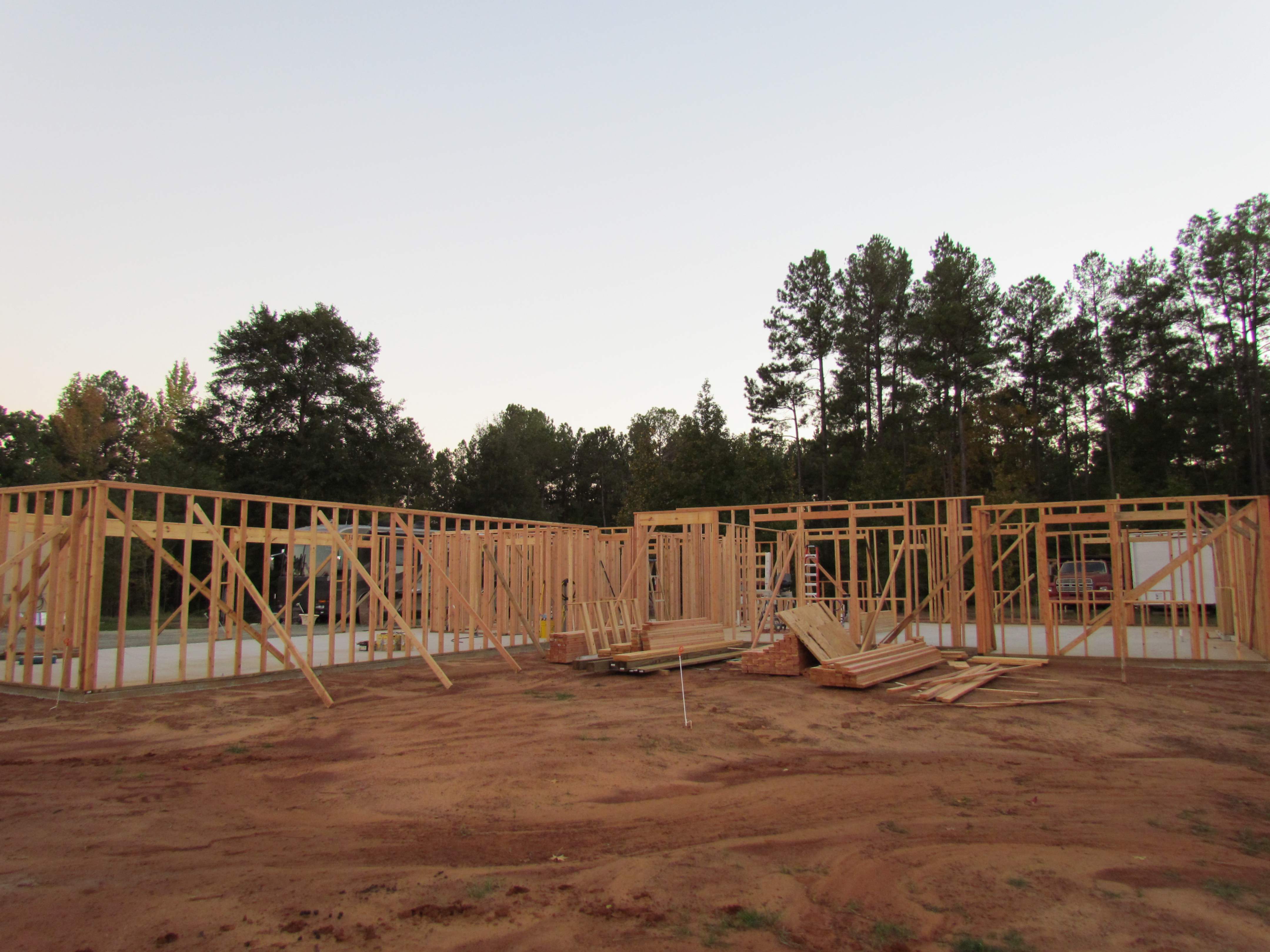

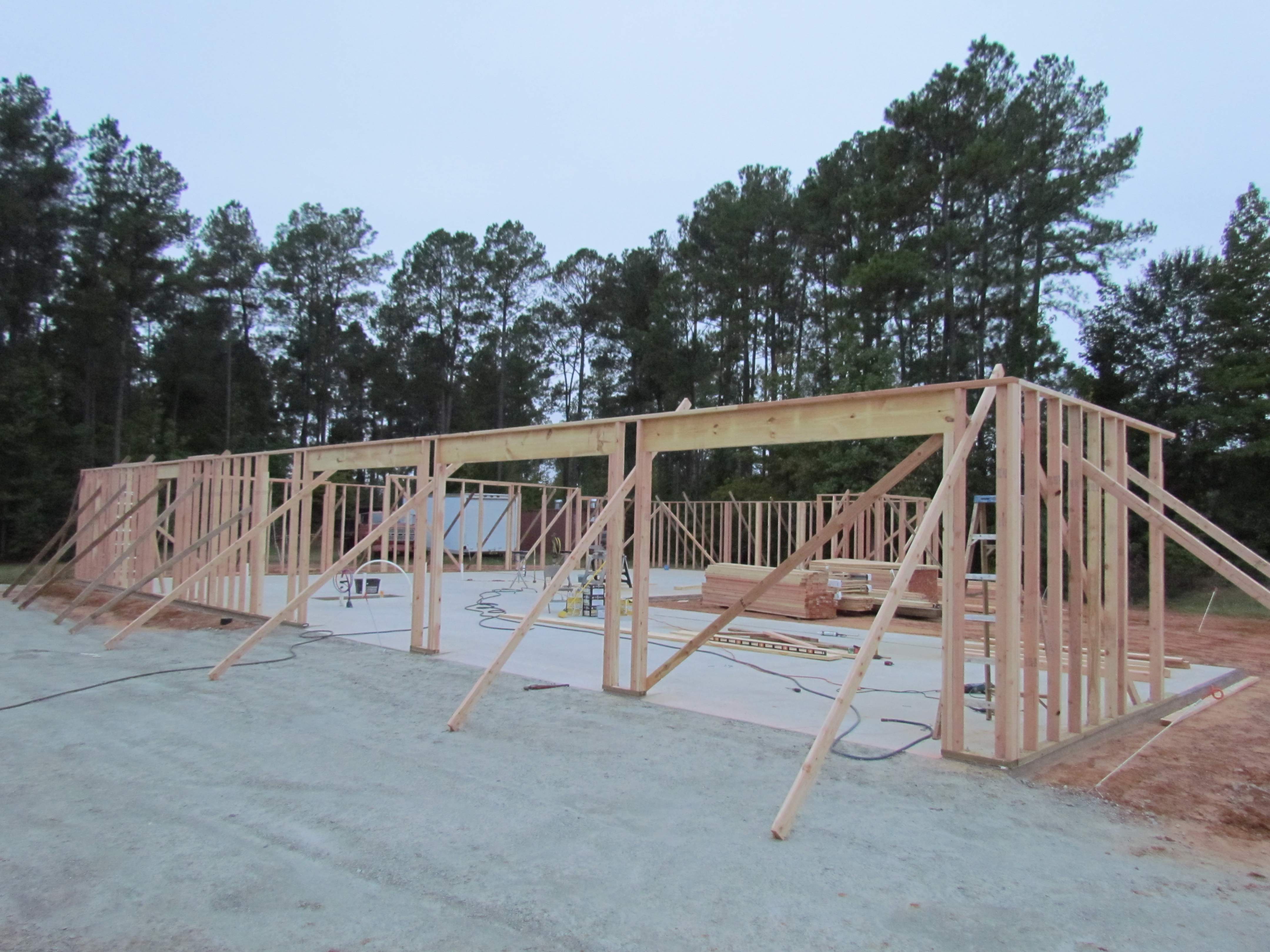

Started framing this weekend.
Eddie
   / House for my Parents #95
All that in a weekend, wow! How about more pics, its interesting to watch a pro at work. Are those 2x6 studs, 16' O/C ?
Dave

Dave,
I'm using 2x4's on 16 inch centers. 8 foot walls for the bedrooms and common areas, 9 foot walls in the great room that will include the living room, kitchen and dining room.
I'm doing all the measuring and framing, they are helping with bringing me what I need, cutting jack studs and holding the wall in place while I drilll for the bolts and attach the supports.
They are good helpers, but struggle with understanding what I'm doing or what happens next. No concept of what they cannot see, or what has to be done to get there.
If you look close, you'll see that there are no headers over the windows or walk through doors, and only one 2x12 above the garage doors. Dad will cut and install those during the day while I'm at work. If he gets that done, I'll go over cripple studs with him and have him do those next.
Kyle,
We debated on roof pitch and have decided on 9:12 They both hated steeper and where split on flatter. This will give some room for attic storage, but with trusses over the garage, it's not going to be very easy to get around up there. I'm a firm believer that for insulation to work in an attic, you cannot store anything or evey walk through there, so all the space above the living areas will be off limits to storage.
The master plan includes two more storage buildings. Both have sort of been started and laid out, but are way low on the priority list. Once done, storage wont be a concern.

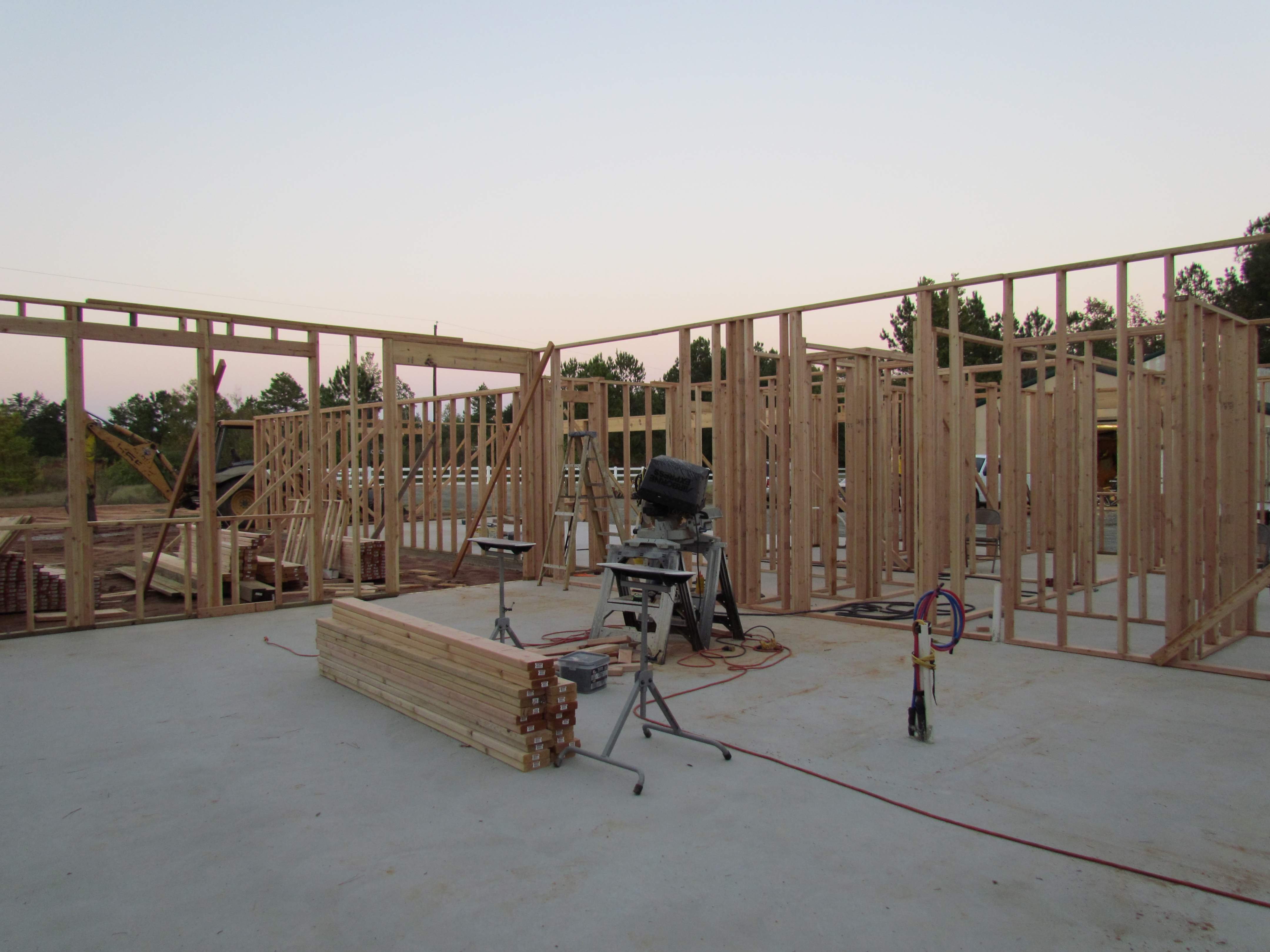

As the framing continues, we're making small changes. Doors and closets are being fine tuned.
Eddie
