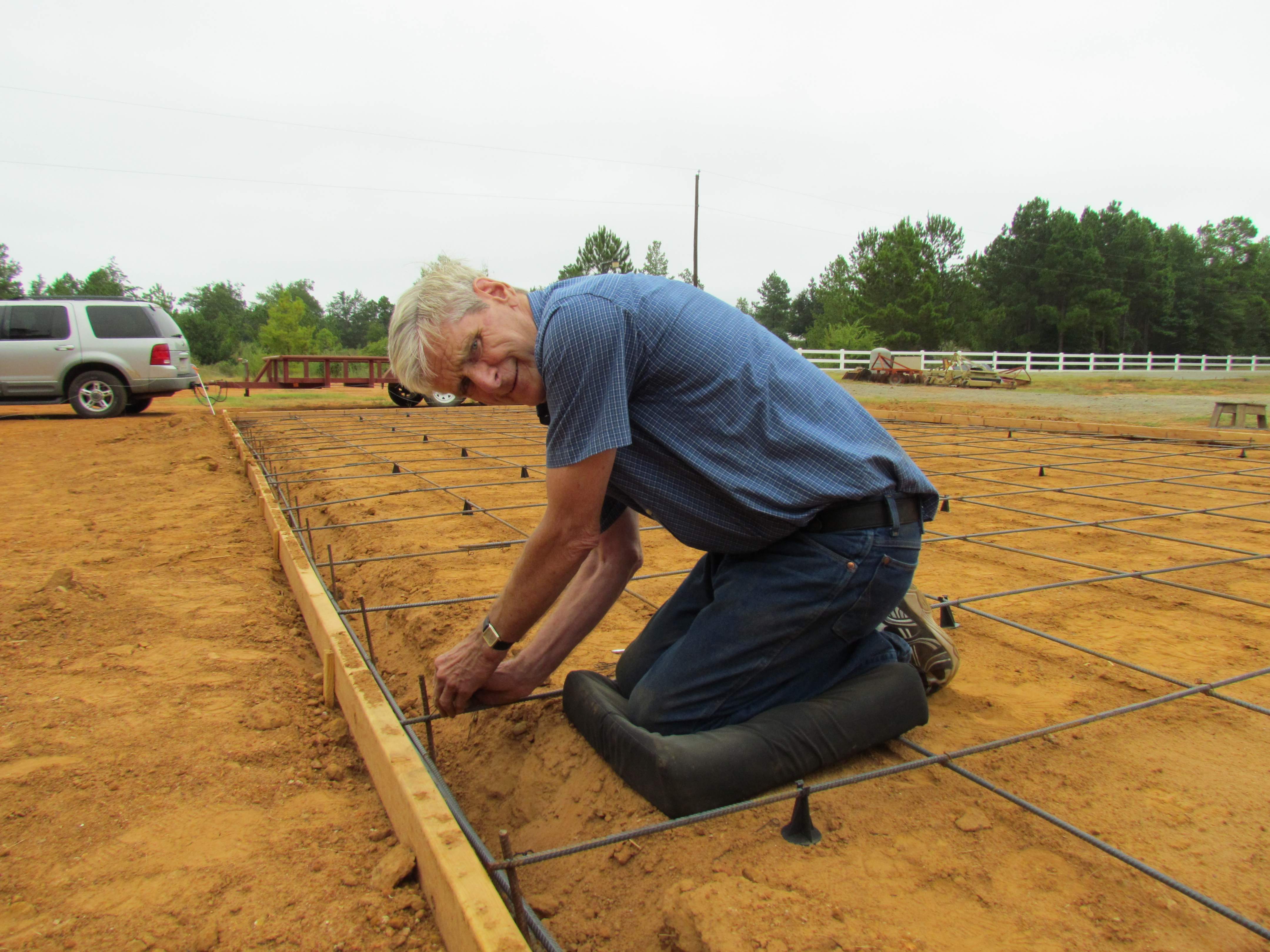

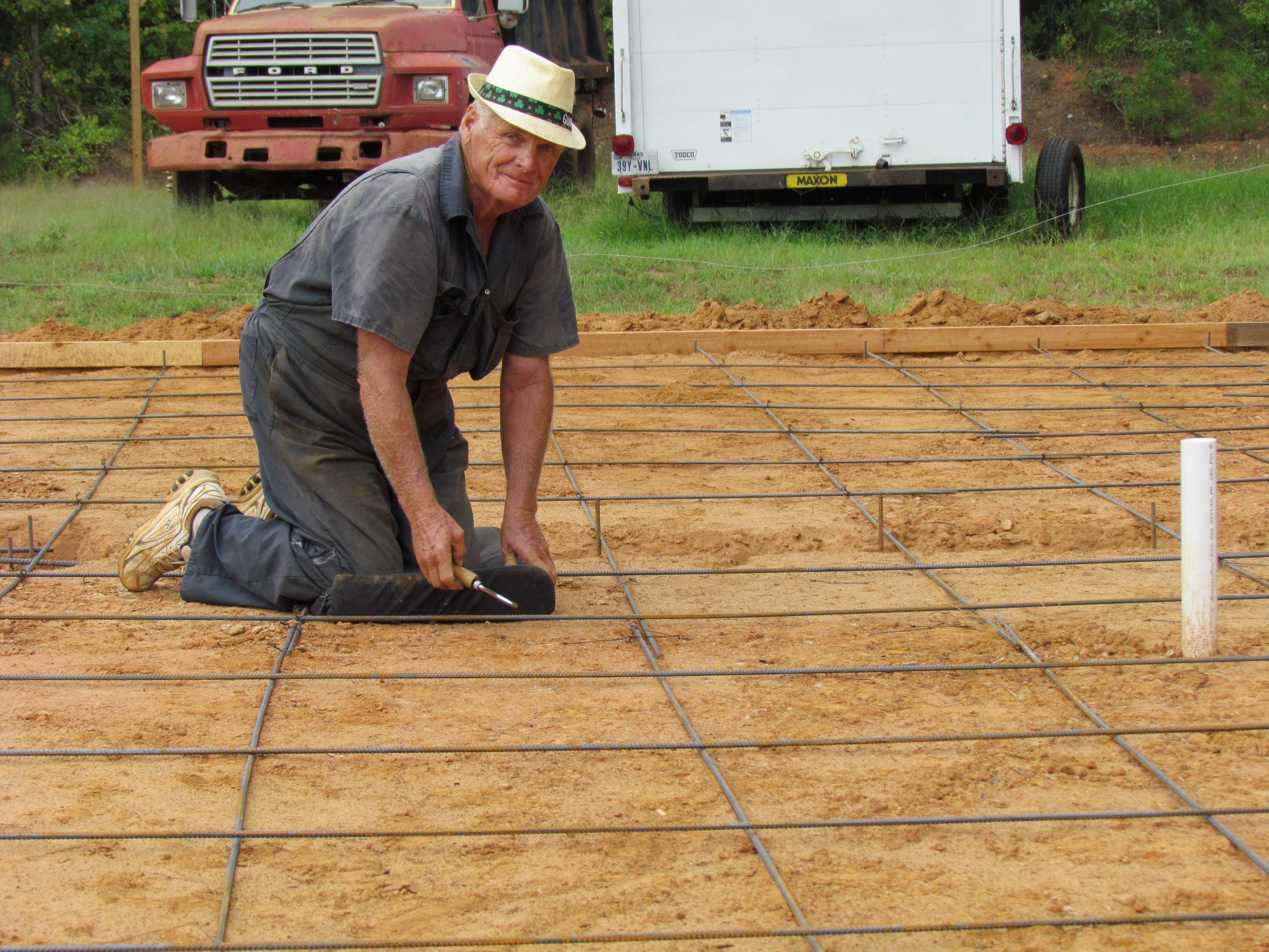

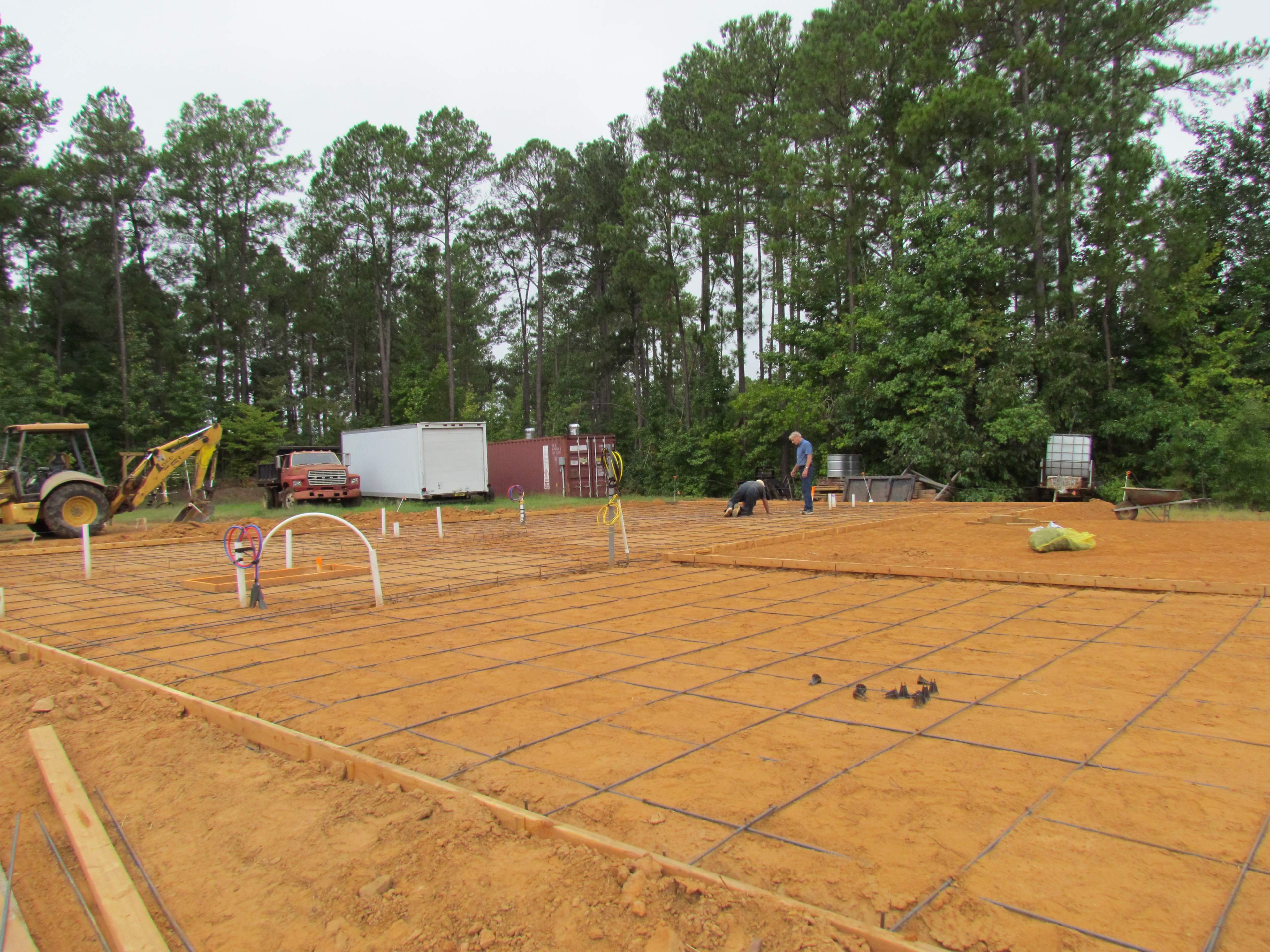

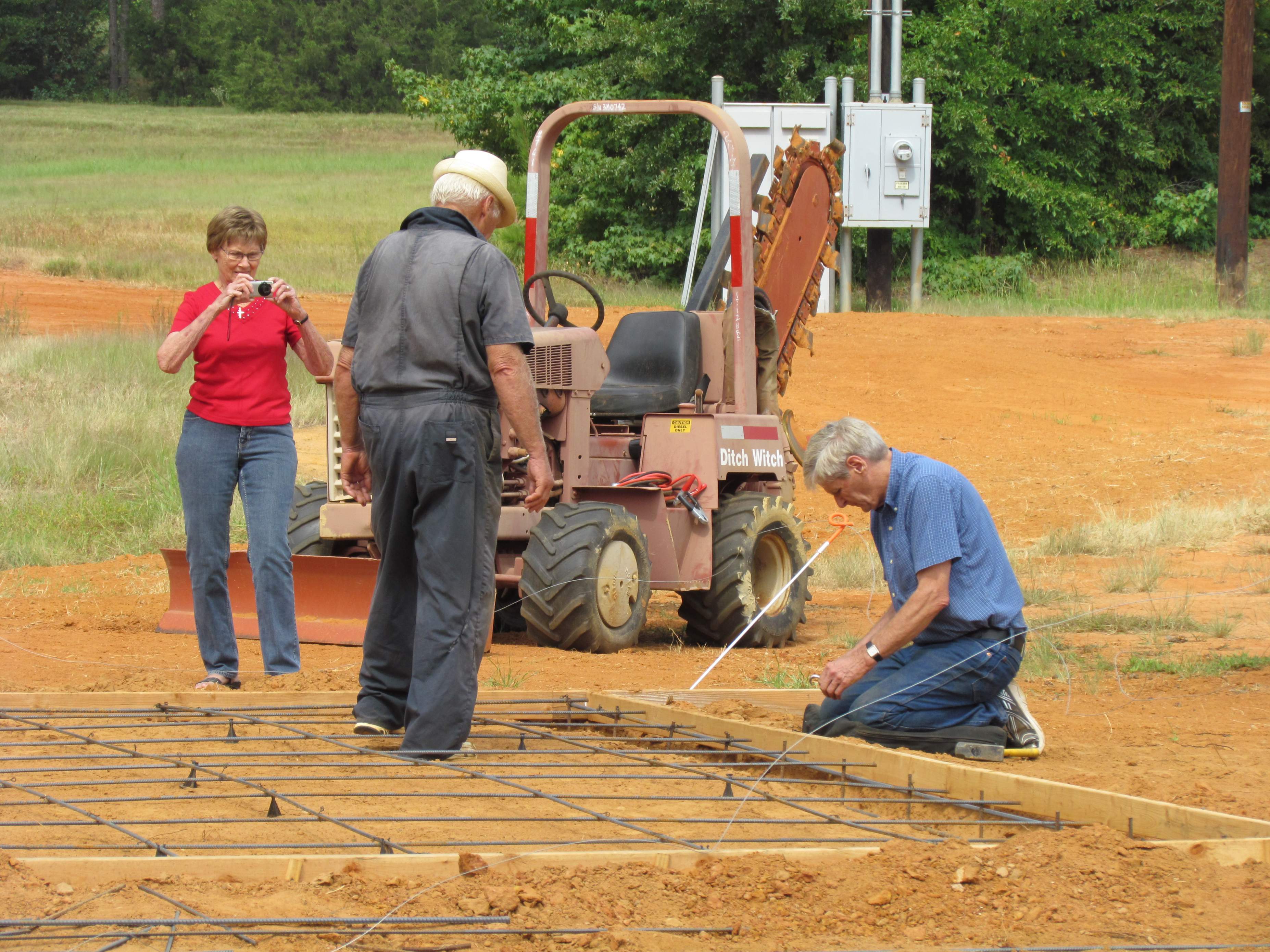

Rebar is half inch, doubled up in the footings and 3/8's on a two foot grid sitting on chairs through the rest of the pad. There is 3/8's rebar sticking through the forms a foot for the porches every two feet that I will tie into when we make the forms to pour them.
Eddie
View attachment 280951View attachment 280952View attachment 280953View attachment 280954

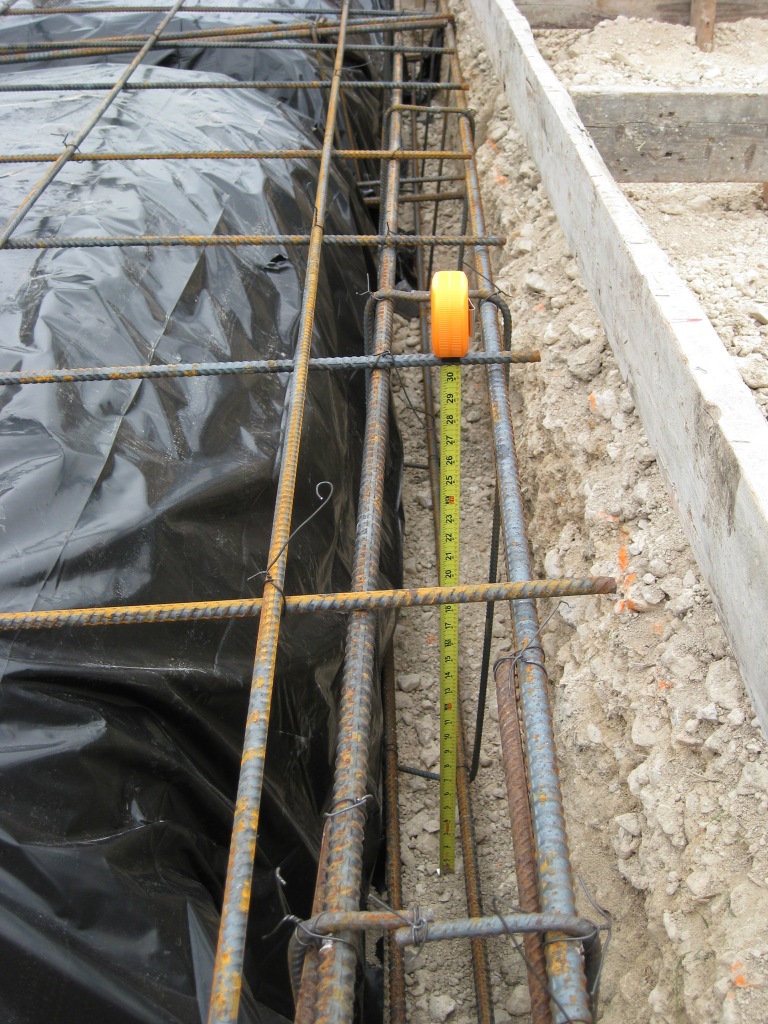

I am jealous of your red clay. Down here on the Black Land Prairie (black clay), you would have dug down 3-4 ft, brought in road base, compacted it, then dug 18 x 24 perimeter beams (at least) with 12 x 18 grade beams throughout the slab.
Here is a picture of some of the foundation work for the porch we added in 2009 (engineered foundation):

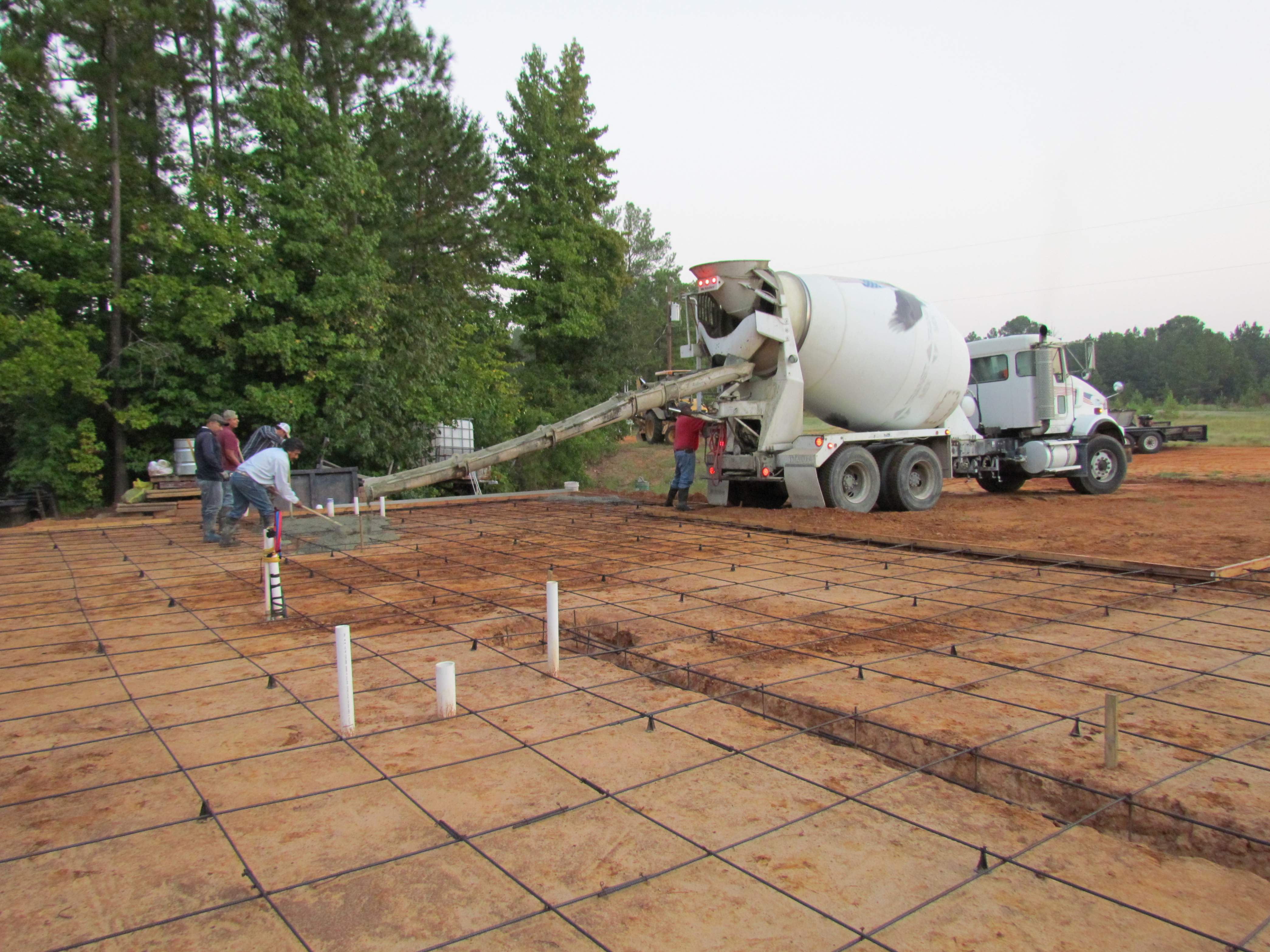

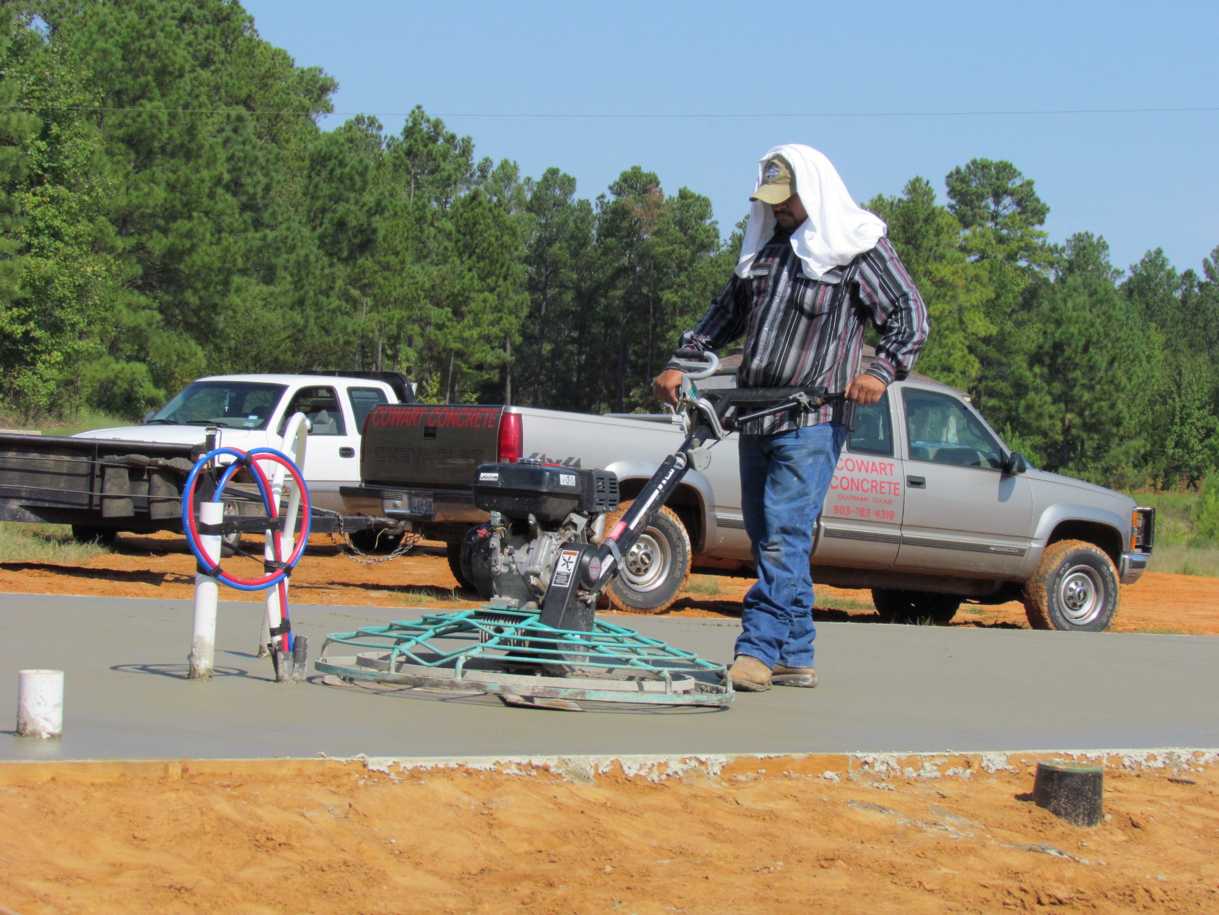

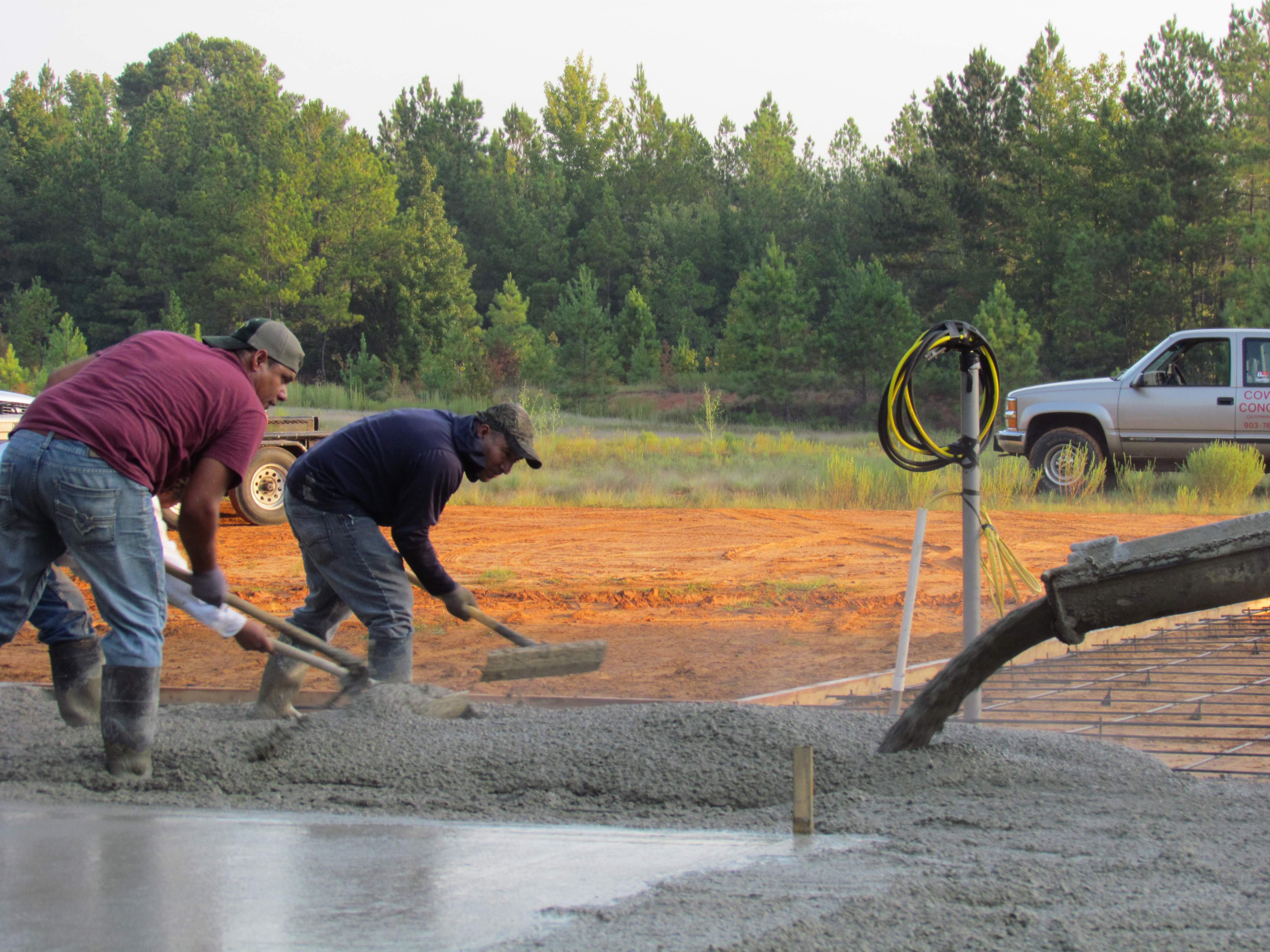

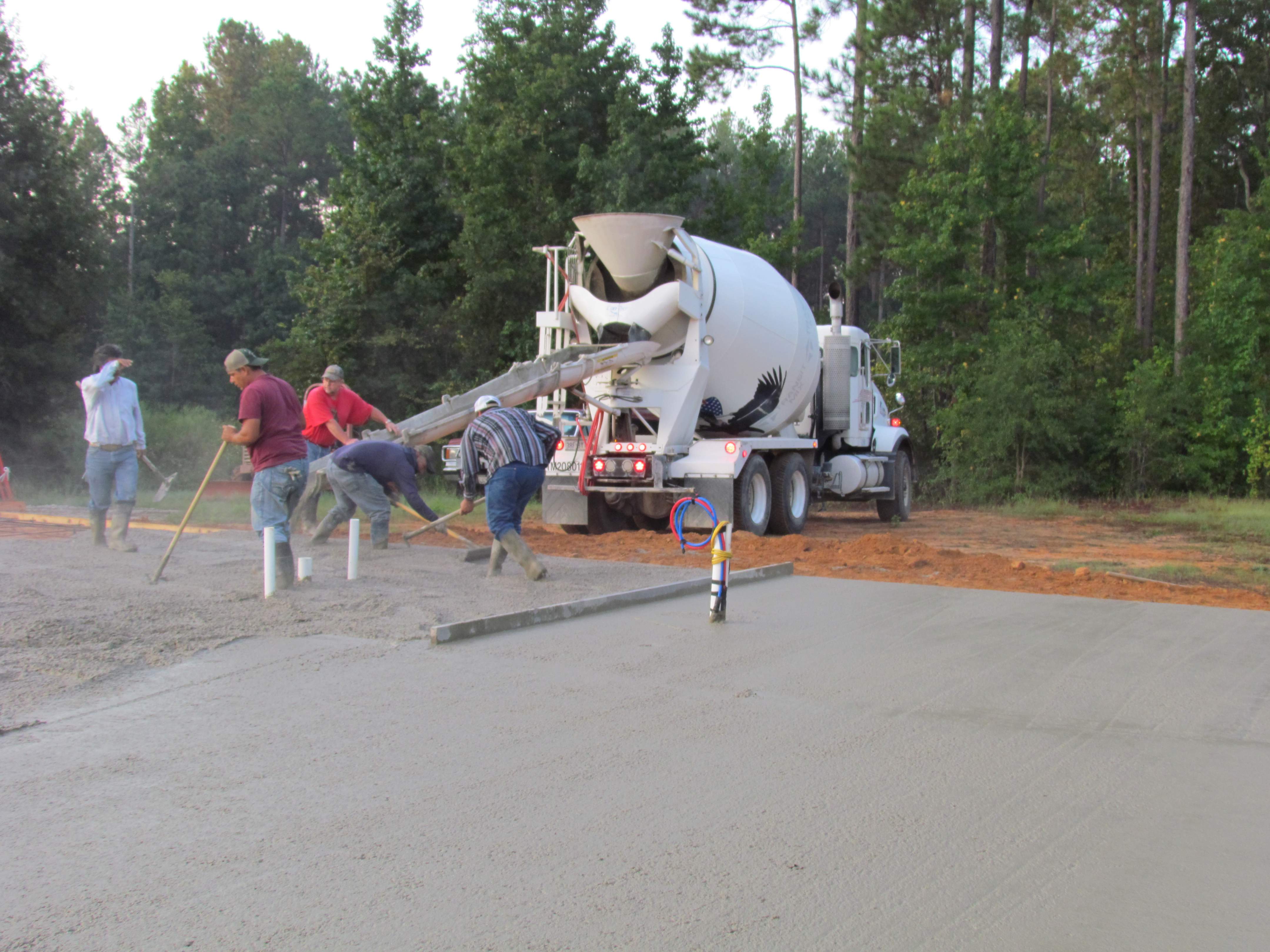

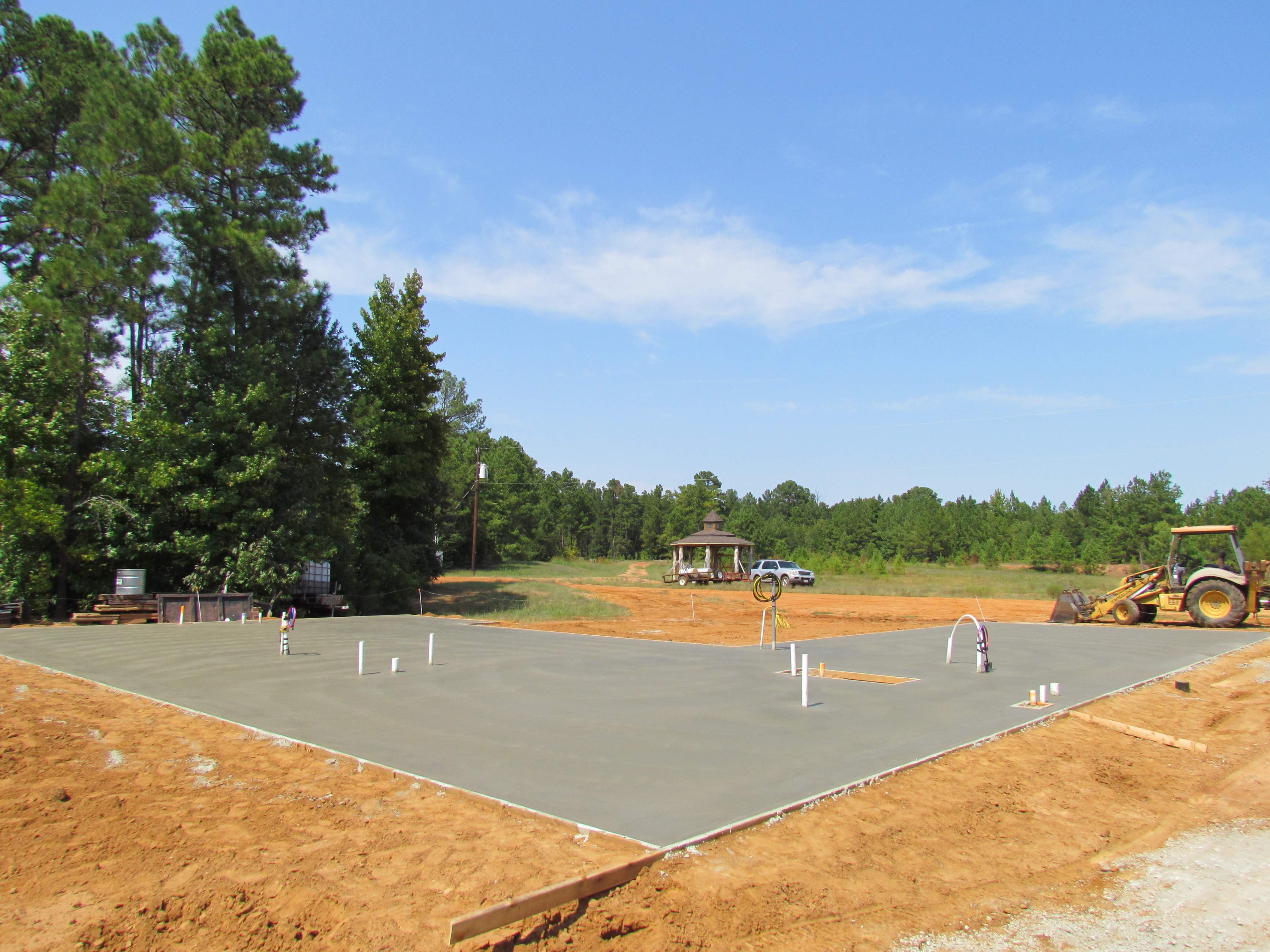

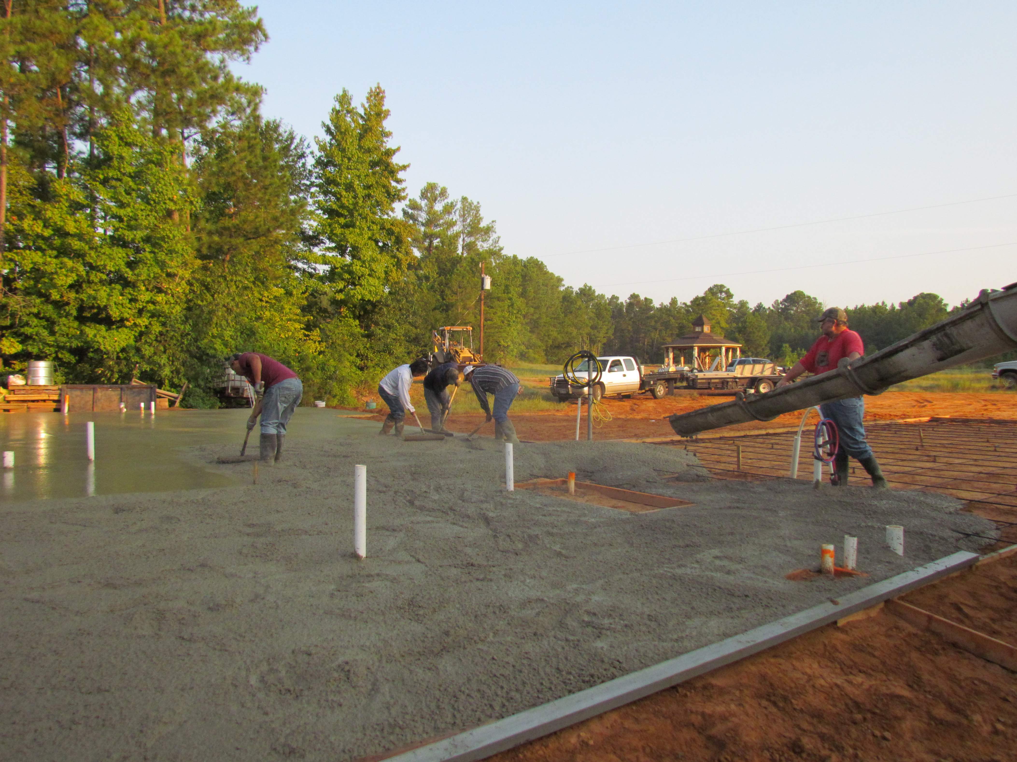

After finding out the guy I've used before for bigger concrete jobs was deported, and asking around the people I know for somebody they recomended, and after talking to them, I went to Angieslist.com and found the guy I hired. He was at .50 cents a foot to finish it off. He arranged with the concrete company when to be here and set the day for this morning. 005.jpg014.jpg022.jpg024.jpg036.jpg037.jpg038.jpg
He and his guys showed up about quarter to seven and started going over the rebar and setting their guide stakes. They came in two trucks, each pulling a trailer full of supplies. Three power trowels, all sorts of straight boards, rubber boots and just about everything you could think of to do concrete work.
The first truck showed up a little after seven and the last one was gone by 9:30. Almost forty yards for a total of just over $4,400 for the concrete.
They stayed and worked it until about 2pm. It looks perfect!!!!!
Eddie

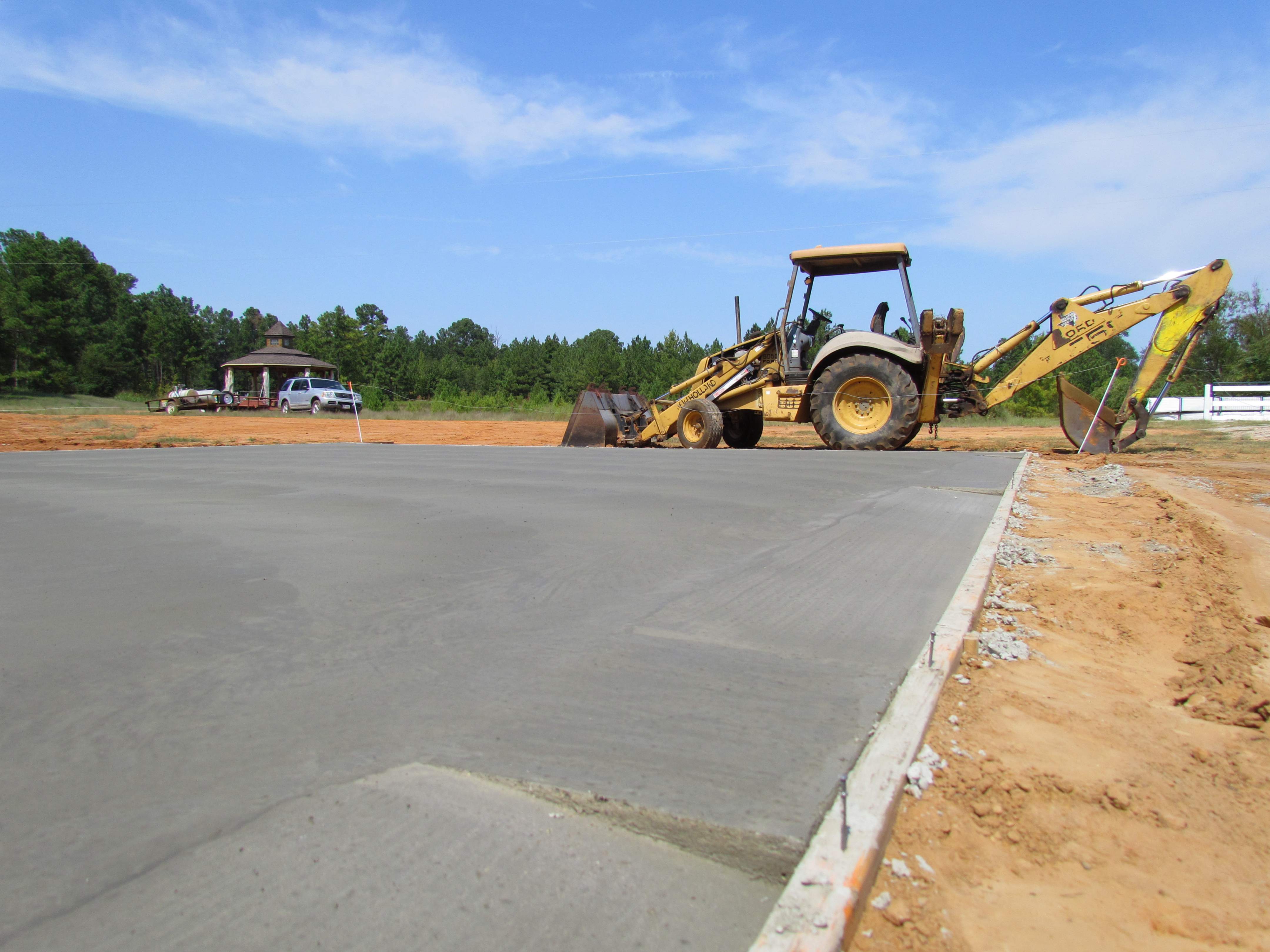

In the very last picture, where it shows the cut in the concrete for the garages, you can see the electric wire to keep Oscar out. He does not like that wire!!!! LOL
Eddie

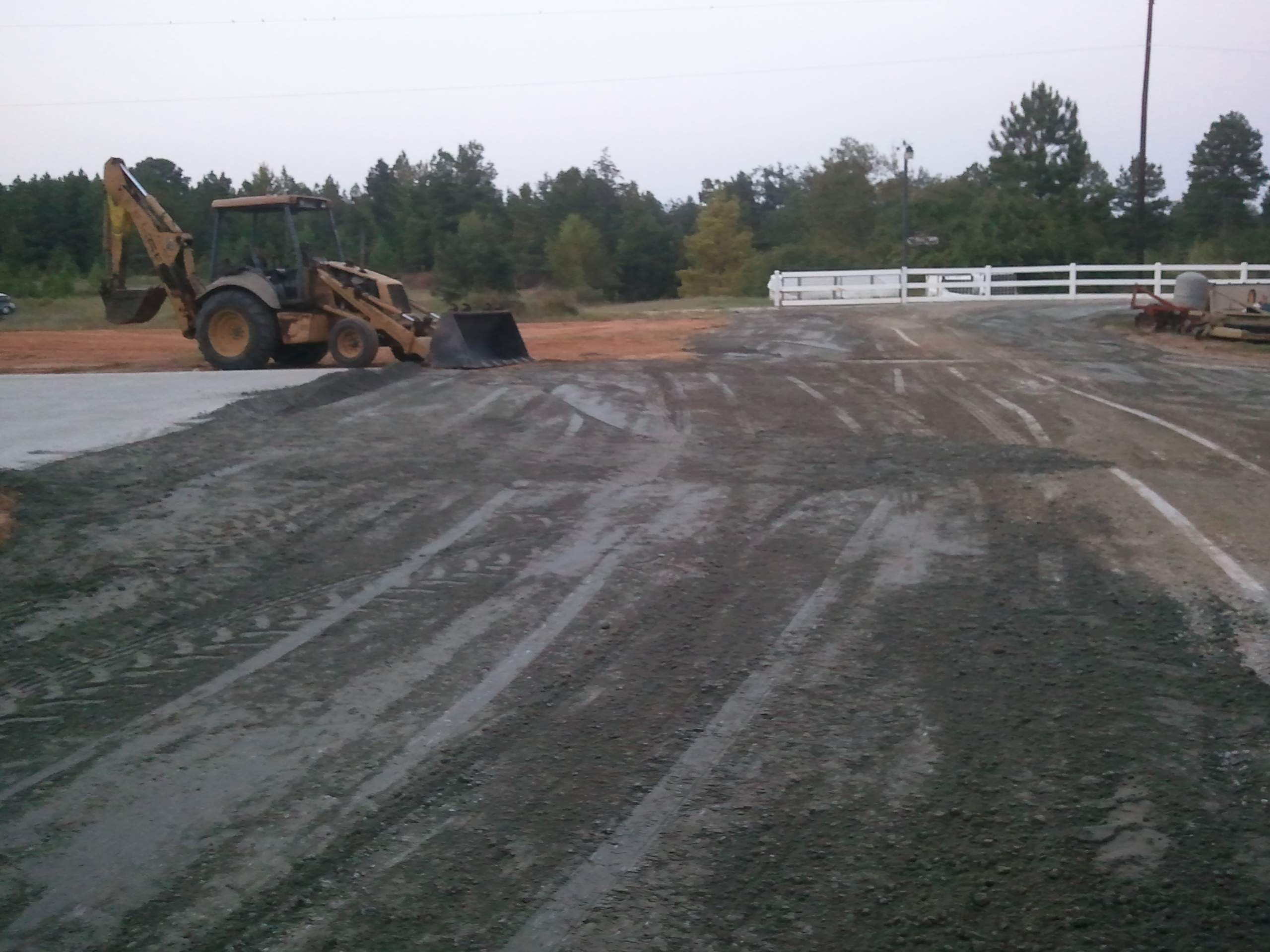

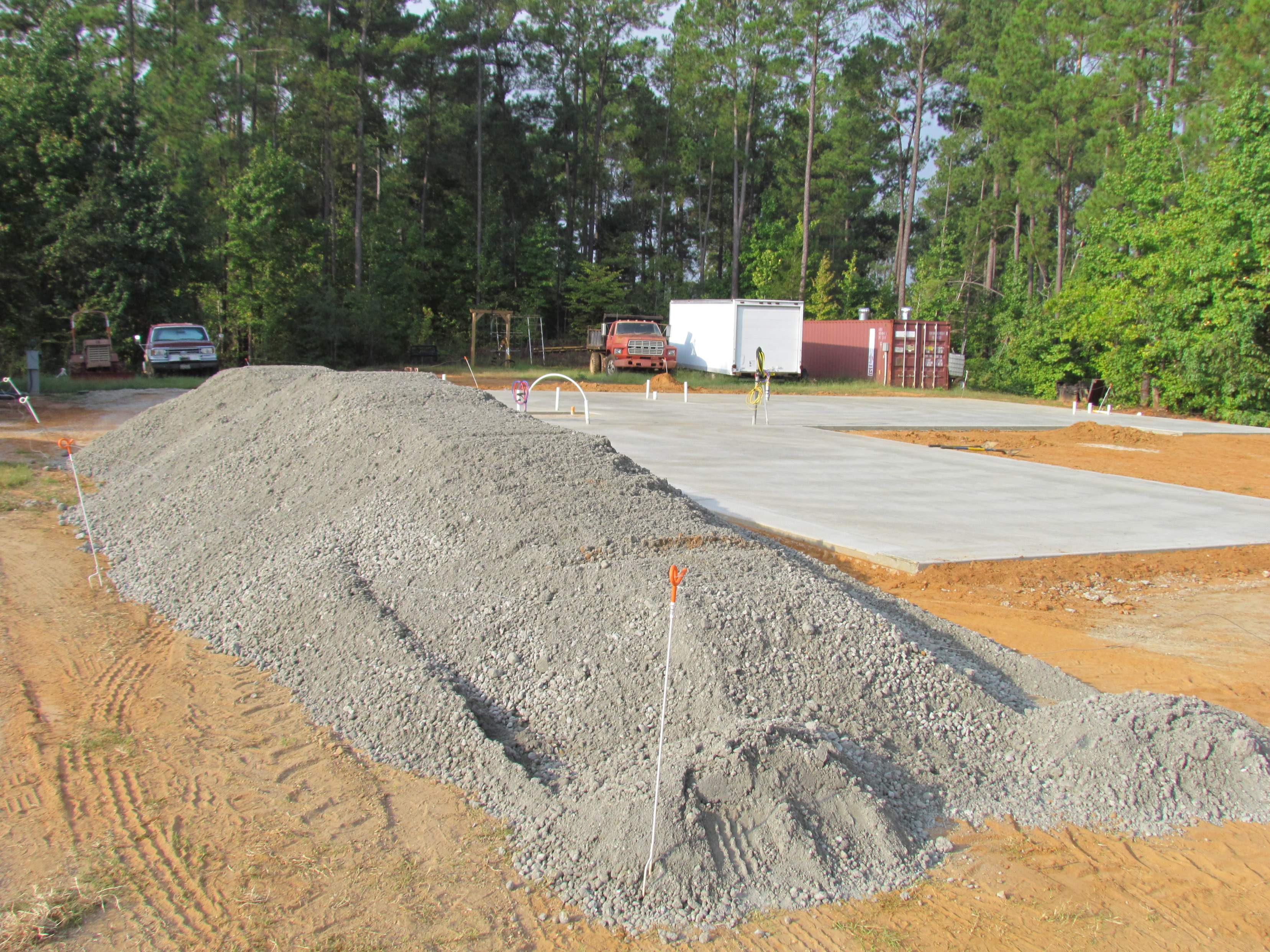

I had two loads of road base delivered on Monday, but wasn't able to get to it until yesterday. Cost of rock is steadily rising and this was $22 a ton for a total of just over $1,200
I had a road in already that was wide enough to drive on, but not much else. Parking has been on dirt since I built my house. With my parents here and their friends coming over to visit, we needed more parking areas. This worked out just right!!!!58.jpg60.jpg
