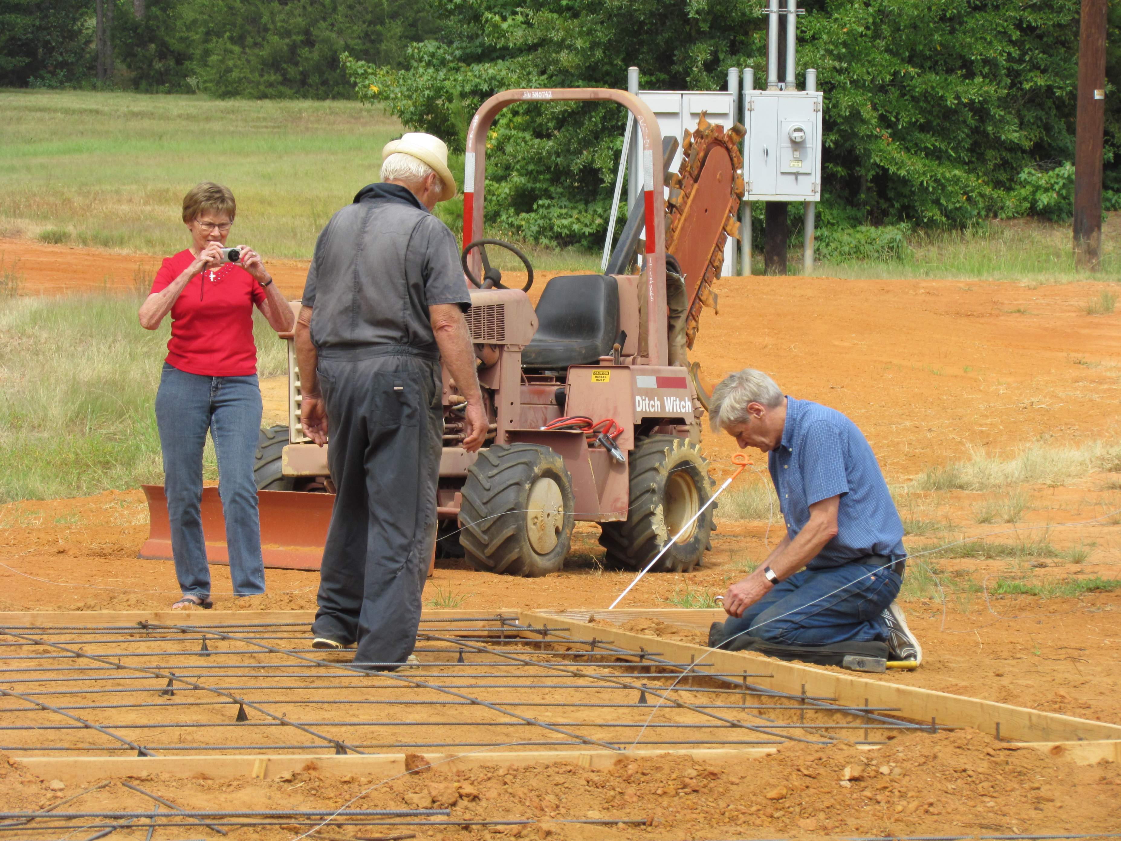

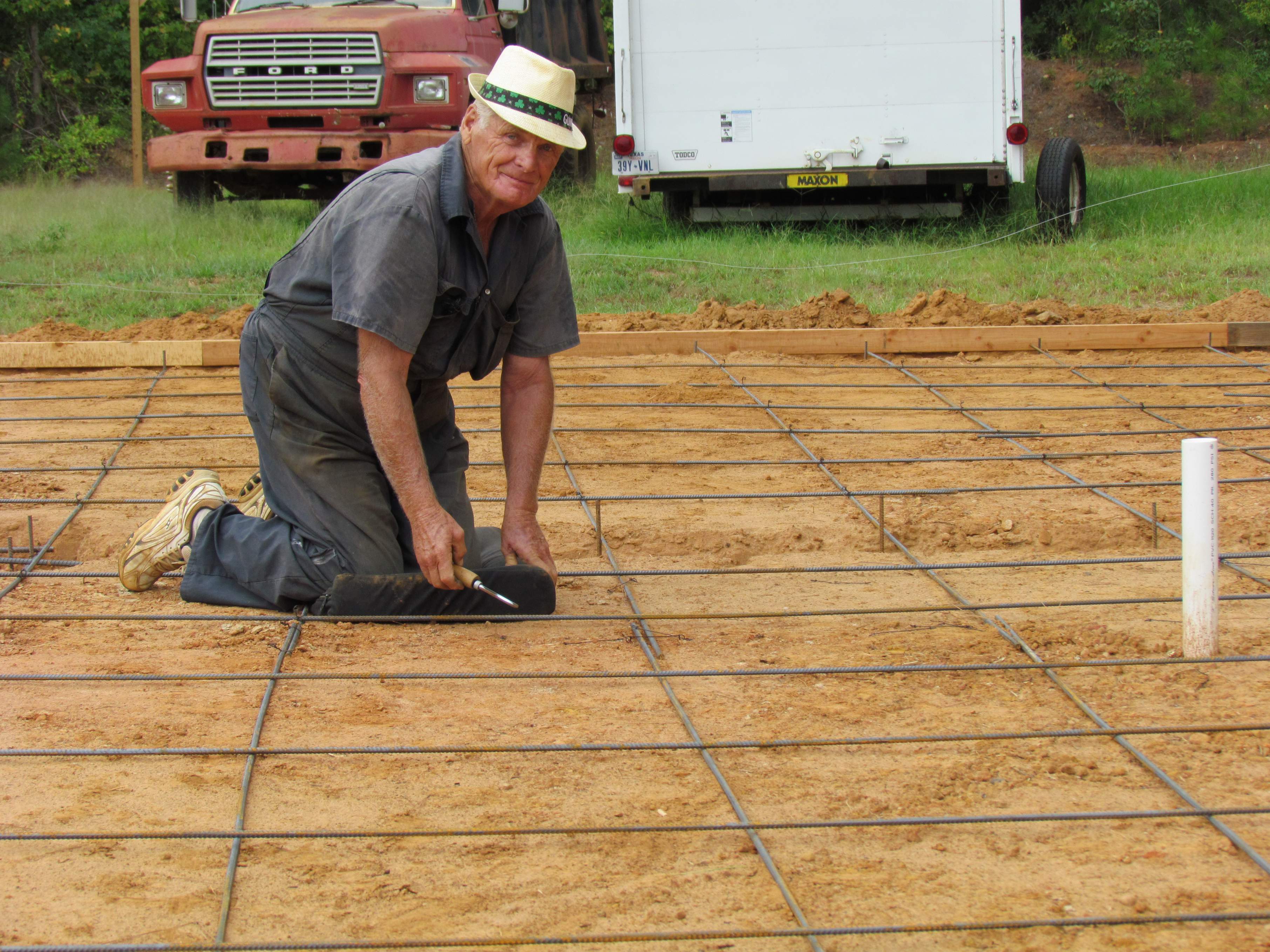

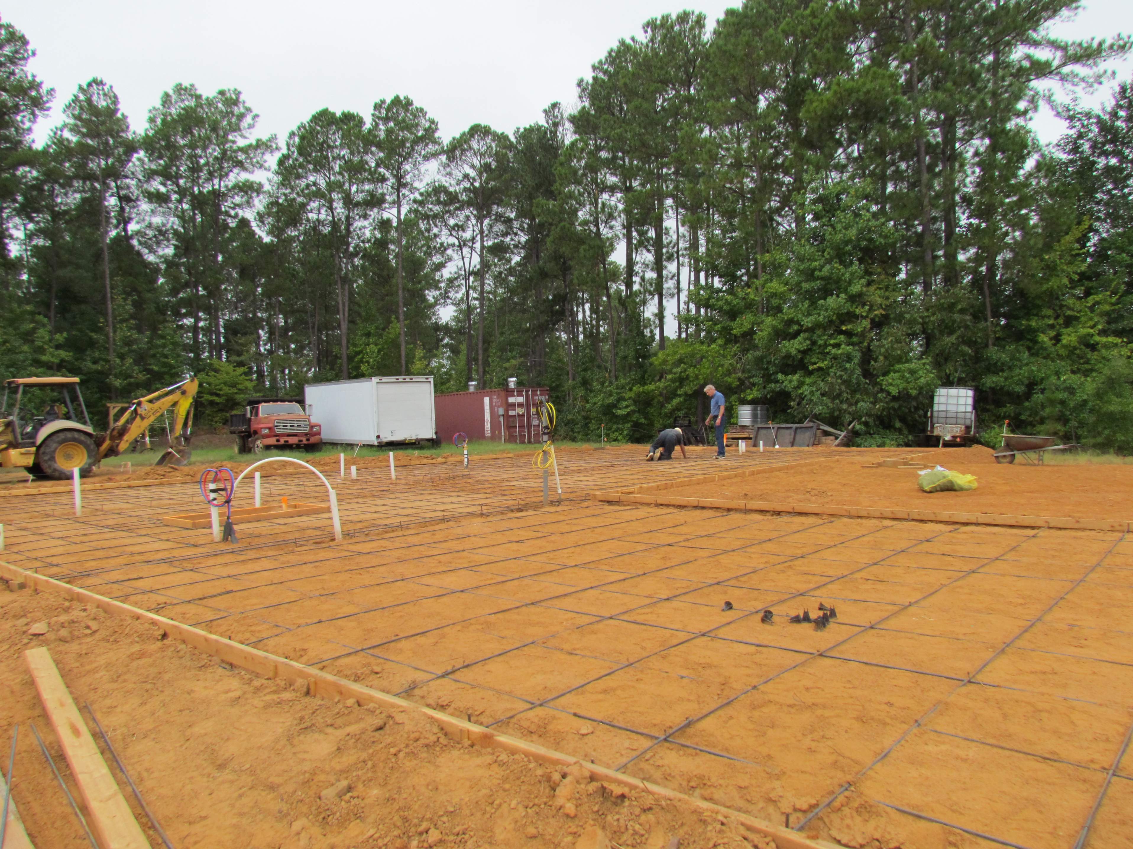

We've had company visiting from Canada this week and haven't got a lot done. Not that it matters, I'm still talking to guys about finishing the concrete. Hopefully we can pour this week, but I don't know when, or who will do it.

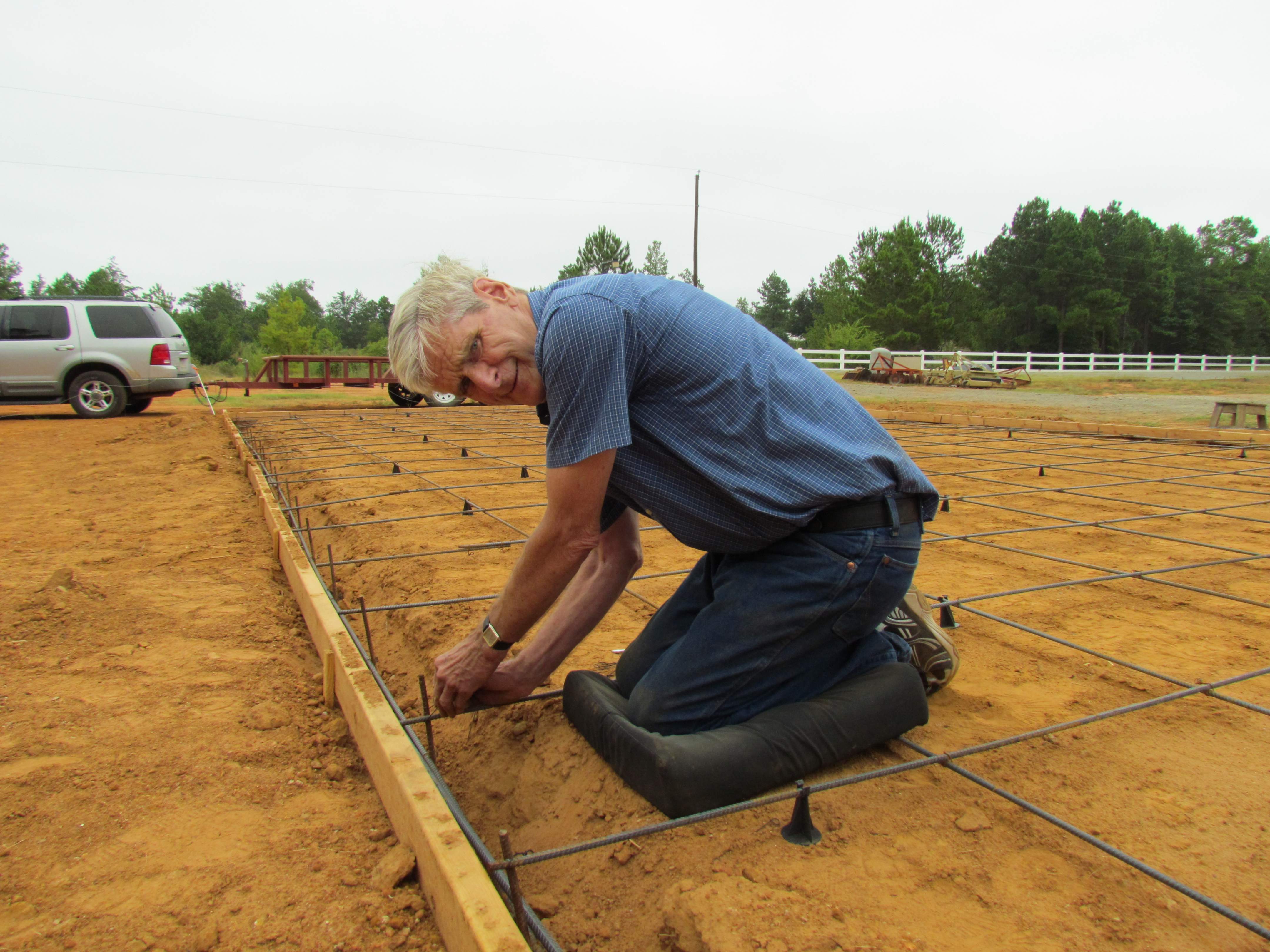

Rebar is half inch, doubled up in the footings and 3/8's on a two foot grid sitting on chairs through the rest of the pad. There is 3/8's rebar sticking through the forms a foot for the porches every two feet that I will tie into when we make the forms to pour them.

I may have missed this or forgot it already but are you going to run any in floor heating?

Where is the vapor barrier. Plastic first, then the rebar....

Winter is only two months here and we only have a few days that are below freezing for more then a few hours. There will be a gas central heating unit and a gas fireplace for heat.

No need for a vapor barrier with my soil.

Eddie, I will have to disagree about the vapor barrier. I am in the Longview area and the barrier is standard on all homes here. Jus a little advice, really hard to install after slab is poured.
Just my opinion.
   / House for my Parents #80
Nice plans Eddie, I was also wondering were the vapor barrior was, do you have Radon gas in your area? Its code here in Iowa, but the builders always skip it in the garage, the floors will realy sweat in summer humidity, slick as ice to walk on.
