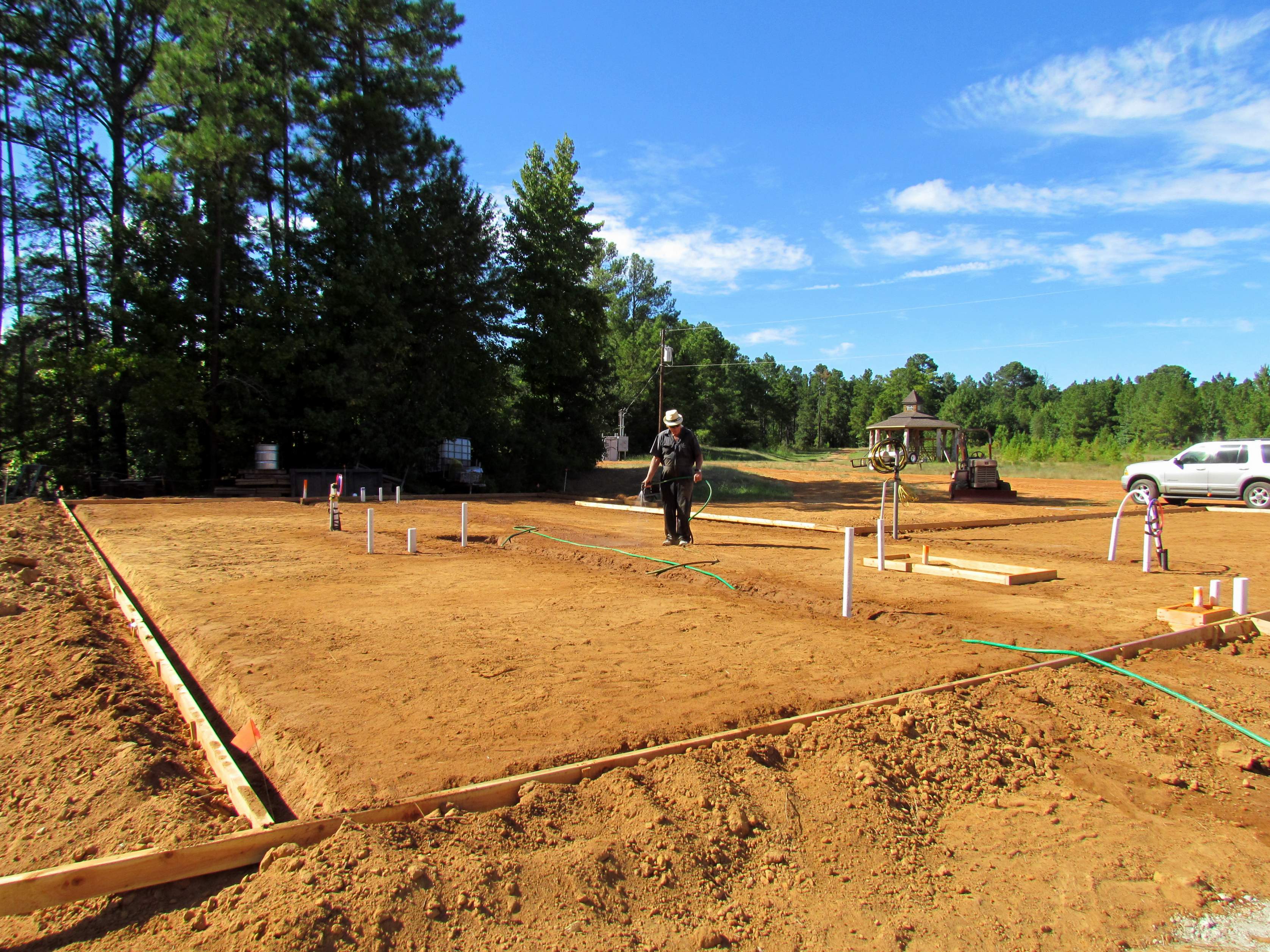

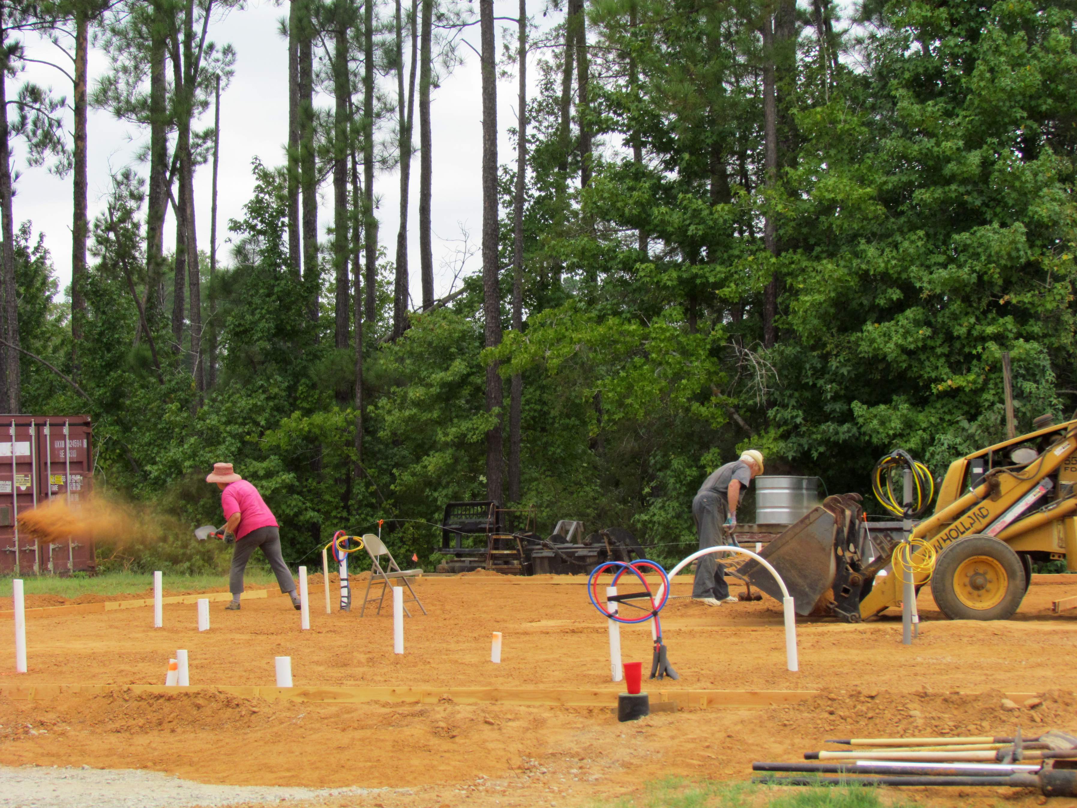

We finished off all the prep work. All sewer and drain lines are in, the water lines to the island and from the main are in and the power lines to the island and to the house are in. I built three boxes to keep concrete away from my tub and shower drains, and we've smoothed and gone over eveything. It's time for rebar and the termite guy to spray the dirt.
Concrete took a step back. The guy I was going to use lost his mind. He's done work for two other people that I recomded him to, and he was very affordable with excellent results. He just told me he wanted $1,800 to smooth the concrete. Half a days work for his crew of five and himself. He said he has to pay his guys $180 each, which leaves $900 for him. I'm not going to say what a guy should earn, but I'm not going to pay him that. Not even close!!!!!
I'm waiting on calls from other guys right now. I should have something figured out in a few days.

I didn't think about help on the toilet. The master toilet is in a room that is 3ft 6in wide and 5ft 9 in long. That might be big enough for help. The hall bath toilet is more open, so that should work better for assistance. The shower is 3ft 6in wide and almost 7 feet long. That should be big enough for quite a few people!!!! LOL
Everything is on one level. The front and back porches will have a very mild slope away from the house, but no steps. The side door to the garage will have a step, but the garage doors next to it wont. I think that is the only step.
I like levers over handles, but they will decide on that since they will be living there. Its an eas change down the road if I have to do that. There really isn't anything that I can't change if I have to, but things like blocking the walls for handles in the shower and toilet walls are all part of the plan and great advice.
The pad will be sprayed for termites tomorrow. The owner of the company is a friend on facebook and is giving me a great discount. .12 cents a square foot, or $336 for 2800 sq ft is a BARGAIN!!!!
