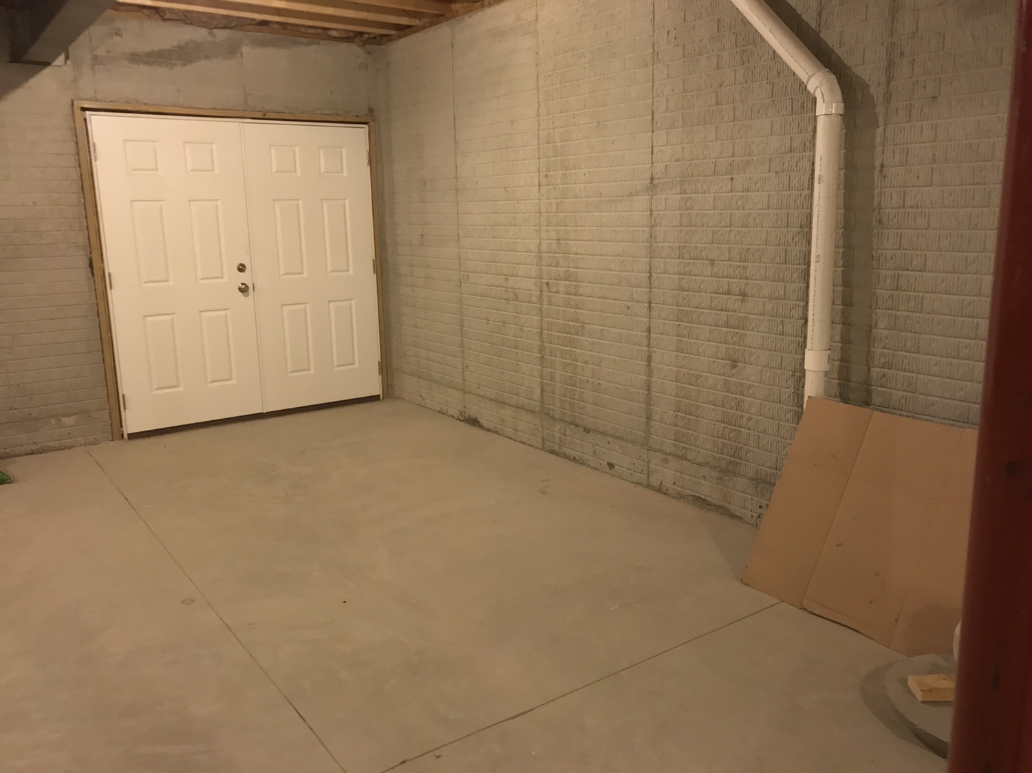

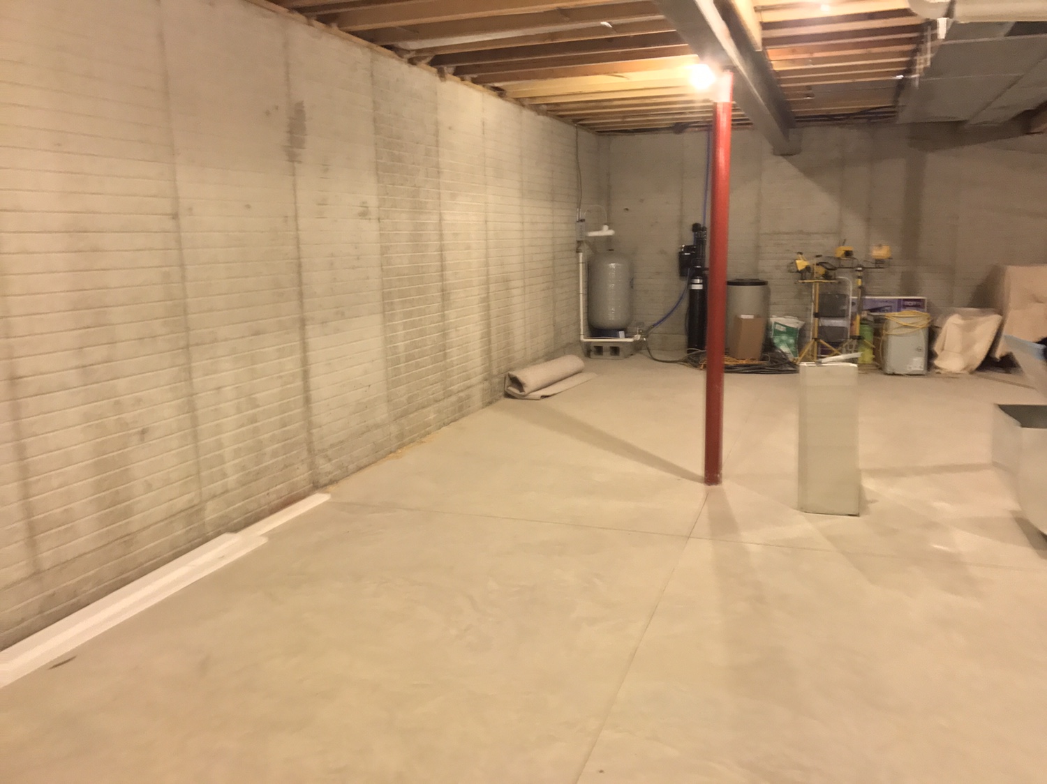

I have always had walkout basements. One piece of advice I can give you that I haven't seen mentioned yet is to go with steel I-beams to really open up the basement. We went with 12" I-beams and the support posts are MUCH further apart than if we went with wood. It would have been something like every 6ft there would have been a support post. A ranch style house would probably be different than our 2 story. We also did 9ft basement walls.
   / House with a basement #49
View attachment 539644View attachment 539645
A good friend of mine and her husband had a modular home built for them. He is an engineer. So he figured out the size of steel I-beam he'd need to run the length of the entire house, and had the foundation built to support it. The entire basement is free of any posts! HUGE! Very nice thing to have. He coordinated delivery of the I-beam with delivery of the house, so the same crane set the beam and both halves of the house the same day. Worked out great!
