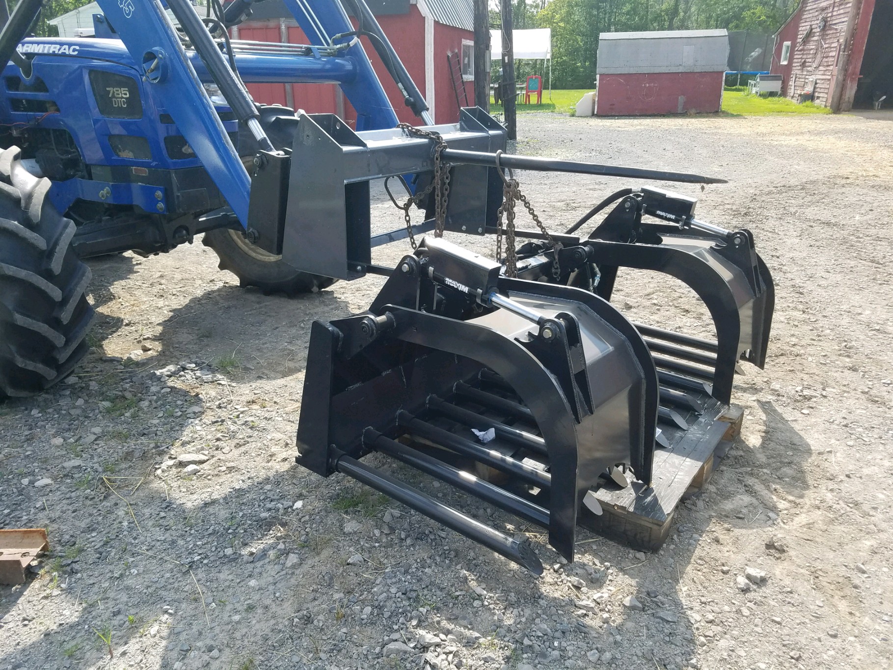

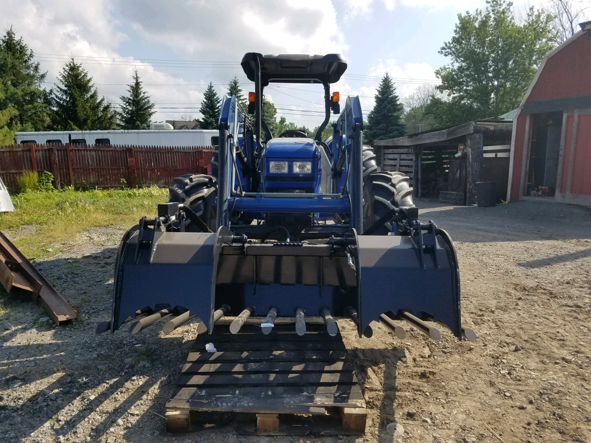

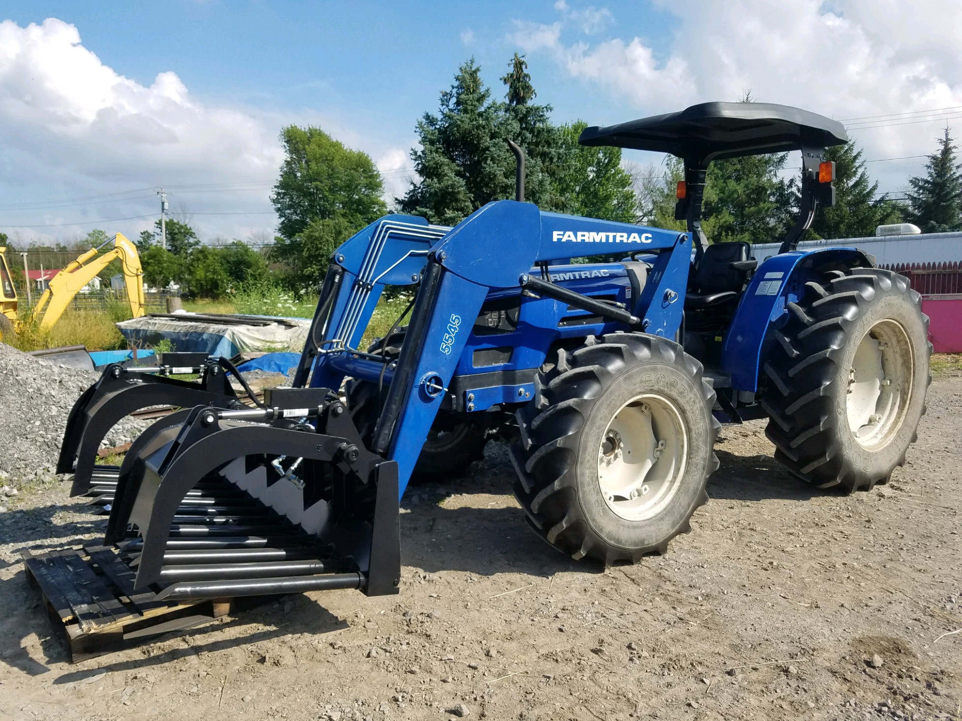

The grapple from Jenkins has been my first choice as well but, Meyers emailed me back with updated pictures of their current model since it's different from the website. I actually like that one now. It's very similar to HLAs debris grapple. It would be 2980 shipping included and about 400lbs lighter than Jenkins.
   / How big of a tine grapple should I consider?
Here are the new model design from Meyers that they sent me. Its only primed photos.
Its pretty much between Meyers and Jenkins. Meyers weighs about 400lbs less for the equivalent size. The clamp on Meyers looks pretty beefy but I like how the tines on Jenkins are cut...

So I went ahead an ordered the Jenkins grapple. I went with the 83" Tine grapple.
I decided to go with the heavier grapple because I liked how they have the tines bolted in behind the plate and it'll give me more "meat" to work with if I need to do any welding (novice welder). The cheaper price tag also helped a bit.. It should be here in about 2 - 3 weeks!
