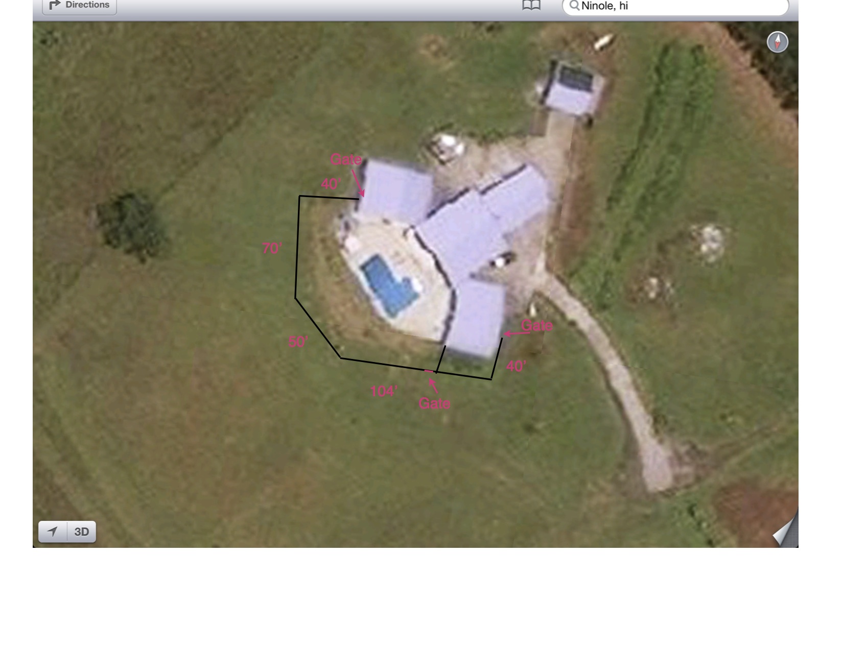

Overview of my project. Thinking I'm going with 5ft mesh
