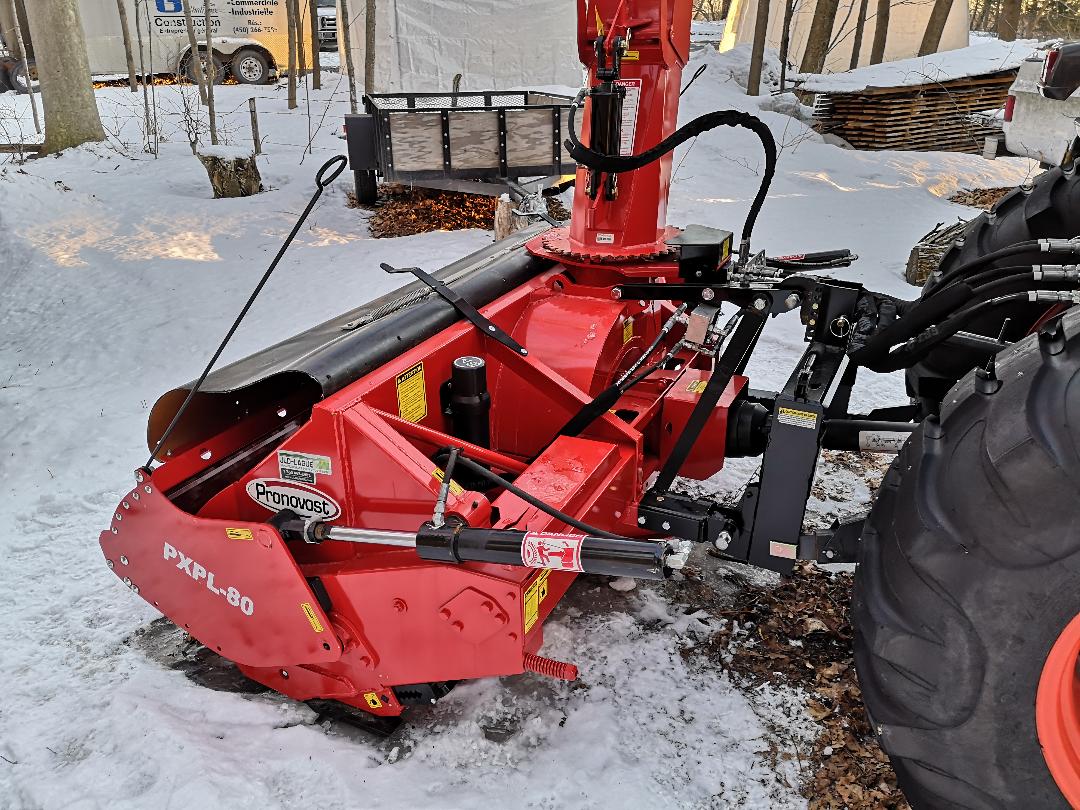

I need a crash course on cushion valves.
I have a pronovost pxpl 80 snow blower with a blade on the back.
at idle it takes 8 seconds to lower the blade on the extension stroke of the cylinder. It takes 6 seconds to lift the blade on the retract stroke.
the problem I have is when I go to PTO rpm it takes 3 seconds to extend the cylinder and 8 seconds to retract. It should be taking about 2 seconds to retract the cylinder.
it is almost as if the cushion valve in the circuit is turning my spool valve into a regeneration valve.
I have an exploded view of the cushion valve in my owners manual but none of the parts are labeled
I did a few tests with my pressure gauge hooked into the remotes. I only get 1500 psi of pressure in one direction and when I switch the pressure gauge to the other side I get full system pressure approx 2500 psi until the blade hits the stops then it is like something shifts in the valve and then I only get 1500 psi on the same side that I got 2500 psi before hitting the stops.
I think the valve is not adjusted to the same setting on each side but I'm not even sure how to adjust the valve.
thanks

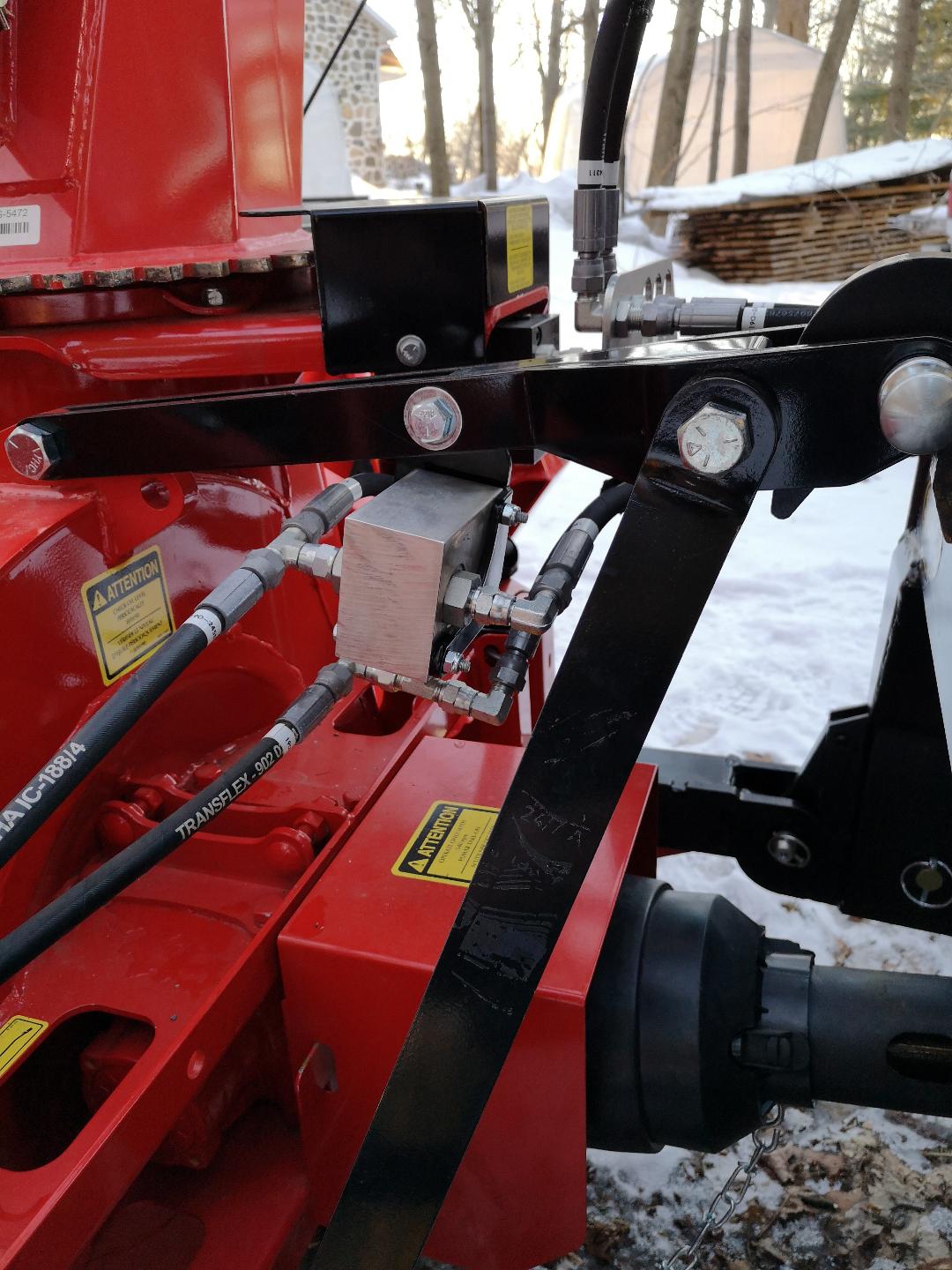

here are pics of the whole setup the valve and the only apparent adjustment on the valve

By "cushion valve" are you referring to cross port relief valves or end of cylinder stroke cushions?
Cross port relief valves: The setting will vary with the return(tank) line back pressure. A float spool should not allow any pressure to build on either line while in float so that should not cause any problems.
Did provonost provide a hydraulic schematic for this blower? Curious if Provonost installed an orifice in the manifold to limit cylinder speed that could under some set of circumstances cause the functions that you are experiencing.

I talked with the dealer yesterday. the hoses come out of the valve and tee to the two cylinders to actuate the blade. it was suggested that the hoses may be switched so that the cylinders are fighting each other and somehow the valve is balancing them out similar to a regeneration valve.
it was also suggested that maybe the wrong end of the circuit (either retract or extend was going through the valve.
checked both out and hoses are not switched and the correct side of the circuit (retract) is going through the valve according to the parts diagram.
the orifice idea is a good one maybe it just isn't on the correct hose. Sounds like I need more info on cross port relief valves instead of cushion valves.
I also found out when looking at the parts list that this valve is not a cushion valve it says its a relief valve (rl-50)
one side of the circuit (retract) goes through the valve like we can see in the picture and the other circuit doesn't actually go through the valve but is tee-d into it. can't see the tee in the picture but it is on the bottom.
