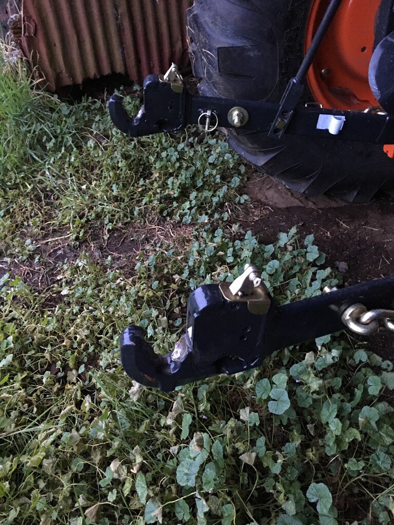

If you posted a pic of your lift arms I think it would be helpful.

Post a link arm pic and it will be solved. Anyway, here's my pics.

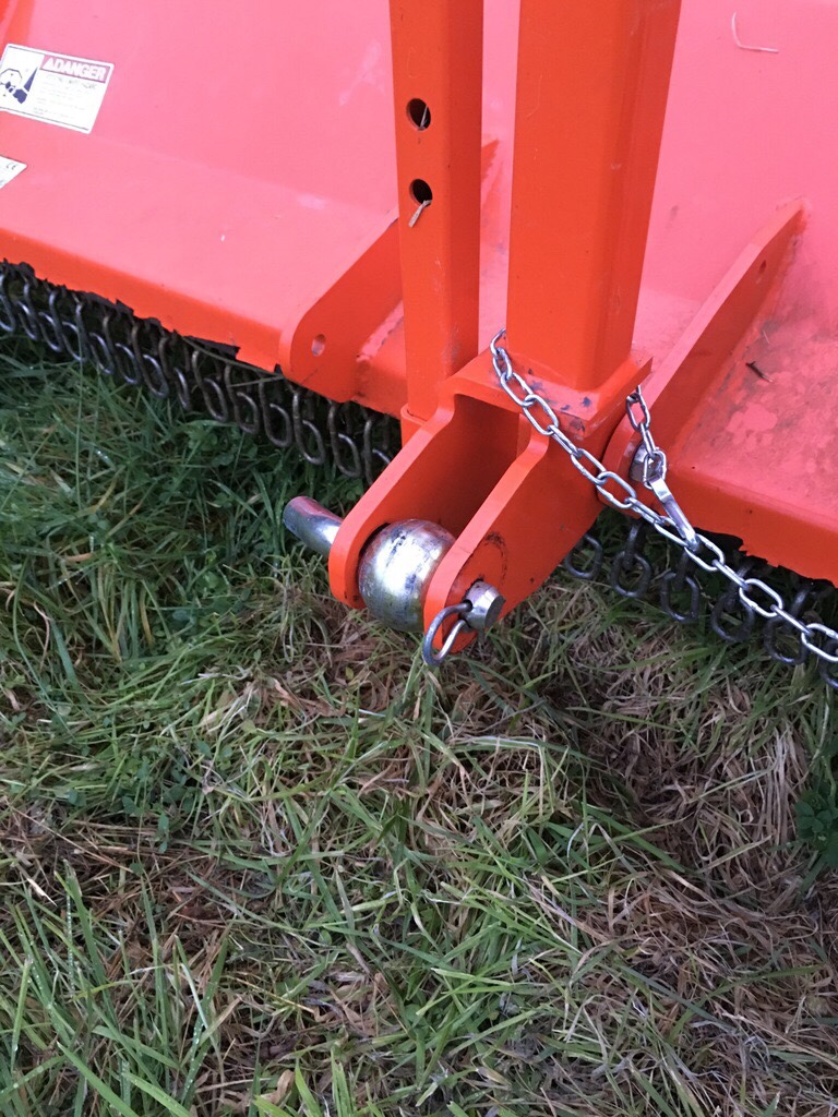

Stole these from another durum here. These are the lift arms and then another of a ball on an implement.
   / How do I find balls for my lower 3 point quick attach arms DK 5010? #26
View attachment 496846View attachment 496847
Bingo; problem solved. Looks like regular lift arm balls will fit but the kind with the boss on the end might work better. Basic lift balls are from mail order and mentioned earlier in the thread. TSC, Rural King; everyone has them here so any farm store there has to have them. Common ag item.

Wanted to provide an update just in case anyone ever faces this problem. Received the balls from the dealer and the ones I ordered that were linked. All too big.
I've learned that the arms for the DK4510 and DK5010 are Cat 1. I'll attach a picture. The dealer apologized and is sending Cat 1 quick attach arm balls now. Apparently he's sold so few of these that even he didn't know what arms came on my machine. If this weren't so frustrating it would be amusing. I've got tools sitting ready to use and cannot connect to them! Once I get a part number I'll get it posted. IMG_3174.JPGIMG_3176.JPGIMG_3177.JPG
