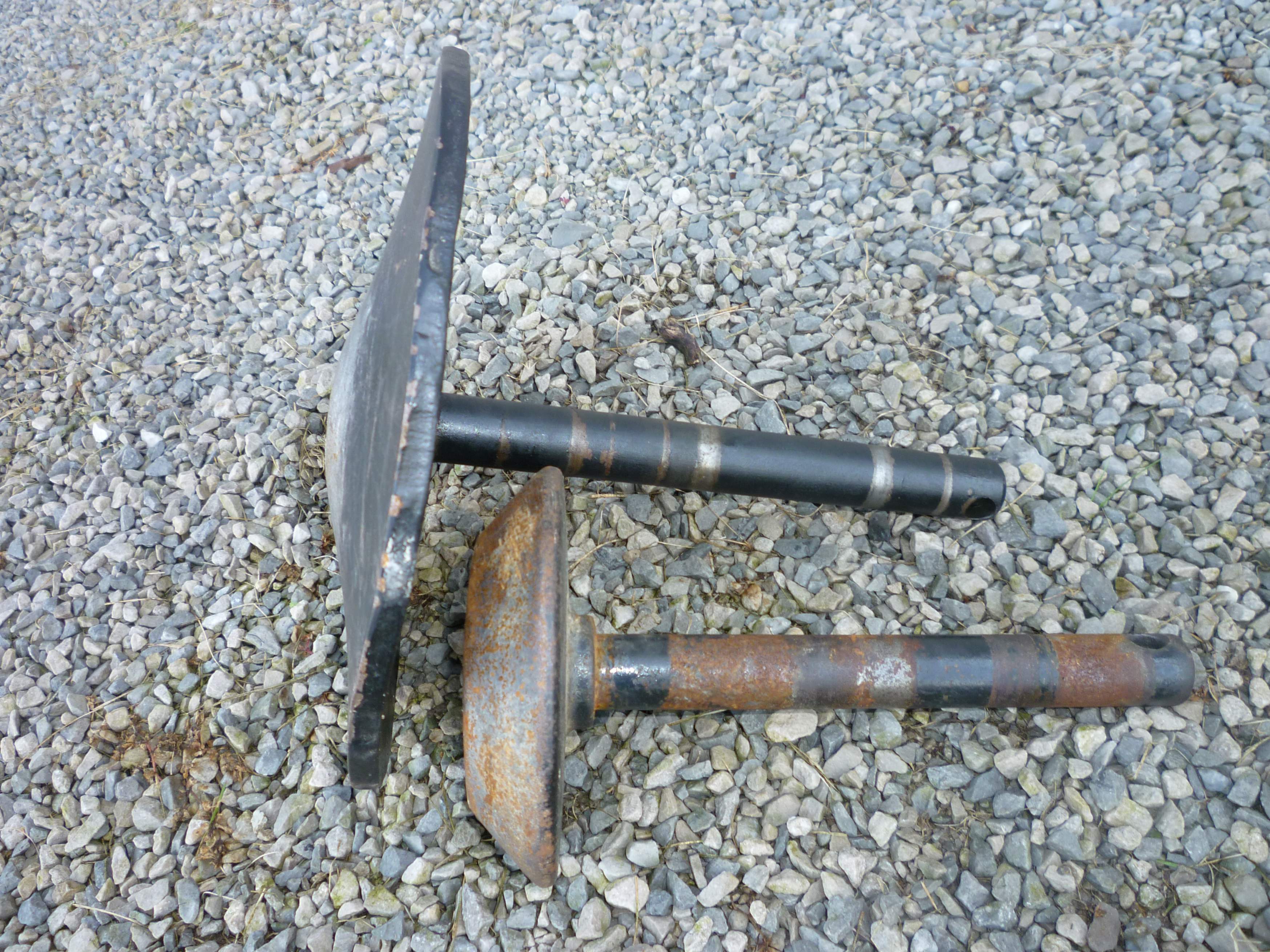

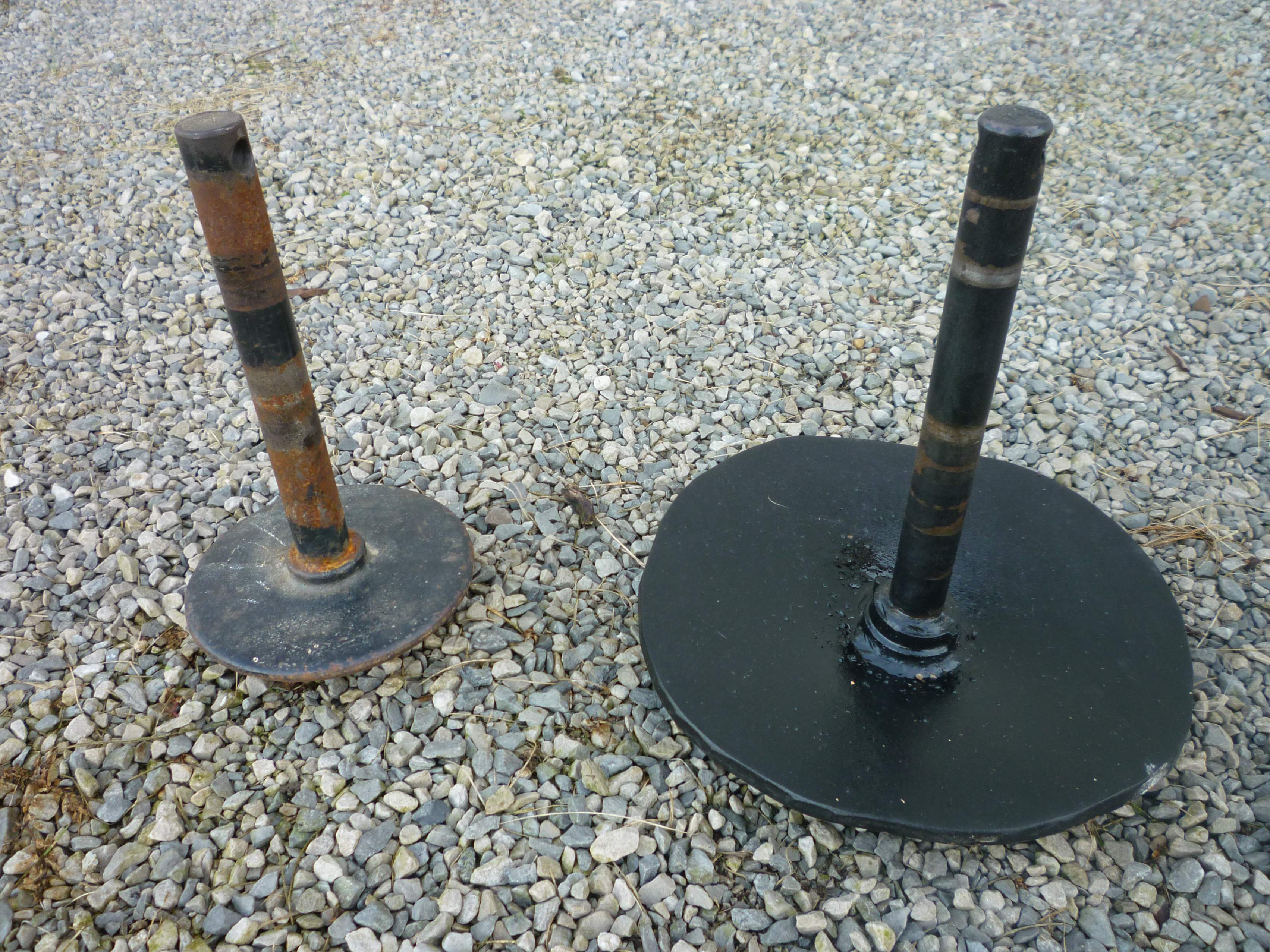

The other thing I've done is improve the shoes on the blade. I had large 10" disks made from plate steel that float on the mushy gravel when needed. The original shoes sink deep into the gravel when it's soft during the freeze/thaw cycles. The guy that made my shoes used a hydraulic press and a short piece of 8 or 10" pipe for a die. He pressed the center of the plate down into the pipe an inch or 2. They aren't pretty but they do a great job.
Ok, I dug out the plow to get a few pictures of the large shoes I have on mine. You can also see the welder added a collar at the base of the post to add strength. The best I can tell is that the collar is just a portion of a pipe coupler slid over the 1" post after the post was initially welded in place. Then the coupler was welded top and bottom for extra support.

Those look great, thank you for the pictures.
