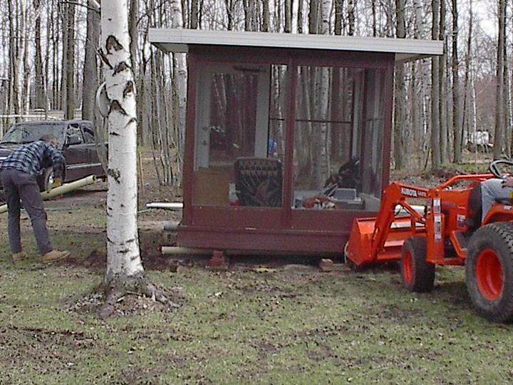

Next, we threw down some 5/4 board 'cuz the ground was still a bit squishy, and put three lengths of 3" Sched 30 PVC on top of those boards, and just moved the pipe from back to front.
This shot is coming up to a corner. I just put my bucket on the corner opposite the direction we were going and gave it a push.
May have had to tweak it once or twice, moving the tractor from one corner to another, but it only took a couple of minutes to actually get the room turned in the direction we needed it to go.

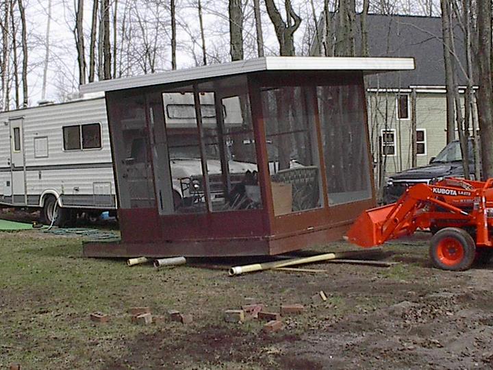

And finally, after the turn was made.
Setting it in place was a breeze, too. Once it had reached it's destination, we just lifted a corner, blocked it, moved to another corner, blocked it and so on.
Good luck, this was an easy, too quick of a project. Got me all excited, then it was over. Hmm, I've heard my wife say similar things....
