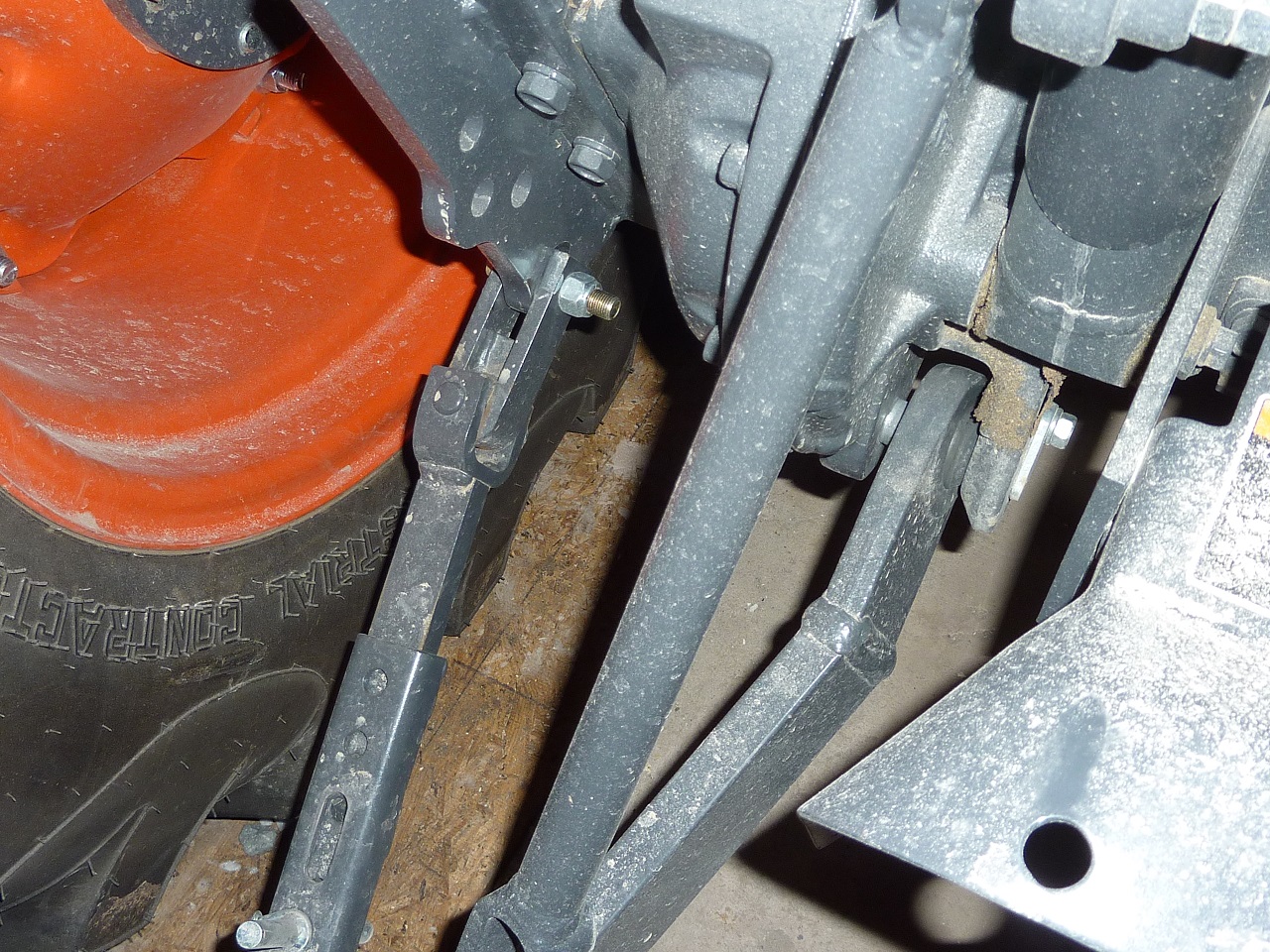

Like you, I kept the BH92 on to check it out before removing it. When I installed the 3pt hitch, I had some trouble since the dealer didn't install the drag link pins and keeper bolts. They fit in blind holes in the brake housing which got fouled with debris and it took a bit of time to clean them out. It might be worth checking. It's also a good idea to keep the parts well greased with anti corrosion lube and keep them in place when using the hoe.

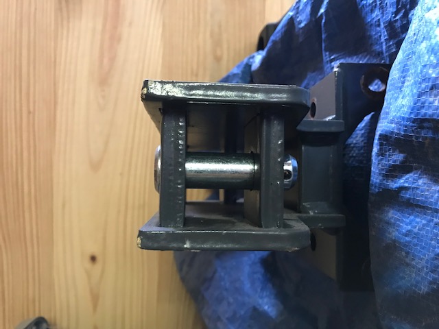

I'm not sure if this will help since I don't have a cab but here is a pic of the 3pt hitch anti sway bar attachment point:
It may be different on a cabbed model though.

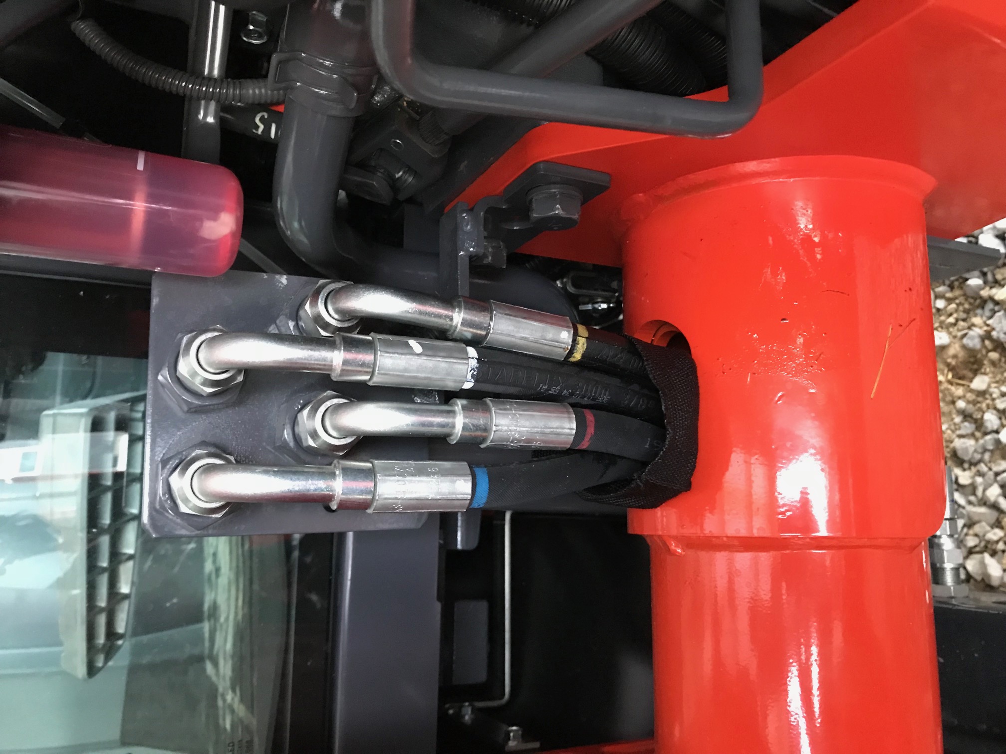

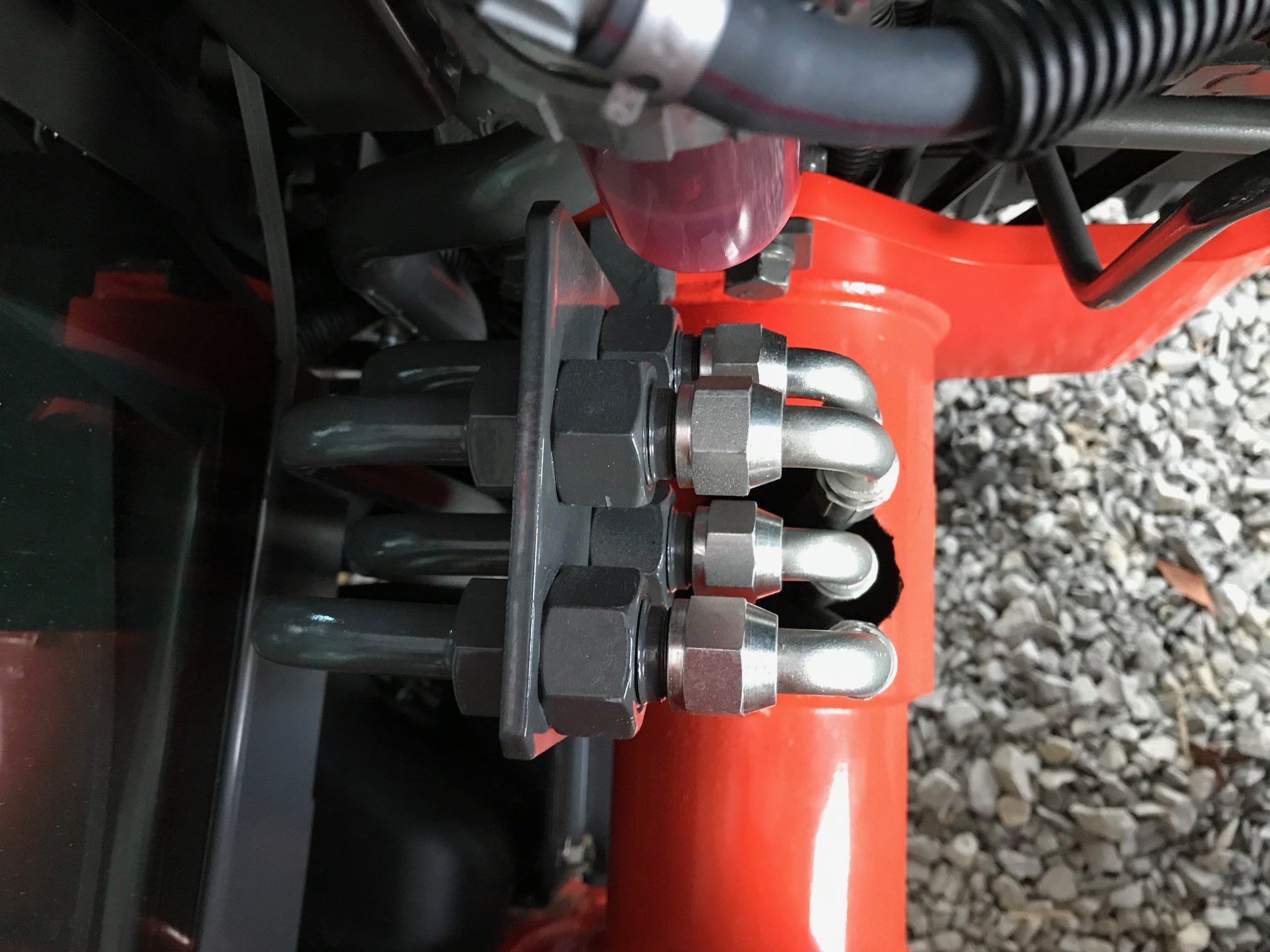

I believe I have the hydraulic leak resolved. The leak was coming from the yellow hose on the loader hydraulics where the loader block comes off the tractor equipped hydraulic outputs, which I believe may be the return for the loader up/down cylinder. Hence using the loader more caused it to leak more. I thought the leak was in the crimp, but after further looking at it over a period of a couple days I determined there was fluid around the flange nut. That led me to thinking it was likely not tightened. I got a 22mm crow foot socket adapter and was able to get a 3/8" wrench in there to tighten it about 1/4" with barely any effort. I'm not sure how tight those flange nuts should be so I basically snugged it and left it. I cleaned up the area under the tractor as much as possible and I haven't noticed any new leakage, although sometimes I spot something but I think it is old fluid that I didn't clean up before. I need to wash it but it has been way too cold.
This is where I was talking about regarding where the leak was:

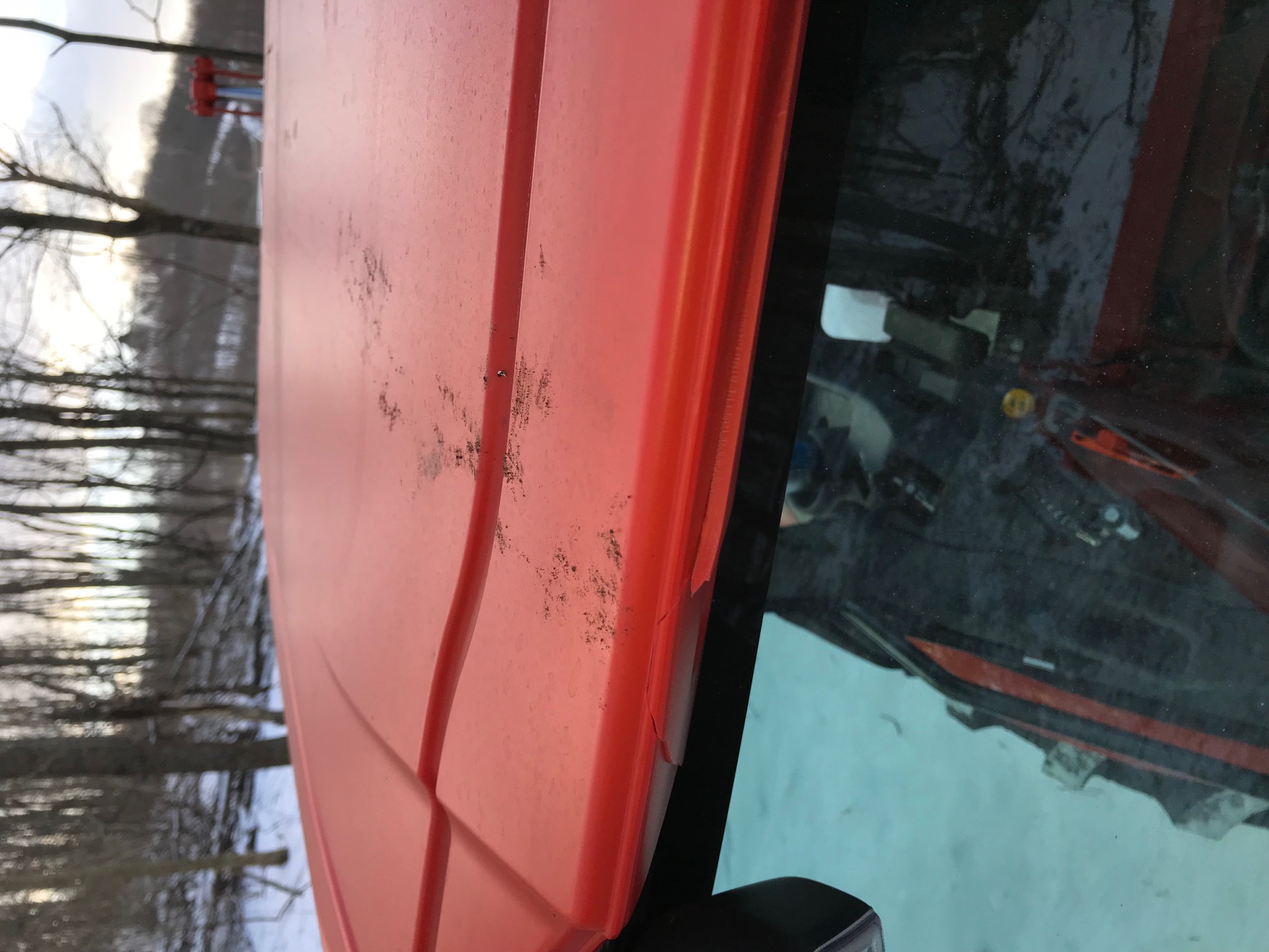

In testing the loader, I had a pile of 3/4" gravel that I used to get a load, lift it, and let it down. In years of owning tractors, I have never managed to allow gravel or anything else to fall out of the loader onto the hood by accident. I was lifting the gravel extremely high to test the loader circuit and all was well with keeping the bucket level. But I let off the joystick too quickly and it bumped back and gravel went over the top (full bucket) and onto the hood and front frame. It looked like something out of one of the JD advertisements showing off their plastic hood that won't chip. Well, I think those JD guys were onto something, because the Kubota hood and frame did chip when the gravel hit it. Bummer. If anyone has any ideas of how to properly repair that let me know. I didn't notice any dents, just chips. I'm rather peeved at myself for this one as I have never done it before and should have taken smaller bites of the pile not being fully accustom to the loader controls yet. I will say the loader does smoothly curl in and out when raising/lowering as I would expect to keep things from spilling (I don't have the spill guard btw). I could definitely see how you could get yourself into trouble not having the spill guard and forgetting to roll the bucket forward. Honestly the only time I have ever lifted anything that high practically is when I was dumping trash into a dump truck with my last tractor. I was very surprised how high the LA1055 loader could go, let alone lift a full bucket of gravel without any issue.
Here's a picture of the hood:

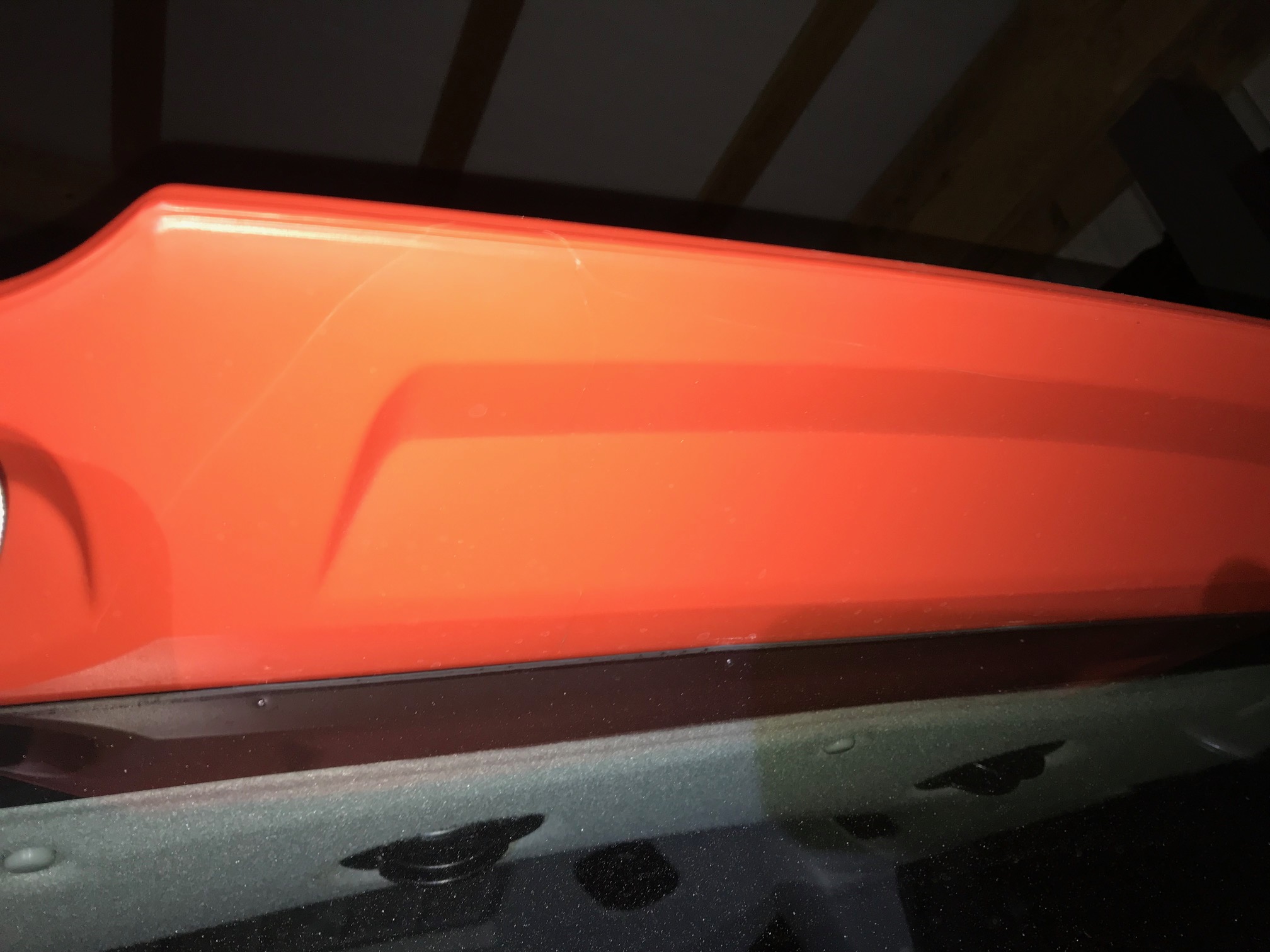

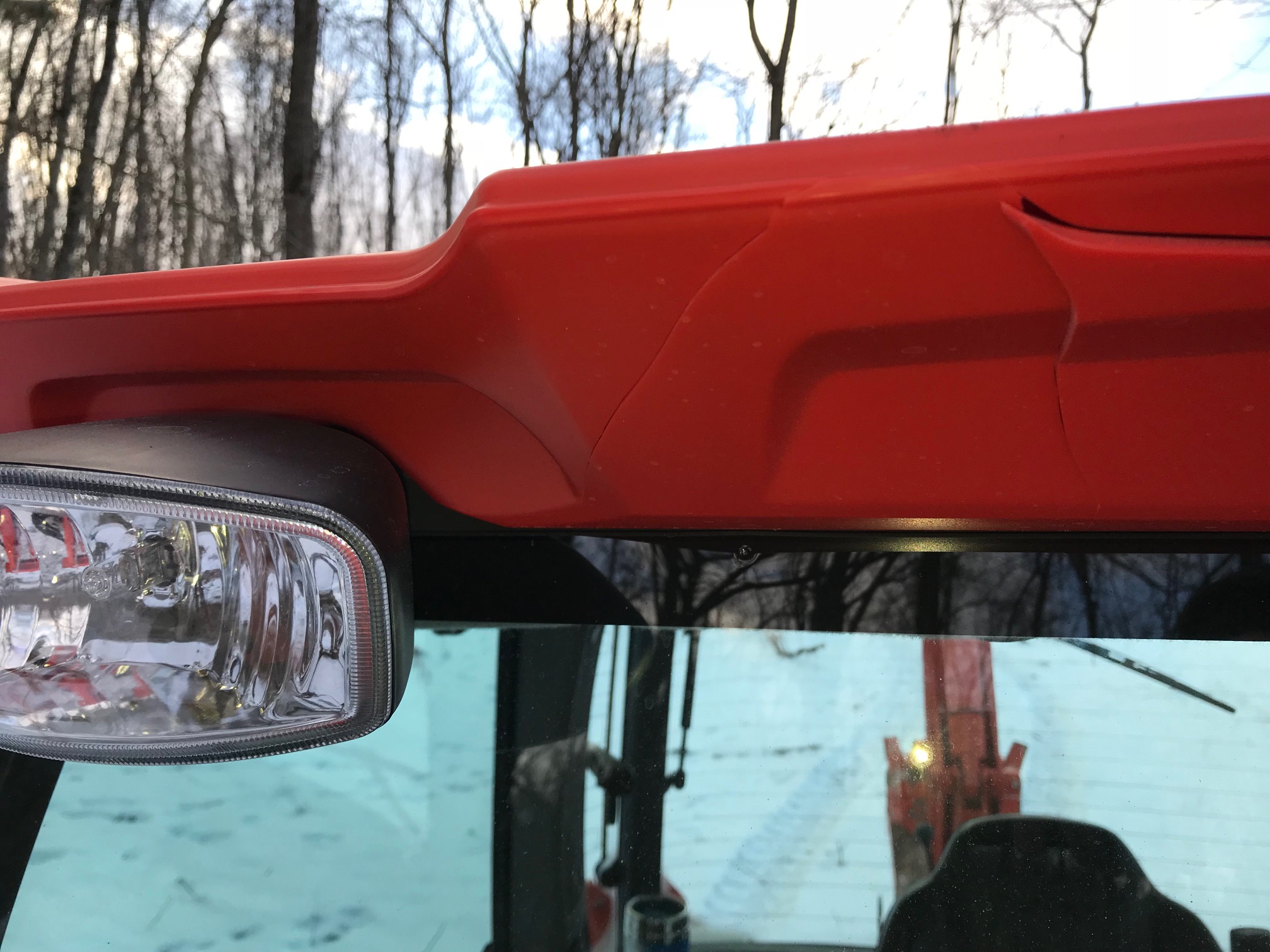

The biggest accident was when I was clearing some light debris in a partially wooded area. I've been clearing back there with my last tractor and went back there yesterday to try to push some stuff aside to make room for a debris pile when my gravel arrives this week. I managed to push against a tree that was probably 6" in diameter and it was dead and frozen and snapped off near the ground. Unfortunately I was downhill, so I raised the loader as quick as I could while reversing about 10' before stopping realizing I could back into something and just had to let the inevitable happen. The tree came down, somewhat controlled pivoting on the loader, and then hit on the top of the cab and thankfully only damaged the front of the cab exterior. I'm not sure if I should consider turning it in to KTAC or just letting it ride for now in case I do something more severe. Honestly I was just thankful to have a cab because without the cab it likely would have missed the roll bar and hit me, likely causing extensive injury. I wasn't really upset it happened, as I definitely was not expecting the tree to move when I was pushing up against it. One thing I did realize though is with the cab you cannot see as far up as with a ROPS. I somewhat think had I noticed the top of the tree was gone I would have been more inclined to know it was dead and not have gotten around it. I've broken a lot of stuff in my years and gotten pretty upset with myself, but this one was definitely a "stuff happens" kind of moment. Honestly I'm surprised the cab held up as well as it did, and I almost wonder had it been warmer (it was about 10F when it happened) if it would have cracked at all.
This is what the front of the cab exterior looked like after it happened:
I managed to pry the plastic back and push the other piece back in place so it sealed up pretty nice by itself. I haven't tried to put anything on it. I do worry about the cracks long term though.
