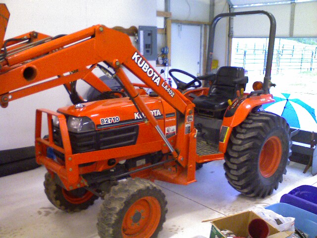

I have a 2002 B2710 I bought new and have put about 500 trouble free hrs on it. I know around this area if they are in good shape they are asking over 10K. I would have a hard time wanting to sell it even at 12K (not that I could, my wife claimed it after she bought me the L45). It is a good size any acreage or hobby farm.
Photo_112711_001.jpg.
   / HOW DO KUBOTA B2620 & B271O MODELS COMPARE?
#15
What size bucket is mounted on the 2710...54"?
There is a 2710 nearby with 550 hours with an asking price of 11,500. Has been left outdoors some of the time and has a seat with some tears.
