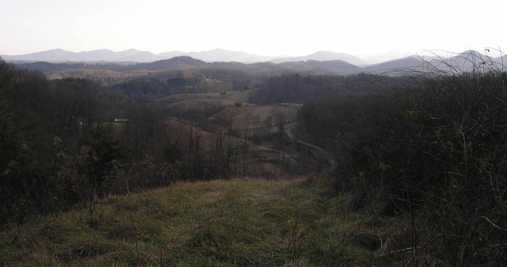

Hi Renze: The land is very hilly on My Farm in Western North Carolina. The ground is very uneven. Often I need to lift the mower as high as it will go to maneuver around obstacles the hydraulic top link will allow me to lift the mower higher. Also I mow very steep pasture. A 3PH implement with a strong linkage system will help the tractor resist a rear rollover. A mower with chain linkage would offer no resistance in case of a rear rollover.
I plan on strengthening the linkage on my brush cutter. The strap linkage that came with it folded up like noodles one day when I caught the mower on a hidden stump and the mower stood up on end behind the tractor.
Thanks for asking, Marshall

Marshall:
Your place looks like it has the same sort of terrain as my West Virginia property, except mine is more wooded. I mowed my open areas for 15 years with a 5' Bush Hog on a Ford NH 1320. Both the property and tractor are for sale because I have moved to Northern CA where the ground is even steeper and I have a new JD 3320. I know exactly what your problem is- the ability to float the mower, but still be able to lift it high enough to drive or clear stumps. I think a hydraulic solution, however you work it out, is the only way to go.
That said, the way my Bush Hog works is the attchment frame for the 3 pt pivoted on the mower deck and chains are attached to the back to lift it, but allowed it to pivot up. This was very useful when backing into a steep hill to mow or turn around, it would just tilt up. This arrangement prevents damage to the mower. I mowed a gas line right-of-way that was so steep that it was hard to walk and 4-wheelers had trouble if they lost momentum. I never had the front end lift even though the tractor was rated for a smaller mower (I always mowed with the loader on). If I lost traction I would just back up and try a different line, or wait for better soil conditions. If you are light in the front on hills you may need to rebalance your tractor.
If I had had a hydraulic top link on the Ford I could have just lowered the link so that the chains would be loose and allow the mower to float on its rear tire and the lower 3 point arms. Raising the link and the 3 point hitch would get the mower up high.
