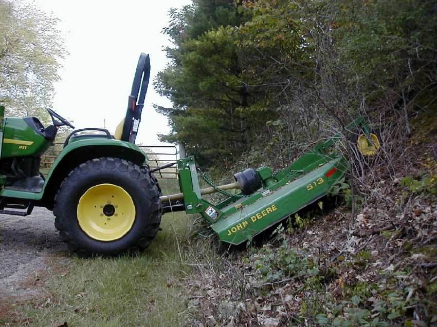

I am new to "tractoring". Can someone explain how a chain is used with a rotary cutter to help "float" the attachment? Possibly a picture?
Not my picture, but:
attachment.php
You use a chain as a top link. This will allow the tail to rise independently of the front of the cutter. My carry all/forks are made this way to allow easier pick ups and drops.
I've never used a rotary cutter so maybe someone can comment on whether this is a reasonably safe thing do.
