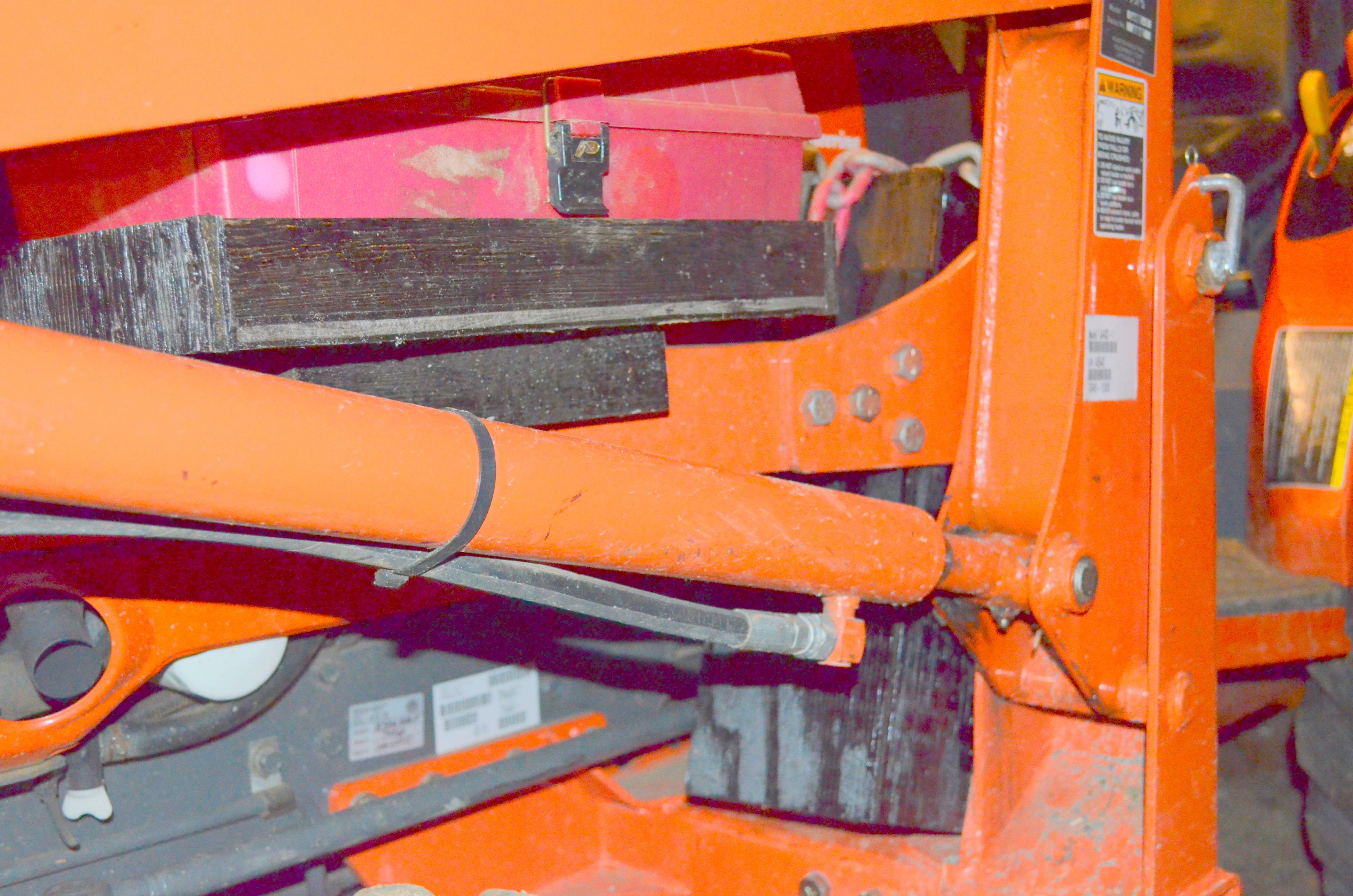

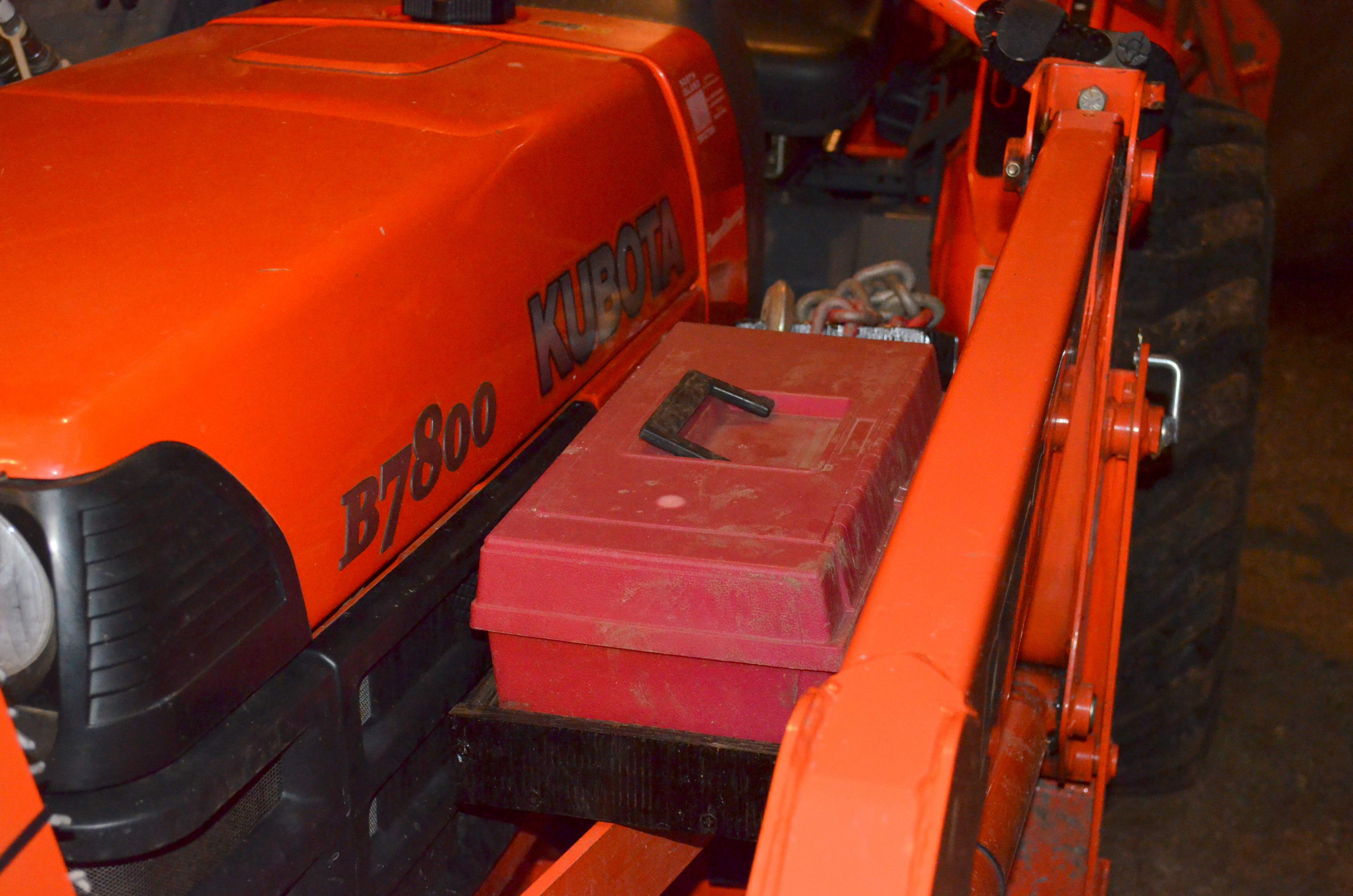

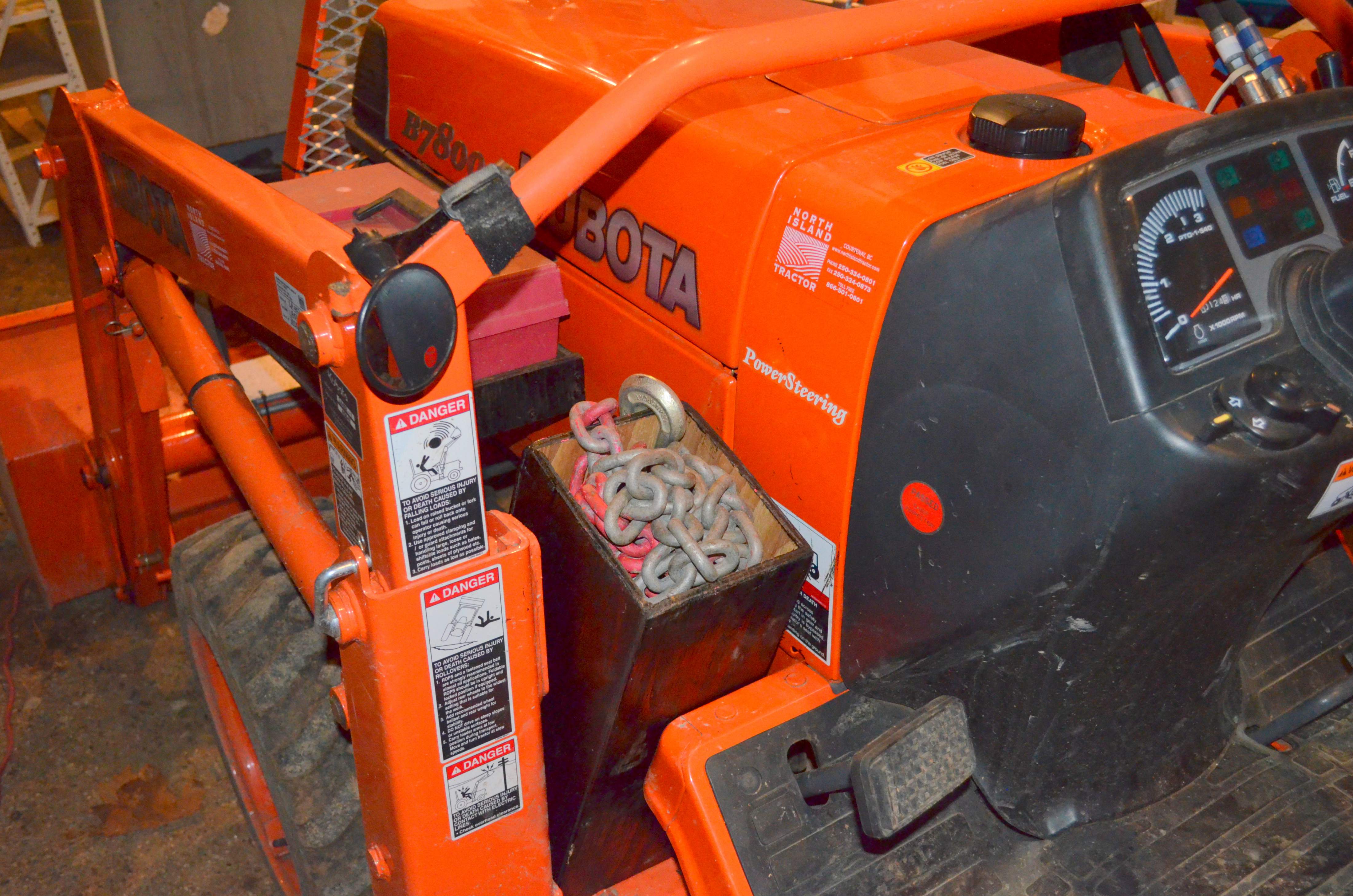

For stowing chains I made up a simple wooden box that sits on the FEL frame right in front of the clutch pedal. Bolted to the sheet metal of the floor-boards. It`s completely out of the way, has drain holes in the bottom but would be easy enough to put a lid on it. For my tool-box, ,I made a simple tray for the box to sit in. On the underside is a couple of ears` or slot which jambs down over the FEL frame to hold it in place. Both work like a charm! DSC_0043.jpgDSC_0044.jpgDSC_0043.jpgDSC_0046.jpg
