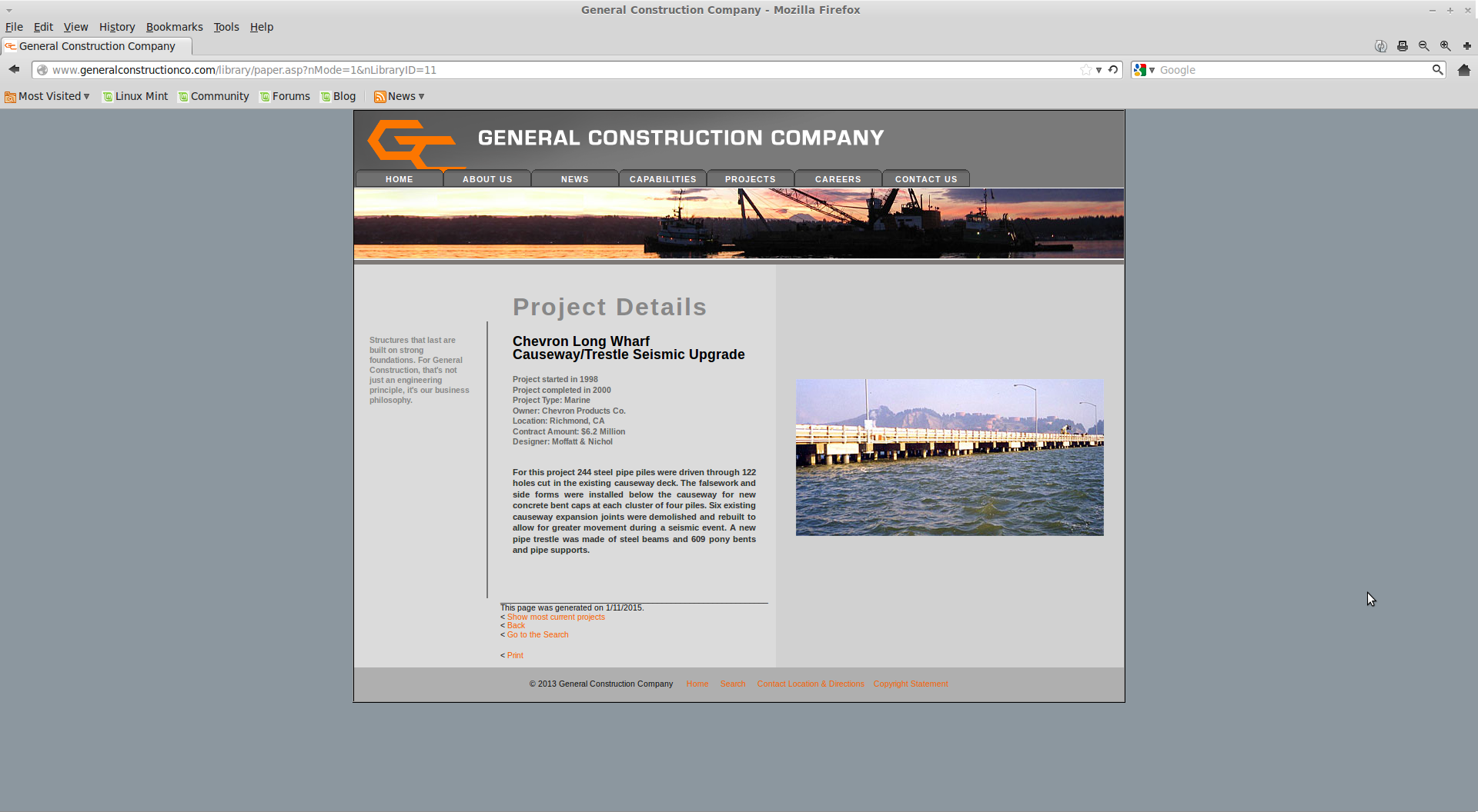

I was the supervisor on the Chevron Long Wharf in Richmond California. The welders ran self shielded flux core wire. But the welder tacking the beams in place with the rigging crew used 7018. I had to have three rod ovens on site, and keep a log book of how much rod was taken out of the oven in the morning, how much rod was put back in the oven at noon, and how much rod was taken out of the rod oven after lunch, and how much rod was put back in the oven at night. :confused2::confused2:

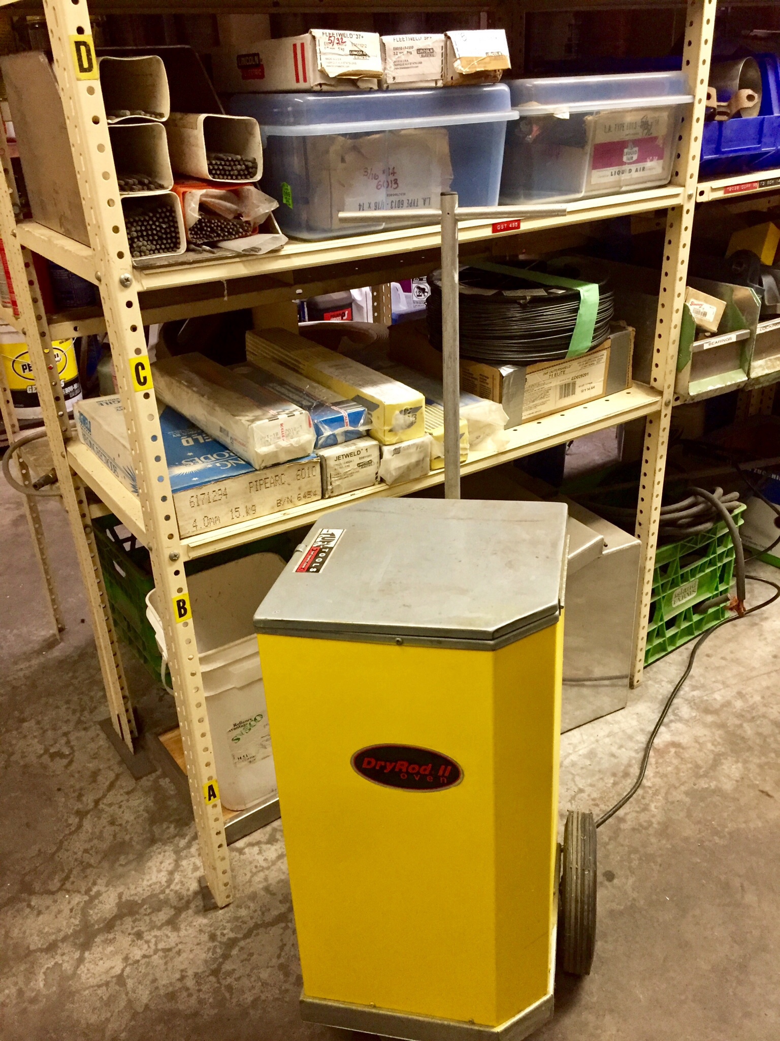

i too have a small rod oven. also a nice way to warm my hands in winter :)images.jpg mines the same as this but only yellow colored.
