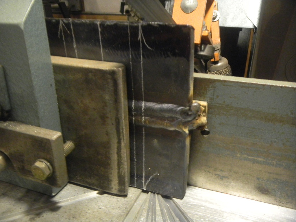

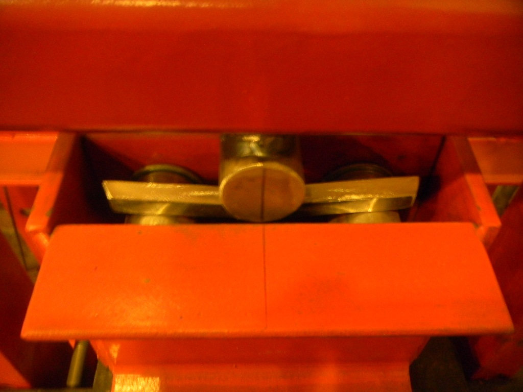

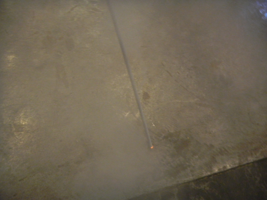

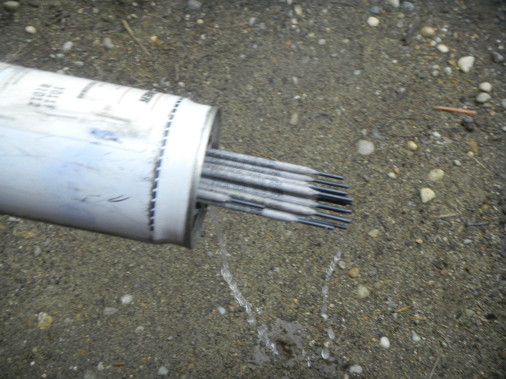

Living west of Seattle, building bridges, container ship docks, and ferry docks for a living. I can't tell how many times I had to pour water out of a can of 7018, because some carpenter didn't close the lid to the gang box.
Here is what wet 7018 can do!;)

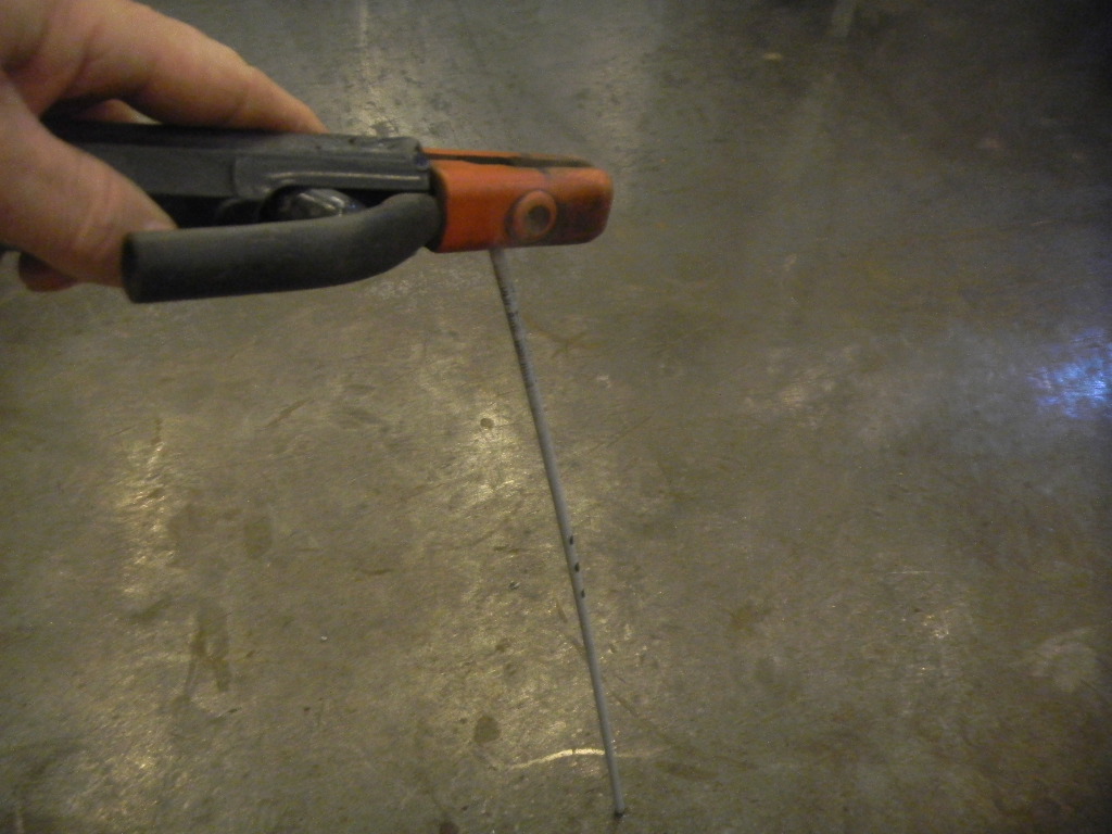

If a 7018 weld has porosity does that mean the rods are wet? I bought some Lincoln 7018AC at Lowes and the welds are porous , mostly at the start. I hold a very short arc, but still does it. Thanks.
   / how do you store your welding rods (7018) #28

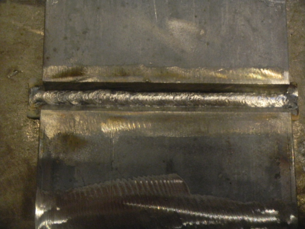

bigdeano put your 7018 in the stinger and ground it out on some metal to dry the rod out. Then weld with them;).

   / how do you store your welding rods (7018) #29
7018AC<<<The AC is half the problem, I've had the same the trouble with those, I wont use them no more. It's not really a low hydrogen rod, 7018 DC rod is a better/stronger rod, you wont get no porosity with those but you need a DC welder.
