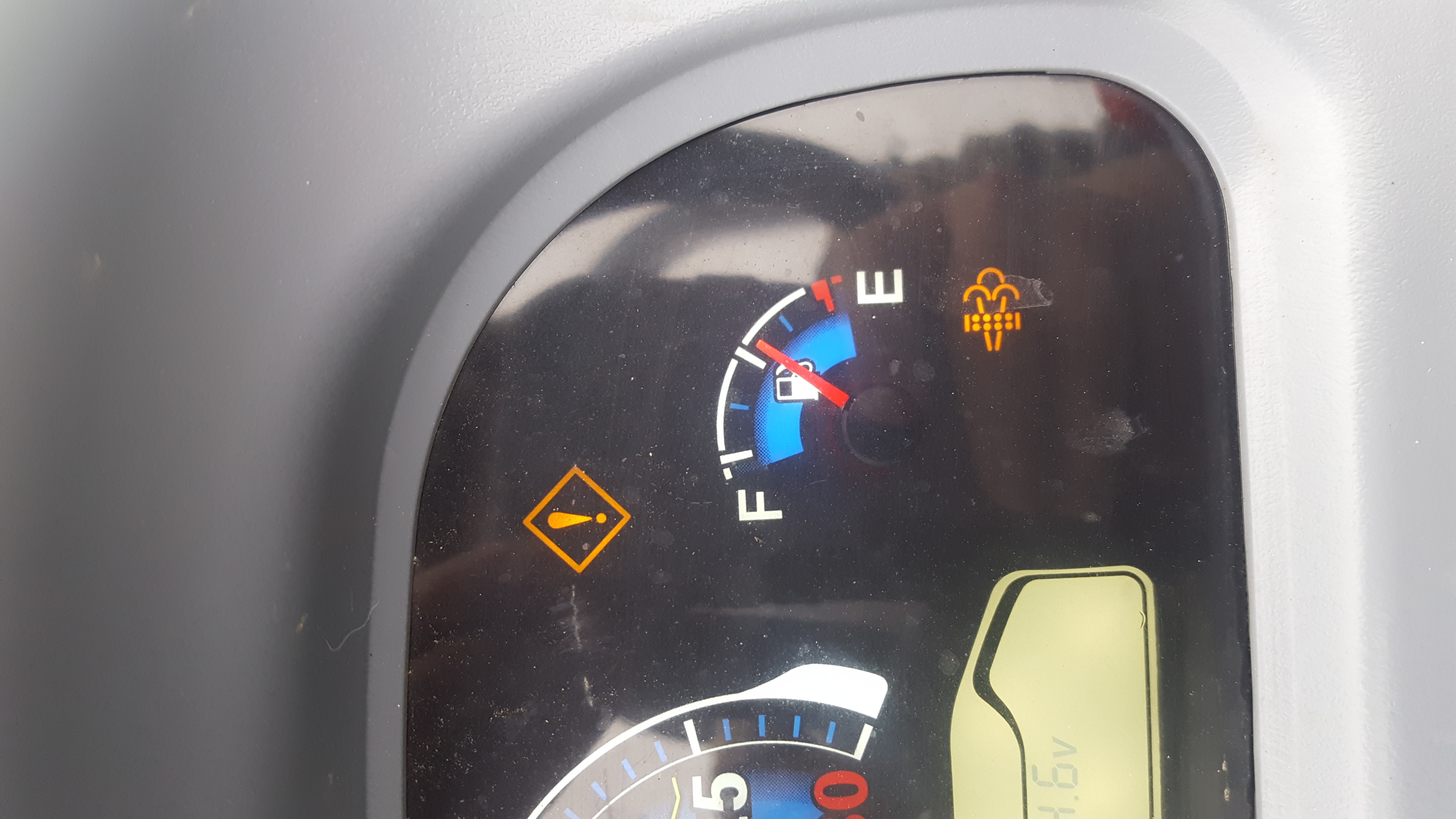

Ironically I had the opportunity to prove the concept today. Tractor tried to go into regen and started freaking out, flashing lights, flashing a code. I bumped up the RPM and it calmed down, code went away, regen commenced. I looked up the dash code in the service manual and it is a Regen Overload. Just for grins I hooked the Amazon scanner and read + cleared the stored DTC. Torque recognized the DTC code and provided an explanation.
