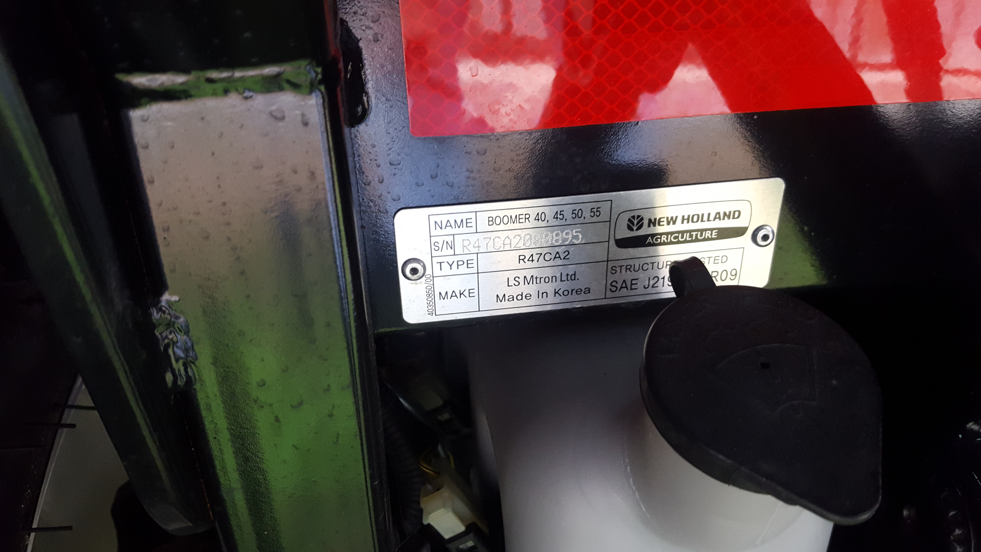

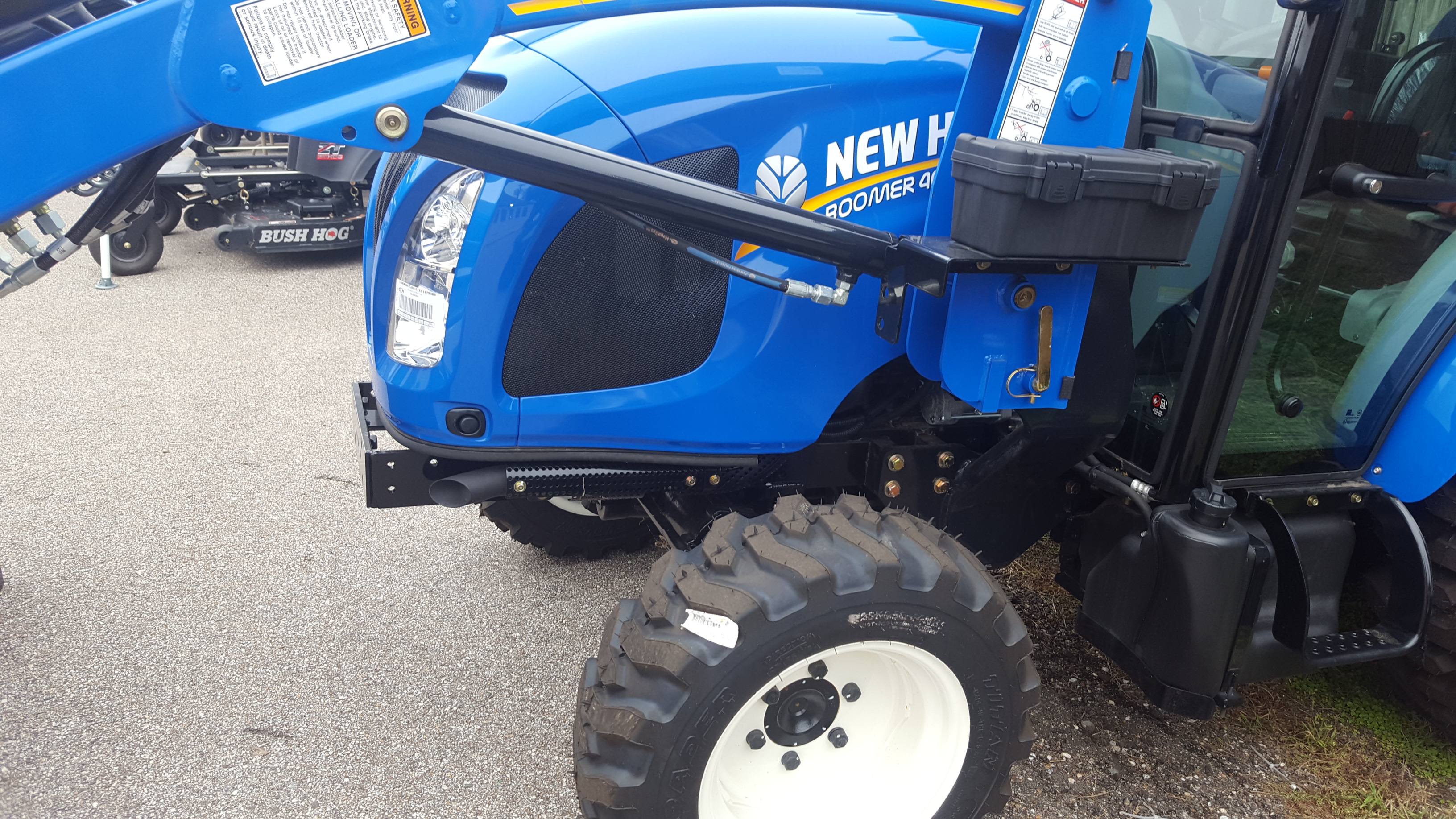

Really? Since when? Literally this month? I took the attached pictures 3 weeks ago at the county fair, New Holland dealer was there with a whole line of LS Mtron machines that didn't end until up around 75hp I believe.

Fiat owns NH now... The Boomer CVT models are built in-house by Fiat, heche en Mexico. The other Boomer and Workmaster models are made by LS.
