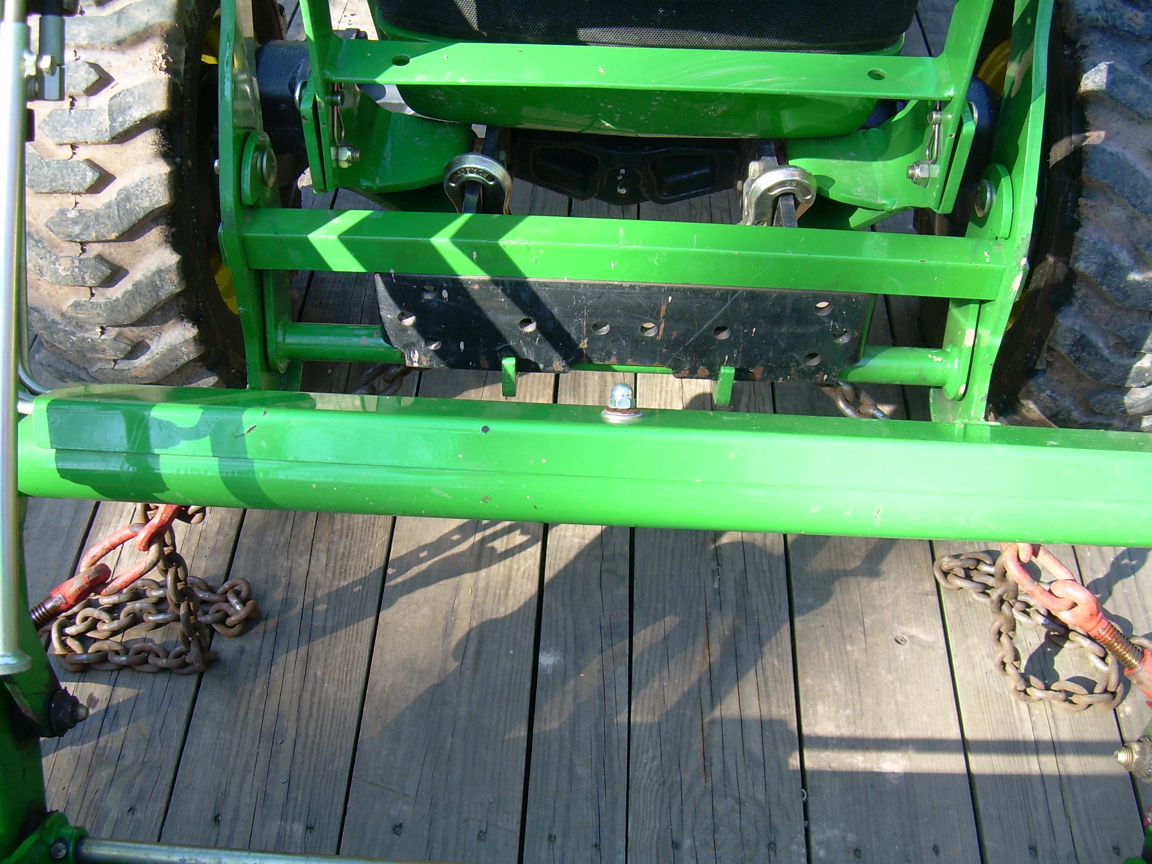

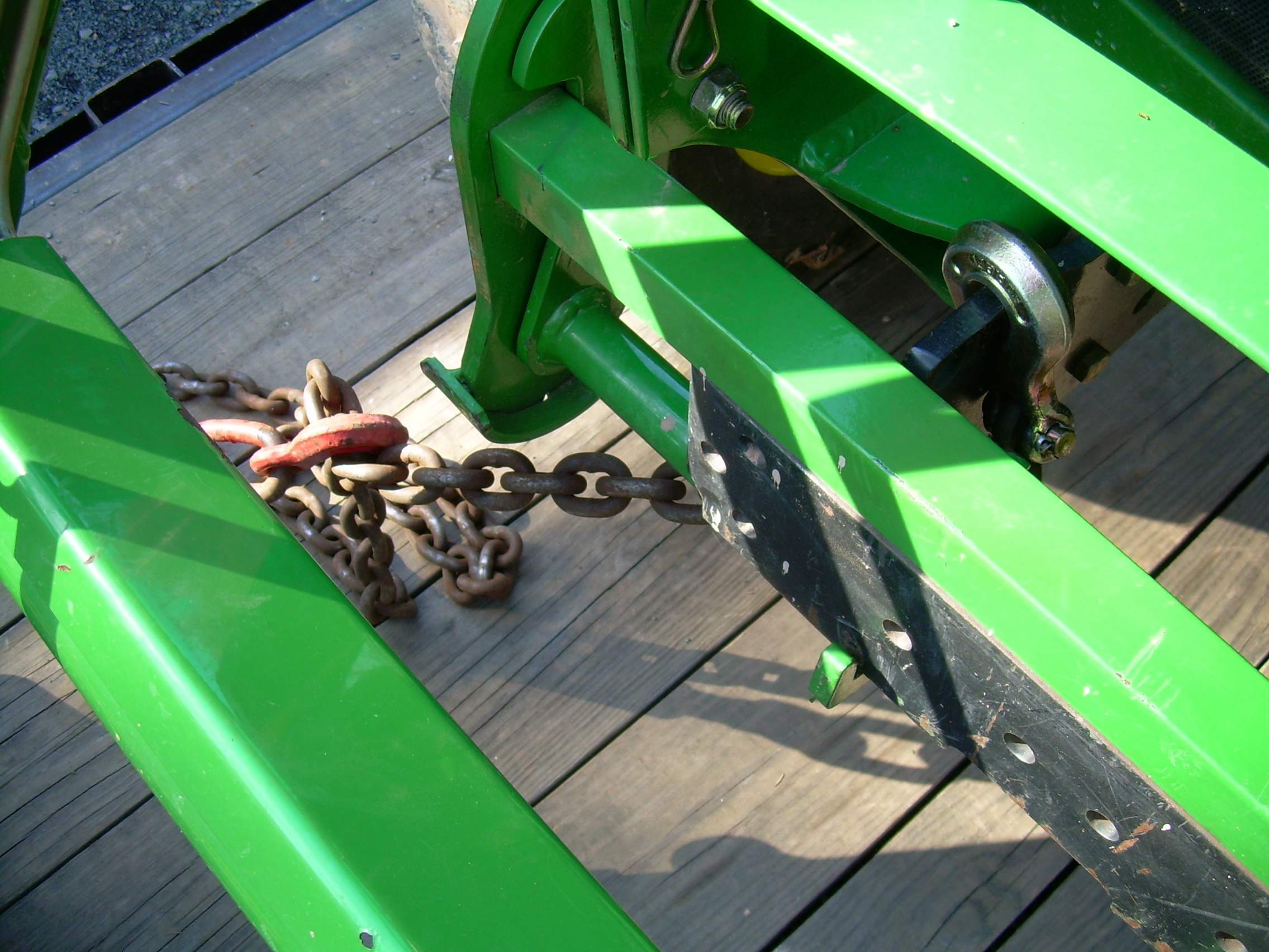

I used to tie my JD870 thru the same holes in the front bucket, and tie the rear over the drawbar support. There was no other way to do it. I use 5/16" chains though. QUOTE]
Do you have any pics? I have thought of this but how?
no pics..sorry. I sold the tractor last year. My new tractor is too heavy and large for my current trailer.

Here's how I do my 790

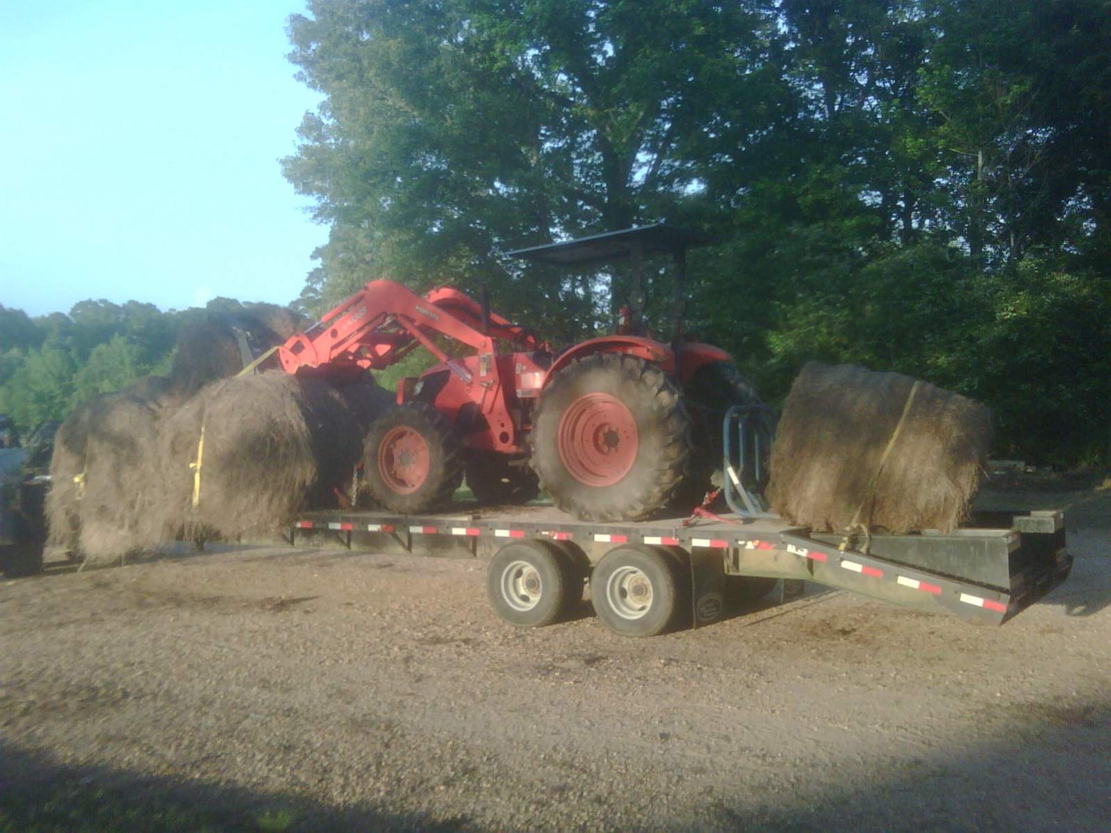

I haul a M9540 with a shackle in the drawbar with a chain passed through it and another chain through the loader arm cross tube. Never had any problems. When I was a kid my dad and grandpa hauled tractors all over the place without even a hay string holding them down and never had any trouble. At least I am doing better than that.

I also haul my M9540 with a 3/8 G70 chain and 3/8-1/2 binder through a shackle in the drawbar on the rear and a 3/8 G70 chain and 3/8-1/2 binder looped over brush guard on front. This is how the Kubota dealer suggested to tie it down. I wish there were holes or hooks to use, but there isn't and I don't really want to start drilling or welding to the frame.
On our JD 4020, I do use two 3/8 G70 chain and 3/8-1/2 binders on front and rear because I am able to find something to hook to, plus it is a heavier tractor.

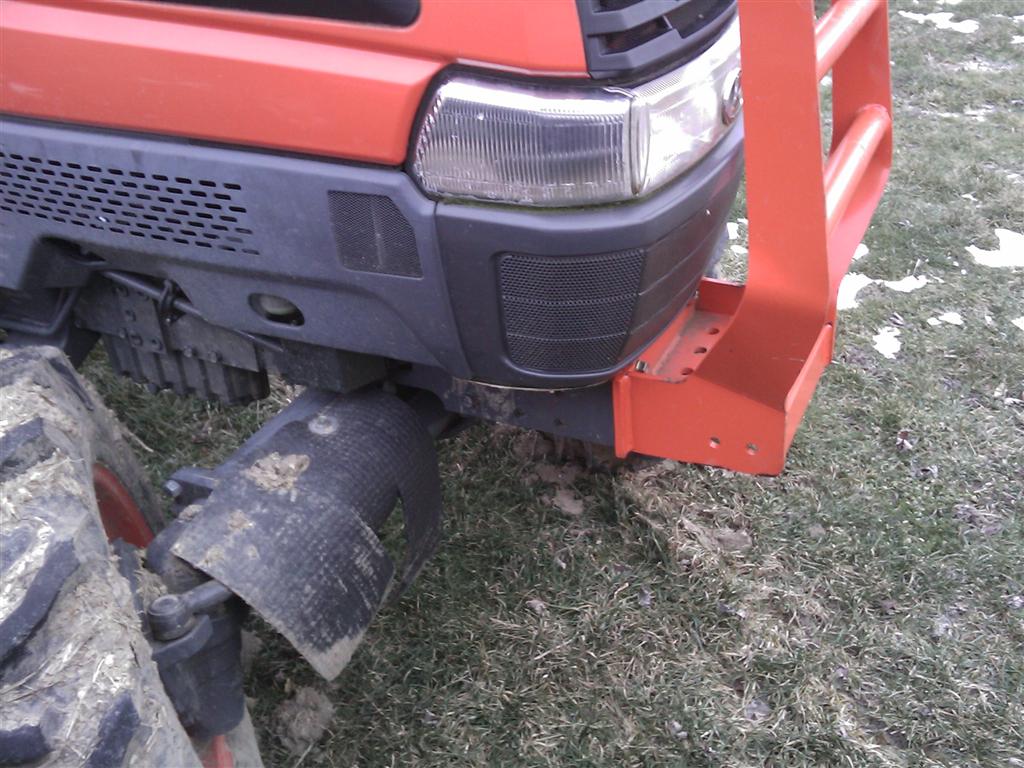

   / How do you tie down tractors when hauling on a trailer? #160
I don't think the brush gaurd is designed to hold much more than itself, I do the frame behind the weight bracket. that makes a very short stout connection.
Makes sense in your case, but on a Kubota (like OrangeToys who I replied to has) the brush guard is different. This is the one on our L3830 which is similar to his:
That (IMO) is strong enough to fasten the tractor to.
Aaron Z
